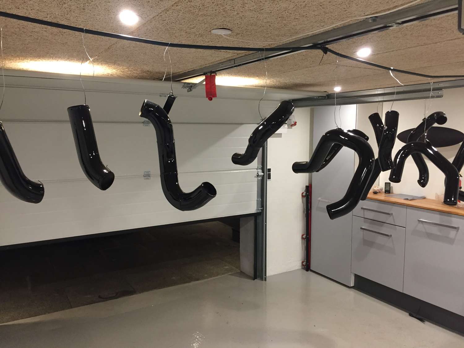

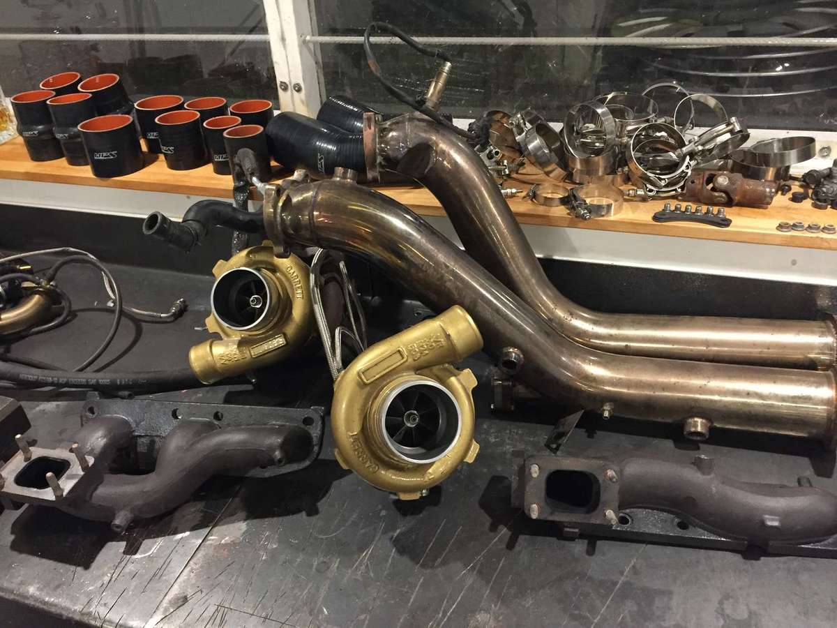

Ortega_9 Posted November 28, 2017 Share Posted November 28, 2017 (edited) Always wanted to go the tt Way with a 350z, and after a few Sc kits, i finally Got my hands on a tt kit. this is what i will be building over the winter. gtm stage 5 twin turbo kit. with 2x garrett gt3076's i'm having manifolds made from stainless, in bigger dimensions, and also having ALL the support hoses, water, Oil, re done in braided Lines with AN fittings. all IC piping is powdercoated Black, aswell as the bov and turbos. lots of parts still needed, i will make stuff up along the Way. hopefully this will be done by spring.... *Wishfull smiley with nervous tweeks* Edited December 31, 2017 by Ortega_9 5 Quote Link to comment Share on other sites More sharing options...

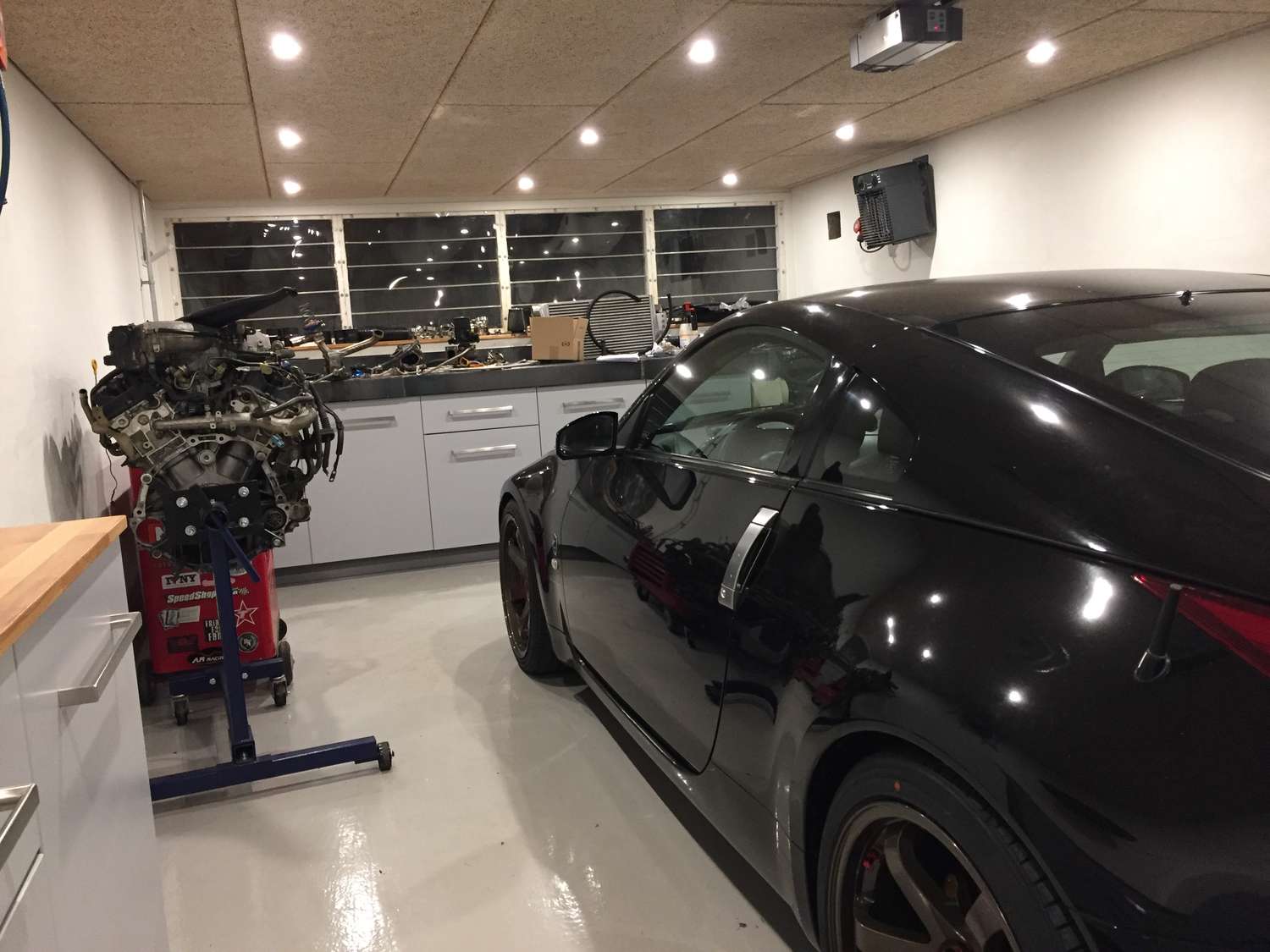

rabbitstew Posted November 29, 2017 Share Posted November 29, 2017 Nice looking garage there! 1 Quote Link to comment Share on other sites More sharing options...
Ortega_9 Posted November 29, 2017 Author Share Posted November 29, 2017 (edited) 2 hours ago, rabbitstew said: Nice looking garage there! Thank you. just had the whole thing done. Used to be a shed, and with my special hoarding powers it was a mess... Edited November 29, 2017 by Ortega_9 3 Quote Link to comment Share on other sites More sharing options...

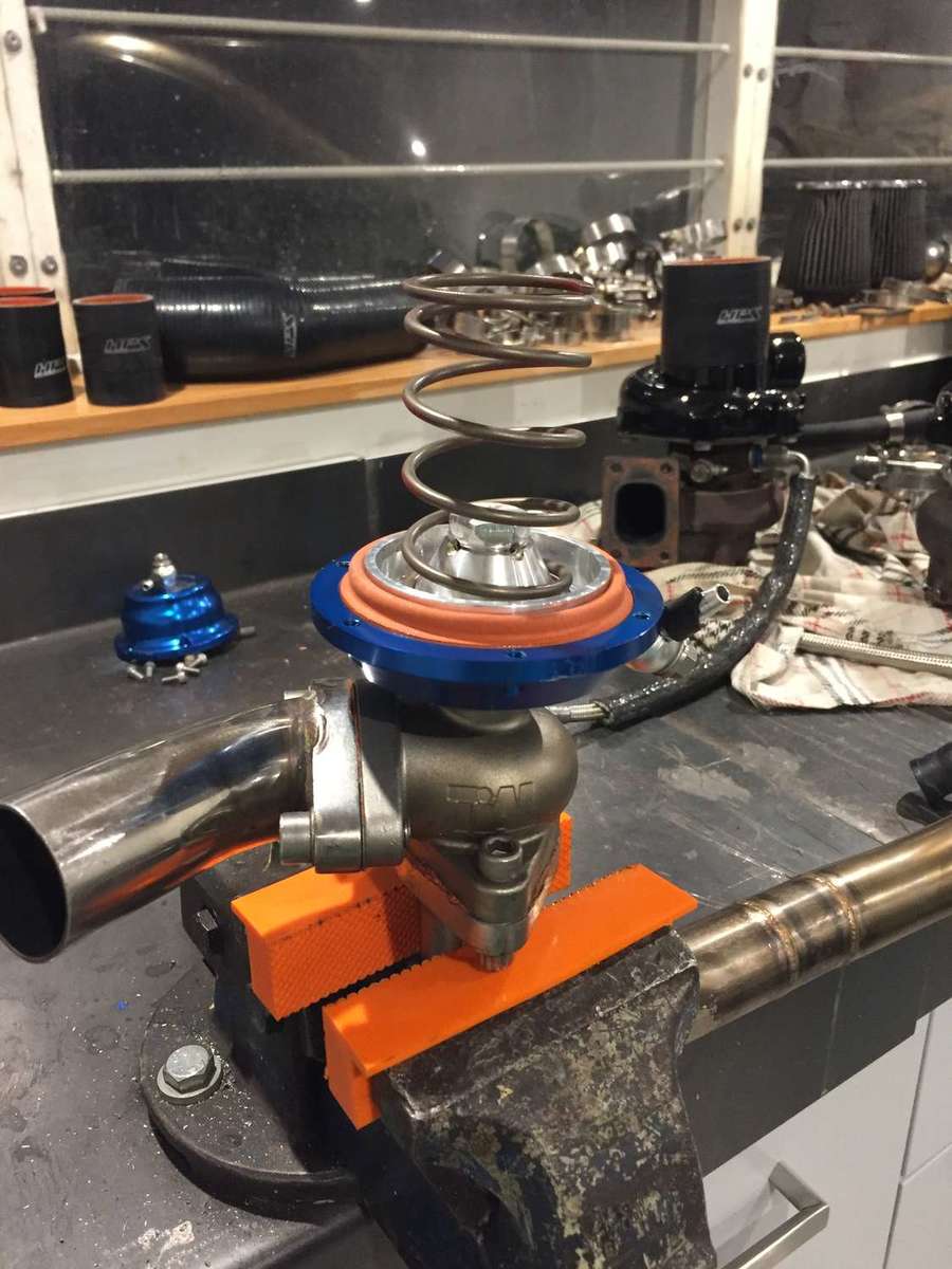

Ortega_9 Posted December 23, 2017 Author Share Posted December 23, 2017 And just Got my new wastegate springs in. Small red tial springs will see 0,4 bar. and that's about ALL i dare on the Stock vq. So that's the starting point. 1 Quote Link to comment Share on other sites More sharing options...

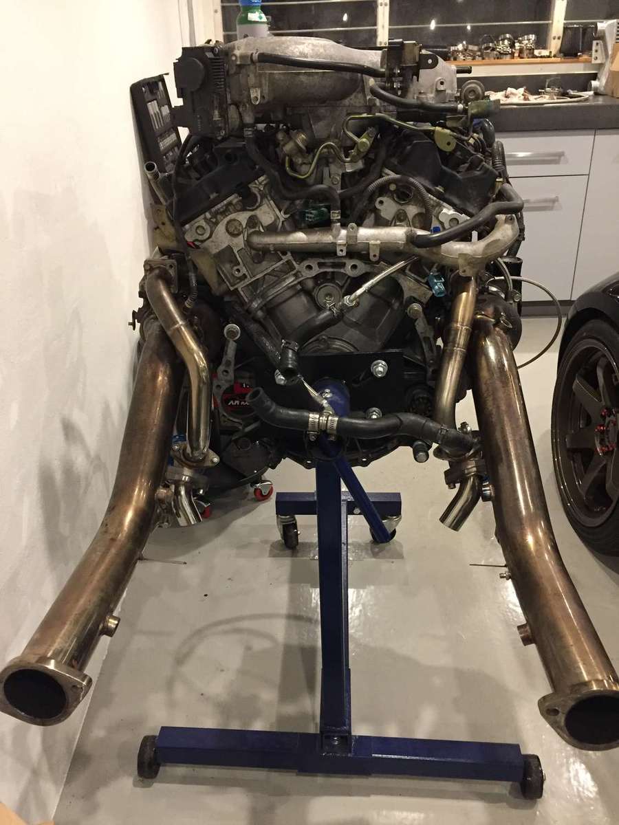

Ortega_9 Posted December 31, 2017 Author Share Posted December 31, 2017 And ALL done... Well, the manifolds, then i Can begin the teardown 2 Quote Link to comment Share on other sites More sharing options...
Ortega_9 Posted January 1, 2018 Author Share Posted January 1, 2018 Right hand side test fitted. everything seems to be in place. Quote Link to comment Share on other sites More sharing options...

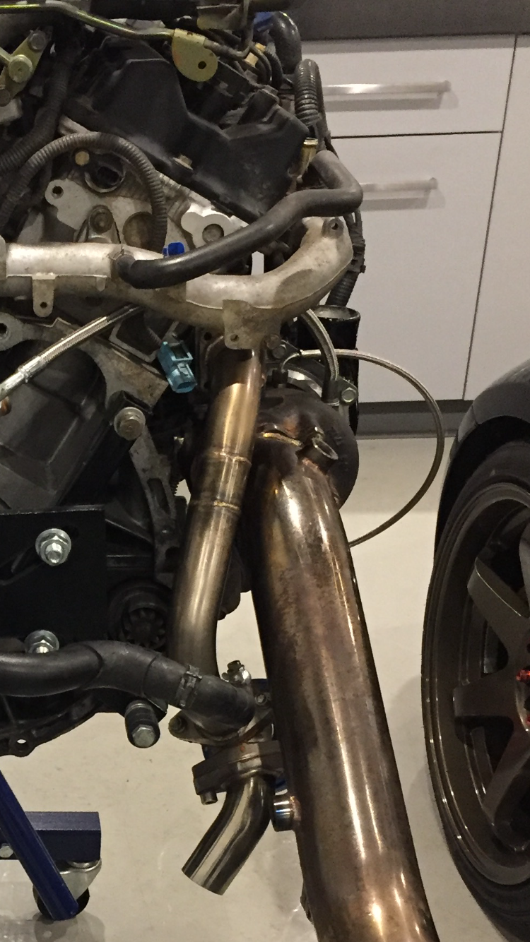

Ortega_9 Posted January 1, 2018 Author Share Posted January 1, 2018 And the left hand side test fitted. i Think i might have to adjust the wastegate piping as the flanges are a little off... but Otherwise everything looks fine.... 6 Quote Link to comment Share on other sites More sharing options...
Ortega_9 Posted January 7, 2018 Author Share Posted January 7, 2018 Had a little time to get something done. cut and adjustet the right side wastegate pipe. Now it clears the transmission. Last picture is from before, sticking out like a sore thumb. need to do the other side aswell. also pulled the exhaust off the car.. and sold it, so need to make something new in 3" instead of the 2,5" it was 2 Quote Link to comment Share on other sites More sharing options...
