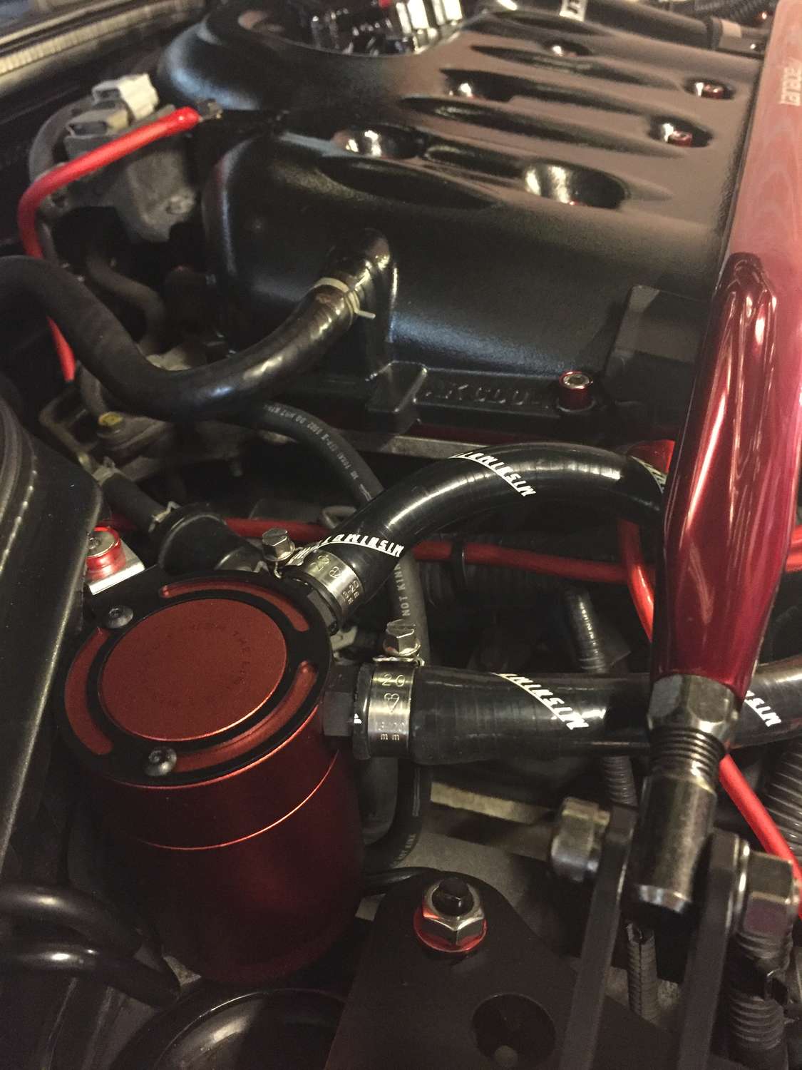

SHEZZA Posted November 21, 2017 Share Posted November 21, 2017 (edited) Here you go pic of the rockstar and red catch cans Edited November 21, 2017 by SHEZZA Quote Link to comment Share on other sites More sharing options...
Chris141084 Posted November 22, 2017 Author Share Posted November 22, 2017 Engine bay is looking well mate, do you have the piping to go with the can? Quote Link to comment Share on other sites More sharing options...

SHEZZA Posted November 22, 2017 Share Posted November 22, 2017 5 hours ago, Chris141084 said: Engine bay is looking well mate, do you have the piping to go with the can? Cheers mate. No piping with it, though it's now sold mate. Quote Link to comment Share on other sites More sharing options...
Chris141084 Posted November 22, 2017 Author Share Posted November 22, 2017 No worries mate, did you have to buy your pipe work separately, or did it come as a kit? Quote Link to comment Share on other sites More sharing options...

SHEZZA Posted November 22, 2017 Share Posted November 22, 2017 I bought it separately mate, got some mishimoto 10mm vacum hose. However being silicone it's porous so I'm looking to change it, any recommendations would be good 3 minutes ago, Chris141084 said: No worries mate, did you have to buy your pipe work separately, or did it come as a kit? Quote Link to comment Share on other sites More sharing options...

nissanman312 Posted November 22, 2017 Share Posted November 22, 2017 16 minutes ago, SHEZZA said: I bought it separately mate, got some mishimoto 10mm vacum hose. However being silicone it's porous so I'm looking to change it, any recommendations would be good Fuel line is a good shout think that's what we used Gt4zed set mine up 1 Quote Link to comment Share on other sites More sharing options...
SHEZZA Posted November 22, 2017 Share Posted November 22, 2017 4 minutes ago, Chris141084 said: I would see where you nearest hydraulic supplier is, I'll be going to carlton hydraulics near me and asking for some pipe rated to carry oil so it doesn't degrade. Clear plastic hose should do the trick tho Cheers for that mate. Yes I've seen the clear stuff. Not keen of the look of it to be honest, reminds me of the beer pipes in my parents old pub ! Quote Link to comment Share on other sites More sharing options...
SHEZZA Posted November 22, 2017 Share Posted November 22, 2017 1 minute ago, nissanman312 said: Fuel line is a good shout think that's what we used Gt4zed set mine up Cheers mate that's another option then Quote Link to comment Share on other sites More sharing options...
Chris141084 Posted November 22, 2017 Author Share Posted November 22, 2017 Haha that's true, not the best looking stuff. As said above, fuel line would work too Quote Link to comment Share on other sites More sharing options...
