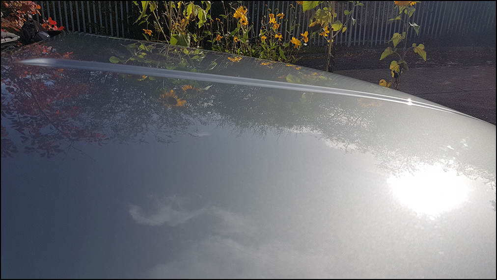

1CE Posted October 21, 2017 Author Share Posted October 21, 2017 Thank you! I took a deep breath and IPA'd the whole bonnet. It's removed all contaminants and tree sap! Then clean, waxed and polished! Only done the bonnet as it was taking forever but the results speak for themselves . Quote Link to comment Share on other sites More sharing options...
HEADPHONES Posted October 21, 2017 Share Posted October 21, 2017 Glad to see and hear that the paint is back to its former glory Quote Link to comment Share on other sites More sharing options...
