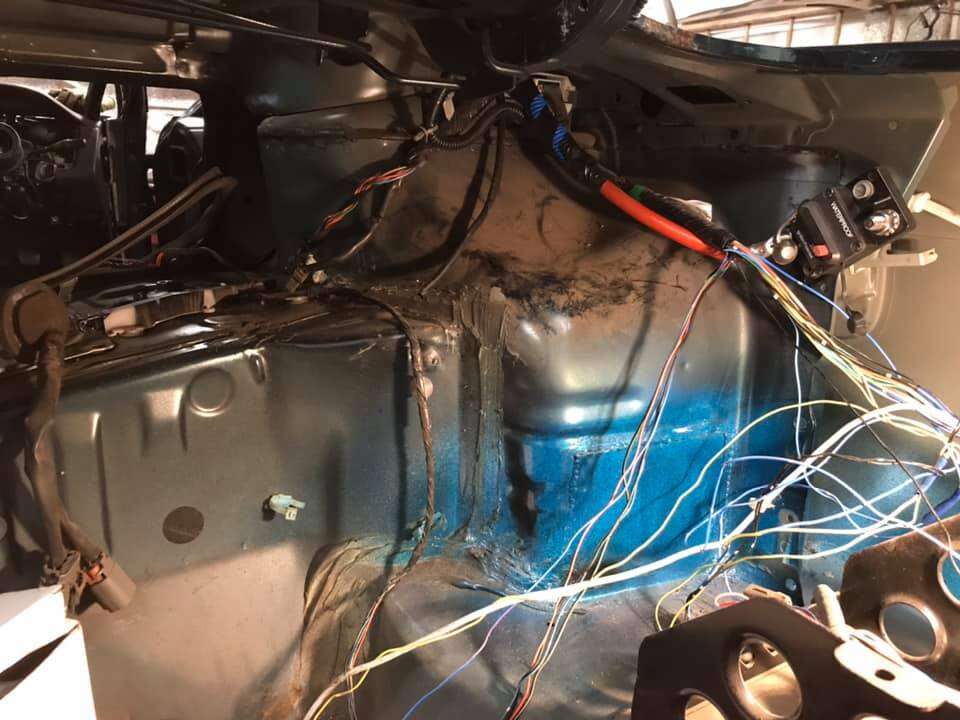

evilscorp Posted October 30, 2019 Author Share Posted October 30, 2019 Sad times, I was told the car was finished by the restorer after months of waiting and false promises from the guy I turned up and it was half complete. Ended up being a paypal dispute but hopefully it's clear cut and I will get money back. So it's back in my possession and I now need to see whats missing/broken and needing finished. Most of the new floor and sills have been primer'd but the ones that haven't I have done, today I used cavity wax to stop any fresh bits in the sills going rusty, lets just hope I don't have to weld near them as I think the stuff is very flammable? every crevice I could find I sprayed in, I bought 3cans and still have a small bit left in the first one. I will redo them all once ive finished welding any parts that need done (seat mounts were cut out and not replaced). I may have lost some of my labels on the connectors... 1 Quote Link to comment Share on other sites More sharing options...
scobie140 Posted October 30, 2019 Share Posted October 30, 2019 Shame about the restorer screwing you over, hopefully you get it back on track. That wiring looks like my worst nightmare 1 Quote Link to comment Share on other sites More sharing options...

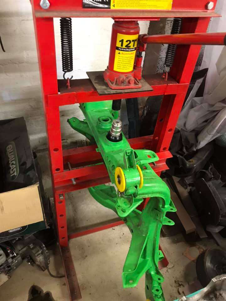

evilscorp Posted May 27, 2020 Author Share Posted May 27, 2020 Been a while, trying to upload on the forum this time. Done a lot, made a lot. I will let the pictures tell the words. 1 Quote Link to comment Share on other sites More sharing options...

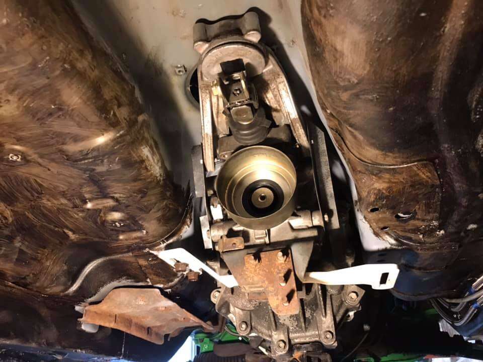

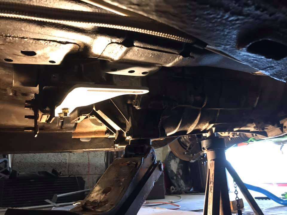

evilscorp Posted May 27, 2020 Author Share Posted May 27, 2020 350z diff lined up well, by complete fluke I think. 1 Quote Link to comment Share on other sites More sharing options...

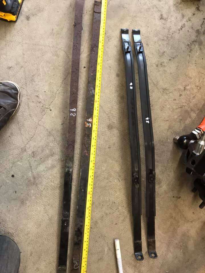

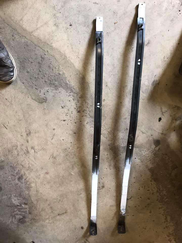

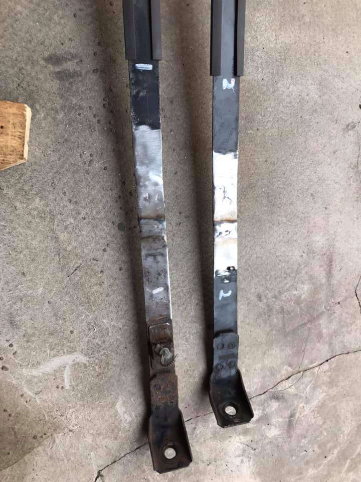

evilscorp Posted May 27, 2020 Author Share Posted May 27, 2020 Couldn't get new fuel straps and 370z ones dont fit lol, probably going to run a old seatbelt as a precautionary 3rd back up in case the welds and back up tabs brake. 1 Quote Link to comment Share on other sites More sharing options...

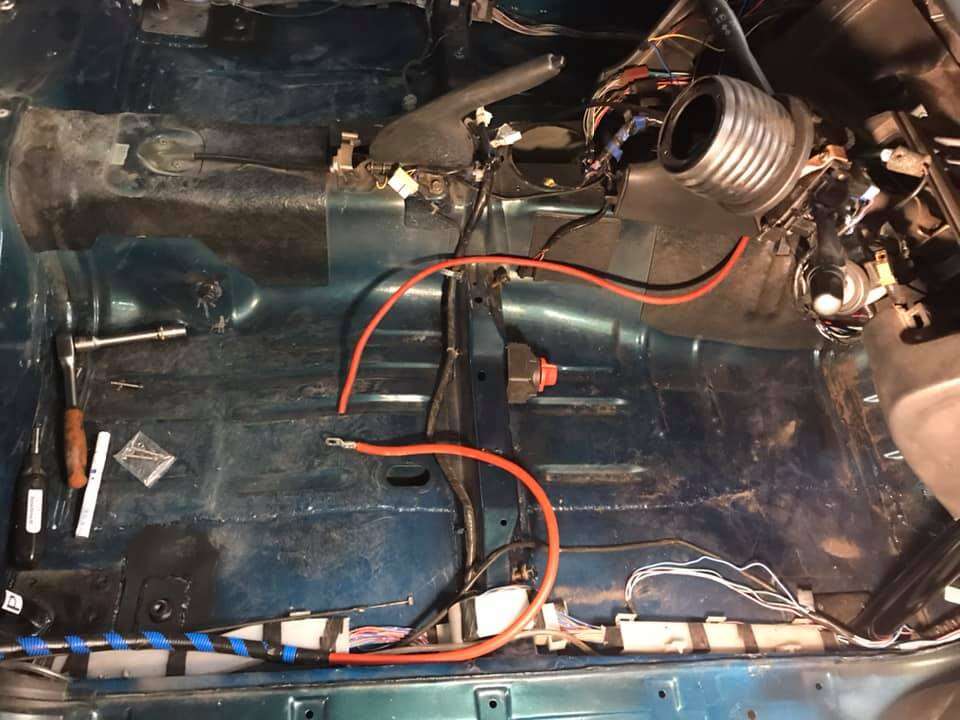

evilscorp Posted May 27, 2020 Author Share Posted May 27, 2020 Battery kill switch/added security under driver seat. Runs to the relocated fusebox in the dash. 1 Quote Link to comment Share on other sites More sharing options...

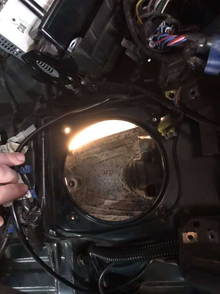

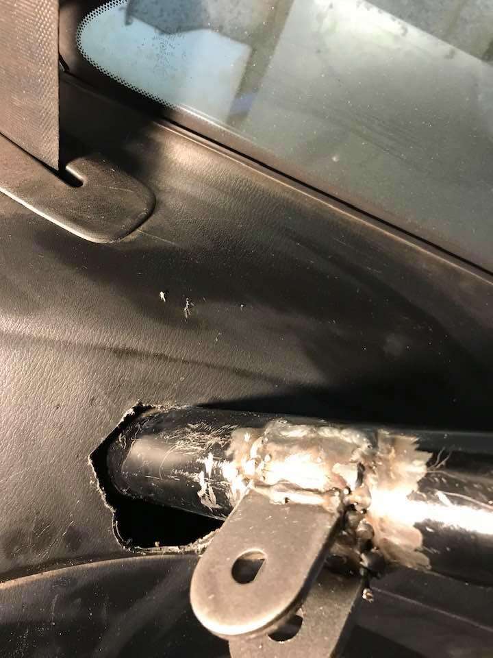

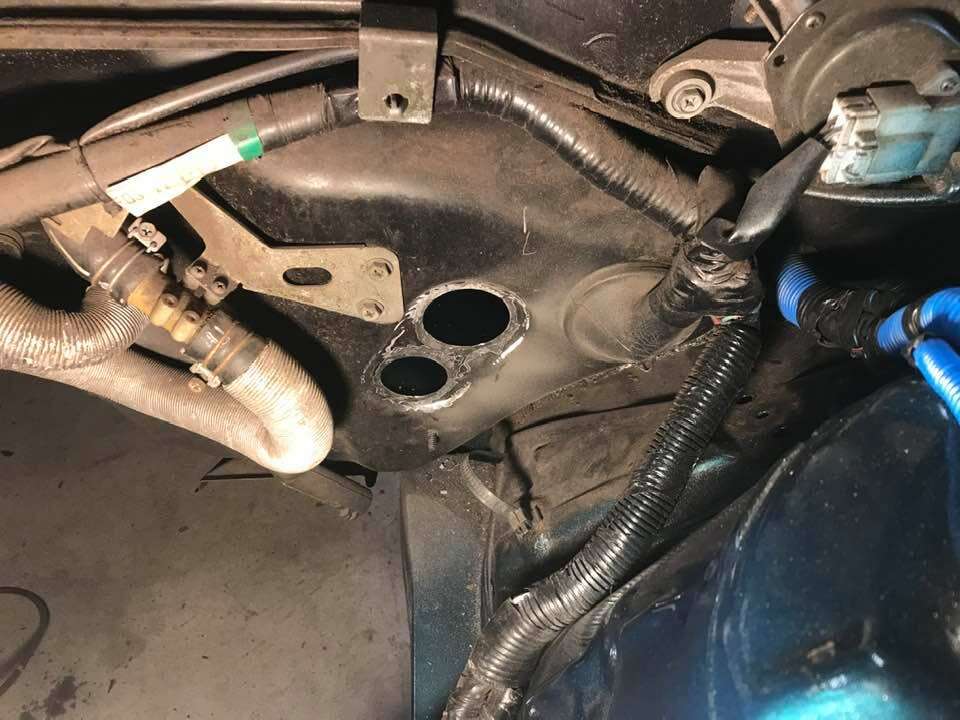

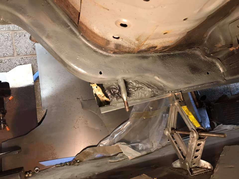

evilscorp Posted May 27, 2020 Author Share Posted May 27, 2020 Didn't want to use rubber grommet for the air con delete so welded the holes (near the downpipe so a bit hot for rubber) Mocking up a removable harness bar. Tried to put mounts under the rear seat arch but the fuel tank hits them so no go. Quote Link to comment Share on other sites More sharing options...

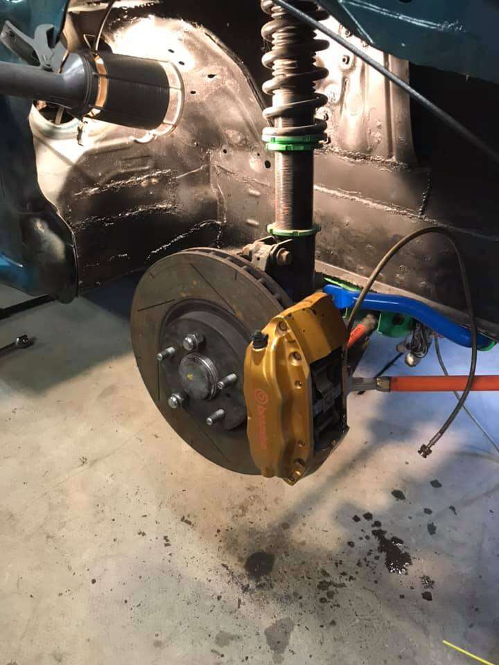

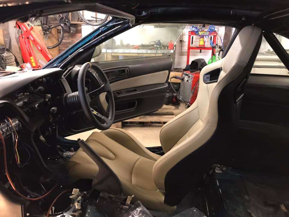

evilscorp Posted May 27, 2020 Author Share Posted May 27, 2020 350z brembos needed the geomasters drilled out to accept the larger bolt. Also braum seat will fit a 5'10" driver and no one else lol, my head is going to be below the roll cage and in a good position for me, however the missus might struggle as it wont go much further forward and it can't move back due to the roll over bar. 1 Quote Link to comment Share on other sites More sharing options...

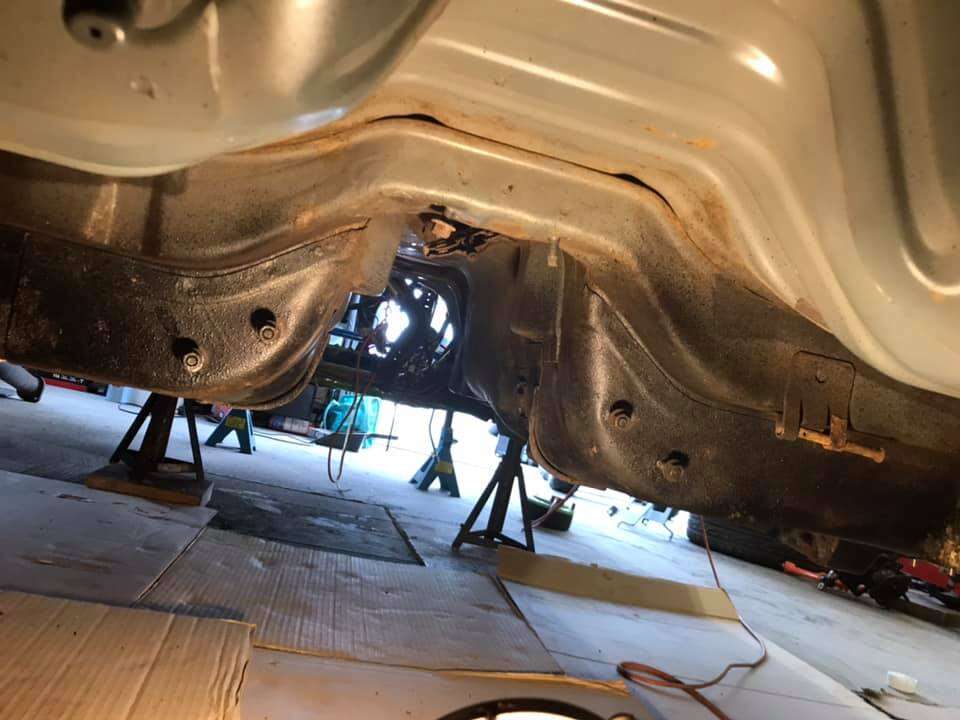

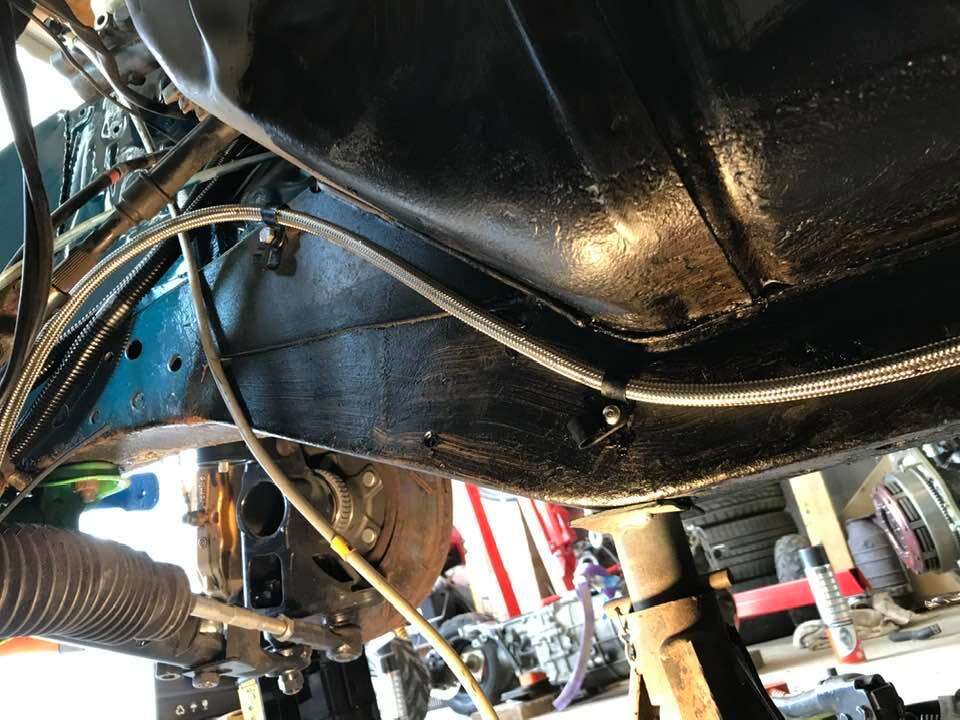

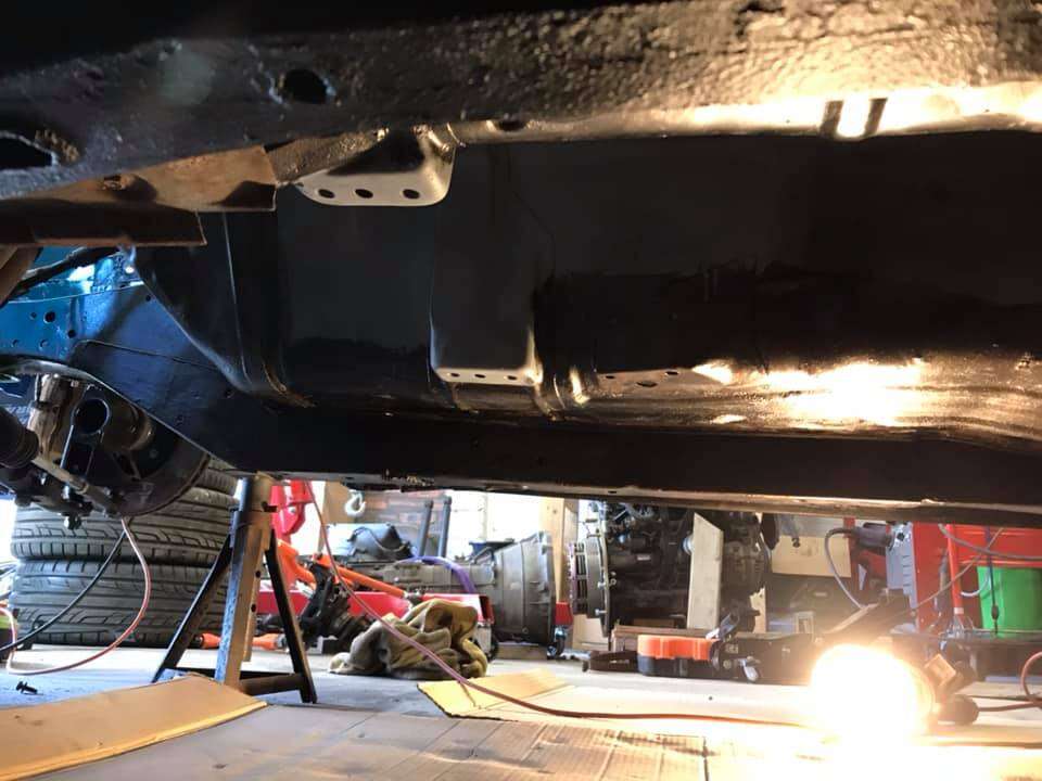

evilscorp Posted May 27, 2020 Author Share Posted May 27, 2020 wire wheeled the underside, worst job ever. Used hammerite anti rust, then zink primer x2 coats then waxoil. 1 Quote Link to comment Share on other sites More sharing options...

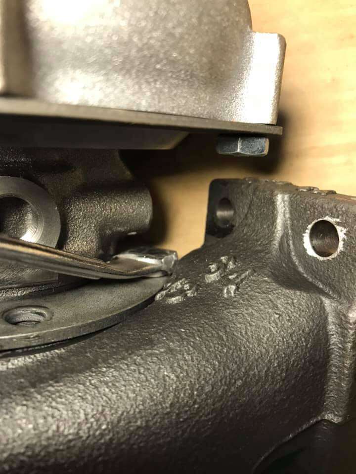

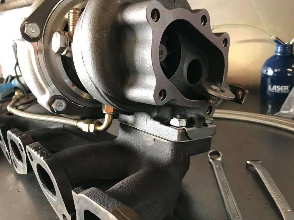

evilscorp Posted May 27, 2020 Author Share Posted May 27, 2020 Garrett don't make it easy to rotate the exhaust housing. neither is removing the old exhaust studs. 1 Quote Link to comment Share on other sites More sharing options...

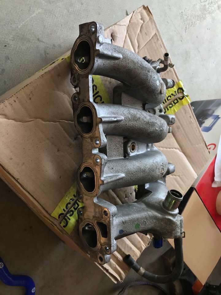

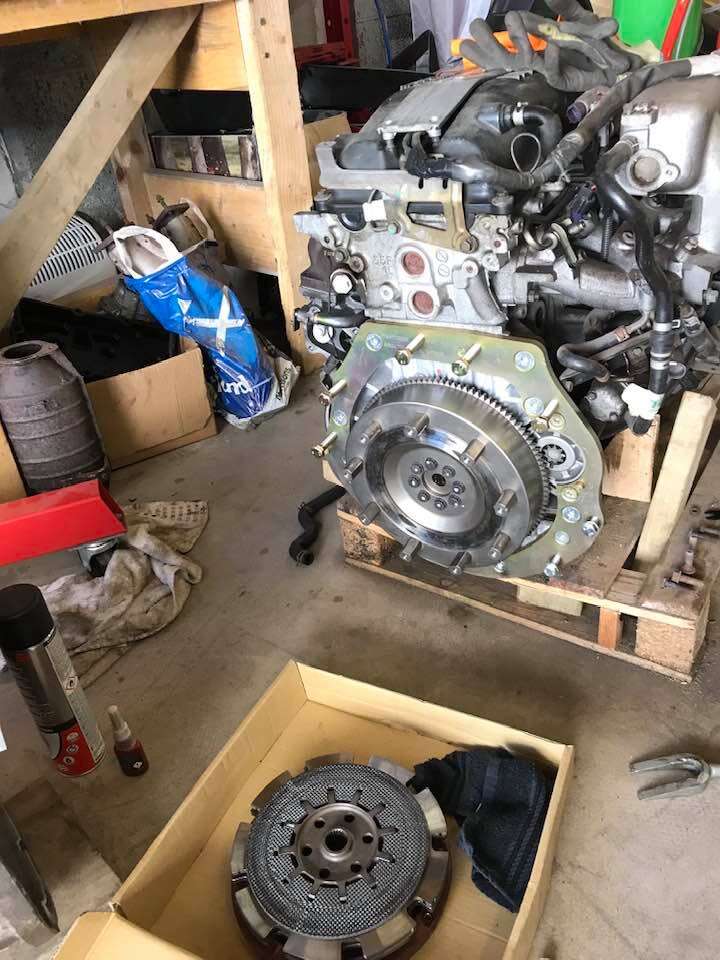

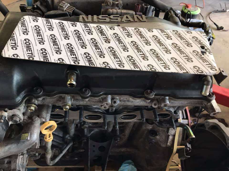

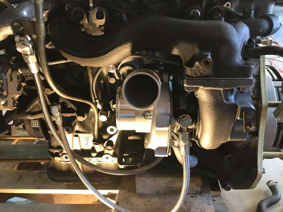

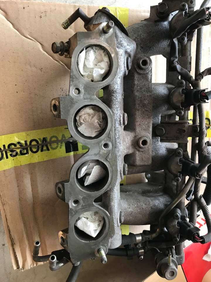

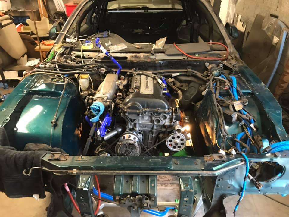

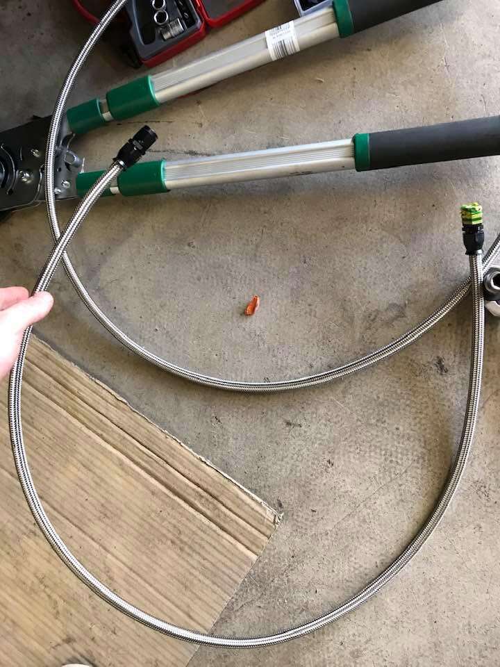

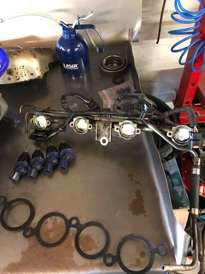

evilscorp Posted June 2, 2020 Author Share Posted June 2, 2020 Made some -6 An fuel lines and mounted my filter, might make a shield to protect it some more,(used my new heavy duty garden shears for this and only this lol) cleaned and torqued the flywheel and twin plate clutch, Tried to swap the heater hoses at the firewall and bought a hose kit which had every hose under the sun, (bar those ones) started to fit them and realized i would need to take off the inlet manifold... then clean it... and remove the old injectors after their screws rounded. Got nismo 555cc to go in. The oil and water line kit for the turbo is a bit long, wish I had made my own, but I think ive managed to route it of so it wont grind off stuff. 2 Quote Link to comment Share on other sites More sharing options...

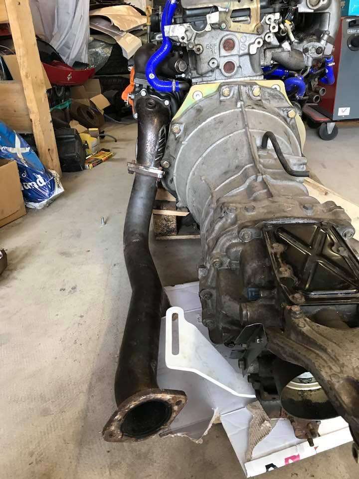

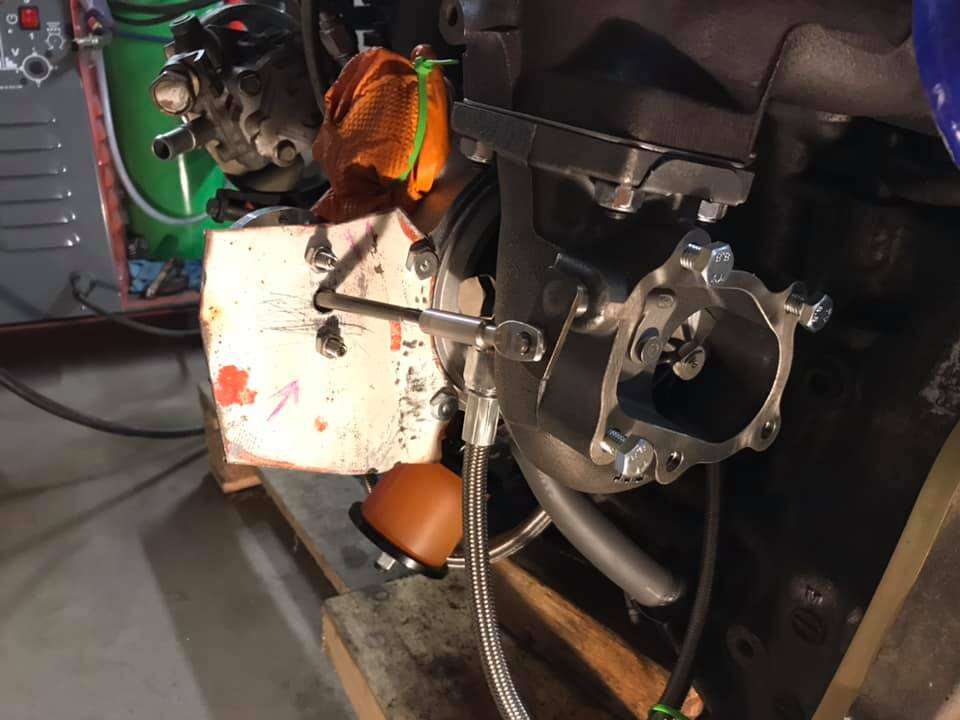

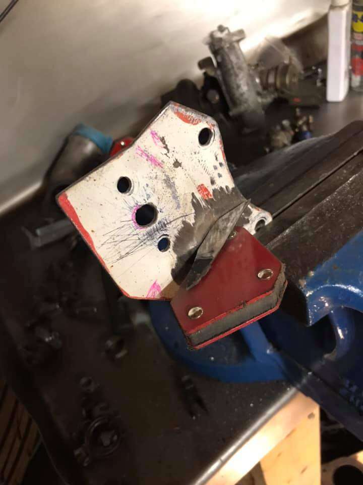

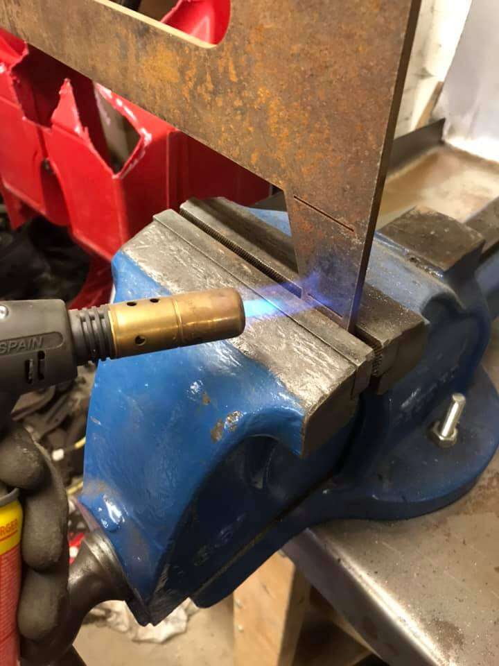

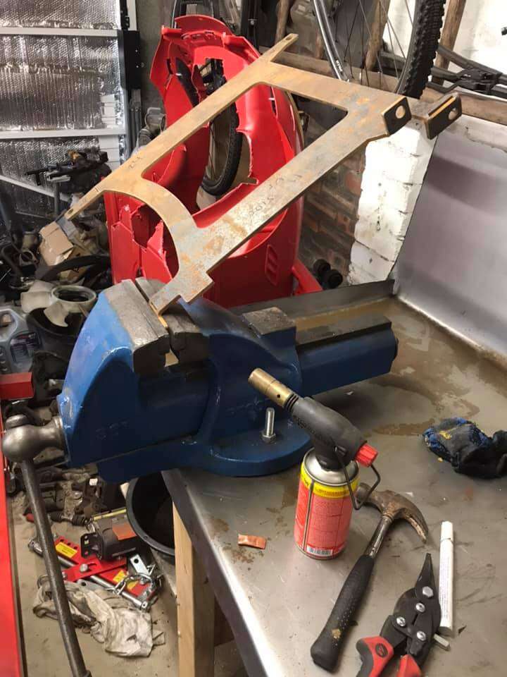

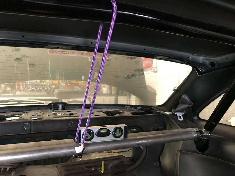

evilscorp Posted July 29, 2020 Author Share Posted July 29, 2020 Few updates. custom wastegate bracket made, new coolant hoses,larger injectors, custom harness bar (I may do more to make it even more safe for my own piece of mind, wanted it removable for rear seat use if needed.) My custom shifter bracket is still too long so had to buy the gktech one, just need to fit it. The stupid gearbox mount doesn't line up and is too far back for the front two bolts so need to modify the rubber mount to move it forward if i can as I don't fancy just two bolts holding it up. 1 Quote Link to comment Share on other sites More sharing options...
