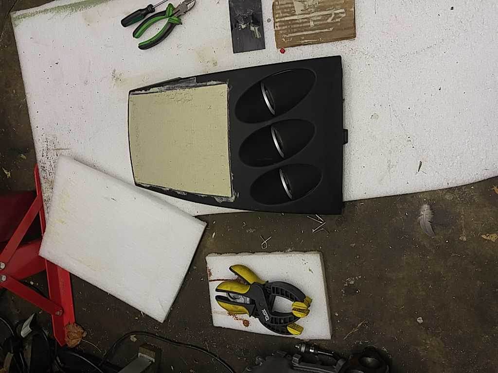

andybp Posted September 10, 2017 Share Posted September 10, 2017 So I've been planning this for some time but have been keeping my eye out for a cheap centre console rather than butcher mine but I'm just not willing to pay stupid money for a bit of plastic but being a bit bored today because of the rain I decided to just get on with it. so what do you get if you mix these items with fibreglass and body filler ? hopefully something not too embarassing to show. as you can see I've already removed the back cover to gain access to the power and volume buttons so I can put in external ones only started this an hour ago so I haven't achieved an awful lot yet. 1 Quote Link to comment Share on other sites More sharing options...

andybp Posted September 10, 2017 Author Share Posted September 10, 2017 A couple of things I forgot the tablet is a windows 10 10 inch with a dual core processor nothing special and I'm hoping to use the steering wheel controls for volume and power button and obviously I lied about the ironing, I'm a man god damn it.. 1 Quote Link to comment Share on other sites More sharing options...

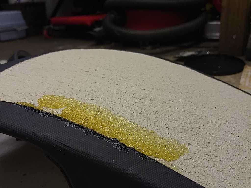

andybp Posted September 16, 2017 Author Share Posted September 16, 2017 been on standby so haven't got too much done on this but here's a few pictures for you. Quote Link to comment Share on other sites More sharing options...
andybp Posted September 24, 2017 Author Share Posted September 24, 2017 filling is pretty much done I have machined a recess in the back for the tablet to sit into just finishing and painting to do now 1 Quote Link to comment Share on other sites More sharing options...
