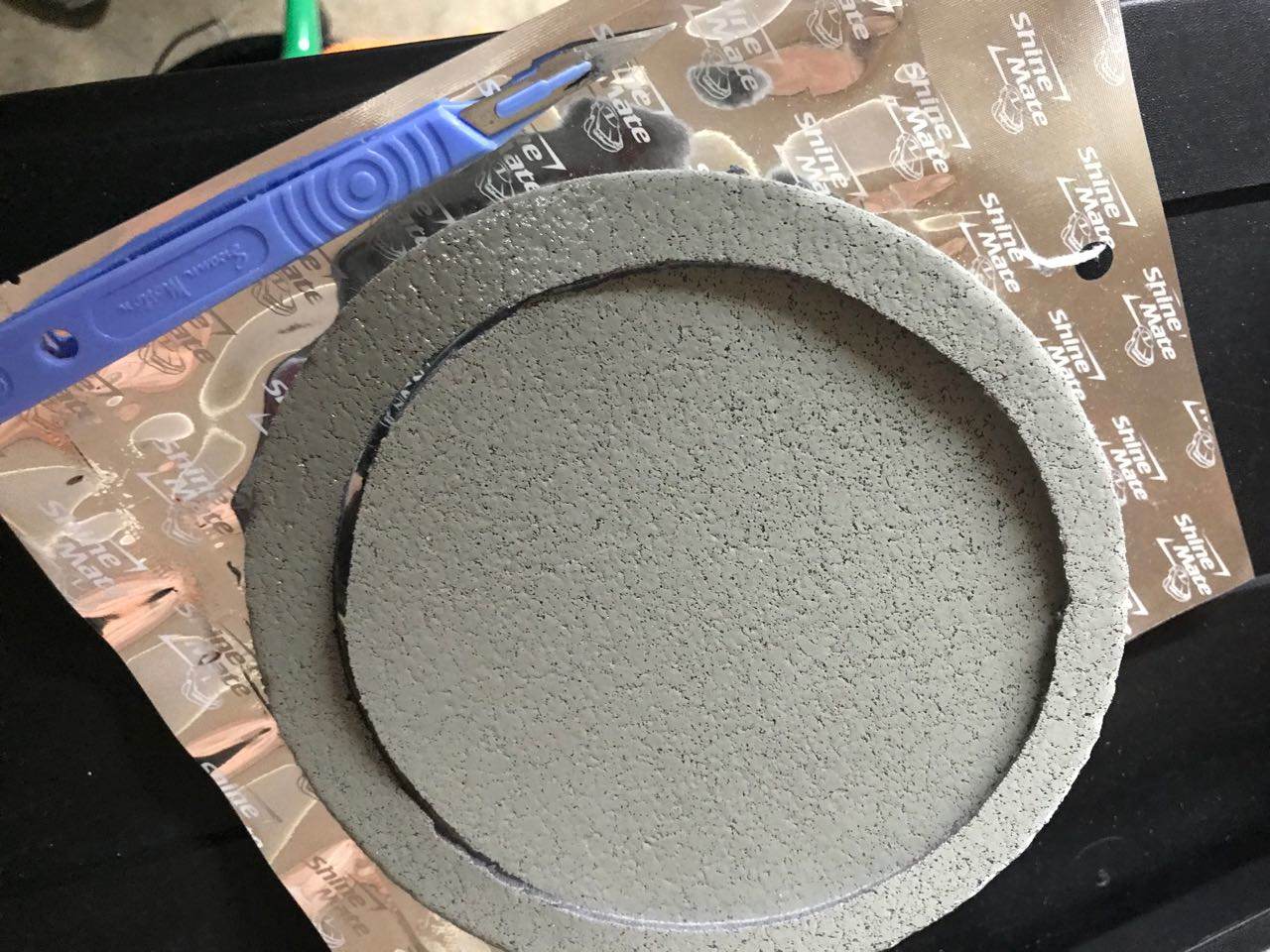

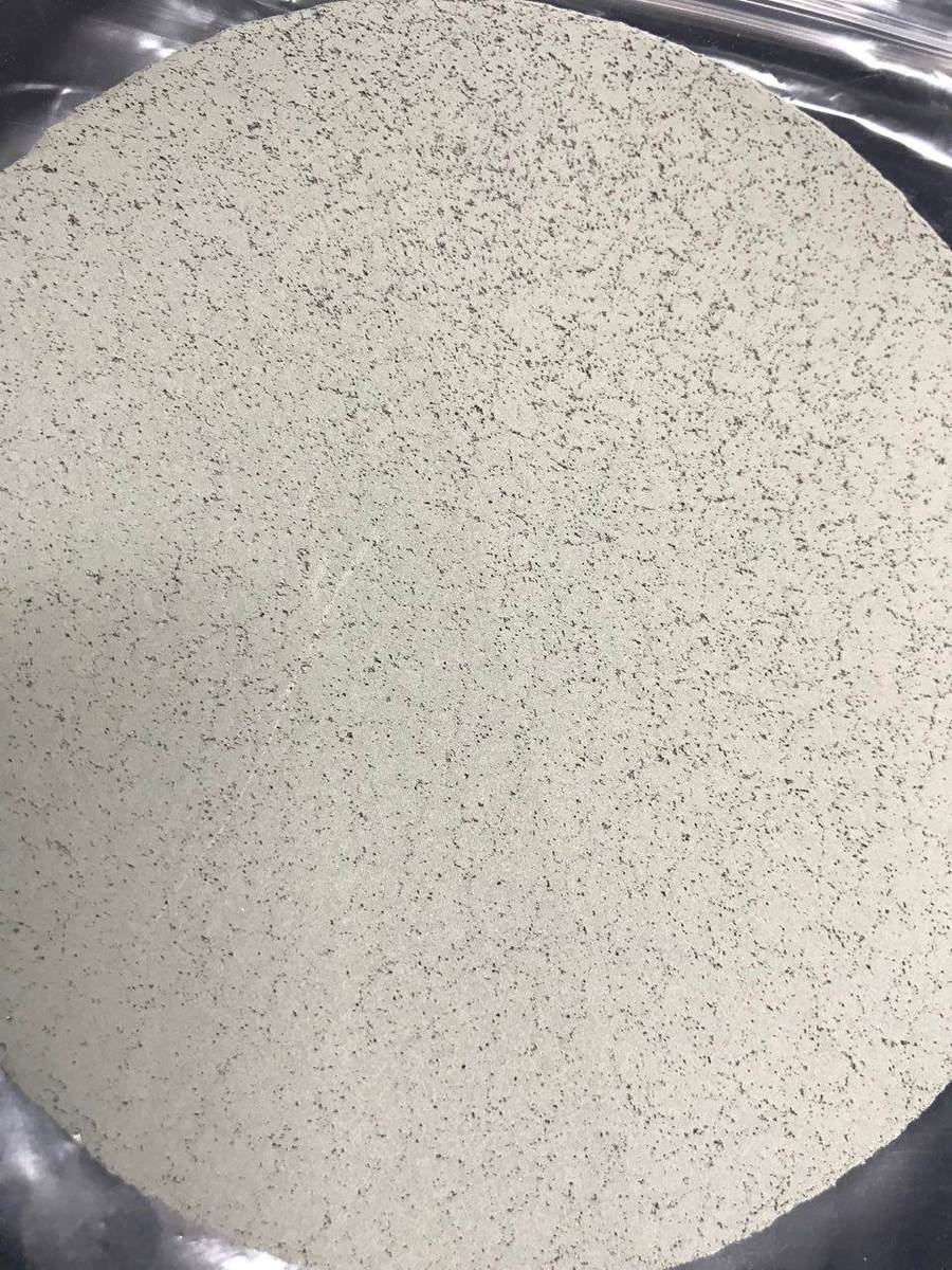

The 3000 grit 3M pads arrived and look like this and felt like a sort of nice leather.
After giving the bonnet a going over with it, I found I had a slightly less dull finish and much more even sanding pattern. There's not much in the way of instruction on the packet, so I tried number 6 and a lot of pressure (see below damage) and then number 3 and next to no pressure, nothing really felt perfect - as you can see from the image below.

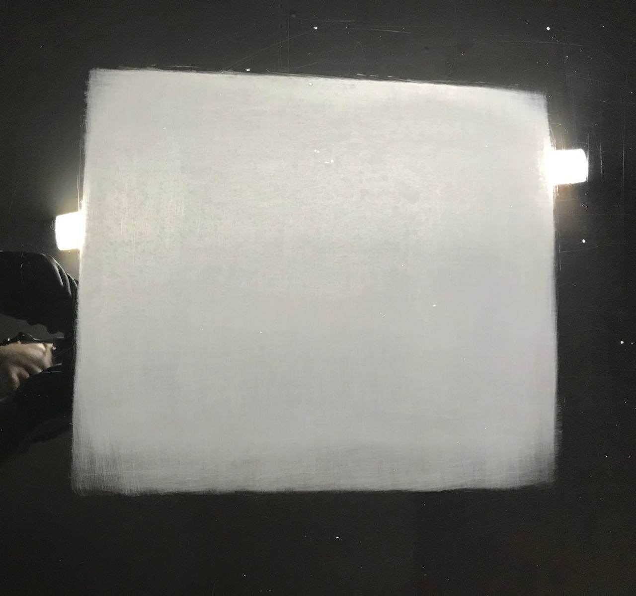

Nice uniform dullness.

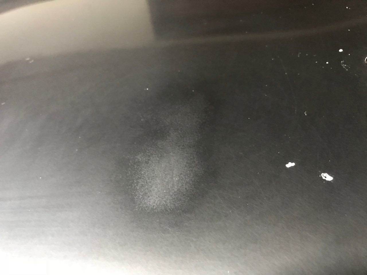

I started to think that hand sanding the 1200 grit wasn't such a swell idea, the machine does a much better job. Well except where I crank it up to 6 and lean on it.
Whoops.

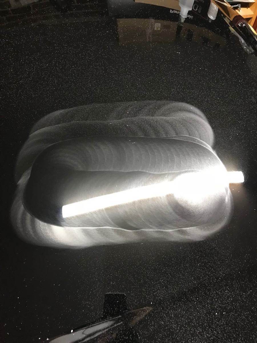

After wiping the clear coat/water slurry spray off my hoodie, I eased down and gave the MF cutting pad another spin with 105. Yeah, I still don't like the 5" MF pads, so I switched to the god old 3" foam pad. Which left me with this.
Plus a number of deeper scratches that I thought had been sanded away, but it turns out, hadn't, or, perhaps may have even been introduced by me and the shambolic hand sanding phase. Tomorrow should bring more 105 and polishing pad fun.

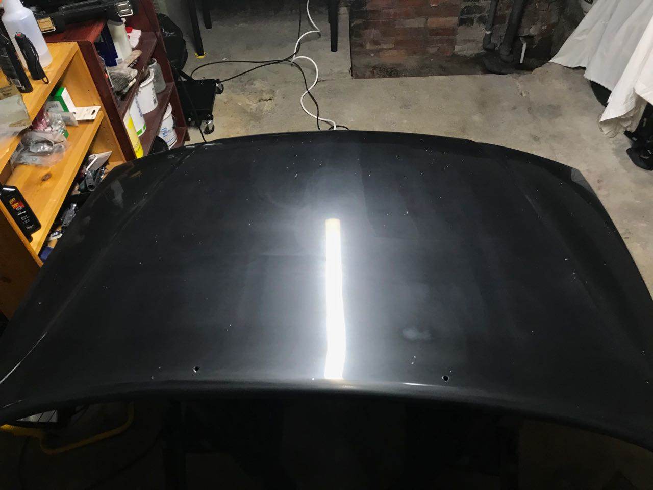

After giving the bonnet a full third stage (105 on a polishing pad) of a projected 4 stages, I was hoping the dull 3000 grit sanding marks would transform into a gloss surface, ready for a final 4th stage of Menz SF on a finessing pad to make a mirror surface. Well, you know what they say about best laid plans...

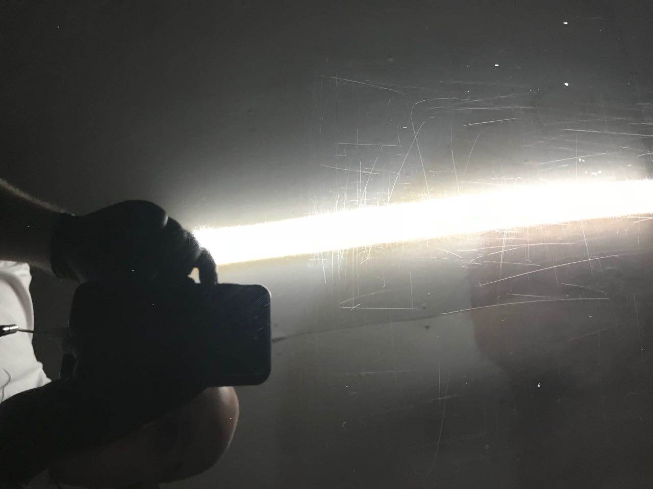

Stage 3 left me with some nice gloss (as hoped for) and some rather unsavoury deep scratches (not hoped for). Many of these deep scratches I know weren't there before I started, they came during the 1200 grit hand sanding stage.

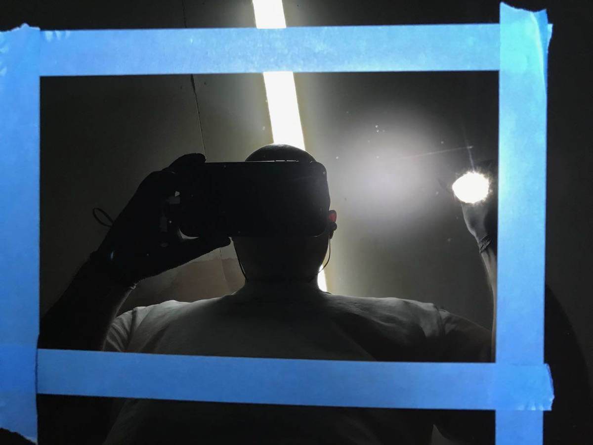

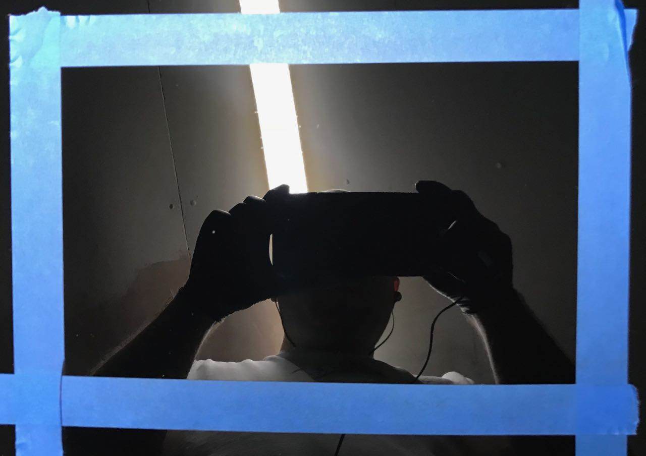

Somewhat disappointed, but not disheartened (who gets it right first time?) I decided to isolate these and have another go at them. So I taped up and went in again with the 1200 grit by hand, leaving me a nice dull square.

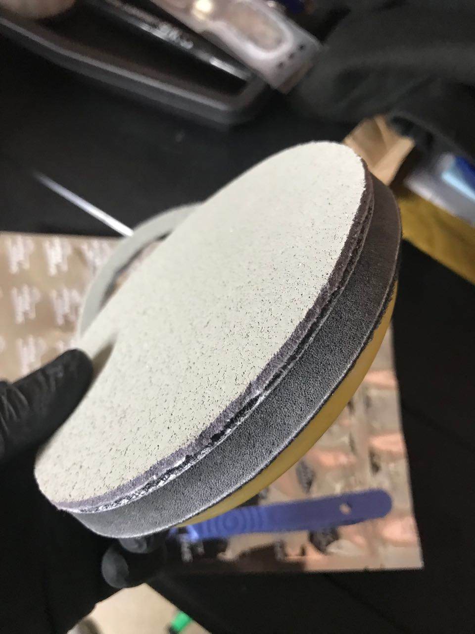

I'd chucked out the first 3000 grit sanding pad, having ripped it on a edge, so I had to do some surgery on my remaining one.
Making it more or less fit the interface pad.

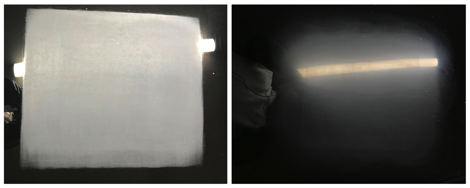

Before (1200) on the left and after (3000) on the right. Since playing with the 3000 grit pads last time I'd read that when using them on a sander a typical speed might be 1200rpm, which I'e been way over, so this time I slowed it down and reduced the pressure. This worked better.
It goes without saying that it's night and day between the two, the strip light can be clearly seen on the right but is lost on the left. It's amazing how the paint can be brought back from this kind of damage, not once, but twice. I'd love to have had a Paint Depth Gauge to know how much was coming off at each stage.

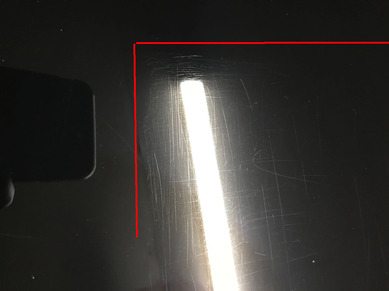

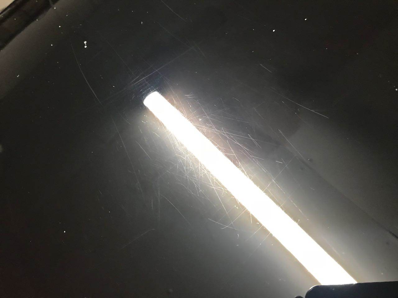

Sadly, after moving on to one pass at stage 3, the deep scratches will still present. You can clearly see below the well defined corner where the masking was for the hand sanding. I could have gone back to the 3000 grit for more goes, but I wanted to see what the 105 could do if pushed.
