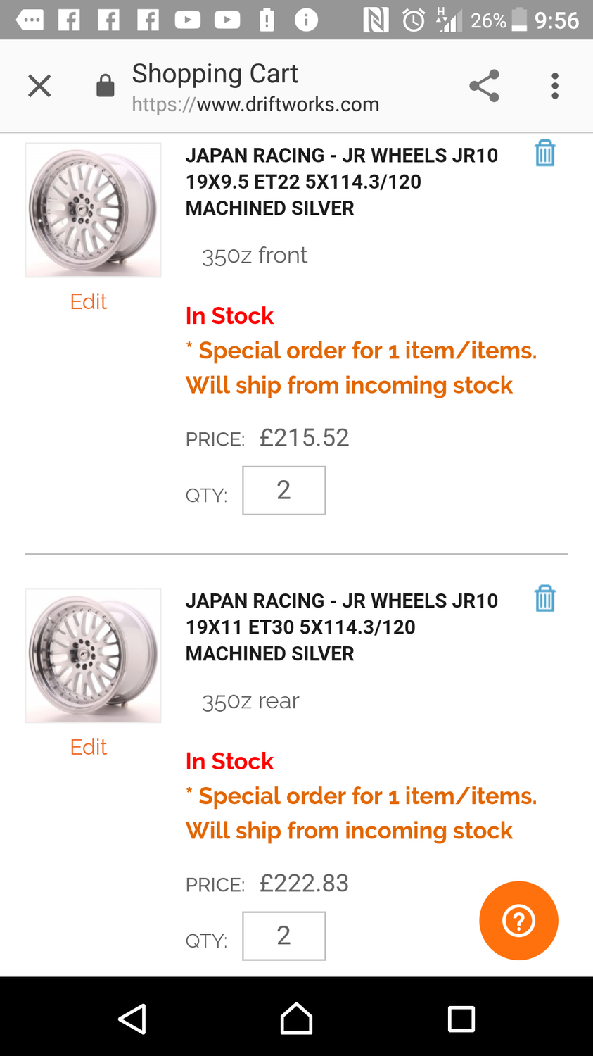

Z33man Posted August 21, 2017 Share Posted August 21, 2017 Hello, first post here! Not long got my Zed (350) and loving most things about it! I am looking to change out my stock rays for something a but more dishy and aggressive but without having to mess with the car too much, I seen these wheels on driftworks and was wondering if anyone here is running the same setup to know about clearances etc. It has the brembo brakes and is lowered on eibach springs. I apologise if this had been covered loads but wheels seems a minefield! Cheers! Quote Link to comment Share on other sites More sharing options...

Tarmac@TarmacSportz Posted August 21, 2017 Share Posted August 21, 2017 You really want ET15 on the rears We supplied Marks, can do them a bit cheaper than DW too plus the front requires a 5mm shim spacer to clear brembos that we can supply FOC Chris Quote Link to comment Share on other sites More sharing options...
Z33man Posted August 21, 2017 Author Share Posted August 21, 2017 Would et15 give it more of a dish/ move it closer to the arch? Would I get away without rolling my arches do you think? Cheers! Quote Link to comment Share on other sites More sharing options...
Z33man Posted August 21, 2017 Author Share Posted August 21, 2017 5 hours ago, Tarmac@TarmacSportz said: You really want ET15 on the rears We supplied Marks, can do them a bit cheaper than DW too plus the front requires a 5mm shim spacer to clear brembos that we can supply FOC Chris Would et15 give it more of a dish/ move it closer to the arch? Would I get away without rolling my arches do you think? Cheers! Quote Link to comment Share on other sites More sharing options...
Tarmac@TarmacSportz Posted August 22, 2017 Share Posted August 22, 2017 15 hours ago, Z33man said: Would et15 give it more of a dish/ move it closer to the arch? Would I get away without rolling my arches do you think? Cheers! ET15 Will move it closer to the arch yes, not really going to affect the dish Re arches - Depends on if you are lowered or not and what tyres size you choose 1 Quote Link to comment Share on other sites More sharing options...
