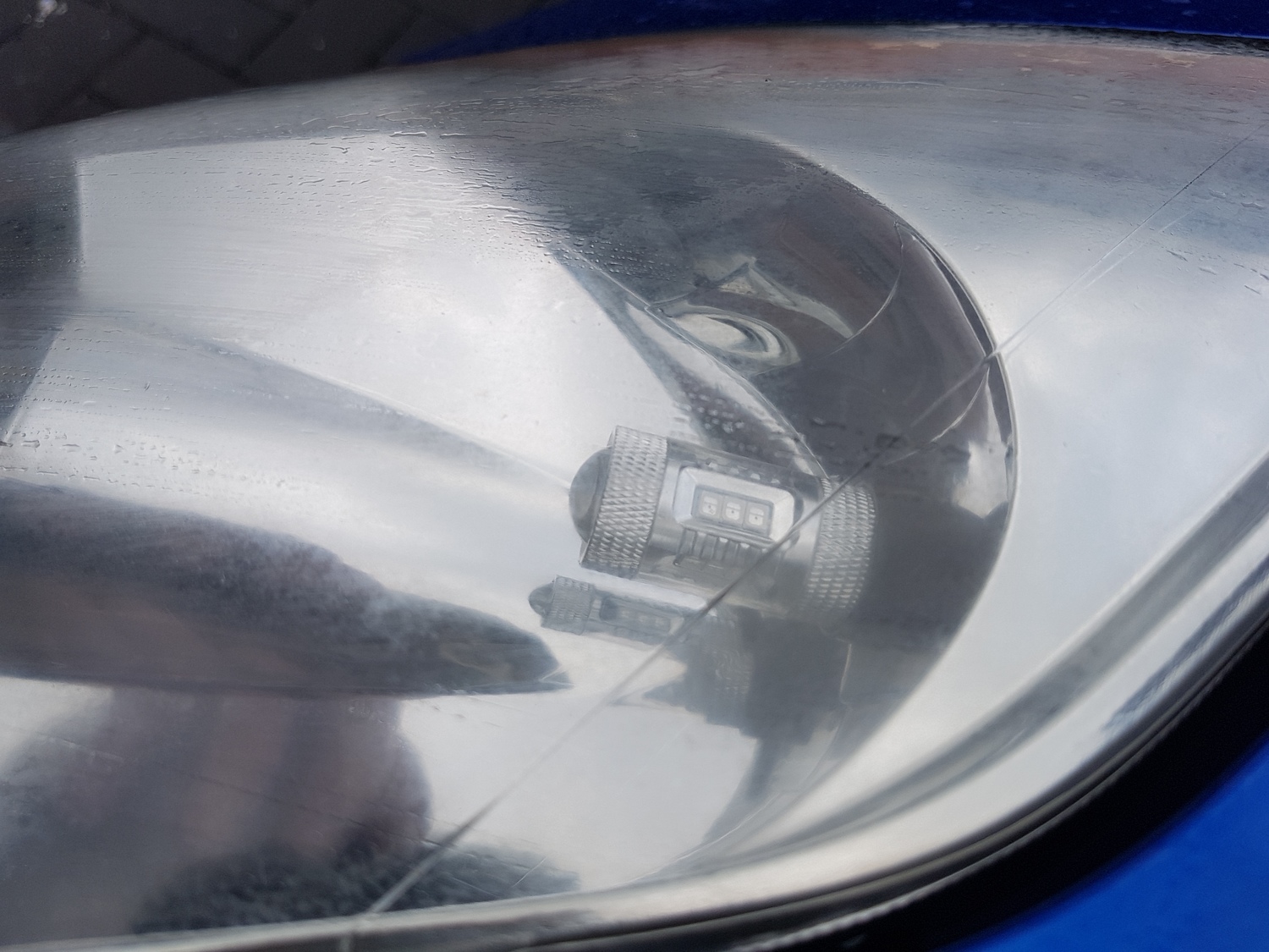

Auckies Posted August 17, 2017 Share Posted August 17, 2017 Just fitted switchback DRL's, where the reflector goes on the front bumper, they stick out more than expected. What a pain, front bumper off and rewire. Problem is there are no Acc points under the bonnet, got a box of magic that connects to the battery which controls the lights and they stay on until voltage drops when ignition switched off. Also fitted led projector indicator bulbs. Caution_ headlamps out because of the length of the bulbs. Major job if they blow, there is no room for access. Quote Link to comment Share on other sites More sharing options...
Erni902 Posted August 17, 2017 Share Posted August 17, 2017 Got these exact same LED indicators and they are a massive improvement. Looks good man, but yes it was a huge PITA to fit as the headlights need to come out like you say. Worth it though and its been nearly a year that mine have been in and had no dramas. Quote Link to comment Share on other sites More sharing options...

Erni902 Posted August 18, 2017 Share Posted August 18, 2017 1 hour ago, Olly350z said: Slightly confused by this and gping to show my electrical lack of knowledge! Arnt these just LED bulbs? What makes them Day time running lights? He has done 2 mods here. 1st is the reflectors on the front bumper, he has changed these to DRL's but the picture that has been uploaded is not showing correctly. The 2nd mod is the LED indicator bulb which is the only picture we can see. Quote Link to comment Share on other sites More sharing options...
