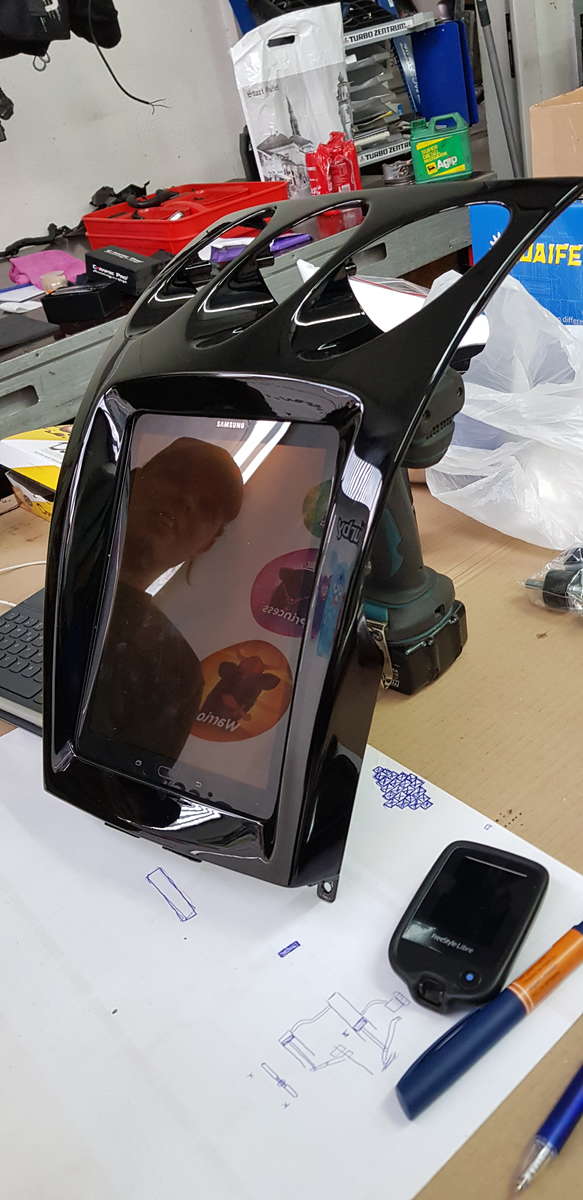

SmoggyPauly Posted October 2, 2017 Author Share Posted October 2, 2017 9 hours ago, ZeppoJeff said: Looks cool...can’t wait to get mine started now. Just got it all sitting in the spare room waiting to go in with a full audio install. Good luck with it all - would love to see some pictures etc when you get started One thing that can be problematic is the lack of access to hardware buttons. This has reared itself a couple of times so far: I accidentally left an app open and drained the battery over a weekend. It charged back up ok once driving again but of course, without access to the hardware buttons, I couldn't boot it back up and had to remove it to restart. My tablet froze. Again, I had to remove to restart. Just this morning, my tablet has decided not to recognise the memory card that stores all my music. A restart might help but again, I need to remove it to check. Because of this, I'm thinking of a possible mod that involves drilling a small hole in the side that I can insert a thin rod into that lines up exactly with the on/off button. I could somehow spring load this and size it so it fits the hole perfectly and stands just proud so it could be reset/turned on at any time. All these issues are worth it though in my eyes - love the look of it and gives the Z a little something different Quote Link to comment Share on other sites More sharing options...

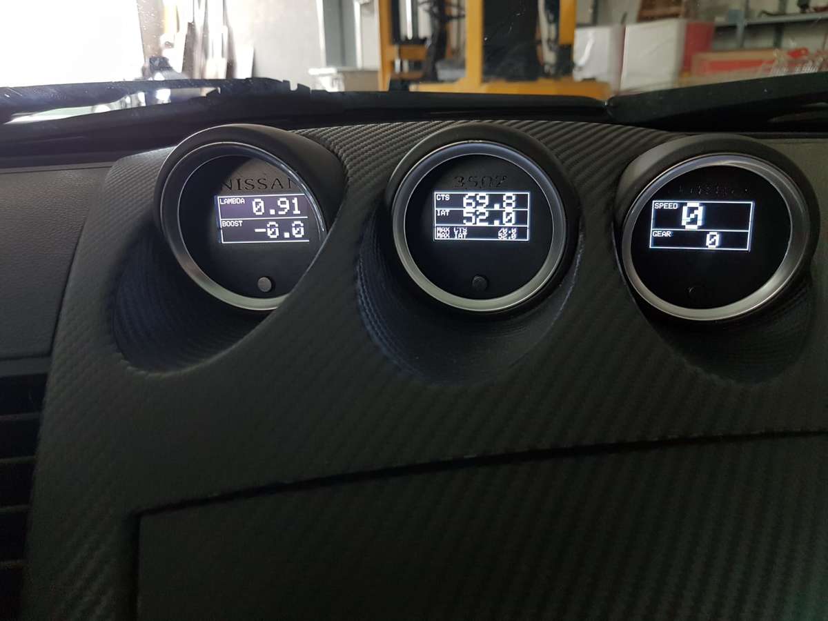

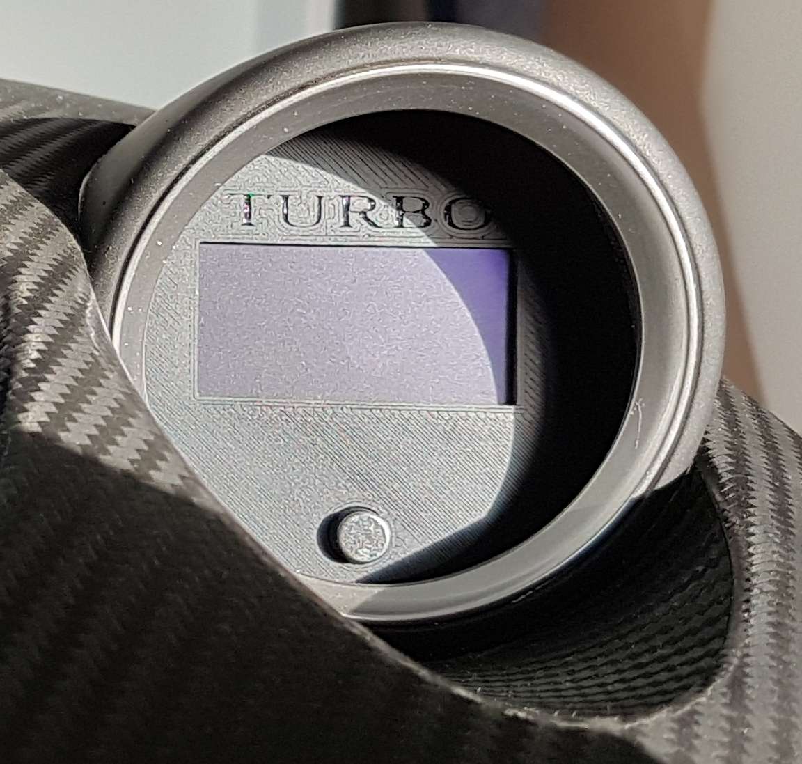

mrle Posted June 6, 2018 Share Posted June 6, 2018 (edited) I dont like brainiac tab mount because you can not take out the tab. In my case slide up , push the upper part inside and its out. If you go with 12" then measure it from all sites. I think its too big. You will lose the shapes of oem plastic. My first idea was to run gauges on the tab. My car is a fully build tt so i needed to see things like oil temp...now I have the haltech ecu. A friend of mine has made custom gauges that will replace the oem. Its connected to haltech via hub and every display has many mods. Ill post some pics. Edited June 6, 2018 by mrle 1 Quote Link to comment Share on other sites More sharing options...
