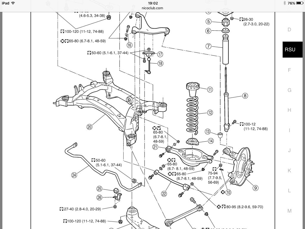

Dicky Posted August 14, 2017 Share Posted August 14, 2017 Apparently the offside rear suspension component "Front Lower Link" item 22 in attached diagram is apparently "severely bent" The attached diagram seems to indicate that its supposed to be bent. Can anyone confirm if it does have a bend in it and if any of the forum traders can supply one? Quote Link to comment Share on other sites More sharing options...
gsexr Posted August 14, 2017 Share Posted August 14, 2017 Do both sides of the car look the same or is one bent more than the other ? 1 Quote Link to comment Share on other sites More sharing options...
SHEZZA Posted August 14, 2017 Share Posted August 14, 2017 There meant to be bent dicky, though if one is more bent than the other I'm guessing there right. 1 Quote Link to comment Share on other sites More sharing options...
G1en Posted August 14, 2017 Share Posted August 14, 2017 That to me is the camber arm. I have eibach adj arms and they are straight although the oem ones and many others do have a slight bend in as the guys say. If it is severly bent your camber and toe may well be way out as well. Just compare it to the other side. 1 Quote Link to comment Share on other sites More sharing options...
Dicky Posted August 14, 2017 Author Share Posted August 14, 2017 The near side rear does have a slight bend in it while the offside (fail side) one appears to be bent more. Can't think how it can have happened other than careless garage mechanics because I know I would never jack the car up there. Given the bar is quite thick (poss 15mm dia or so) I can't imagine I could have ran over anything either without hearing it. Must have been a mentally challenged mechanic then? Tryed a breaker bar on the badly rusted bolts but chickened out when it wouldn't give , so will let the garage have this one to do me thinks! Does Tarmac/ other supply these ? Quote Link to comment Share on other sites More sharing options...
G1en Posted August 14, 2017 Share Posted August 14, 2017 Lots of traders on here will have new oem or aftermarket options. Tarmac sports, cougar store, clark motorsport, torqen etc.. If you are planning on lowering in the future you may as well get adjustable arms, if not then standard is fine. Zmanalex will prob have new or used available so plenty of options. 2 Quote Link to comment Share on other sites More sharing options...
