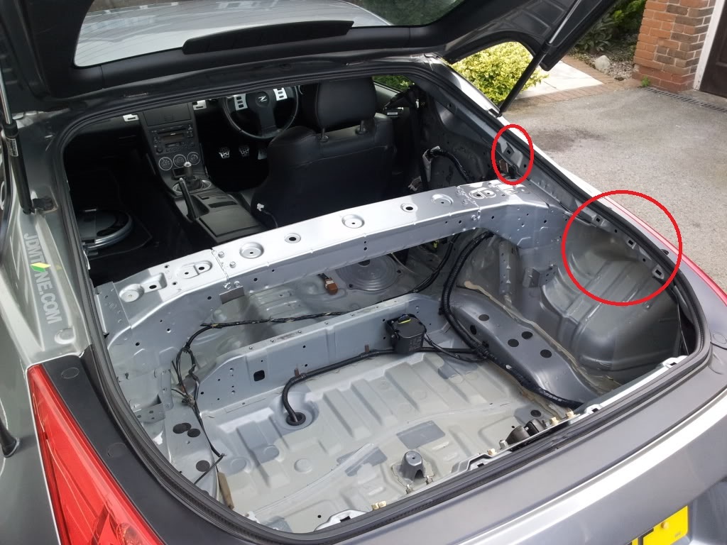

Colin747 Posted August 22, 2017 Author Share Posted August 22, 2017 The only reason I ask is when I was getting work done at a bodyshop they seemed to be under the impression that if you strip the boot out there would be some sort of access there which you could spray the waxoil through, but looking at this photo of a stripped boot I can't figure out if there actually is. Quote Link to comment Share on other sites More sharing options...
Willsy1980 Posted August 22, 2017 Share Posted August 22, 2017 If you remove the rear light clusters and fire a load in through the holes circled, it 'should' run down quite a bit. But you will need to dump loads in and just hope for the best. 1 Quote Link to comment Share on other sites More sharing options...
Colin747 Posted August 22, 2017 Author Share Posted August 22, 2017 (edited) Many thanks for your help! Do the rear lights need removed or do you just need access to those rectangle holes circled? Edited August 22, 2017 by Colin747 Quote Link to comment Share on other sites More sharing options...
Willsy1980 Posted August 23, 2017 Share Posted August 23, 2017 Id pop them out, there are a few additional holes you can attack from. I'd probably just remove the lights to start, there are some holes the locating pegs go in, remove the little bungs and fire it in there. These are not 100% for getting waxoil down all the way, but better than randomly drilling holes everywhere. That could lead to more issues than what you are trying to prevent if im honest. 1 Quote Link to comment Share on other sites More sharing options...
Colin747 Posted August 23, 2017 Author Share Posted August 23, 2017 That's great, many thanks for your help. The can I have at least has a long 8" nozzle on the end so hopefully that'll be of some help. Quote Link to comment Share on other sites More sharing options...
Willsy1980 Posted August 23, 2017 Share Posted August 23, 2017 No worries, just any hole you can find near by, if the nozzle will fit, shove it in and spray is the best approach. Same for the car and waxoil 1 Quote Link to comment Share on other sites More sharing options...
