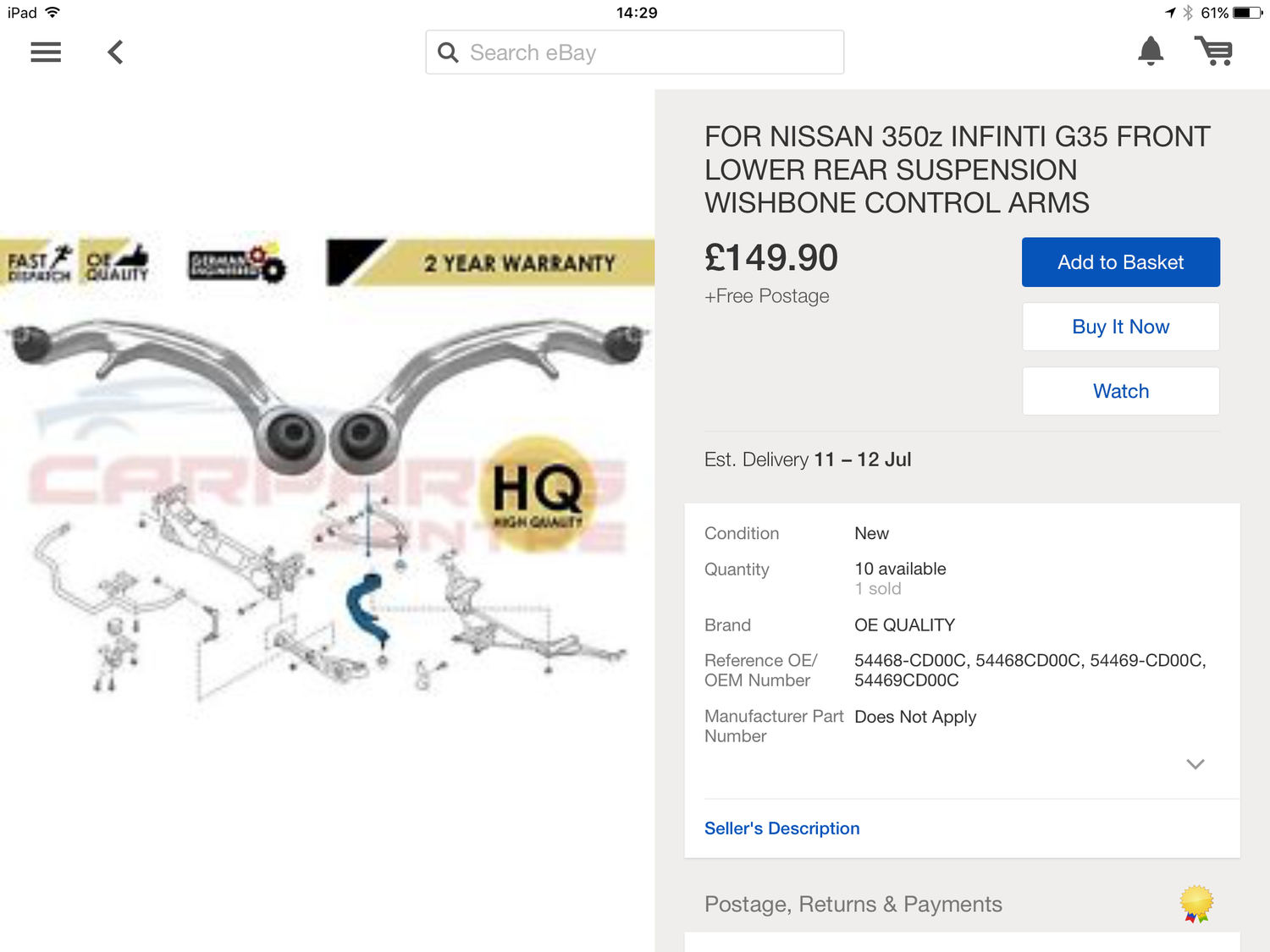

Kev Posted July 7, 2017 Author Share Posted July 7, 2017 2 minutes ago, MDMetal said: My ball joints weren't great either once I'd got the old ones off so was glad to have swapped the whole lot The rubber boot is starting to let dirt etc in by this age usually. As Adrian says the bushes mean you'll need to take the old arms off, press the bushes and refit. If the garage is doing it all then it might be cheaper but i'd guess its around 2-3 hours labour so the different between paying the garage vs swapping it all yourself isn't great tbh. I just object to paying people to do jobs I can do myself for a lot less, but that's mainly so I can give Adrian and Alex more of my money I'm going to replace the arms I think. Ball joints can't be in great condition after 12 years. Everytime I think of a new exhaust something expensive crops up. Which brand and did you go with? Are these eBay specials awful? Quote Link to comment Share on other sites More sharing options...
MDMetal Posted July 7, 2017 Share Posted July 7, 2017 Not sure what brand thoseare tbh. I got Dorman from Adrian above, or for £10 more each arm you can get Moog not sure what the difference is, both are OEM replacements I understand. 1 Quote Link to comment Share on other sites More sharing options...
Kev Posted July 7, 2017 Author Share Posted July 7, 2017 I was just looking at the dorman ones on Adrian's site. The ebay ones seem to good to be true at that price. Quote Link to comment Share on other sites More sharing options...

Kev Posted July 10, 2017 Author Share Posted July 10, 2017 4 hours ago, MDMetal said: The nissan ones are 250 vs 150 arent they? (Each!) If your still not 100% the OEM replacements are just as good, good luck either way They are. Not as bad as the £370 a side Nissan are asking. Im sure the replacement parts are good but the garage who are fitting them say they are hit and miss with regard to fitment. Knowing my luck I'd get a bad pair. One seller on here has moog arms for £125 which is tempting. Quote Link to comment Share on other sites More sharing options...
Adrian@TORQEN Posted July 10, 2017 Share Posted July 10, 2017 Kev, we sold hundreds of Dorman and Moog banana arms, both having excellent history behind the brand. They are not cheap knockoffs from eBay, they are OEM quality products. They are 300% perfect fit. There is no such thing as bad pair, these products are going to fit perfectly every time! 1 Quote Link to comment Share on other sites More sharing options...
MDMetal Posted July 10, 2017 Share Posted July 10, 2017 Up to you what you want to do but I'll echo Adrian above I fitted mine perfectly and didn't need any realigning at all just slipped them on and off perfectly. Most of the OEm stuff with Nissan is always more expensive than solid aftermarket products and for most things there's little need to pay that extra. 1 Quote Link to comment Share on other sites More sharing options...
Kev Posted July 10, 2017 Author Share Posted July 10, 2017 (edited) 35 minutes ago, Adrian@TORQEN said: Kev, we sold hundreds of Dorman and Moog banana arms, both having excellent history behind the brand. They are not cheap knockoffs from eBay, they are OEM quality products. They are 300% perfect fit. There is no such thing as bad pair, these products are going to fit perfectly every time! 31 minutes ago, MDMetal said: Up to you what you want to do but I'll echo Adrian above I fitted mine perfectly and didn't need any realigning at all just slipped them on and off perfectly. Most of the OEm stuff with Nissan is always more expensive than solid aftermarket products and for most things there's little need to pay that extra. I agree with both of you if I'm honest. Its the garage that are moaning about non Nissan parts. They insist the ball joints are not as good and they're a struggle to fit. I won't use them again. I'm not impressed at all. They think the w brace is the subframe! Im thinking if I use copy parts they will use it as a excuse for a couple of extra hours labour. And I don't want to give them any excuses. I would give them a piece of my mind and tell them what I think, but my uncle uses them a lot for his civic. He's friendly with the owner so I'm biting my tongue. I'm calling Lockwood and greenwood and taking it there. They're not too far away and have a good reputation on here. I cant find a used w brace anywhere and the ultra racing ones have a 5 week lead time. Is is it dangerous to run without a w brace for a few weeks? I wouldn't want to cause any damage to my car. Edited July 10, 2017 by Kev Quote Link to comment Share on other sites More sharing options...
