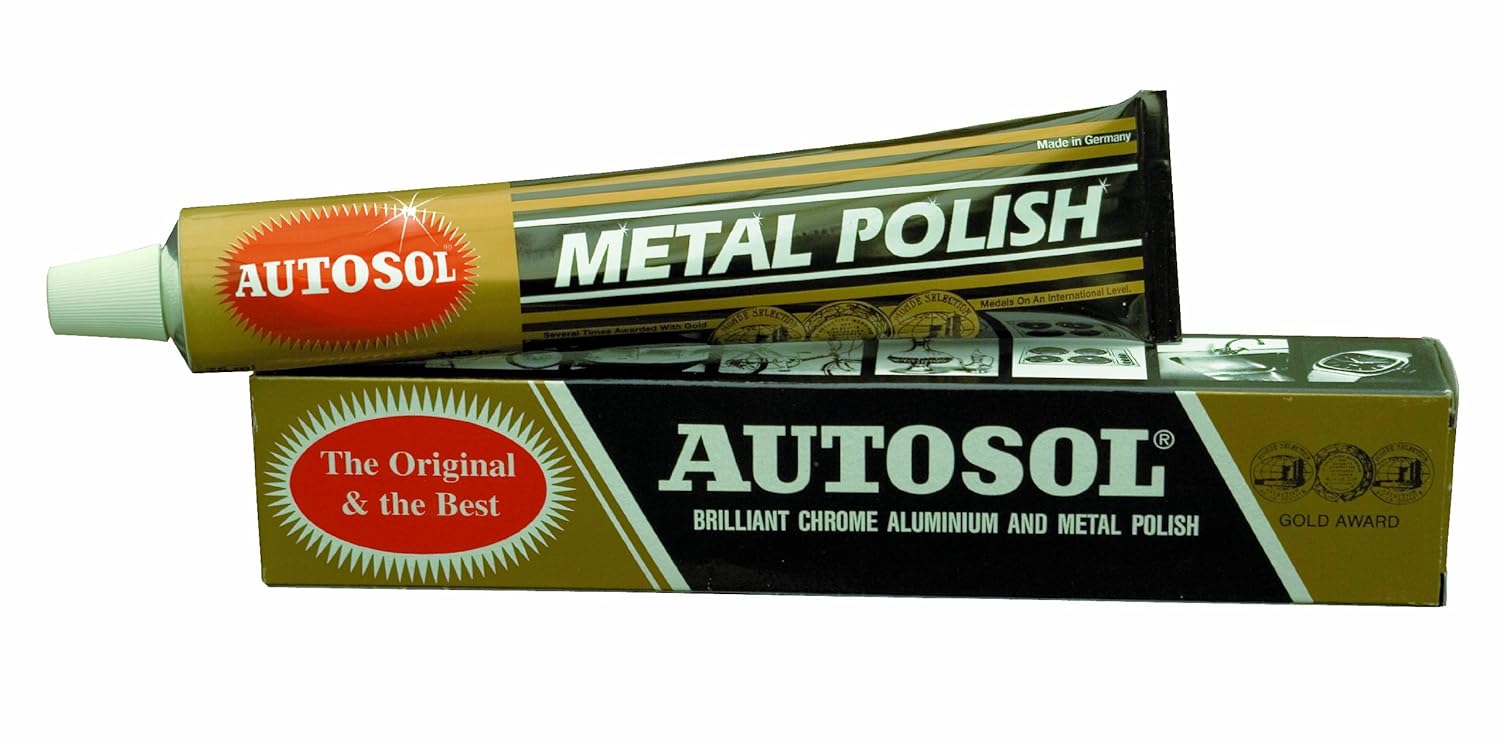

GMballistic Posted June 6, 2017 Share Posted June 6, 2017 For light oxidation I used to use a tube of metal polish, tried loads over a period of time, although some give a cloudy finish post polish. There was one (and I'm really not being helpful here) was amazing, great polish and no clouding, but cannot for the life of me remember which one it was. Although, once you have a clean and polished plenum, you must use carnauba based wax. Forget anything other than carnauba! "Autosol"? 1 Quote Link to comment Share on other sites More sharing options...
Zeezeebaba Posted June 6, 2017 Share Posted June 6, 2017 I use Autosol and a damp kitchen sponge which needs to be continually rinsed whilst doing the job. Interesting reading about different ideas for sealing the finish though. 1 Quote Link to comment Share on other sites More sharing options...
Wasso Posted June 6, 2017 Share Posted June 6, 2017 Nah not the obvious Autosol believe or not, aggressive! It was a grey cream, I'll hunt it down. Quote Link to comment Share on other sites More sharing options...
