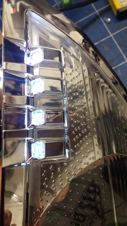

cob1980 Posted June 7, 2017 Author Share Posted June 7, 2017 (edited) First mod done, ordered white LEDs off ebay to replace the amber ones. Cost £1.89 for 20 and only took 15 mins to fit. Edited July 8, 2017 by cob1980 Images 4 Quote Link to comment Share on other sites More sharing options...

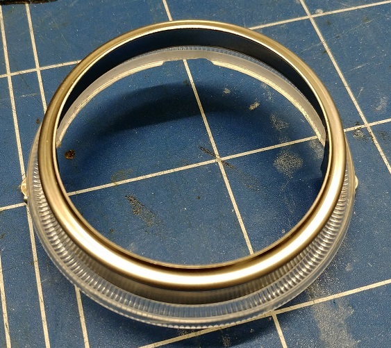

cob1980 Posted August 24, 2017 Author Share Posted August 24, 2017 (edited) 20 hours ago, P15UL T said: Looking great 13 hours ago, scobie140 said: These look great. No matter how many times I read about putting their lights in the oven and it working i'd still be bricking it to do it myself Can't wait to see them finished Thanks chaps. Haha... yep they are a little expensive to replace if you melt them! A little more of an update... I'm not a big fan of having the halo on the outside of the projector housing so wondered if it were possible to put them on the inside of the housing as there is a small gap. I bought a pair of 90mm CCFL halos, these were are fraction too small for the projector. A hour or so of filing later I got one to fit. The good thing with putting them on the inside is that they will illuminate the opaque part. I plan on wiring these up to the side lights. I think the effect looks pretty good. Not as bright as a full on halo but good for sidelights. You can see on the last photo above the paint is a little thin in places so I will give the inside a coat of paint to stop the light leaking through. Next I bought 10x 5mm blue LEDs. Could only find room for 4 on each lamp, and they are not as bright as I hoped. Decided I will wire these up to the courtesy lights to give a cool blue light when locking and unlocking the car. I've ordered a pair of bluetooth LED kits from China just for show use. I'll update this thread when they arrive.... Iain. Edited August 24, 2017 by cob1980 3 Quote Link to comment Share on other sites More sharing options...

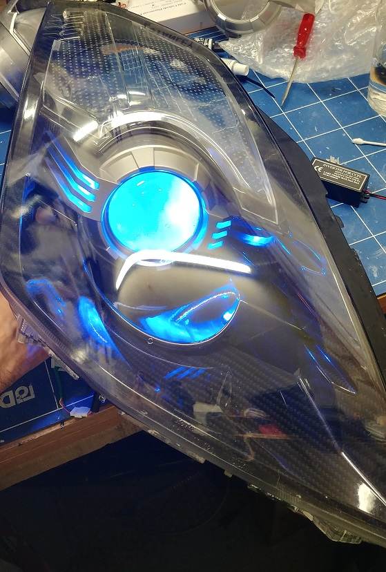

cob1980 Posted September 5, 2017 Author Share Posted September 5, 2017 Bluetooth LED kits have arrived from China... The LEDs are on metal strips which you can just trim down to suit. I've fitted one inside the projector housing, and one on the outside. Here's a completed unit (finally)... I decided to fit a discreet On-Off-On switch to the side of each headlight unit. This will switch between the street legal 4 side LEDs + Halo, Off (or side light bulb if present), and bluetooth LEDs. Sneak preview! Chuffed with how this is coming together, taking me an age but I think it'll be well worth the time. Now to do the other headlight, fully test them, then back in the oven! Iain. 3 Quote Link to comment Share on other sites More sharing options...
cob1980 Posted September 17, 2017 Author Share Posted September 17, 2017 Finally got one of them finished... !! Here's new vs old prefacelift... Had some issues with the other one - managed to crack one of the halos and bluetooth LEDs packed up so waiting again for parts. 2 Quote Link to comment Share on other sites More sharing options...
