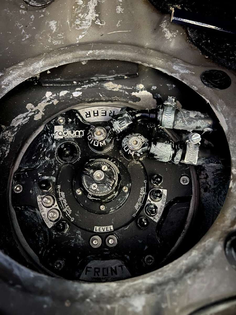

G1en Posted March 24, 2024 Author Share Posted March 24, 2024 Yesterday saw me back in action for the first event of 2024. It's been in at the guys at Horsham Developments for a few weeks to do some work including new rear wheel bearings, new coil packs and plugs, the gearbox rebuilding (3rd and 6th syncros) along with fitting a coolerworx shifter and finally a radium fuel hanger surge tank kit (which has caused a few issues) Yesterday was the first time I had driven the zed in anger since the work and overall the day went well but there are a couple of issues. We had lots of problems with the radium kit leaking fuel, I Think (because we don't know for certain) that the fuel tank opening is slightly bowed so where you have the oem plastic level sender unit fit, it probably sealed ok as the plastic is slightly flexible, the radium kit is machined metal and was rocking on the opening, because solid metal doesnt flex the fuel was getting past the o ring which wasnt sealing properly as you would drive around sloshng the fuel about. I have since siliconed around the unit which has stopped 95% of the leaking now but there was still a little yesterday so have added even more on today, fingers crossed the sealant lasts a while, I got it from work as it states it can be used to seal leaking, oil, petrol and deisel tanks as well as other chemicals. The shifter is very different to the oem one and will be marmite to lots of people. I love it but it does have some drawbacks, 2nd gear is hard to engage and 4th gear doesnt feel like it engages at all (but it does) so i'm hoping once i get used the the operation and how it is, i will be fine. I do love the precisiona and clunk of it. No grinding/crunching now from the gearbox which s a big positive. Strangly on the dyno, it made 10hp less than last time (all top end 6500-7500rpm) but more power/torque all way upto 6500rpm I can't notice any difference after driving and as the 2 runs were 3 years apart and very different times of year probably non comparable date anyhow. So latest video below from Cadwell, still probably only committing at 8 tengths. Its a hard track to figure out trying to go fast and not trash the car at the same time. Really would benefit from a track day here. 4 Quote Link to comment Share on other sites More sharing options...

G1en Posted April 8, 2024 Author Share Posted April 8, 2024 (edited) Well, just before I post my video from the weekend, back to the fuel system. After getting back from Cadwell, I went to get some new tyres fitted, and on way back car started cutting power every turn, realising i must be ruunning empty i pulled into the nearest garage and brimmed up the tank. now the Zed apparently holds 80 ltrs, I put in just over 79 lts so it literally was on dreggs. I went inside to pay the £133 (new record) only to come out to find a river of fuel running out from under the car. after informing the attendant of this potential hazard, i set off back home leaving a trail of petrol down the A1. It was still leaking when i got back home so put a oil pan underneath and went inside to cry. so just to confirm, Horsham-D had replaced the O ring 3 times in total and i had put mastic/silicone round as well, as whilst at the garage we just could not get it to stop leaking. the opening for the pump/level is slightly bowed. so this is how it looked at first: After brimming up and losing what felt like 20 ltrs I decided the only thing i could do was what a plumber once told me, if in doubt use more silicone, so i did. left it to cure then went for a short drive. unfortunately this was no help and resulted in the picture below: Fuel was still finding its way out, and as there had been so much it had eaten through the electrical connections so as i was fiddling around, 3 of them just detached meaning no engine starty, I decided to disconnect the battery at this point as having current run down a positive cable hanging loose next to liquid petroleum was starting an alarm bell ringing in my head. So i decided to strip off all the silicone and have a rethink, back to below: (the fuel has eaten away at the tank coating as well! So in my head I thought the best solution would be to make my own gasket and do away with the o ring that for all intensive purposes was doing diddly squat. I consulted the google AI to find out what rubber would be best as Petrol can eat its way through most things. I found out that Viton Rubber is highly resistant to petrol, even more so than nitrile rubber that the o rings are made from so i ordered some of this 200mm x 200mm x 2mm thick to make my own gasket. drew a template the best i could, as i couldn't remove the fuel hanger from the tank without disconnecting the fuel hoses and the level sender that has tiny screws that looked like a recipe for dissaster, i could pull the unit up an inch or so to give me enough room to fit a gasket in. template below: Rubber arrived and gasket cut, note: as i couldn't remove the unit easily i would have to split the gasket so i could wrap it around the hanger, i cut a wedge interlocking shape so it would hopefully link back together ok and limit any leaking, see below: I then fitted it and screwed down the bolts, all went went apart from losing the o-ring into the fuel tank never to be seen again, I put a bit of silicone on the area where the cut was and prayed to the car gods. finished pic below: You can make out the gasket just sicking out from the edge of the plate. Amazed to say, so far this has worked and when i got to Anglesey after 160 miles of driving, no wet patches. Although there is a smell of fuel sometimes, so at some point i need to check all the hoses as i think one may need nipping up. Edited April 8, 2024 by G1en spelling 1 Quote Link to comment Share on other sites More sharing options...
