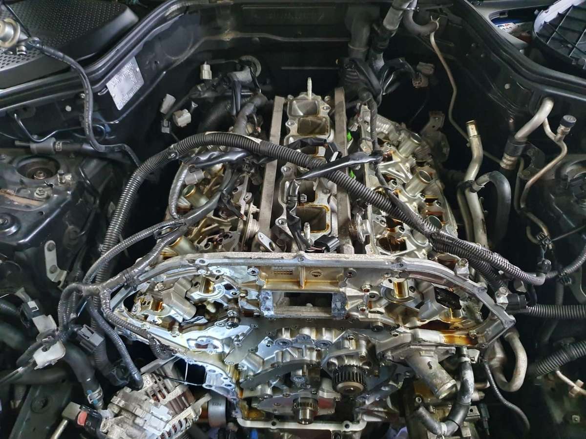

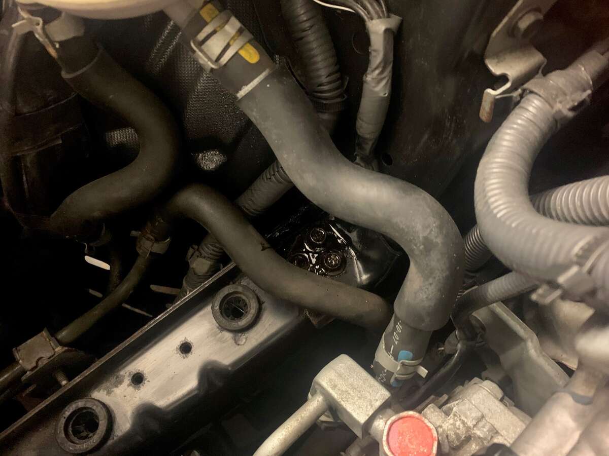

Many of you will know one of the very few flaws on the 350z HR motor is the dread oil gallery gaskets, so even though I have never had any issues with the oil pressure and the car is on around 70k it only seemed right that whilst the engine was apart, we may as well get the gaskets replaced with the uprated version for peace of mind, it also makes financial sense as the cost is minimal if the engine is stripped already.
The great thing with trusted garage such as Horsham Developments is the guys ring you with updates as they are going along especially if they hit any snags/issues. The gallery gaskets in the main were still ok, which is obviously why my pressure has been fine to date but Craig did say one part had broken loose and over time would have failed so like many HRs, they WILL need doing at some point even if you have an unblemished service record. This was mine below:

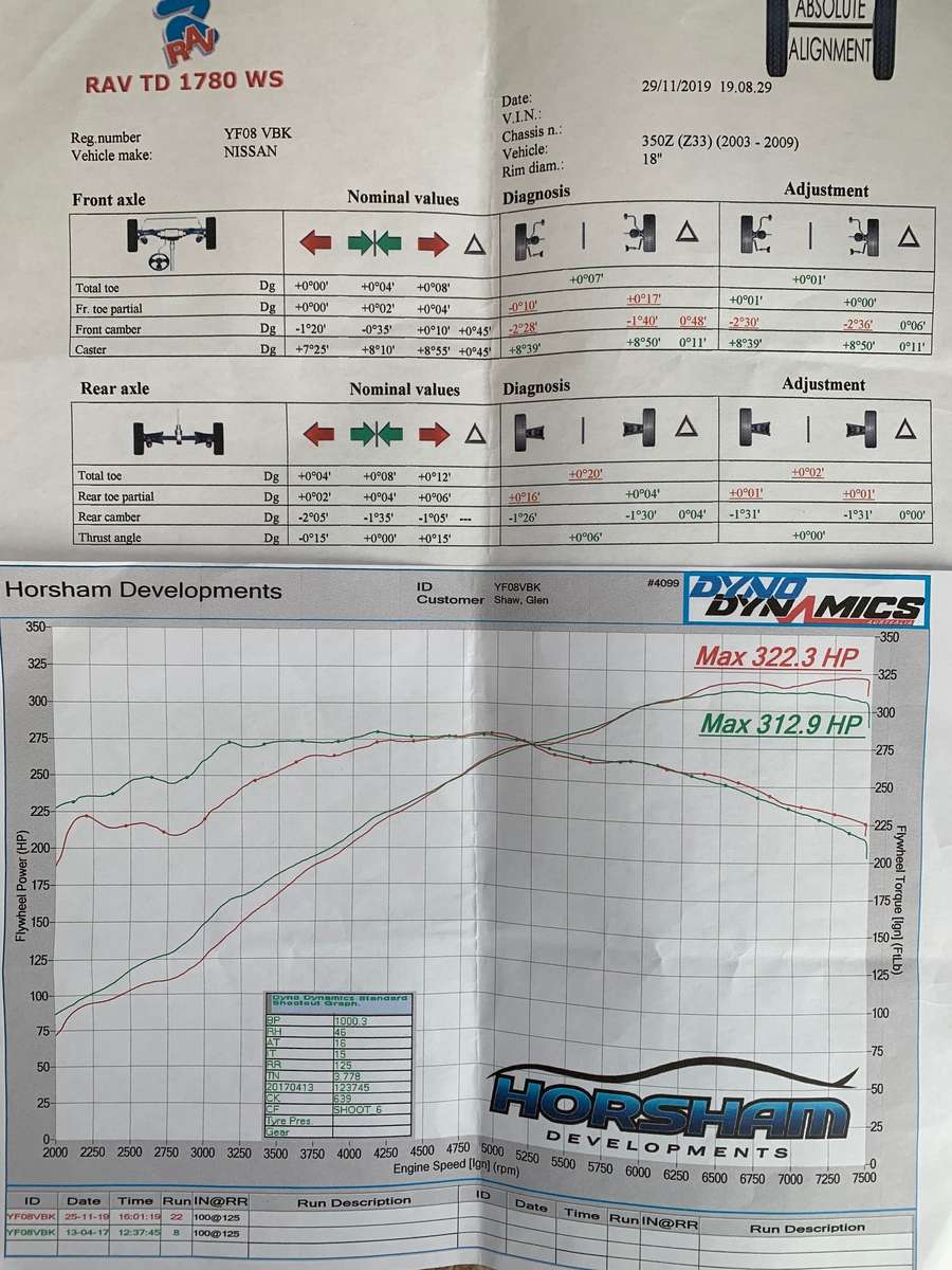

Onto the dyno, now Horsham were disappointed with the results and they think a CAT may be degraded/blocking some of the exhaust gases, this may well be the case as it keeps throwing up the same EML light periodically which is O2 sensor 1 &2 Bank 1 but I don't have the time/money to sort the exhaust so that's something for future, it could also be the manifold but its not major as it did make 10bhp over last time which was 2 years ago. They did not have a start point as apparently with new cams you can't do a base run/before run as you need to download different things to ecu or it runs like a pig. so we are basing this against last dyno printout, previous in this build thread which as stated is 2 years ago, the car may have naturally lost some power since then, who know, I know I have never changed the K&N air filters so that may restrict the airflow, anyway, we still got an improvement at the top end which is where I need it for track driving and it seems obvious the Tomie cams are working as the power is still there/increasing at red line. Its hard to tell whether I will see any actual time improvements (watch this space) but the sound at WOT is proper race car now and amazing. shame I cannot de-cat the exhaust because of hillclimb regs (and general mot regs!) as it would sound even better and release even more power (another reason the gains had been low) all the cars previously dyno with high lift cams had been de-catted and uprated cold air intakes for breathing, so although slightly disappointed, I know I can certainly get more power down the line if I sort out the intake and exhaust.

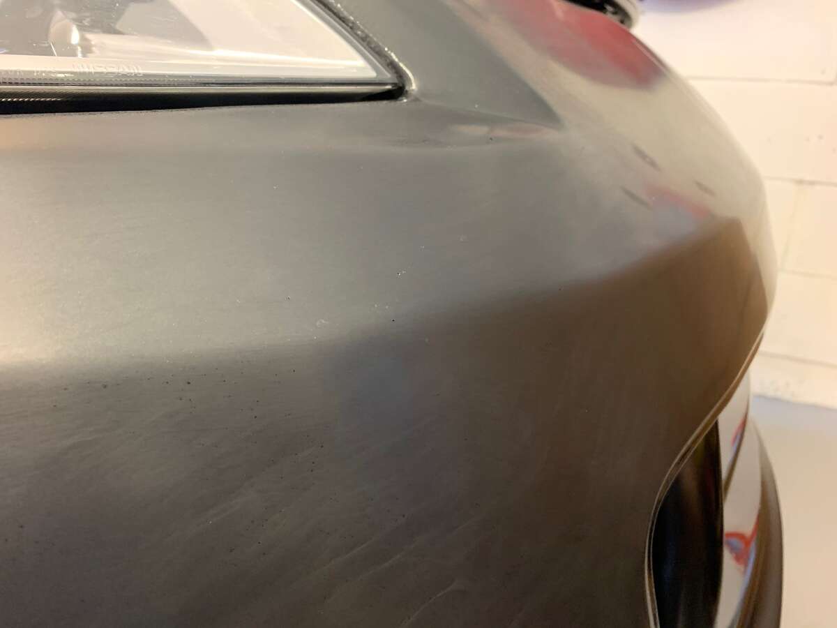

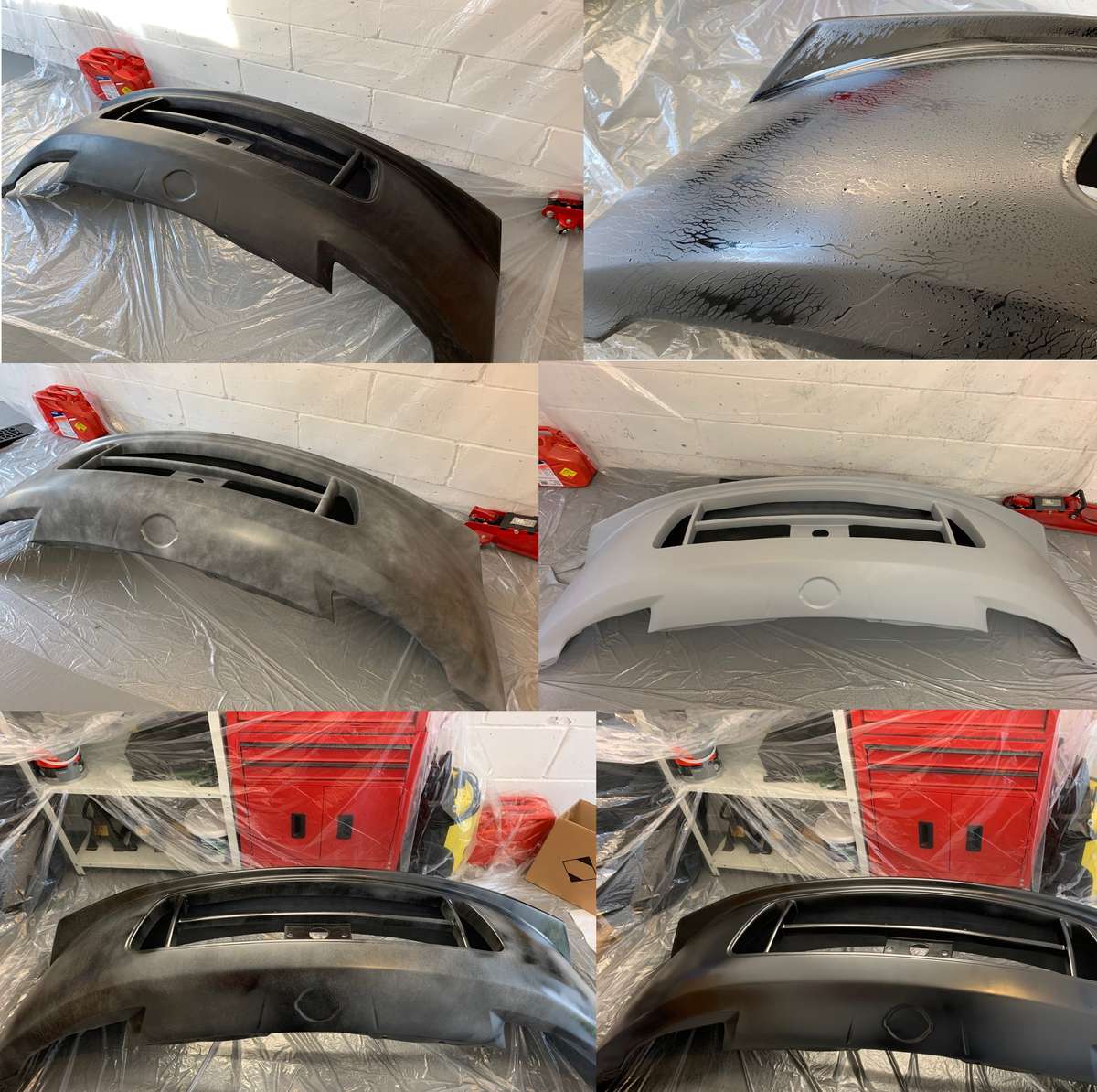

After spending most of last year with a bare polyurethane bumper I decided to get round to giving it a lick of paint. The original plan was to either get it professionally sprayed or wrapped but with both options costing around £250-£300 I plumped for me having a go with rattle cans at a cost of £50 all in, so here was the line-up:
Now I will be up front and say the final outcome is not that great. The orange peel is more like a Spanish orchard of naranjas BUT from afar, and by afar I imply something like 200mtrs you cant tell. In hindsight, I should of wet sanded the clearcoat, before that I should not skimped on the main colour and bought 3 cans instead of 2 and I have no idea how long it will even stay on the bumper anyway as many internet threads worn of the perils of painting polyurethane, even the paint shop and a vehicle paint repair man who was in at the same time as me had different views as to what you do/don't do or need. So with that and me confused as hell, I purchased some cans and thought to myself, even if it turns out terrible, its only a bumper and can be re-done or wrapped later on.
Below you will see the 6 stages from top left to bottom right. Firstly I had already cleaned the bumper before sanding with 400/800 grit sandpaper and wiping clean with panel wipe and painters wipes. Next I sprayed the adhesion aid, this didn't stick and cover as I expected, I'm not sure you should use it or not but some places say to so I did, because it kind of run, I smeared it across the surface with a cloth and let it become tacky before applying another coat and doing the same. Maybe I didn't clean/degrease/sand properly to start with, maybe its the wrong product, I havn't got a scooby. All I knew was I was carrying on regardless. Next I sprayed the high build primer (again, I asked for a plastic primer and got told at the shop this was best) It seemed to go on great and the adhesion promotor definitely must have helped. Next was the base colour, I had it mixed to the car colour, I sprayed 2 coats as I had 2 cans and because its a large bumper it took almost a can per coat. This just isn't enough really as you can tell in the odd spot at the finish where you can see there is barely and black paint in areas. The other problem with spray cans is because I was mainly spraying downwards, every now and then I would get a drop of paint fall off the nozzle and onto the bumper making a blob here and there. I tried to wipe one off with my finger only to find it took the whole paint off back to primer so quickly realised I would just have to live with it or spend hours refining the finish afterwards. Final stage was 2 coats of 2k clearcoat. Now 2k is, I am told, a chemical resistant clearcoat like normally found on your car and is resistant to petrol/oils, "normal" clearcoat is not, its all a learning curve. I let that dry and then weeped at the results.
I decided to push ahead and ""protect" my work of sh**e
I used some old polish I had in the garage, some scholl deep cut, then general cut/finish grade to try and flat out the orange peel but it didn't it, it just served to enhance the shininess of the turd I had created, Anyways I could just not be bothered with wet sanding or starting again so my intention was to coat the bumper with Gtechniq EXO I had left from doing the car but as soon as I tried panel wiping the finish to get the polish remnents off it made all the paint go really weird. it was like I was scratching the finish and creating marks and dull spots so I quickly stopped and got the cutting polish back out which got the finish back to the shiny turd. I changed approach and grabbed something else I had in the garage instead, some ptfe polish followed by hydro-coat from carchem, This went on fine and ggive the very thin paint another layer of protection.

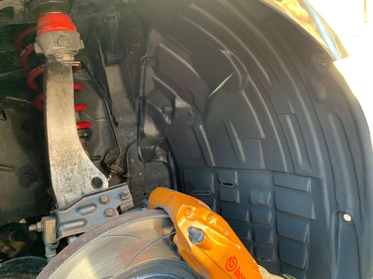

Anyway, onto some easier tasks, I had not had a right front arch liner for a while after my wheel decided to chew the original one up so whilst the car was off the road I purchased a cheap replica off ebay. Now normally I would not recommend buying cheap Chinese tat but at around £25 I though it was worth a punt. It came rolled up in a tube, not great I thought, but after opening it sprung into some sort of shape and because its a much more plyable type of plastic than the OEM one, you can bend and shape it really easily. I had a big shock when I put it in the arch and it fit perfectly with all the holes lining up for the clips, RESULT for once:

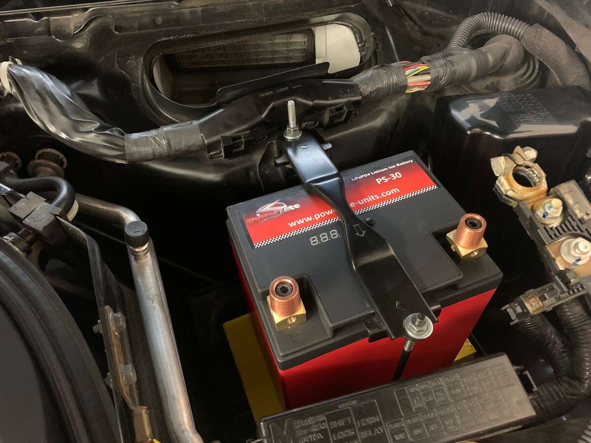

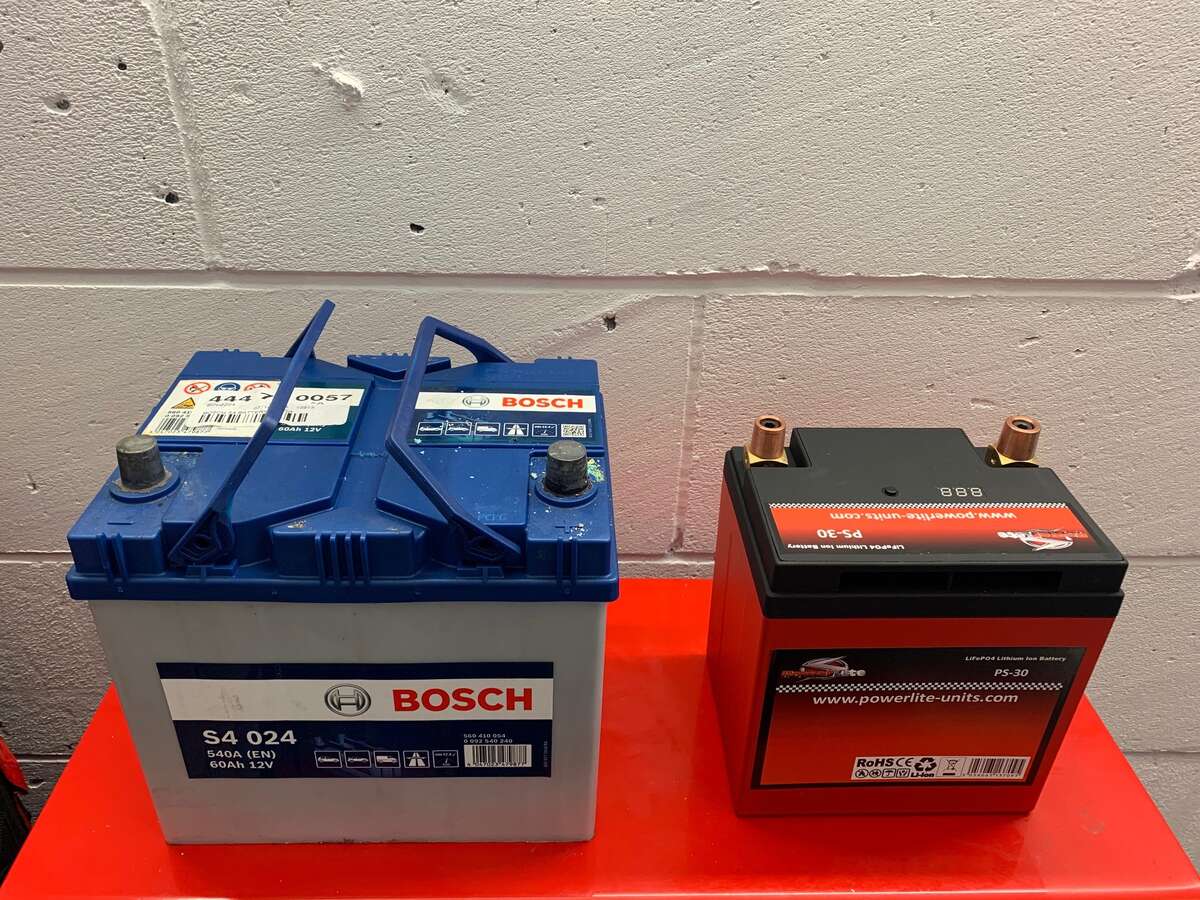

So, speaking of keeping the battery going, I decided to invest the money I wasn't spending of Mcdonalds and KFC during this lockdown on a Lithium-Ion battery. I saw a post on this forum about someone getting one and couldn't believe the price. I thought they were around 700-800 quid (and they are at demon-tweeks and the like) but this one from Powerlite is only £250 ish and in theory should be fine for the Zed. it says on their website something about upto 4ltr engines I think. So here it is next to the Bosch S4 I took out:

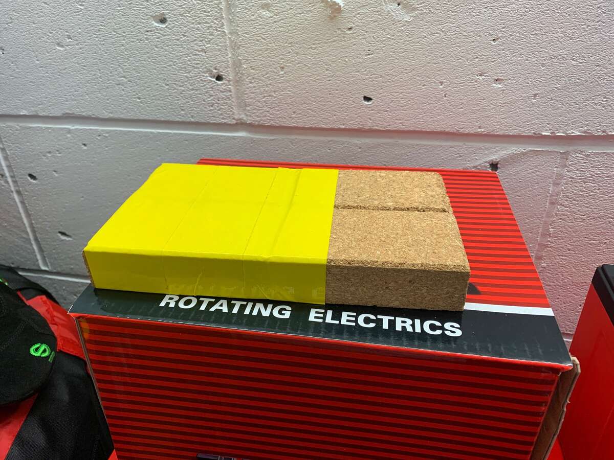

So as you might guess, first problem was the size and getting it secured down in the battery bay. The height was too low for the standard clamp so onto bodge 1, how to make it sit higher, after trip to local car parts store and wandering the isles, I came up with this:
4 cork sanding blocks gaffer taped together which would raise the battery to a "standard" height. Cork is fairly dense so shouldn't squash under pressure, its water tight now with the tape over and it doesn't slide when secured down so its a win in my eyes. It now fits:
I then proceeded to connect the terminals only for the positive to be too loose and not secure enough, as the copper terminals are tapered it was just sliding off, time for bodge-it number 2, thanks to the forum again, I remember reading about using a bit of thin copper to wrap around the post thus so enlarging the diameter. I nipped down to B&Q to find some.

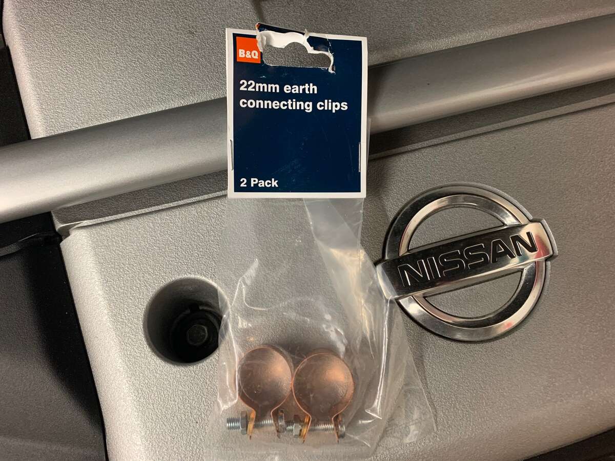

On entering the carpark on a Saturday lunchtime, I was greeted with a queue that stretched for what seemed like 4 and a half miles to get in. with nothing else to do that day, another negative of lockdown, I waited in line, truth be told it was around a hour wait to get in, where I found these bad boys:

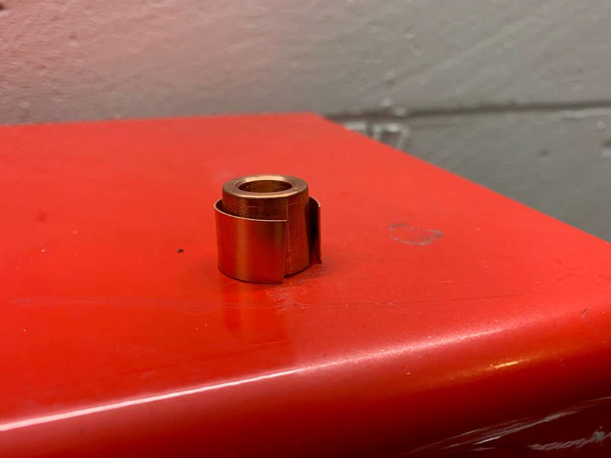

Just the ticket I assumed, so I cut off the nibs and measured around the copper terminal like so:
My delight soon turned to "what a fc*kwit" as the copper sleeve was too big to fit inside the positive terminal and at that point I realised that the terminals were 2 different sizes and I had attached them to the battery the wrong way round, after swapping them over , both were coupled up no hassle and I threw the B&Q purchase at the wall shouting a few obsbletives for good measure. Now please take pity on me as I had wasted 2 hours of my life to learn this valuable lesson that had never dawned on me, you see when you buy a battery, you just connect it up, you never usually have to attached the terminals to it and because they look the same size, I assumed they were, anyway turned out bodge number 2 was not needed and here it is, sat in all its glory and the car sitting 13KGs? lighter so win win. As a side note, it actually served its secondary reason for purchase, it started the car!
took it for a quick blast, charged up fine, it has a handy button on the top that you press and it shows you the voltage, apparently anything over 13 is fine. It read 13.9 after a drive, the car has been sat for a week and I tested today and it shows 13.6 so by quick man maths that tells you when its coupled up and powering the alarm etc. it will be good for around 3 weeks before needing to be started/topped up. Will keep an eye on it.

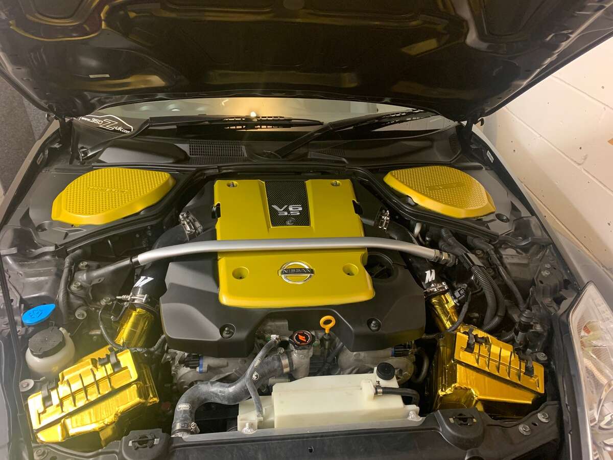

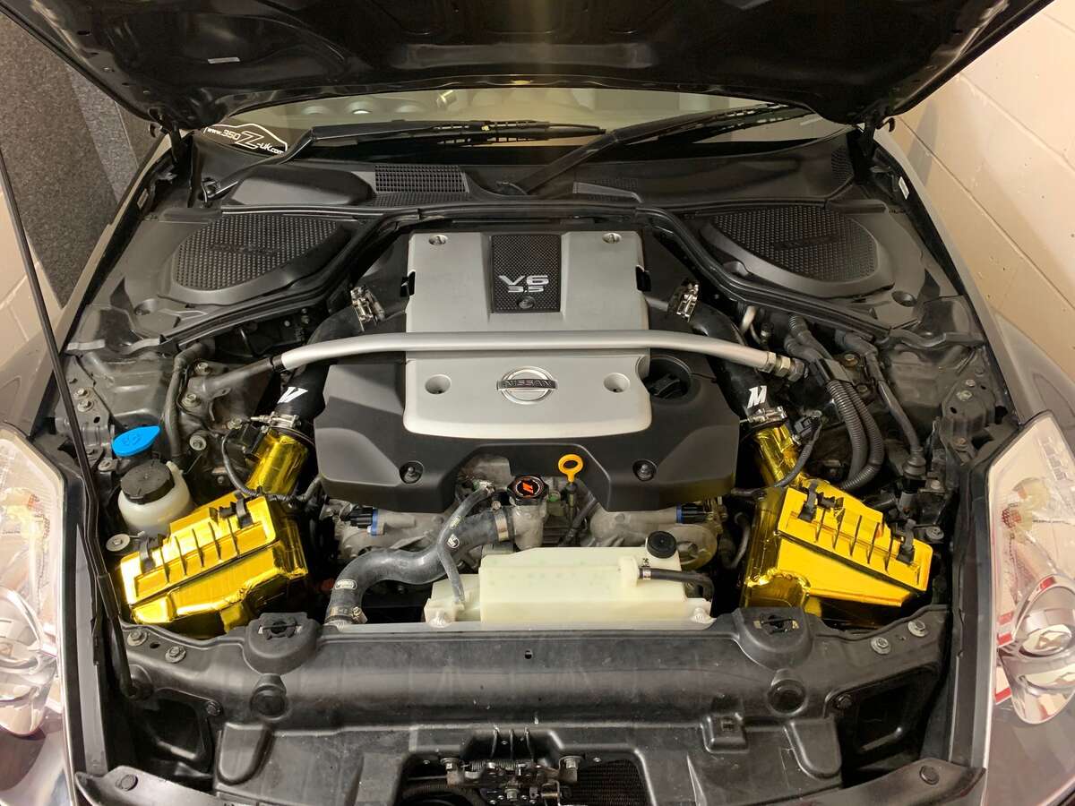

Next I thought I would check the intakes just to see if there was any oil/crap build up. Great news, they looked very clean including the throttle body which kind of confirms as well why the car hardly uses any oil. Fingers crossed It looks like I have a good engine.
So, onto the arts and crafts. The design of the stupid air boxes meant it took my half a day to tape these thing up. I wanted them to look semi-decent so didn't just wrap he tape all the way around like some Egyptian mummy, instead I cut out bits to sit between the various fins and nobbly bits. It was never gonna be perfect but thanks to my patience we ended up with this:
I also noticed the foam was hanging off where the intake connects to the duct behind the bumper. I don't know how functional this is as when I have sorted it and re-fitted, there is still a gap anyway all way round but it gave me another excuse to play - how long is the queue at B&Q? for anyone that's not played this game, get yourself down, you don't know what your missing. I also played the sister game today aswell - How long will I be, at KFC? that was only 30 mins and was well worth it. back to the post, purchase some foam draught excluder and wrapped around like so:
Intakes complete, I reinstalled and admired my work, definitely need some more gold now in the bay to complement it, possibly paint the engine cover and strut brace? I reckon they are now good for an extra 0.1hp Can't wait to find out.

Good work on the battery. I had one that was working on my VX but leave it a couple of weeks and it was dead...changing the battery on a VX is a nightmare, so I put it off but in the end just did it and now it fires up on the button each time, fantastic! And yes, you need to gold the rest of the engine bay now!
Those air boxes are a work of art! Reminds me of the gold reflective surfaces on satellites and spacecraft. And it’s not just for bling if there’s the smallest chance it could help performance, so all is good.
@msitpro 267 whp think it was, they were dissapointed as usually they are 10-20bhp more but all others dyno,d with cam swap had  decats, headers and full cold air intakes, i have to have cats for racing so it restricts the flow obviously but does leave me with option of increasing in future. Forgetting the numbers the torque/power is noticeable above 5k and it sounds great.
@Kieran O'Quick as soon as i posted the battery jobby i knew you would be on it. It has slightly more CCA than a standard battery but only half the AH. And im fairly sure you cant jump these off, you have to recharge them with a dedicated charger so thats the risk.
Yeah, in theory it should be fine. Its supposed to have an overcharge/undercharge safety cut off anyway so it wont charge above a certain voltage and cuts off to protect itself when it drops below a set voltage. The bonus is it displays the voltage when you press the button on it so will see how it goes

I hit 269hp@6800rpm @ hubs on my 04 DE with headers (your HR has very good headers stock), 3" exhaust, 3x 200 cell cats, full intake and Kinetix Velocity plenum - stock cams.
I'd be expecting 290-295 whp from an HR with say 270 deg cams, exhaust, sports cats. On Abbey's hub dyno maybe even 300 @ hubs.
I'm really really interested in that battery as well - been looking at them but like you say, everything that fits the spec seemed to be £700-900.
Horsham did say they thought the cats were degraded/blocking the flow. I may have to swap them over, i need a new y pipe anyway so could renew and see what that does. Thanks for the info

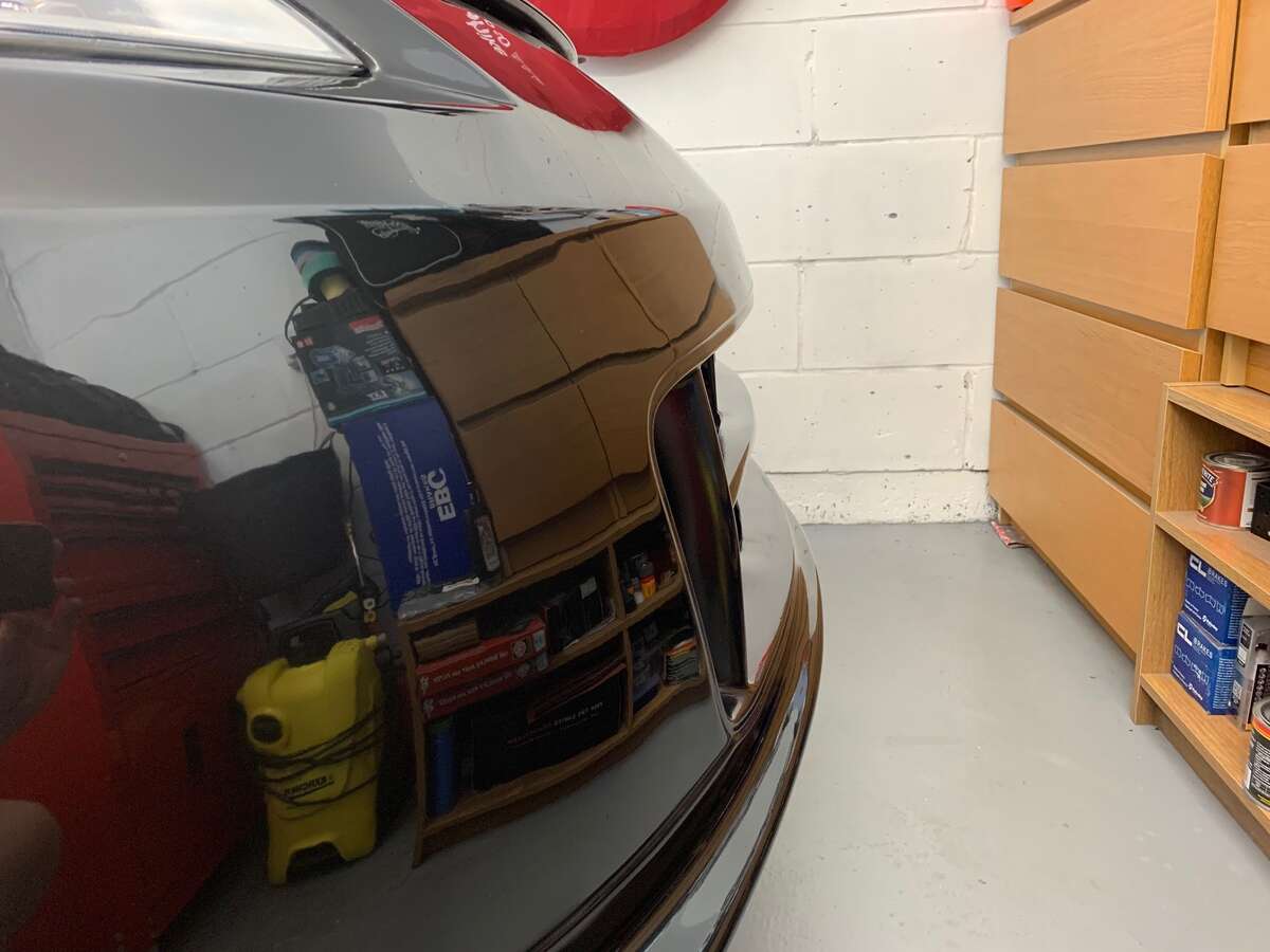

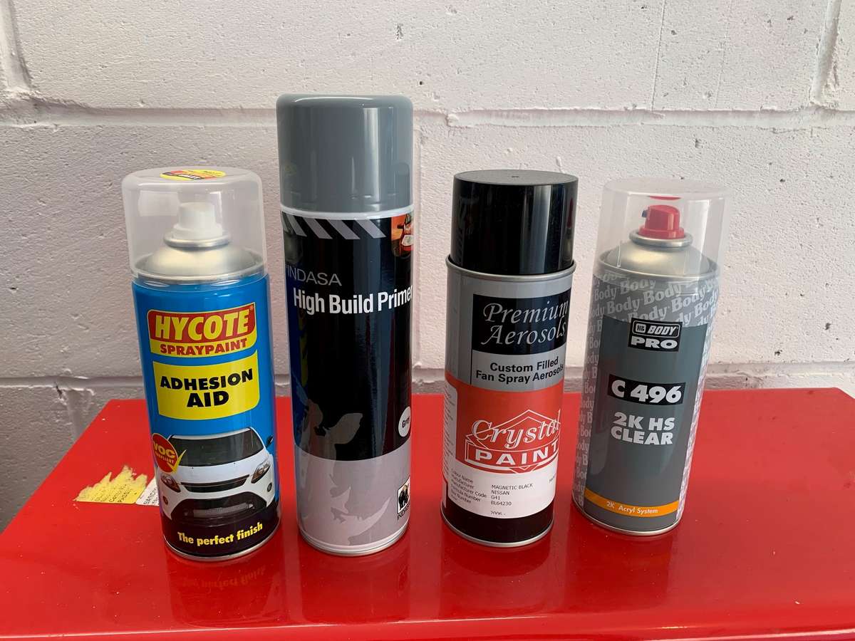

During August I decided to have another go and painting the front bumper. I had rushed it far too quickly last time resulting in a shower of s6!t finish and it may be no show car anymore, it still needs to be presentable in the paddock. So bumper spray job part duex ensued and this time putting the base colour down as a mist, 3 light coats followed by one light clear coat, then 2 heavy coats of clear. left overnight to dry/cure. then wet sanded back with P800 and P1200 resulting in this:
Then hand polished with a gtechniq hand polishing sponge, course side (white) with some scholl S3 compound i had left then the soft side (black) with some S40 for the finish. I opted to do by hand with plenty of elbow grease as the DA polisher was just not cutting it. It was taking 3 times as long to get the same results. Just confirming that DA machines may be great for finishing they are too "safe" for heavy cutting if required. Anyway final result was this, which for a diy job in the garage i was happy with, overall 6/10 rather than the 2/10 i had before. I did finish with my right bicep a good 1" bigger than my left counterpart:
What I will add is that if like me, you decide to do this inside, cover everything. I masked up the floor in front and the engine bay and wheels behind but the overspray from the base coat and clear goes f-ing everywhere! literally, it gets where water can't. Luckily as the car is ceramic coated, the layer of whatever it is was sat on top of the paintwork so a quick snowfoam and wash afterwards cleared the mess, not sure how lucky i would have been if either the car paint was "bare" or i'd left it several days/weeks before cleaning.

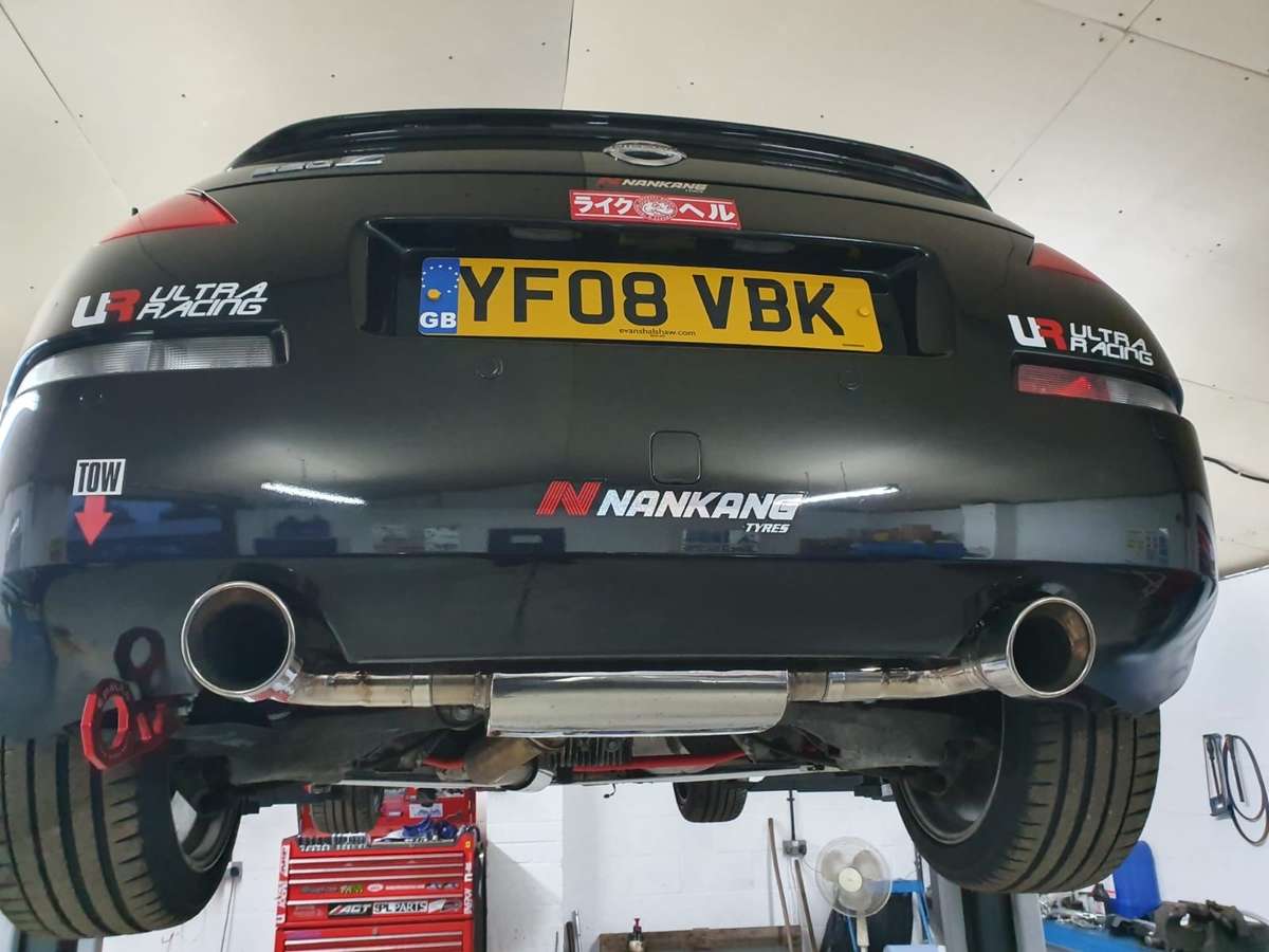

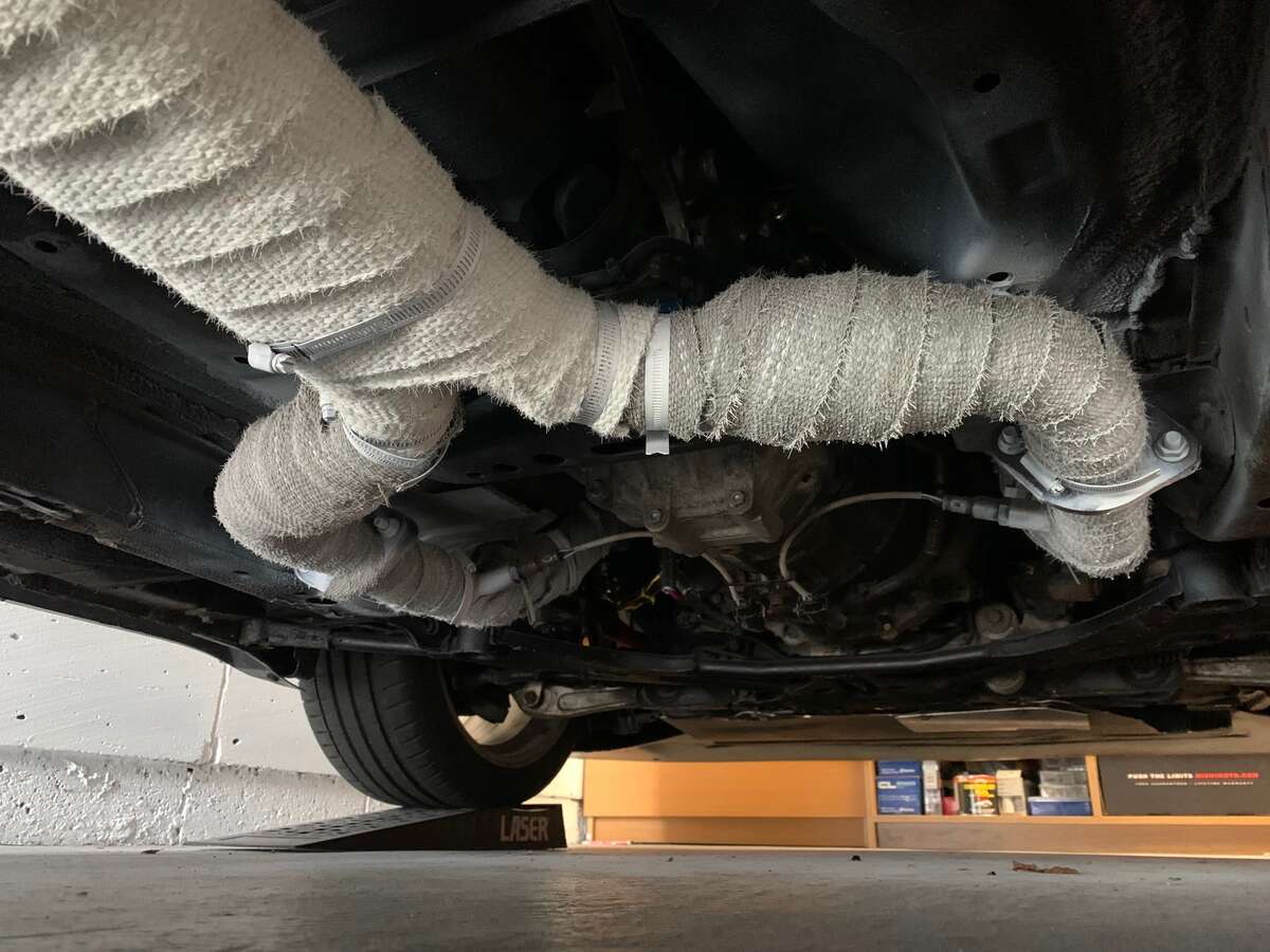

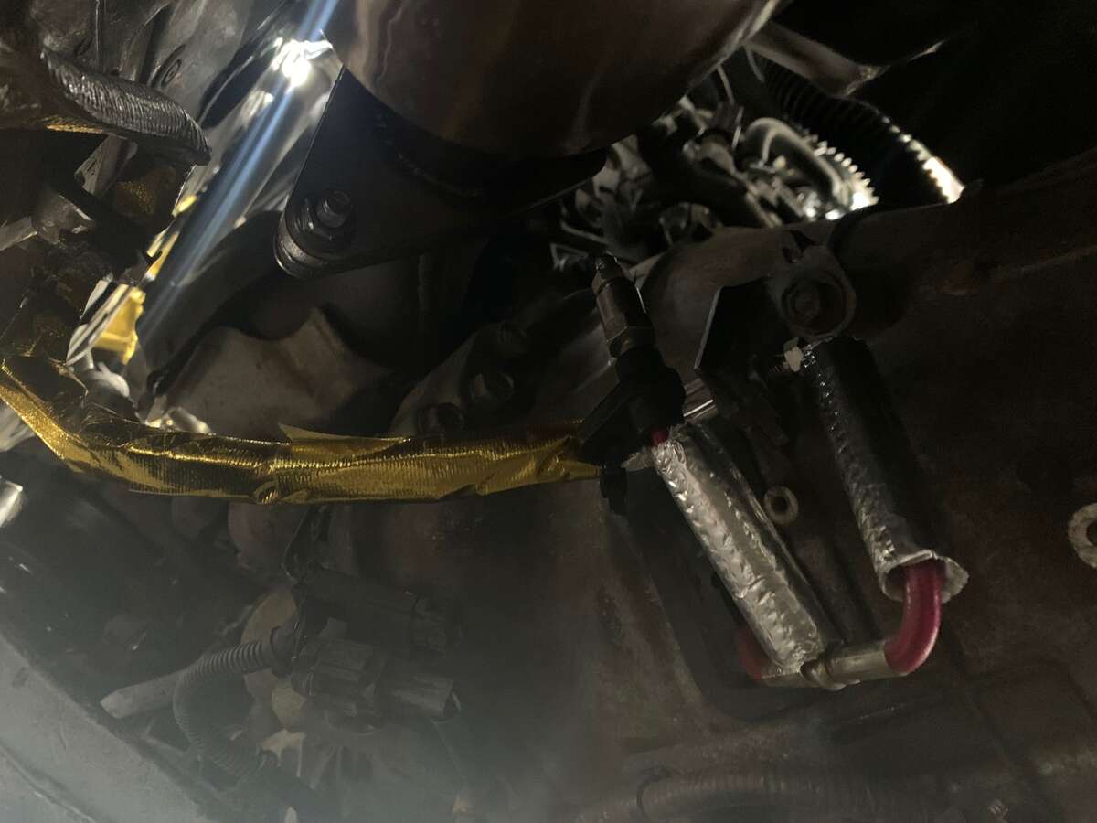

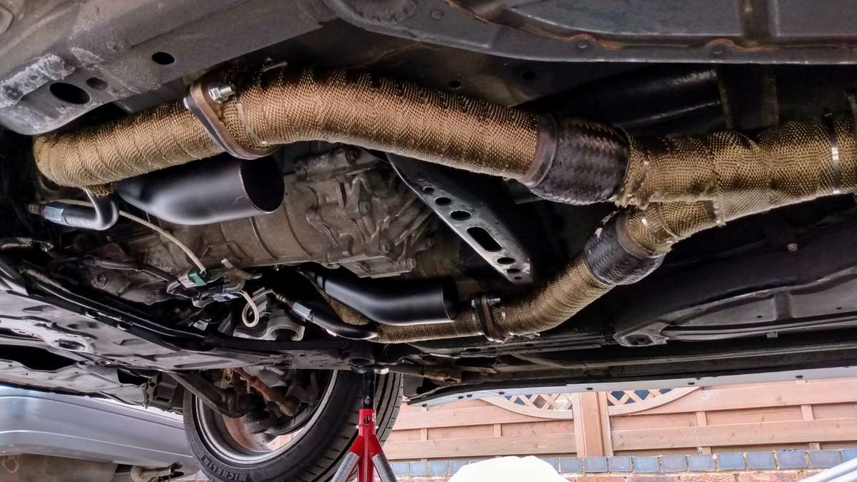

Then I had been umming and arring for a while on whether to put some heat wrap on the exhaust so just bit the bullet and went for it. I had 10mt of volcano wrap bought on E-bay. It doesn't state what volcano it comes from but i suspect its one in China!! This was only enough to do the CATS so i had to purchase some more from a local car shop. This was the standard fibreglass stuff which is all they had so i used that for the y-pipe and finished it off there, I think there is little point doing any further along, there may be little point doing any of the exhaust reading the internet but what the hell. I started the car and left it running for 15-20 mins to cure the wrap as per instructions. It does smoke a bit and stinks and you certainly have to open the hood if your stationary to let the smoke/fumes out. The next day i sprayed some high temp silicone spray over the wrap purchased from Demon-Tweeks which supposidly helps seal the exterior preventing moisture and dirt getting engrained into the wrap and causing corrosion.
The problem I have is that i was doing this in the garage with car on axle stands, I barely had enough room to scratch my ar5e let alone install the wrap so it wasn't anywhere near as tight as it should be and I struggled to get it taught around the cats which chamfer out and in, I just had to do best i could and use lots of jubilee clips but there are still small gaps here and there so crap can get in. Worth noting i used white silicone spray so finish isn't the most aesthetically pleasing but it was the only colour in stock, you can get black and others if you prefer.

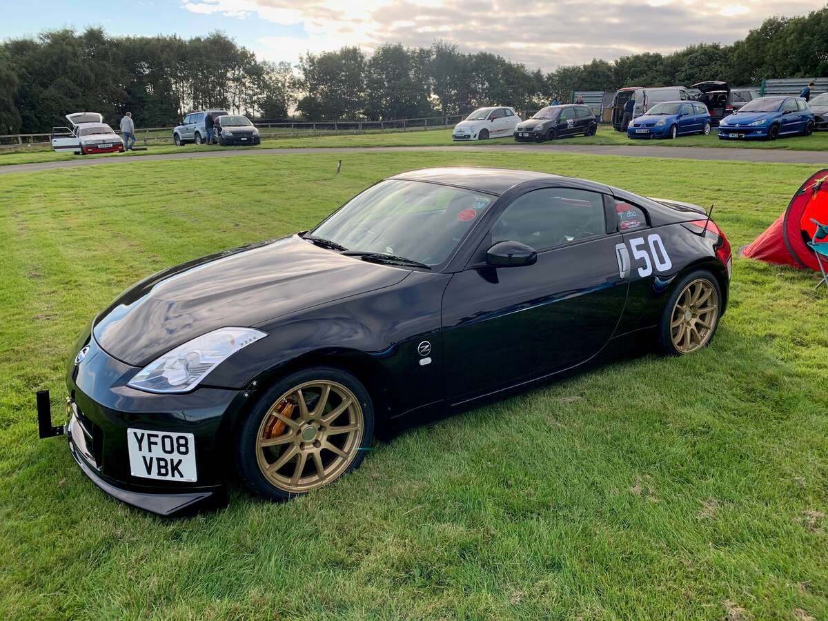

Fast forward to last week and it was the second event at Harewood, weather was the same as previous, dry but very cold for August (about 14 degrees) and very windy on the hill so it was never going to be a record setting day but nether the less on Run 2 I put in a flawless run to net a 64.61 Think this is third best ever so given the conditions and the fact the grip was just not there, i was chuffed, every corner on the run hooked up and i even managed to get the car launched semi-reasonable. I have just come to the conclusion that starting "normally" and feeding the throttle in over 2-3 seconds is quicker than any other method at Harewood. Overall I was second in class again (out of 12) missing out on win by 0.15 secs
Car was looking good, just noticed I have also fitted some quick release bolts for front bumper as i was fed up cutting my hands getting into the wheel wells every month. Another quick mod although I cringed when i was drilling the wings (fenders if you like) I have actually done a fair bit looking back. Photo below of some of the class, including a fully stripped out GT4 Aston (that if it was a regular championship event I don't think would be in this class)

Very much worth removing the y pipe (x6 nuts/bolt) to do neat, as its only a job you ever want to do once. Also when on the move going forward in the wet means, water will collect the way you've installed the wrap ie starting front to back instead of back to front if that makes sense. You want the folds to be facing towards the rear of the car so any water just hits and runs off rather than collects. Ideally also the wraps needed to be installed damp, this allows for tighter fitting and when you start the car the burning smell goes after the first drive and doesn't come back. Correct head wrap ties are very cheap also and wont attract heat soak nearly as much as a jubilee.
Yes mate, yours looks much neater and more like a pro job. I suppose its easier when you stick to the same size pipe. With the cats and flexis i was going over and with no room to move under the car along with starting at the wrong end which i didnt realise was an issue until after it was never gonna be great. I guess at some point i may end up pulling it all off and doing again (bit like the bumper) do it once, screw it up, leave it a bit then do it right next time round.
what i would say is it does seem to have given me a few extra bhp as at last event i was hitting rev limiter in places a good few metres before i ever have previously so definitely think it helps with both temps and getting the gases out quicker, just need to find out how long the bodge will last...

There were 2 reasons for the car pulling left. First, the camber was maxed out both sides at the front on the adjustable arms, this was done to keep things simple, max camber, max attack, if it gets knocked, easy to put back, but this resulted in the drivers side being around 15 minutes more than the passenger side, also the castor was around the same 15 minutes more. (Toe was identical from prev alignment) so although only minor and on a standard car you may not ever notice, on a race prepped machine with poly bushes, stiff springs, anti roll bars etc it accentuates the tiniest of variants. So armed with my impact gun and torque wrench i decided to have a go safe in the knowledge i would not be driving it in earnest for a while.
I started by measuring out the adjustability on the camber plates which was around 3.5 deg then trying to work out how little gap was 15 minutes, basically its a small one, around 3mm, so adjusted that back, then tried to find online the castor specs along with my last printout. The passenger side was right on the upper limit (8.55mins) drivers side was just over 9 deg (out of spec) luckily the eibach camber arms also have adjustable caster plates that can adjust the castor either .5 .75 or 1 deg plus or minus so taking .5 off the passenger and .75 off the drivers side meant they were almost identical number wise and bang in the middle of tolerance  oem spec wise, win win. This left me with one last issue, when you change camber it affects toe so i needed to tweak the toe on the drivers side to compensate for the 15minutes less camber.
back to the tinterwebs and the zed American forum had someone do some self alignment and worked out (rightly or wrongly) i may never know that 1/8th turn on the tie rods resulted in 15 mins toe which is what i needed so thats what i did.
wheels back on, jumped in and took the girl out for a quick spin and to my amazement she handled superb, 100% straight on the flat and following the camber of the road both left and right as applicable. Now i don’t condone everyone to self align as in my defence i was only tweaking the front, i dare say if the camber/toe was way off i would have probably screwed it up even further but nevertheless i was chuffed to bits with this.

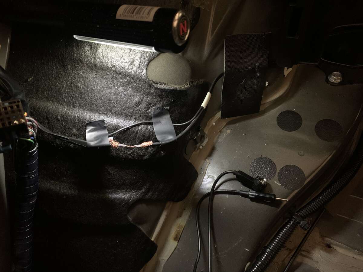

Fortunately for me, as i already have an aftermarket steering wheel i don’t require or have use of steering wheel controls so just purchased the basic non bose iso connector hoping this would be ok.

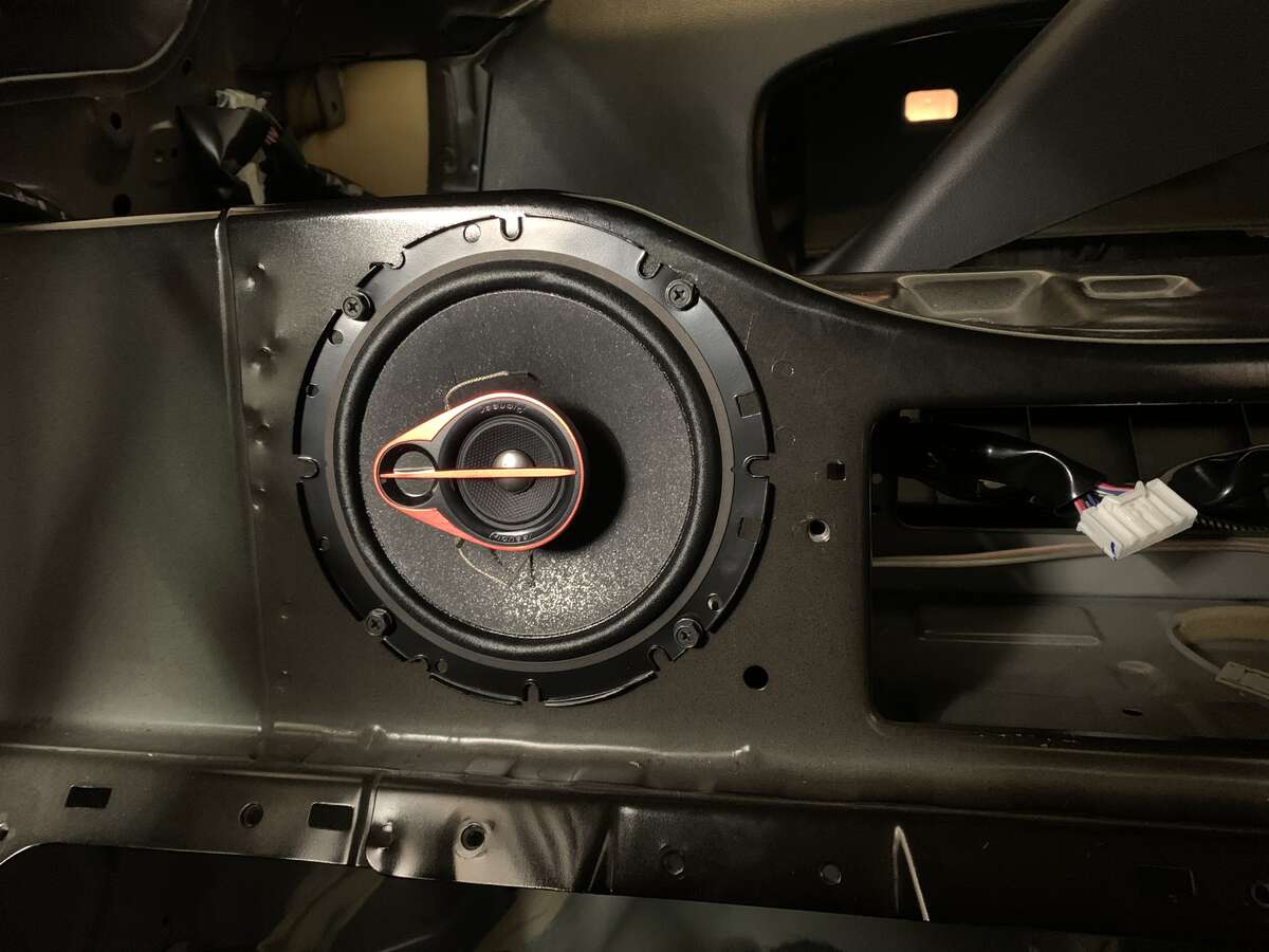

I soldered the new speaker cable into the harness for the relevant rear left and right speaker wires and run them past the gear stick and handbrake and into the housing behind the seats. There are plenty of holes and voids for this making it very easy. In the pic below the new cable is the orangey wire, you can see the new stereo in the hole where the bose sub was to see how compact it is.
Fitted the new speakers which again went straight into the existing holes using the same bolts. Very straight forward when you do a bit of research first and get the correct size. 6.5” for anyone wanting to do this.
So with the stereo fitted, speakers in and coupled up. I was left with 2 holes in the dash where the sat nav screen and control panel used to be. I bought a sheet of 3mm black plastic that i cut down to blank these off. The screen part was easy as its just a rectangle so i just put a small bolt/nut either side. The plan for this area moving forward is to house a GPS lap timer/analytics unit so i can make best use of info to improve lap times when i start doing track days in earnest. I have been looking at the Aim solo 2 DL which seems a good bit of kit, you can program the leds for multiple things such as shift lights and the gps timing is accurate to just 2/100th sec. anyway, with it being a nice flat surface i could use it for lots of future options.
The slanted section was a bit more tricky to sort. I have blanked off with plastic best i can but as its sloped and curved it isnt flush. I did manage to use existing fixing points though by tapering some more plastic and screwing through into them. Finally added a few stickers to make it look less plain.
The little microphone on the rhs is part of the bluetooth stereo and sticks nicely to the side for hands free calling. So at this point I reconnected the battery and fired the stereo up. Now i must admit just having 2 speakers means the sound isn't great but its good enough for my use. The main thing is i have bluetooth calls, apple link up for music and radio. I then realised i had no radio.... or at least no reception anyway. I did a little googling that said the powered aerial needs a turn in signal from the car so battery back off and some more soldering. To try and help others, if you remove the bose amp in the boot, you just about lose all the sound system as everything seems to run through it. I had to connect the remote amp wire (blue) that was on the iso harness to the power wire for the aerial (brown or green) cant exactly remember but the aerial has its own little connector behind the standard head unit. I then figured out that the aerial power or signal runs through the amp so had to cut the connectors off and re-solder together. This was the hardest part of all as aerial wire has an inner and outer copper wire separated by a plastic sleeve. The inner copper strands are so thin they just break when you try and cut through the plastic sleeving so i had to slowly wittle the plastic away to expose the few strands then use plenty of solder and electrical tape to hold together. If you zoom in on pic below you will see what i mean.
Anyway, result, this sorted the reception and i now have radio again. With that sorted and all the plastic trim off i decided to “bed liner” the boot area. This would get it neatened up, looking better and protect it as well as giving it a little anti slip property. So i bought some bed liner spray cans from local automotive shop. I used a little sandpaper to rough it up first, masked off and sheeted off as much as i could then firstly used the half can of grey primer i had lying in the garage before 2 coats of the black bed liner.
3 pics below of before, after then after with plastic trim back in. Looks half decent. Also managed to relocate the alarm siron box to the rhs onto a bracket.
Finally, purchased a new gear gaiter, black suede with red stitching as the original oem one was looking tired. Unfortunately i destroyed my knob extension (insert innuendo) removing the gear knob at the start of this so may have to purchase another if i don't get on with the short shift look and feel of this.

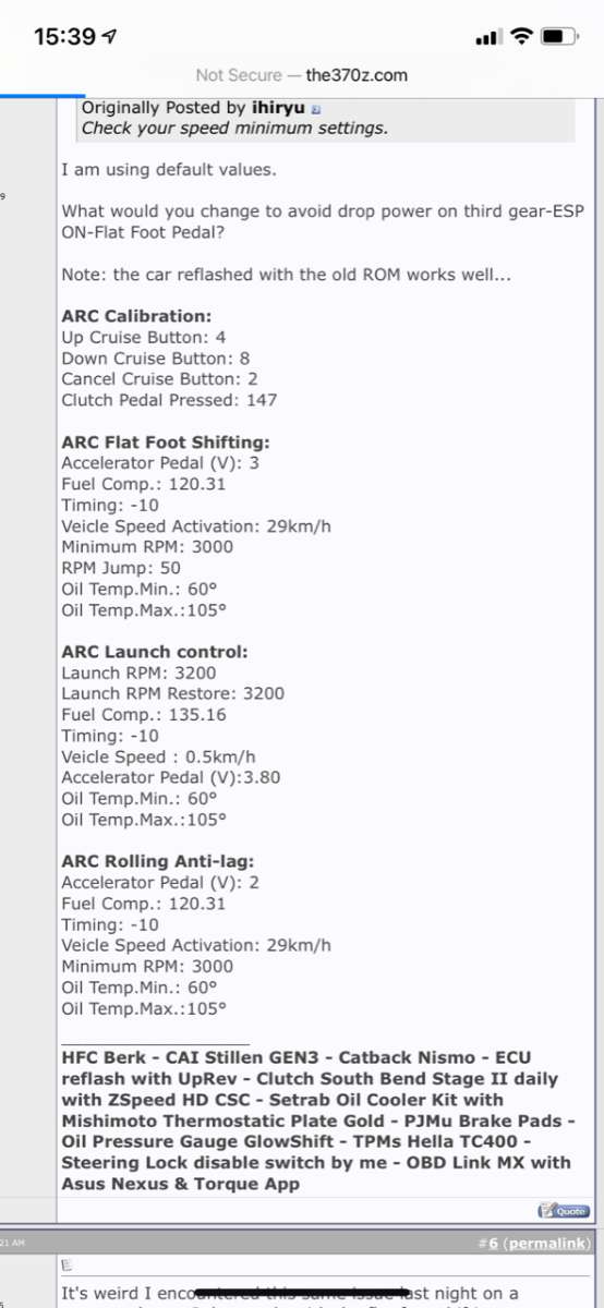

On that subject, my starts are always one of the slowest so I thought i would try the ARC launch control feature and see if that offers any help moving forward. Now only one problem with this, and it was a significant one, in that I don't have any cruise control buttons anymore after putting the aftermarket steering wheel and hub on, so I looked online at possible solutions, it turns out that every option requires you to use the cruise module and most people use a braket to go on the boss and then mount the cruise button/module to that. In my opinion it looks gash and i am concerned that in the heat of the moment you could whack them with your knee as i have the wheel in the lowest position. So i searched some more and found that some people have re-wired and routed the module to somewhere else in the cabin, be it cutting a hole in the dash or using the centre console or replacing the heated seat controls. It was all too involved/barbaric for me so I decided to mount it in the blank off panel i had installed recently just below the other blank off for the sat nav. This meant i was not butchering any OEM panels and i had easy access to it as it just meant unscrewing 2 screws rather than half the interior. I could do a full post on just how you re-wire the cruise buttons somewhere else but thats for another day, let me just say i had lots of conflicting info online but I did find one useful post online somewhere which explained which connector the cruise is behind the steering wheel and which colour wire runs to the ecu (or wherever they go) and how they corolate to the colours on the wires od the cruise buttons, as the wires are all different colours, makes it very cofusing, then throw into the mix 4 core wire to use to run to new point in the car and you have for example- pink wire from connector, soldered to blue wire on 4core cable soldered to green/yellow wire on cruise module (and you have 4 to do) so what i would say to anybody trying to do this, triple check everything and write it all down on some paper before you start soldering/heat shrinking. regardless to all that I did it and it worked, i took the car out for a spin and cruise works again and map changing works, all ready to get the ARC features loaded on are Horsham next week.
And on that subject, the 2-step launch control works by setting the lower rev limit while stationary then reverts to the normal rev limit when you release the clutch but i read somewhere that you can keep the artificial (launch) limiter stay on upto a certain speed? Jez did know about this and every video online shows the revs shoot up as soon as moving, but i found this online for arc setting and it does state under the launch control bit a vehicle speed which defaults to 0.5mph I am hoping this can be adjusted to say 10mph which i think would massively help my launches as we start on concrete at Harewood with very little grip so if the car can hold the revs at say 2.5k or 3k until 10mph when your rolling i think it would work better. Like i said, not sure if this is possible but will mention again to horsham next week and update you guys.

Ah, also got car aligned before season and got them to check weight, corner balancing. I was pleasently suprised. The car weighed in at 1503kg (with me sat in but very little fuel) 50.7% cross weight again close enough for me that no tweaking was worth the while but also confirmed the front weight bias, didn't take a picture but should have done, i can remember the front axle being over 400kg each side, maybe 430 and the rear 300 and something each side, 330? which again doesn't help with traction off the line but i suppose from factory with the spare wheel and tools, plus standard back box it would have been a bit closer to the perfect 50/50.
