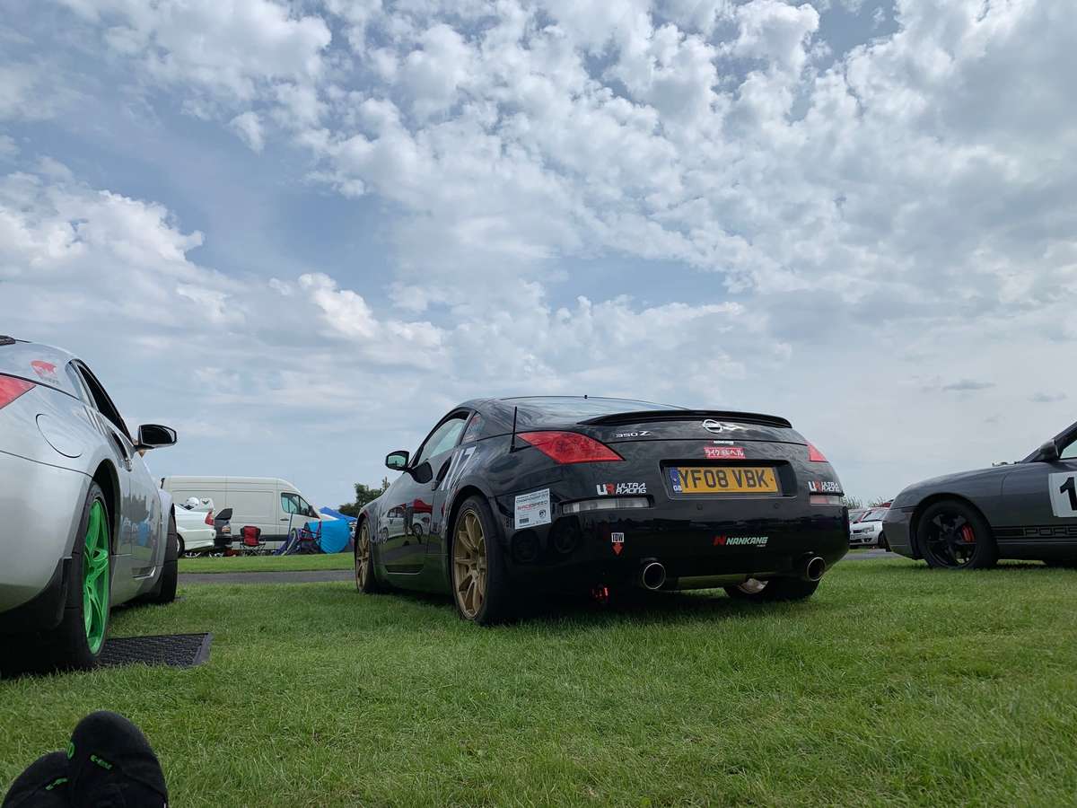

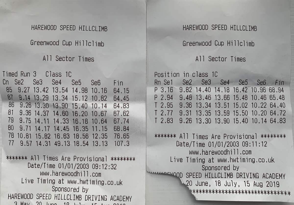

Fast forward to now, just finished another round of harewood hillclimb championship. Now I was getting De-Ja-Vu during the week as its been forecast showers/rain for Sunday all week but luckily on Saturday it changed to just afternoon so I took the decision to just go on the nankangs and leave the others at home. its was very cloudy on arrival but dry and fairly warm so things were looking ok, heading down for first practice but who turns up, yep, Suzy Showers, nooooooo, I was ready to go cry in a corner but it turned out it was just a brief shower and that set the tone for the day really, warm and humid with the occasion light shower, so onto times. I was conscious I had not really posted any time of note so far this year and in my eagerness to get into the top few positions on the leaderboard I probably overdrove the first run squeeling round every corner and the brakes seem to be "going off" there is plenty of meat left on them but I was having trouble slowing down and I was breaking in the same spots as previous, really pushing the pedal and it just was not stopping quick enough, not locking up either so something I will have to look at moving forward. anyway a 67 second time was posted to put me in 4th. onto run 2, similar conditions and dialled back slightly to record a 66 sec, upto 3rd. still having big trouble at a sharp 120deg right where you brake from 70 to next to nothing.
For run 3 I increased the tyre pressures to 36 rear, 37 front. I had been reducing them all day to the point of around 32psi but thought what the hell, lets just try upping them as according to nankang, for 1400kg+ cars pressure should be 34-42.
It must have made a difference as last run (albeit with a brief sunny spell as well) was a 65 second effort to get me into 2nd in class. It was by no means a clean run as you could tell from the video below, a few mistakes/corrections and I was coming off power slightly earlier than ideal due to fading brakes so it bodes well for future, its still amazes me how much better the nankangs are when the sun is out or its warm and how relatively poor they are when its cold.
Best not finish without saying that @Kieran O'Quick once again took the win which normally is a given BUT earnt extra brownie points today as he had car issues all day, (fuel pump intermittent) sensors needed changing, had an OFF and hit a pear tree, tried to copy me in wrecking a bumper and generally spent more time under the car than in it), so well done and sitting currently 2nd in the championship.
I am lying around 15th with all the issues but still hoping to get into top 10 come end of year with hopefully some warm sunny days to come.

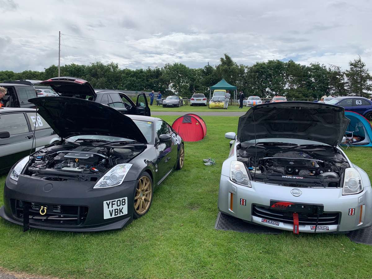

It was basically a battle of JDM Vs the Germans
Myself, Kieren (350z) and Andy (MR2 turbo) along with non JDM Terry in his Talbot Subeam vs various BMW M3s, Z3s, Z4s, Minis and Porsches
And I have only just realised now that us 4 took the top 4 spots with all Zi Germans behind us
And another trophy to finish the day which goes a little way to making up for the hours and money spent last month, onwards and upwards!

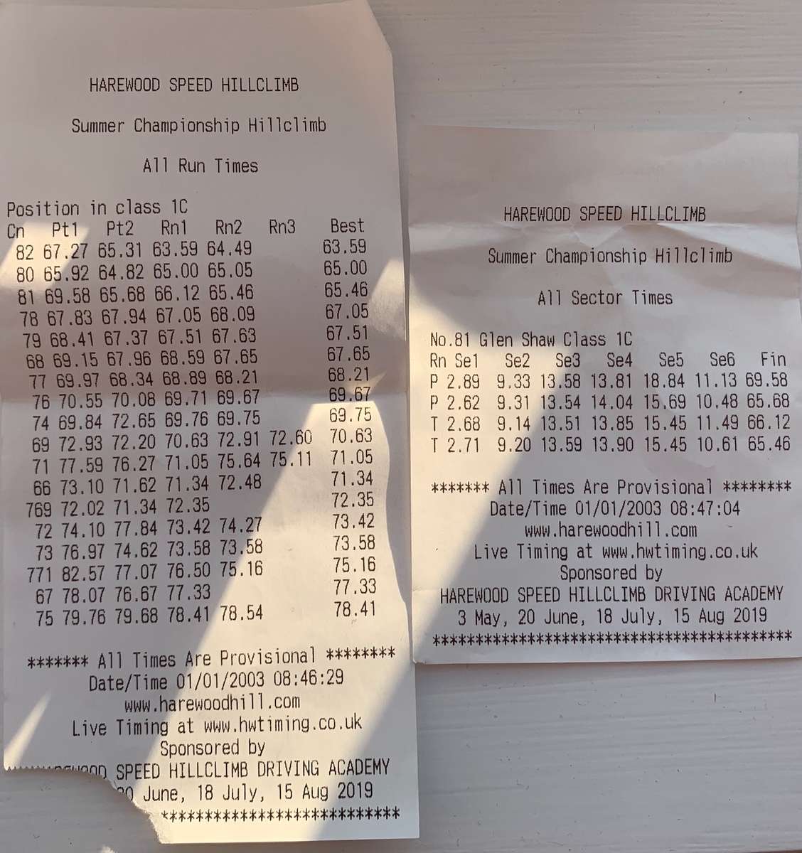

So all fitted, it was onto the next event in July which was a nice warm one I was looking forward to. Practice was 2 runs and the second effort got me a 64.8 (only a tenth off my PB) so I was expecting big things in the afternoon.
Sadly, the times went backwards. My practice run was smooth and precise rather than balls out. The afternoon runs, with me thinking I can smash my PB were just too aggressive and loose. The late braking (and the dreaded brake fade) did not work as I just couldn't stop for the corners so was sliding round losing time. That coupled with lots of accidents/hold ups on the day meant we only got 2 timed runs and my quickest was 65.48, still good enough for 3rd but 2nd was identical time to my practice run so should have been mine. I put the brake fade down to shear heat of the day but something was still not right.
Times below, me number 59

Shot below of someone else going off just to prove its not just me that cant drive:
and a nice landscape/sky/weather/moody shot of the zed, don't know what correct term is.

So next up as mentioned was the JPS show in Coventry. Now I didn't take any pics but some of you will have already seen I did make a short video of the show and I do have a picture of my Zed ready to go in the morning after waking up the neighbours at 5:30
Freshly waxed but the front bumper is gonna have to wait until the winter to get painted/wrapped.
It was great to meet up with the forum massive once again and some new faces as well. Great selection of Zeds on the group stand although as someone said, the 350s are starting to get thin on the ground now some of them are 16/17 years old! Video below:

So onto the hillclimbing: round 7 and we had a lovely day for it, this was the early morning shots:
Yes, A lovely Renault Alpine A110 had come to have a go. The mature owner had only had it a month and just come back from a 2000 mile trip round Europe so needless to say, he didn't trouble the top of the leaderboard understandibly but it did get a lot of attention throughout the day.
Bit of a frustrating day for me as braking wasn't the best yet again. I think in hindsight this was in part due to the 2 year old nankangs being well past their best and then me putting standard pads back on thinking they were the issue so the last 2 sectors I was losing chunks of time meaning my best time of 65.46 was well down on similar conditions from previous year. something needed doing but what....

All 3 timed runs in the 64's The grip these things give you and the confidence to thrown it round corners is incredible. I have said this before and will just stress again, now wonder F1 spends hours debating tyres, almost a second quicker just chucking on a new set and in T1 beat my PB by 3 tengths. I honestly thought I was on for a 63 but excitement got the better of me and a mistake in the next 2 runs cost me half a second each time. I wwas on for the win as well but Terry in the Talbot pipped me on the last run to snatch victory away (he too set a new PB on Extremes) @Kieran O'Quick had an unusual off day and problems/errors meant he finished behind Me and Terry.
Just for info I have the soft R5 compound on the rears and the medium R7 compound on the fronts, to stress the unusual quality the 255 fronts and 265 rears are exactly the same width, when you offer them up side by side or stack them laying flat they are identical, im not sure if the seating part is different as they seem to fit the different width wheels I have fine. To give you an idea of how "soft" they are, I travelled to the event in them, around 20 miles cruising on the motorway at 60mph as I had issues with the wet tyre offering from them overheating on the motorway if you recall. I arrived at harewood around 7:30, the grass was wet and when I parked up the rear tyres were steaming, they were very hot to the touch and burning off the moisture from the ground so again, I would not recommend them for a daily car unless you got the hard compound.
Onto Today (Sunday) and to quote another quote, "what a difference a day makes"
From the dizzy heights of a PB and regular 64's we arrived today to find that what the british weather gaves us in one hand, they now taketh away in the other. fairly cold, windy and rain in the air, although not forecast till the afternoon, it was looking bleak all day. The tyres, even the softs could not switch on until the latter part of the run meaning everyone was complaining about poor starts and lack of grip. There were several first turn incidents including Julian in our class in his MX5 who never managed to record a time. Jonathan who was 2nd in the championship had major problems and didn't get to record a time and lots of people had offs probably due to a number of factors but the colder conditions definitely didn't help. My times were consistently in the low 65's but I just couldn't get a 64. Terry was in the exact same boat and we were posting almost identical times all day. I finally finished 0.05 secs in front of him but we were both frustrated. Kieran grabbed the win again after he must have been up all night crying at both not getting a trophy Saturday and blowing the chance of a top 3 finish in the Championship, he ultimately finished 5th so will get a trophy at the awards night. Myself and Terry after a season long battle ultimately finished just outside the top 10 in 14th and 12th respectively but still not a bad showing, gonna have a long think about what to do for next season to get into the elusive top 10, maybe new cams???
Final leaderboard below out of 164 championship contenders:
