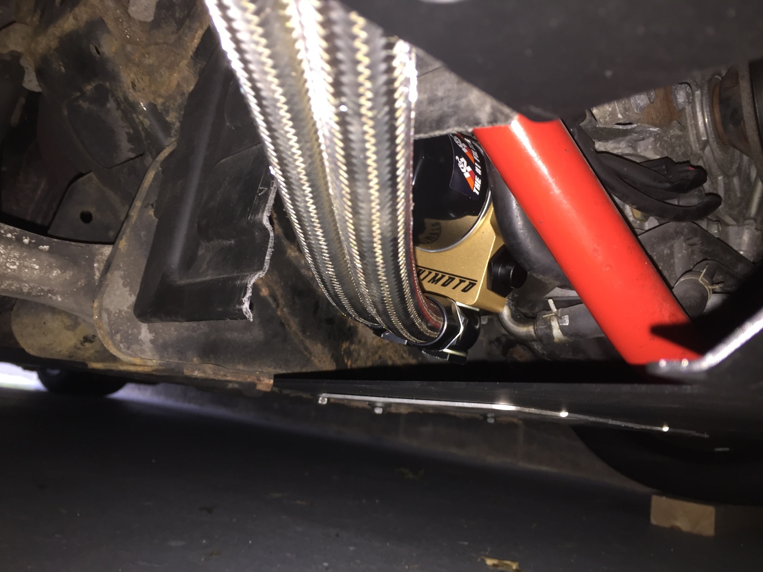

Then Torqen had one of their sales they like to do, and I had been looking at oil coolers for a while so when the mishimoto one came up at a great price I plunged in, then decided it was time for me to get my hands dirty and fitted it myself. Suprisingley it was fairly straight forward. It bolts into existing holes in front of the other rads, the braided lines and fittings are easy to connect and so is the sandwich plate, the only extra work involved is cutting part of the plastic undertrim to run the hoses round but all in all very easy, no leaks and I was proud of myself. It was around this time I started considering doing track days in my own car rather than experience days I had done previously. Its all good spending money upgrading a car but if its never put to good use it may as well have stayed standard.
I think we are upto middle of last year now and around that time I decided to pop my 350 show cherry. I booked for the Japanese performance show in Coventry for September on the 350-uk stand and quickly decided I needed to do something about the "non showroom condition" car I had possession of. I started by tackling the shoddy interior plastics we all know and loathe. I wish I could say the orange rear strut bar cover was the work of a blind man but alas, no, I had done it a few weeks after purchase to match the alezan seats but I know realise why the local graffiti mob didn't even want me. anyway, I can safely say they are all looking much smarter now, no new pics i'm afraid, i'm not that stupid, you will just have to take my word for it. I also ventured for the first time into the world of detailing so got myself a da polisher with pads and polish recommended by the forum, it really is a wealth of great information, and I set about either smartening up or destroying my paintwork, it was a 50/50 gamble I was willing to take.

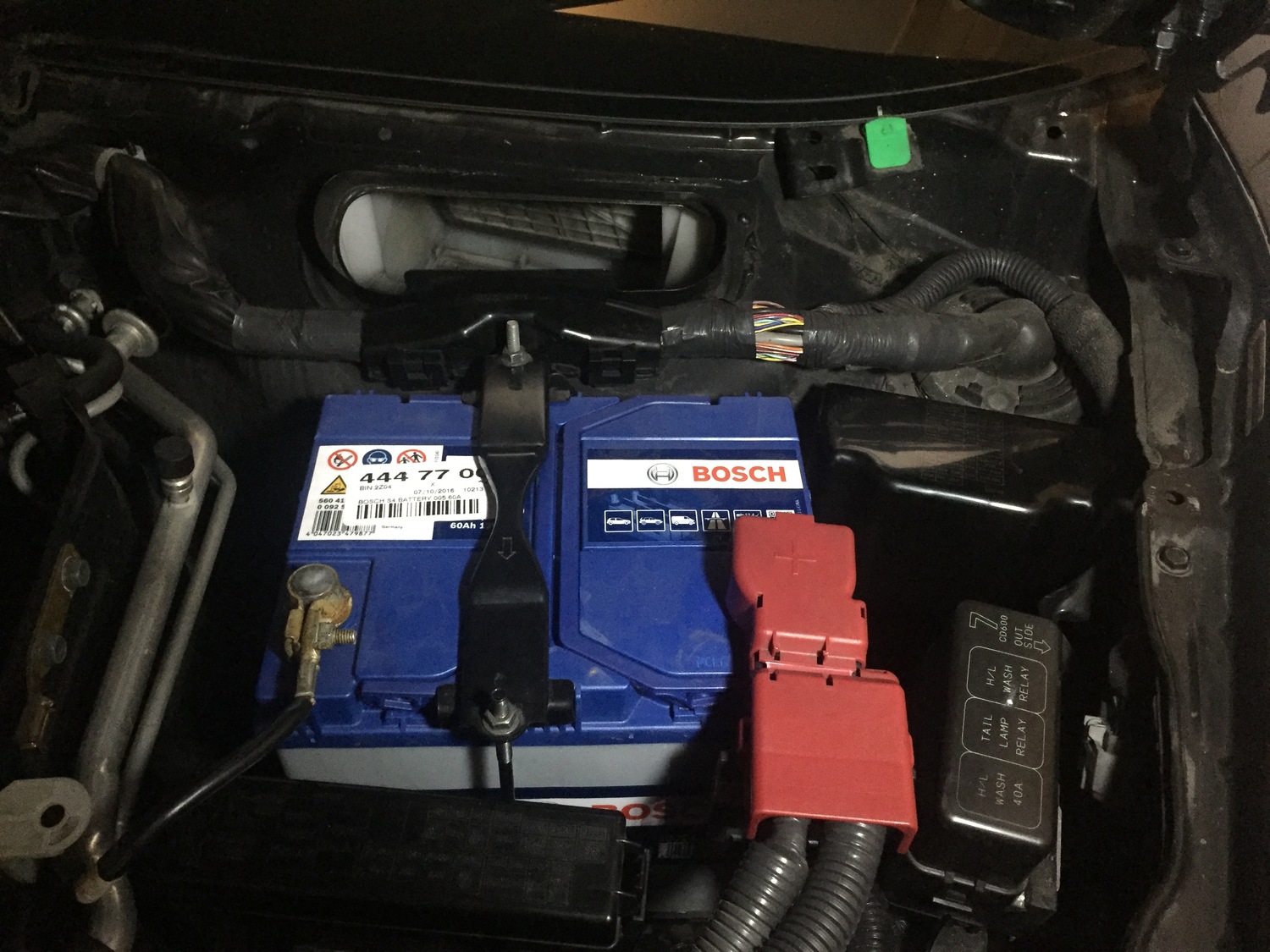

Then because its a weekend car and if its raining it doesn't get used the battery had been struggling for a couple of months until it finally said no more. I got a shiny new bosch S4 from euro car parts. It was still the original battery after 8 years so it had done a good stint.

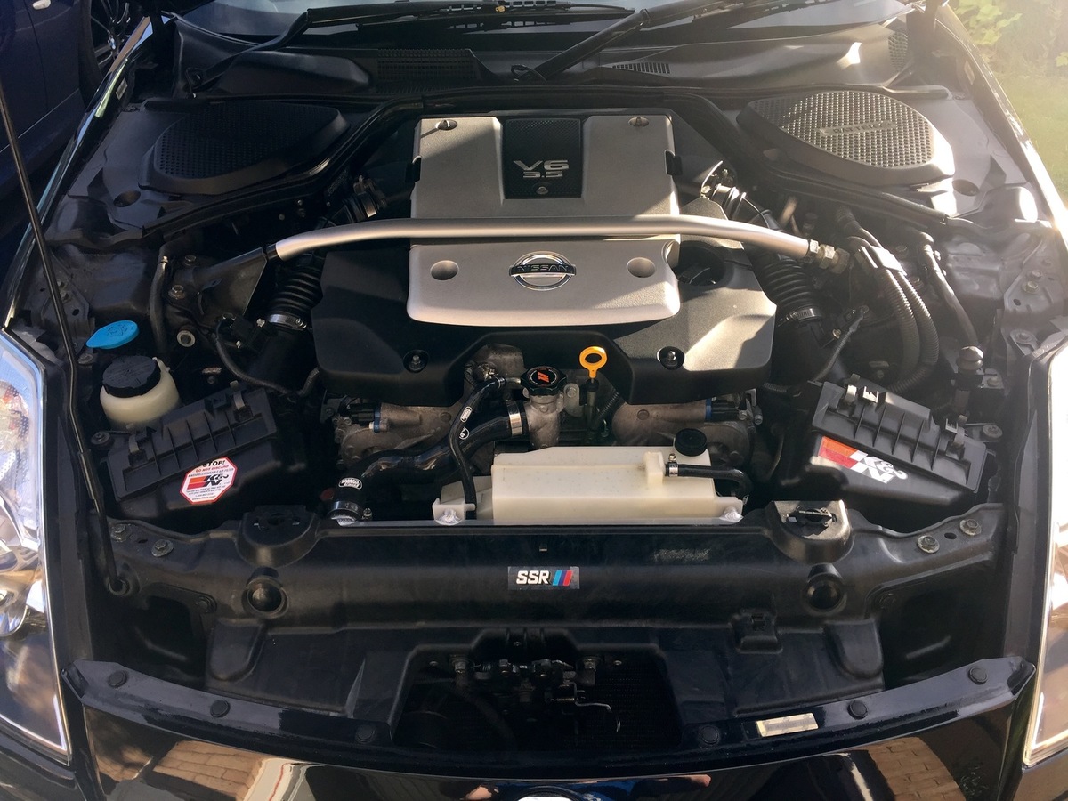

Then with my first show around the corner, thought I best clean up the engine bay a little, I know how people like to stare at engines and even though I had no bling it still needed to look loved.

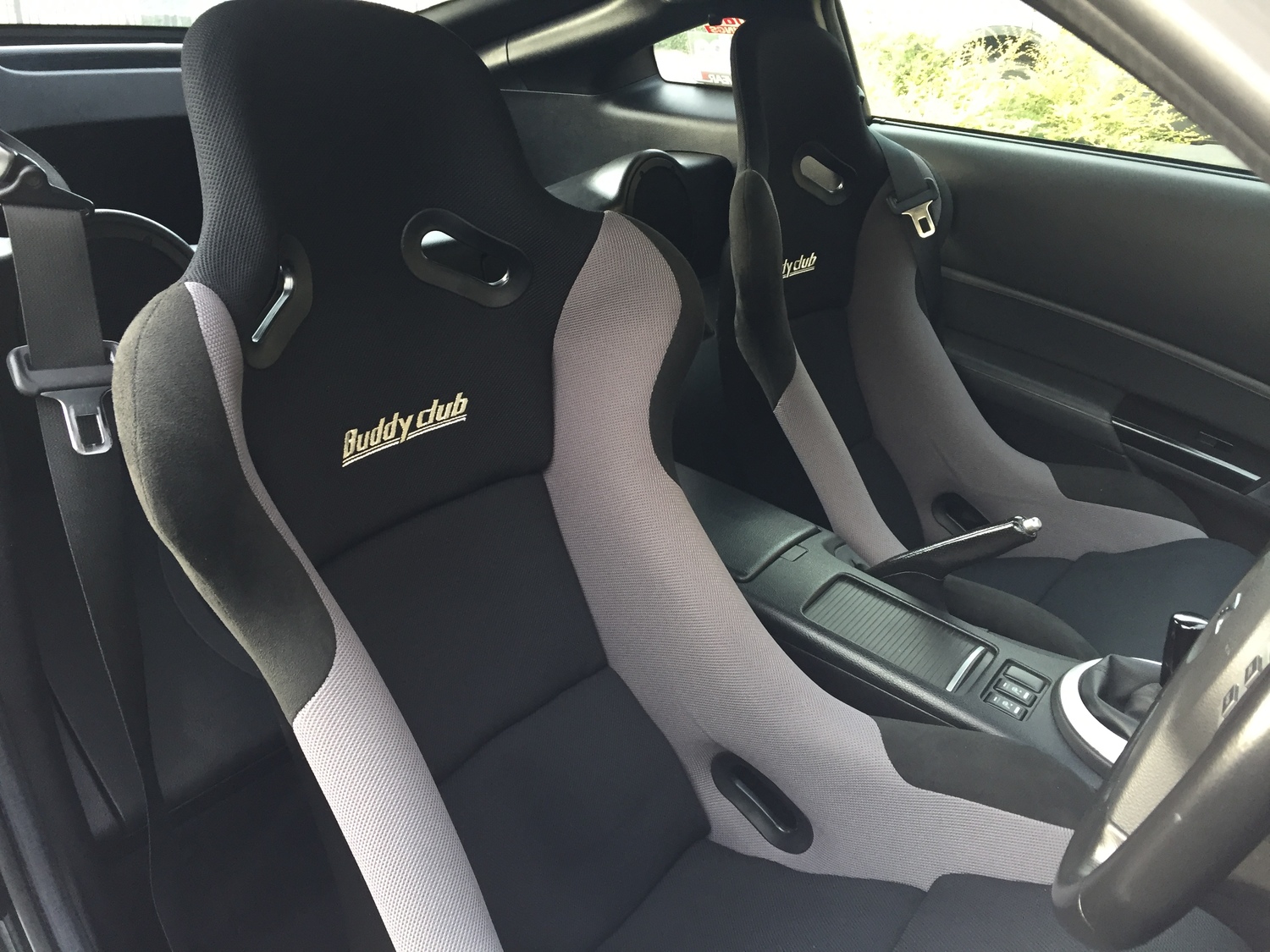

Back to seats, the common issue with the OEM seats is lack of support and no matter how determined you are, when you start sliding sideways in the seat it takes your attention and focus away from the car and corner. So off I went to GSM at Nottingham to try a few out. I was gonna dive right in with the ones I liked the look of best but thank god the forum spoke to me and said make sure they fit right first. Sound advice and I would stress for everybody to try before they buy. After sitting in a dozen or so the one that seemed to fit my body shape best of all was the buddyclub racing bucket seats. They just hold every part of the body snuggly and are perfect size as well as only 5kg each! So after numerous failed phonecalls to GSM I went direct to buddyclub uk and ordered the seats with the buddyclub sliding rails. On the lowest setting they are the same height as OEM seats, I even soldered in the airbag restrictors, again thanks to guide off the forum and no lights on the dash, success.
I am the first to admit, they are not the best looking seat on the market, but they do compliment the interior nicely and its much more function over form. At this point I removed the boot weight, spare wheel and sold the oem alezan seats to another forum member. Total weight saving around 50kg.

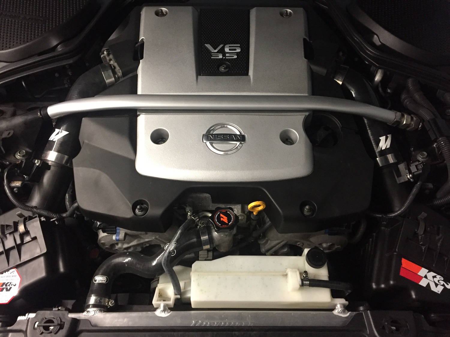

The final mod done before year end was a set of mishimoto air intake hoses, These are a real pain to fit as they are designed for the 370 so need a bit of cutting but they are slightly bigger diameter, look better and fit in with the rest of mishimoto stuff in engine bay keeping the oem+ look.

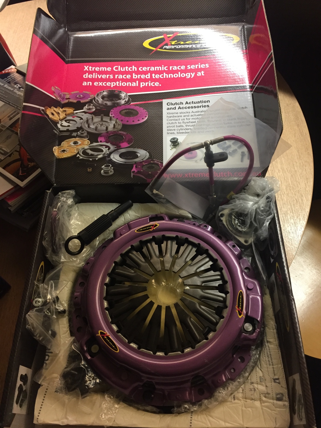

A New Xtreme SMF complete clutch kit with new slave cylinder and braided clutch line with high temp clutch fluid. Another kit highly recommended by traders and it gets my seal of approval, I always thought my clutch was high, but everyone says its a trait of the zed and because it never slipped I lived with it. But when the old clutch (still original) came off Andy said there was very little life left in it and the new xtreme kit has a much lower pedal bite, just what I wanted as well as improved response and another 5kg or more weight saving. win win, the chatter people complain about is none existant if you have an aftermarket exhaust system, the exhaust noise is louder than the clutch so I can't hear it.

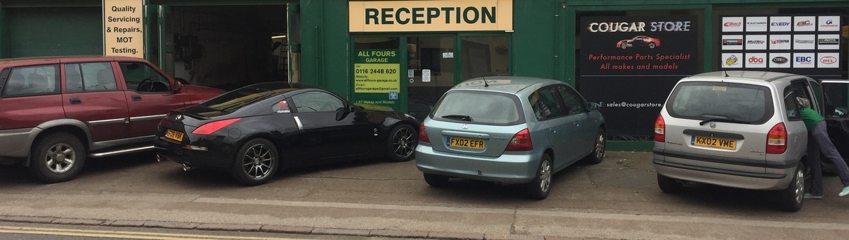

Pic below of the zeds second home, I was contemplating putting All fours garage down as where the vehicle will be kept on the insurance as its spent a lot of time there over last 14 months.

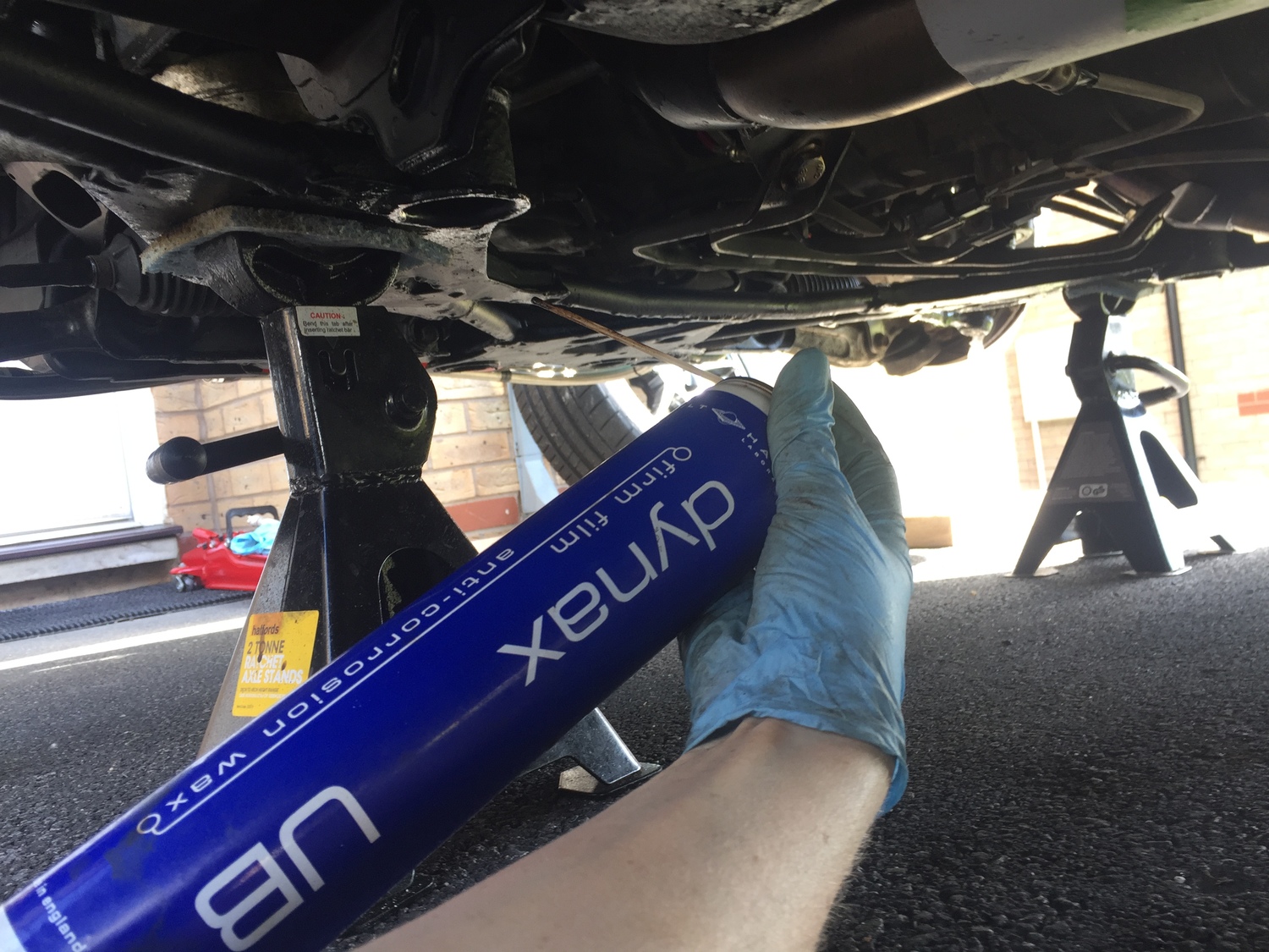

It was then time for the dynax stuff. Now in the kit you get 4 cans. 2 of S50, and 1 each of UB and UC. Now what the F is all that about i hear you cry. Well I said the same thing so I had to do the one thing all men hate and detest. Yep I had to read the instructions. After breaking into a cold sweat I gathered the info that;
S50 is for cavitys and areas away from impact, UB is for underbody and high impact areas, UC is similar to UB but dries clear so is better for seen parts where you wouldnt want a brown/black coating.
So off i went. The S50 was squirted into the arch crevices and anywhere there was a hole underneath the car (insert rude joke)
The UB was then sprayed on the underside where i thought it needed it. Like I mentioned before, it was pretty good anyway and i could not see a lot of the steel as it was already coated in something but the subframe got a blast as did the W brace for good measure, that W brace must be rot proof for at least 50 years now with the amount of stuff I've put on it.
Then i used the UC for the wheel wells, underneath the skirts, and rear shell. The first pic shows it wet and it has a glossy almost laquer appearence but it does dry almost perfectly clear as you can see from the other pics.

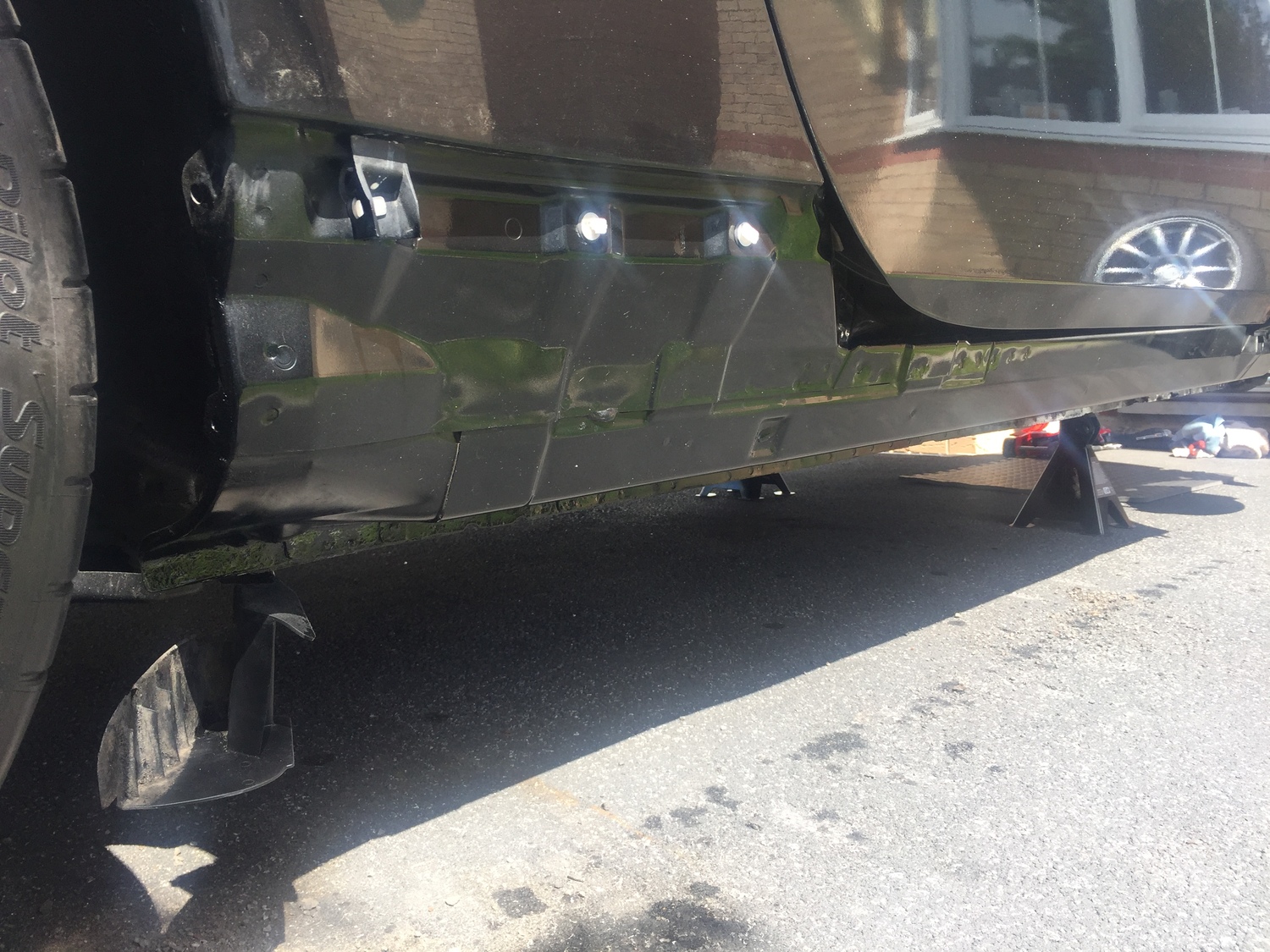

Sideskirts, very good condition anyway, bits of rust starting at rear where they stop for rear wheel.
and rear of car behind bumper, again in very good nick.

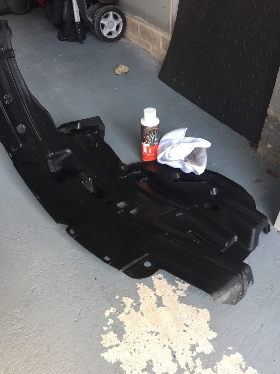

Then before the arch liners went back on, I coated them with some G-technic tyre and trim stuff which brought them back upto almost new.

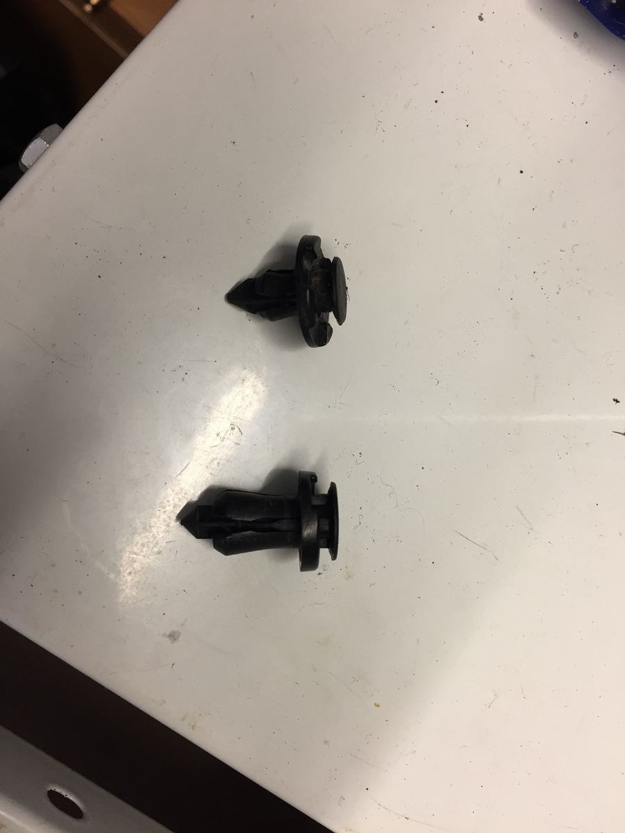

Its the bottom one in the pic Stu. I have put the smaller one in the pic to avoid confusion. They smaller ones are used all over the car to hold various trims and pieces in place. The larger ones i need are not so common and as i said its what holds the top of the front bumper to the car.

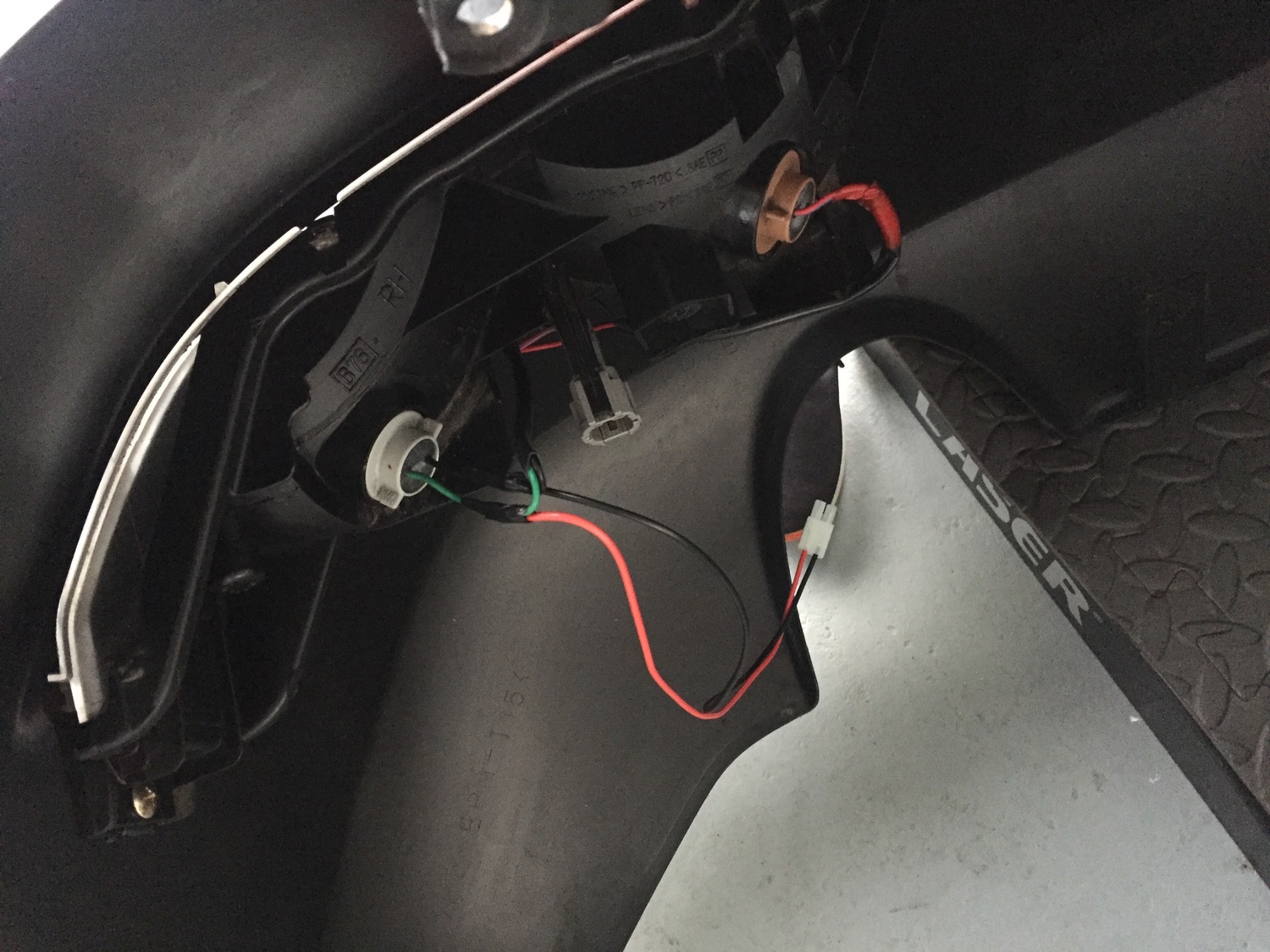

whilst the car had all the bits off and it was such a faff removing everything I thought I would help bring the zed into 2017 with the help of some LEDs. With it being a HR it already has the led rear brake cluster and xenon headlights so the rest of the bulbs were letting it down.
This is what i purchased online for £70 after checking the definative bulb list on here and double checking the actual fitments I can confirm these are all correct to replace the rear indicators, (amber x2) rear fog and rear reverse light (white) rear number plate (white x2)
and side indicators (amber x2)

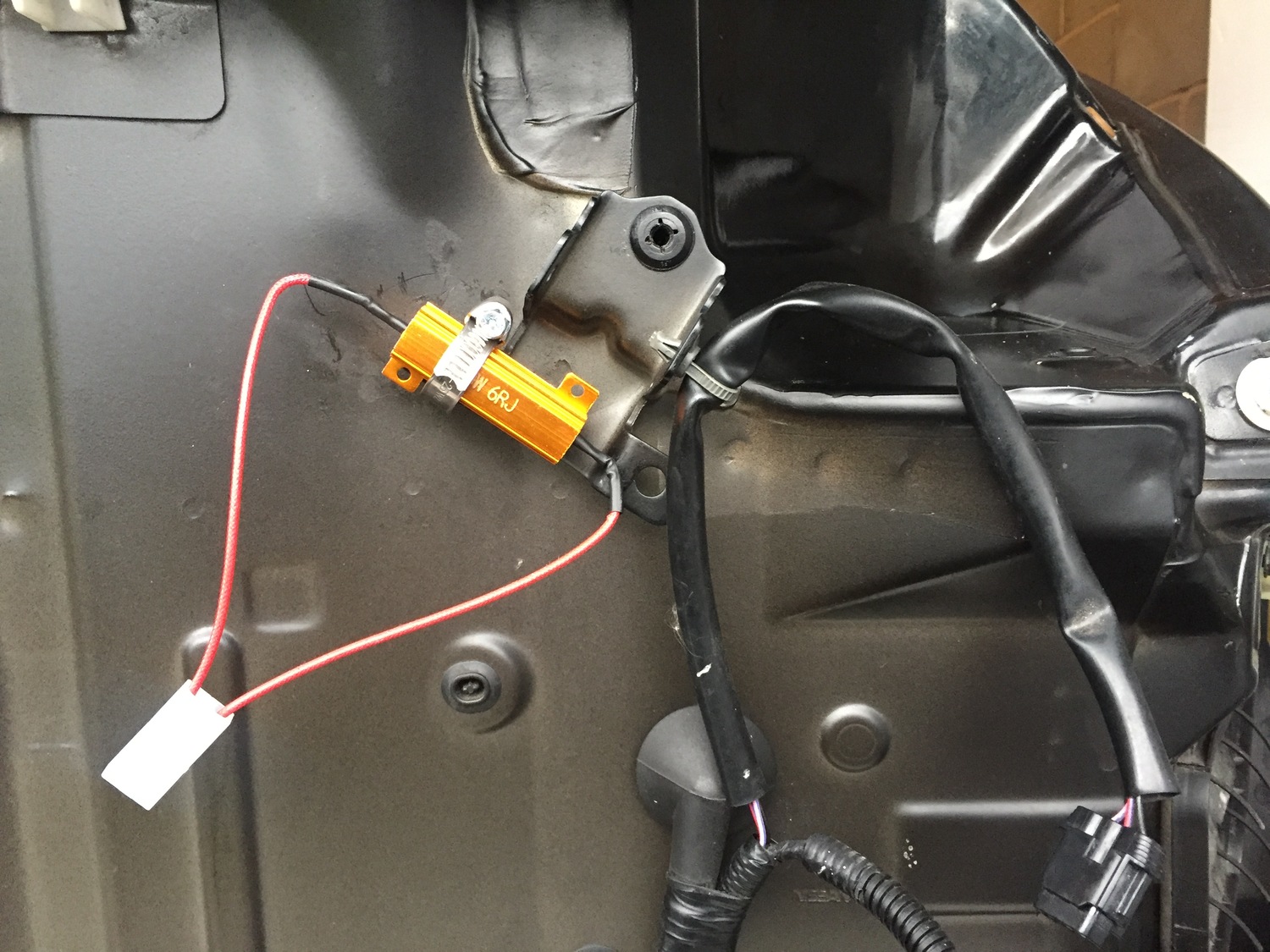

Now in my usual fashion, I bought these and fitted them only to find out that my indicators now blink at 300 times a second. Hyperflash I believe is the common term. This for all you other novices is due to the leds drawing less power and having less resistance than standard bulbs. The car thinks a bulb is blown so flashes fast as a warning sign. It might also be because the resistance is less resulting in a faster flash. I lost interest reading online. Anyway the solution is either to replace the flasher control module (easier but not possible on a zed as it doesnt have one) or wire in resistors to the circuit.
So after more searching i found that people use 50w resistors at anywhere from 4ohms to 8ohms. So I purchased some at 6ohms from Amazon, only £8 for two. You need one per indicator. You dont actually need any for the number plates, reverse light or fog light as the are constant on or off. The resistors come with wire attached and splices to cut into existing wires but as i already had a solder gun and solder wire i wanted a more permanent fix. I also read that some resistors burn out over time so people put connectors onto them so its a quick change over if they do. I decided to do this and took a trip down to maplin to buy 2 male connector blocks, 2 female and a metre of each red and black 1mm wire.
I stripped the cable on the existing indicator wires and cut approx 400mm of wire i had bought then soldered together, wrapped in electricsl tape and put the connector block at the other end of the 2 wires which uses a crimp type thing to hold the wire, pic below
You have to mount the resistors to metal as apparently they can get very hot and melt plastic so i found a perfect spot on either side of the car shell behind the bumper, connected the female connector block to the 2 wires and secured with a 18-25mm jubilee clip. I added a thin layer of foam behind the resistor just to cushion everything. Think it looks rather neat.
You can then connect the male and female connectors together when you re-install the rear bumper and there is plenty of slack on the wires. Pic below. Just to note: it does not matter which wire from the light you connect to which wire from the resistor, and people also said that leds only work one way round in the fitting, I had all mine work 1st time round then took them all out, fitted resistors and they all worked second time so dont think it makes any difference.
and finally tested all ok. This shows the indicator in bright daylight which was still impressive so should look awesome at night.
The other leds as I mentioned before just swap straight over. The side indicators housing needs to be released from inside the arch so needs the front liner off. All in all very impressed and indicators now flash as normal so can confirm the resistors are correct. Anyone wanting to do this as i have will need:
Leds as 1st pic (approx £70) online/ebay
1mtr red 1mm wire, 1mtr black 1mm wire, 2no female plastic connector blocks, 2no male plastic connector blocks (approx £15) Maplin
2no 50w 6ohm resistors with splices £8 Amazon
2no 18-25mm jubilee clips £3 Halfords
optional: solder gun and solder, backing foam, electrical tape.

The following day I decided to give the Zed a wash and use some of the new products I have started selling. A pre wash snow foam, then washed (gtechniq gwash), then clayed, then Carchem PTFE polish followed by Carchem hydrocoat. The hydrocoat really does add a nice shine as you can see in the second pic, wing coated, bonnet not coated, or maybe it was the light, either way the car looked great when it was all finished.
Then sometime in December I think @davey_83 mentioned how he had purchased a c-tek charger for over the winter and thinking that mine may be stood for a few months, I took up the recommendation and purchased one of these:
Now they come with 2 types of connector as in pic, the clamps and the eyelets. This is a great idea as I have screwed in the eyelets to the terminals and because they are wired to a connector block that has a rubber sealed end, you can just leave it hanging in the battery compartment area so no faffing around next time you want to connect it and it still leaves the clamp connections spare for use on another vehicle. They are a great piece of kit for around £60-£70.
That was it and Christmas come and went and onwards and upwards into 2018. The Zed has been sat in the garage and being stood there got me thinking about how I can get more use and enjoyment out of her this year. I went to this last year and watched Kieran from the forum in his 350z flying up the hill.
