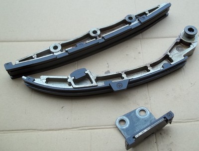

SamJulian Posted March 17, 2017 Share Posted March 17, 2017 Hope this is the right section! My engines currently stripped down and noticed the top chain guide has some wear on it so after a replacement, mine has 3 bolt holes like this... http://i.ebayimg.com...9BWJ2dk/$_1.JPG But the only replacements i can seem to find only have 2 bolt holes like this... http://images.eselle.../13085JK20A.jpg Is this just how all the replacements are now or am i just looking at the wrong part? And wheres the best place to buy them? Thanks, Sam Quote Link to comment Share on other sites More sharing options...

Adrian@TORQEN Posted March 17, 2017 Share Posted March 17, 2017 Old part 13085-AL500 was superseded by the one with 2 holes: 13085-JK20A Quote Link to comment Share on other sites More sharing options...
gsexr Posted March 17, 2017 Share Posted March 17, 2017 I`d want to make sure the holes are blind then if a bolt is to be left out. Just in case it goes into an oil way. Quote Link to comment Share on other sites More sharing options...
SamJulian Posted March 17, 2017 Author Share Posted March 17, 2017 Hi Adrian, Yeah that's the one! Thank you very much you actual hero you're slowly ticking off my build list haha And there's no worries there gsexr, its just a plain threaded hole in the rear timing cover, no oil way. Sam 1 Quote Link to comment Share on other sites More sharing options...
