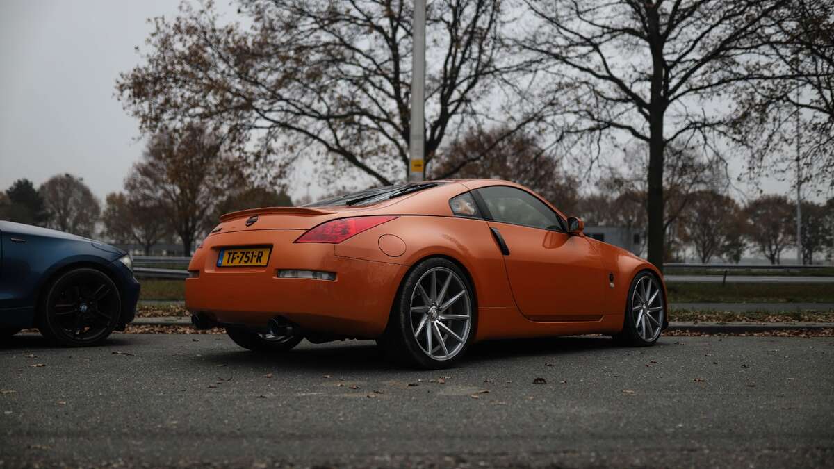

davey_83 Posted November 20, 2020 Share Posted November 20, 2020 Ahhhh got yah. I went with 245/35 and 265/35 with the same wheels, adding a bit of stretch and helping with clearance too. 2 Quote Link to comment Share on other sites More sharing options...
Hansburger Posted November 20, 2020 Author Share Posted November 20, 2020 I like to have the most width tires possible. In the front no issues, but for the back it's just to much. Or my car is to low. Also a possibility. Hahah. Just gonna raise the back a cm more. Quote Link to comment Share on other sites More sharing options...

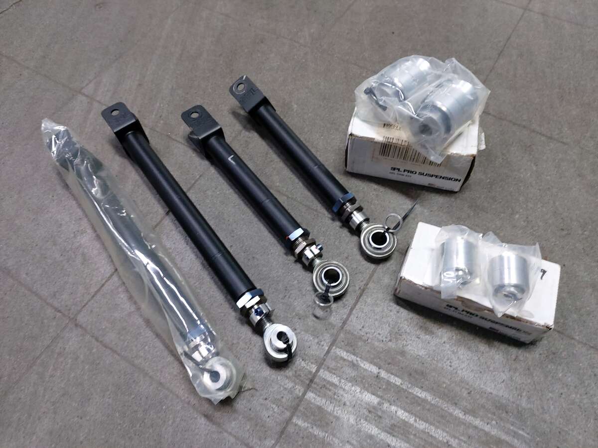

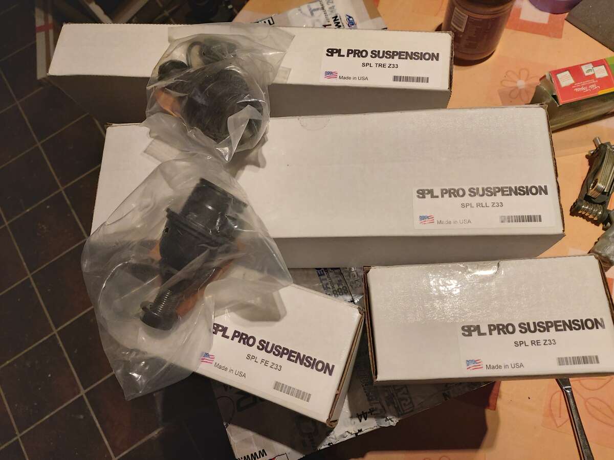

Hansburger Posted December 9, 2020 Author Share Posted December 9, 2020 (edited) I tried the other wheels this week. Really love the look of them! Also ordered some more SPL goodies at @Adrian@TORQEN and got a Kaaz 1.5 diff. Last but nog least... I got myself a VQ37. Let's start with the VQ37HR project this winter. Edited December 9, 2020 by Hansburger 4 Quote Link to comment Share on other sites More sharing options...
davey_83 Posted December 10, 2020 Share Posted December 10, 2020 Subscribed 1 Quote Link to comment Share on other sites More sharing options...
Adrian@TORQEN Posted December 10, 2020 Share Posted December 10, 2020 Thanks Hans! SPL will be here Monday 1 Quote Link to comment Share on other sites More sharing options...
nissanjuke Posted December 10, 2020 Share Posted December 10, 2020 love your photos of the NC 500 ROUTE must do for 2021 1 Quote Link to comment Share on other sites More sharing options...
Hansburger Posted December 10, 2020 Author Share Posted December 10, 2020 4 hours ago, Adrian@TORQEN said: Thanks Hans! SPL will be here Monday Woohoo! I really love this SPL parts. They look so great. Hopefully they will give my car an even better handling then it does already. 1 Quote Link to comment Share on other sites More sharing options...
Hansburger Posted December 10, 2020 Author Share Posted December 10, 2020 1 minute ago, nissanjuke said: love your photos of the NC 500 ROUTE must do for 2021 One of the best trips I have ever done. Gonna do it again some day... But I have to say Croatia and Austria are also worth it. Quote Link to comment Share on other sites More sharing options...
Hansburger Posted December 17, 2020 Author Share Posted December 17, 2020 Woohoo! Thanks @Adrian@TORQEN! The building continues. Got some more SPL stuff and a new chain set. Let's get started with the VQ37HR. 3 Quote Link to comment Share on other sites More sharing options...

Hansburger Posted May 11, 2022 Author Share Posted May 11, 2022 I think it's time for a little update... 😛 Been a while and ofcourse we're still having fun with Nemo. Sorry. Picture heavy... Cleaned the rear hatch and removed the weight. Replaced the trunk struts with all new OEM goodies. And the springs by the replacement parts from OpenTop. Gave it his yearly undercarriage wash. All shiny as it's supposed to be. I finally got rid of that narrow steering wheel and ordered new knobs. Also did the handbrake in the same style, alcantara and orange stitching. We finally did some maintenance and fitted the SPL and Driftworks goodies together with the Ultra Racing bars. Really love the way it handles now, it made such a difference! Even the guy that did the allignment was in love. 😍 Aaaaaaand another tour for charity; Dag met een Lach. 😇 A Fundraiser rally in with we participate every year. So much fun with the Z! I only blew my Berk catalists allong the way. At 7.500 RPM the inner ceramics came lose and plugged the exhaust in the back. All the power was gone! At first I thought I blew the engine, to find out it just could not breath anymore. 😛 Luckily Mario and Luigi were there to help! Hahah. Bought myself a set of Toyo R888 tires to play around. And we changed the exhaust again! New Berk HFC's, a ISR single exhaust and Tarmac Sportz Y-pipe. 😎 Still love the way A 350Z looks. So why don't we keep on changing wheels... But in the end I'm again changing back to the GTR wheels. Just love them on my Z! 🤔🤣😂 By the way... My threepiece wheels are at the shop and getting all fresh. After so many years the paint started to peel off and I wanted the inner wheels to be black too. Can't wait to get them back. 😍 At the moment the car is at the garage. Unfortunately my oil gallery gaskets have decided to stop doing their work. Luckily it needed some new oil as well. So just a bit of love and we're good to go again! Last but not least. Still busy with the VQ37HR build! Finally got some good news from the enginebuilder. It only needs a small rebore and we can use 96mm pistons. And I found a good crankshaft in Athens. 😎 Only a few parts needed and the build can start. I think this is it. Will try to keep this page updated the next time. 😛 Hahah. 4 Quote Link to comment Share on other sites More sharing options...

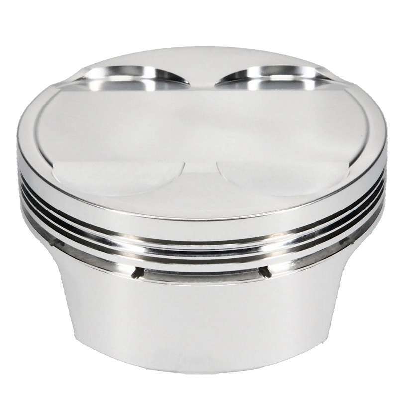

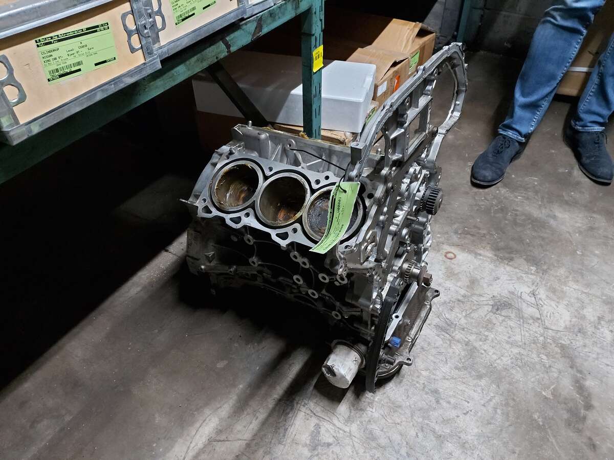

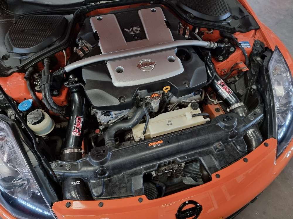

Hansburger Posted May 31, 2022 Author Share Posted May 31, 2022 Engine is back together and oil gallery gaskets are replaced. 😍 Let's see what the oil pressure will do. At the moment it's a bit high in my opinion.... Not sure what we need to do about it. Hopefully it's going to be back normal in a few weeks. Aaaaaand! Finally I ordered myself the pistons for the VQ37HR build. 😎 JE 11.5 compression / 96mm Let's continue building. 💪 4 Quote Link to comment Share on other sites More sharing options...

350Butcher Posted June 2, 2022 Share Posted June 2, 2022 Great looking, great spec Z! And about to get better! So you're running with the vq37 rods........JE stuff is nice, do the new pistons have enough valve relief in them to clear the vq35hr exhaust valves? You're gonna love the new engine.........still surprises me how fast my car is now when fully stretched out and I've done few '000 miles on it so thought it would start feeling "normal" 1 Quote Link to comment Share on other sites More sharing options...
Hansburger Posted June 2, 2022 Author Share Posted June 2, 2022 2 hours ago, 350Butcher said: Great looking, great spec Z! And about to get better! So you're running with the vq37 rods........JE stuff is nice, do the new pistons have enough valve relief in them to clear the vq35hr exhaust valves? You're gonna love the new engine.........still surprises me how fast my car is now when fully stretched out and I've done few '000 miles on it so thought it would start feeling "normal" Yes! We gonne use the VQ37 rods. They should be enough strong enough for my build. And I just couldn't find any lighter rods, except for some very ver very expensive ones. 🤣 According to the company where I ordered the pistons the clearance must be enough. Just waiting for the pistons to be delivered and then the engine can go to the builder. @itsLeon will put it back together and we will see what it's going to do. I believe you love yours. Should sound very good as well. 😎 Just a question. Where's the redline at your engine? I want to get is somewhere up to 8.000 revs. Just to have that little bit extra revs combined with the 4.08 final drive. Quote Link to comment Share on other sites More sharing options...
350Butcher Posted June 2, 2022 Share Posted June 2, 2022 7 minutes ago, Hansburger said: Yes! We gonne use the VQ37 rods. They should be enough strong enough for my build. And I just couldn't find any lighter rods, except for some very ver very expensive ones. 🤣 According to the company where I ordered the pistons the clearance must be enough. Just waiting for the pistons to be delivered and then the engine can go to the builder. @itsLeon will put it back together and we will see what it's going to do. I believe you love yours. Should sound very good as well. 😎 Just a question. Where's the redline at your engine? I want to get is somewhere up to 8.000 revs. Just to have that little bit extra revs combined with the 4.08 final drive. Good news re pistons mate. With regards to rods, I used BC rods which aren't anything too special but are steel so plenty strong enough for what I was doing but reduce weight quite significantly over the oem cast items without being loads of ££. Obviously costs always come into play but if you can I'd add these to your build. Oem rods with bolts 656g BC Pro with ARP2000 bolts 575g Just over 12% weight saving and nearly half a kilo off over the 6cylinders.......makes a huge difference at 7-8k rpm Cheers! Yeah it sounds as angry and as keen as it goes......I will try and get a clip of it at some point! I set my rev limiter at the factory 7.5k rpm only for reliability really as I think a few oem cranks have cracked seeing 8k and I don't want to go there myself. With the 4.08 it'll be very impressive, I'm on the 3.9 and it dispatches gears pretty quick and easy. If you do go for 8k I'd be more interested in those steel rods and billet oil pump gears too This is what I installed.............and looking at how much they are now I'm glad I did it when I did ouch!! Great bit of kit though https://boundarypumps.com/shop/nissan/vq-vhr-billet-oil-pump-assembly/ 1 Quote Link to comment Share on other sites More sharing options...
Hansburger Posted June 3, 2022 Author Share Posted June 3, 2022 19 hours ago, 350Butcher said: Good news re pistons mate. With regards to rods, I used BC rods which aren't anything too special but are steel so plenty strong enough for what I was doing but reduce weight quite significantly over the oem cast items without being loads of ££. Obviously costs always come into play but if you can I'd add these to your build. Oem rods with bolts 656g BC Pro with ARP2000 bolts 575g Just over 12% weight saving and nearly half a kilo off over the 6cylinders.......makes a huge difference at 7-8k rpm Cheers! Yeah it sounds as angry and as keen as it goes......I will try and get a clip of it at some point! I set my rev limiter at the factory 7.5k rpm only for reliability really as I think a few oem cranks have cracked seeing 8k and I don't want to go there myself. With the 4.08 it'll be very impressive, I'm on the 3.9 and it dispatches gears pretty quick and easy. If you do go for 8k I'd be more interested in those steel rods and billet oil pump gears too This is what I installed.............and looking at how much they are now I'm glad I did it when I did ouch!! Great bit of kit though https://boundarypumps.com/shop/nissan/vq-vhr-billet-oil-pump-assembly/ I have asked how much a VQ37 rod weighs. I can order a set of K1 rods for a good price. They also weigh 575 grams. Gonne compare them. Your comment got me thinking. 😛 Also for the oil pump, I was looking at one of those months ago. Maybe just ease a bit on the build and spend a few Euros more. I'm not in a hurry. I really love the 4.08 rear end. It makes the Z so much more alive and especially on roads and circuits with a lot of bends it's really nice. Just the little extra a VQ needs. Have you got a sound clip or little movie somewhere from your car? Would like to hear something. Quote Link to comment Share on other sites More sharing options...

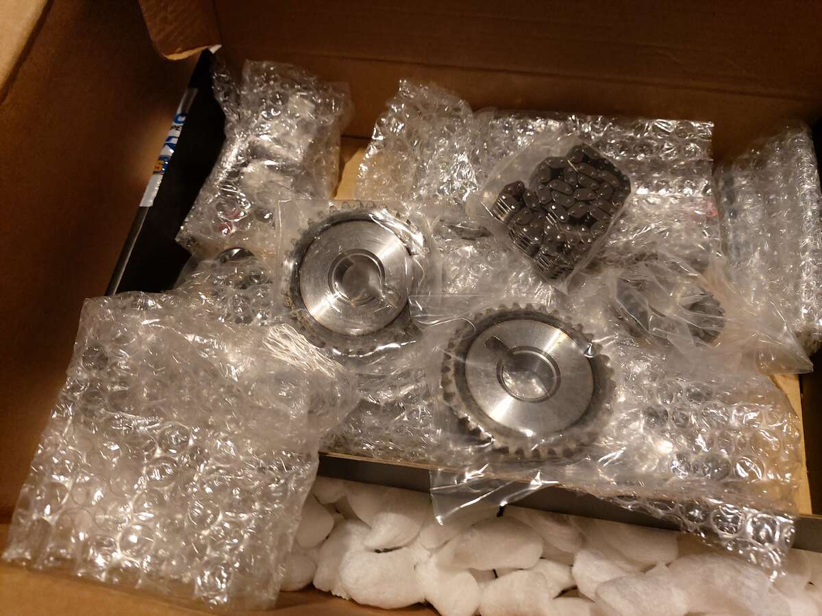

Hansburger Posted July 21, 2022 Author Share Posted July 21, 2022 (edited) Finally the new exhaust is rattle and leak free. 😎💪 The clamps which came with the Y-pipe from Tarmac Sportz are rubbish... Edit! Also ordered some rods for the VQ37 build. K1 rods weighing only 575 grams. And decided to go for the Boundary oil pump gears. 😍 Edited July 21, 2022 by Hansburger 2 Quote Link to comment Share on other sites More sharing options...

Hansburger Posted July 28, 2022 Author Share Posted July 28, 2022 A delivery by Concept Z Performance yesterday! The first OEM nuts and bolts arrived to replace the "rusty" ones from the undercarriage. 😎 Since I still need to fit the Kaaz differential I decided to get the Nismo cover as well. Aaaaaaand another part for the VQ37HR build! Making sure the oil pump gears don't schred apart in higher RPM's I ordered the billet gears from Boundary. 😍 1 Quote Link to comment Share on other sites More sharing options...
