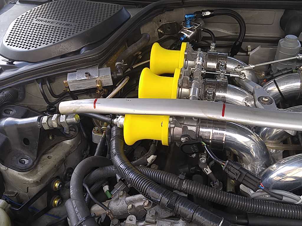

andybp Posted July 14, 2017 Author Share Posted July 14, 2017 As per the previous post I'm waiting for stuff to arrive so I can get on (AGAIN) so I thought I'd look at the strut brace, I was hoping that I could modify the brace a little to fit but there just isn't the clearance above so it's going to have to be more major than I had hoped (luckily I know where there's some stainless looking for a new home 1 Quote Link to comment Share on other sites More sharing options...

andybp Posted July 30, 2017 Author Share Posted July 30, 2017 have started on the strut brace took ages to get the bends right Now that bits in the rest should go a lot quicker also I've put fine mesh stainless filters over the velocity stacks and coated the stacks with resin to make them more heat resistant I've not been too fussy with this as I'll be changing the velocity stacks due to clearance issues that is once my new 3d printer arrives as I had a major meltdown with my old one and it's not worth repairing I've also been tuning the car on the road with the help of my wideband sensors the fuel map's getting better all of the time once I get it a bit better and some of the bugs sorted out I'll take it and get it mapped hopefully by the end of next month. 4 Quote Link to comment Share on other sites More sharing options...
