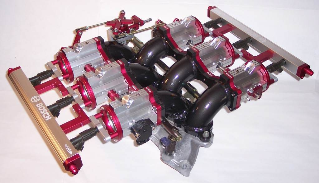

andybp Posted March 8, 2017 Author Share Posted March 8, 2017 (edited) spotted this while looking at the jenvey site £495+VAT think I'm definitely quids in mine's only cost me £30 Edited July 8, 2017 by andybp 1 Quote Link to comment Share on other sites More sharing options...
davey_83 Posted March 9, 2017 Share Posted March 9, 2017 Lol fair play!! Nice pick me up Quote Link to comment Share on other sites More sharing options...
Keyser Posted March 9, 2017 Share Posted March 9, 2017 And I think yours looks better 1 Quote Link to comment Share on other sites More sharing options...
Lexx Posted March 9, 2017 Share Posted March 9, 2017 Yours certainly looks neater. The saving is merely an added Bonus! 1 Quote Link to comment Share on other sites More sharing options...
andybp Posted March 9, 2017 Author Share Posted March 9, 2017 Yours certainly looks neater. The saving is merely an added Bonus! yea but with vat at 20% that's £30 instead of £600 that's a big bonus Quote Link to comment Share on other sites More sharing options...
