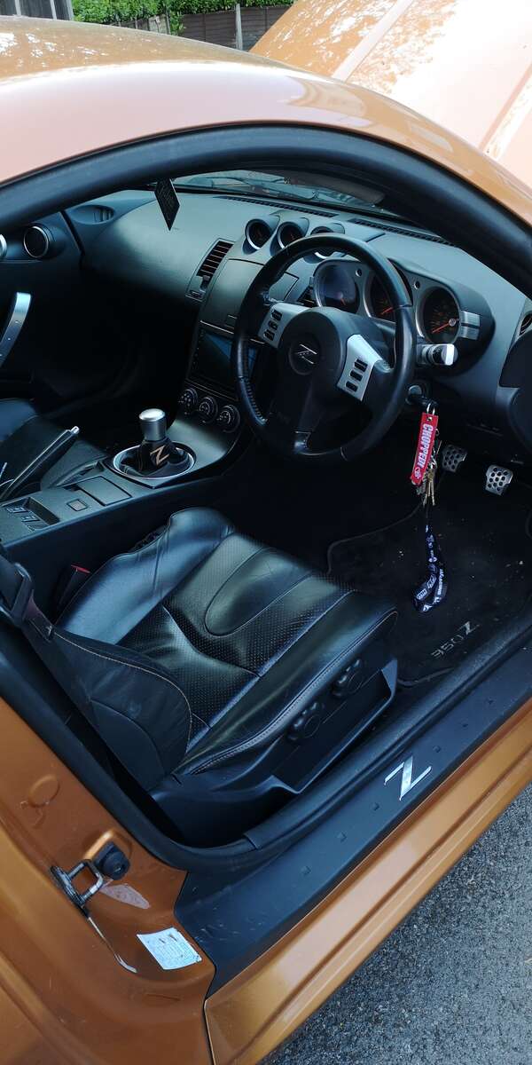

hicksi Posted May 2, 2020 Share Posted May 2, 2020 Hey gents. Bit of deep water thread revival. Hope your all well! Hust thought I'd pitch in, just finished painting the centre console and upgrading to an Xtrons, iso mod yada yada... I purchased the ebay generic incartec style facia plate. I looked around and from the pictures, any 350z specific facia plate available in the UK is the same. Fits the dash perfectly but not an Xtrons unit. I beleive if your running say a jvc or pioneer it would fit perfectly, but xtrons make their units larger for some reason. I did purchase a specific 'universal' xtrons facia plate. Its just square that I think is meant for a cage install as it doesn't have any screw fixings like the Z one... I've given up for now. Can't find one. Can't make one. It's such a shame. How's the foam looking? Anyone found the magic part yet? Would love to fill that gap. Quote Link to comment Share on other sites More sharing options...
