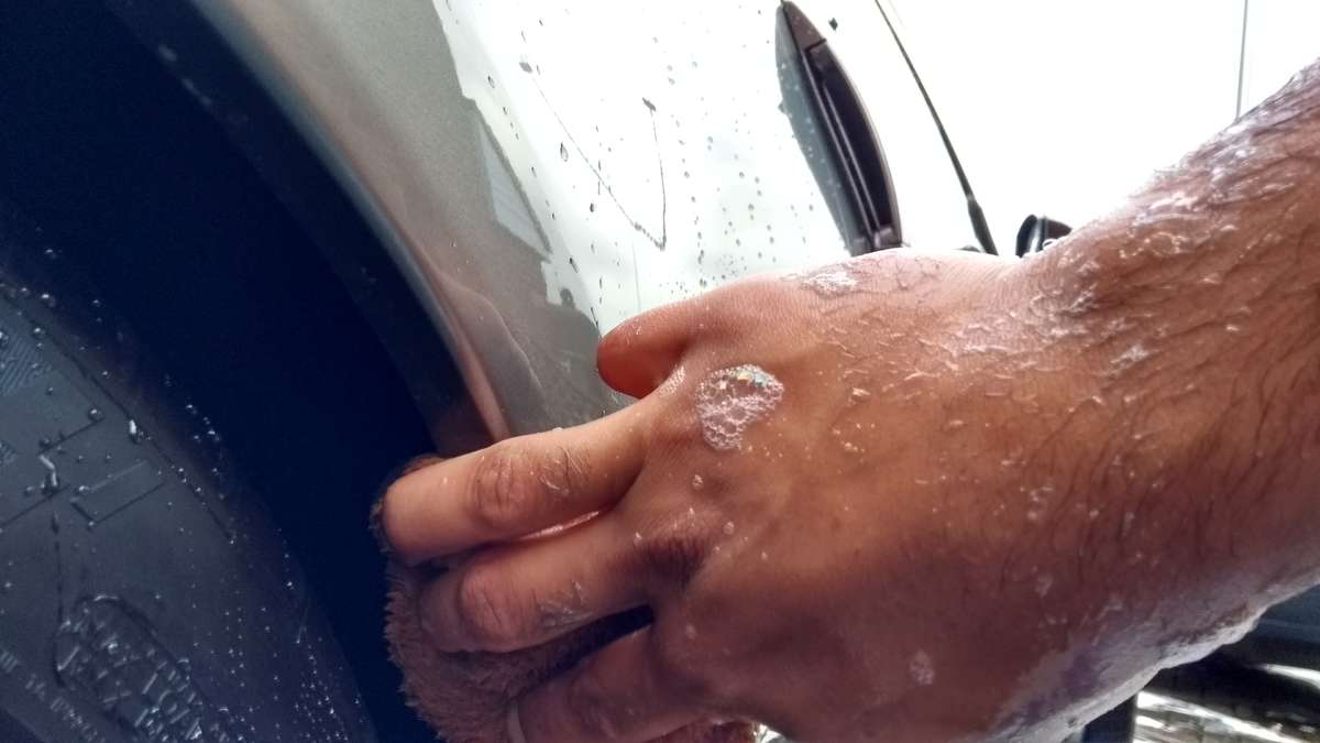

Made a welcome change not having to do a night wash.
Bilt Hamber Auto Foam 10:1 pre wash
Pro-Kleen snow foam *lime
Agitate wheel faces and barrels
Power rinse, arches and underside
2 bucket wash with CarChem car shampoo
Re washed wheels with mf mitt
Cleaned tyres, arches & tail pipes
Open hose rinse

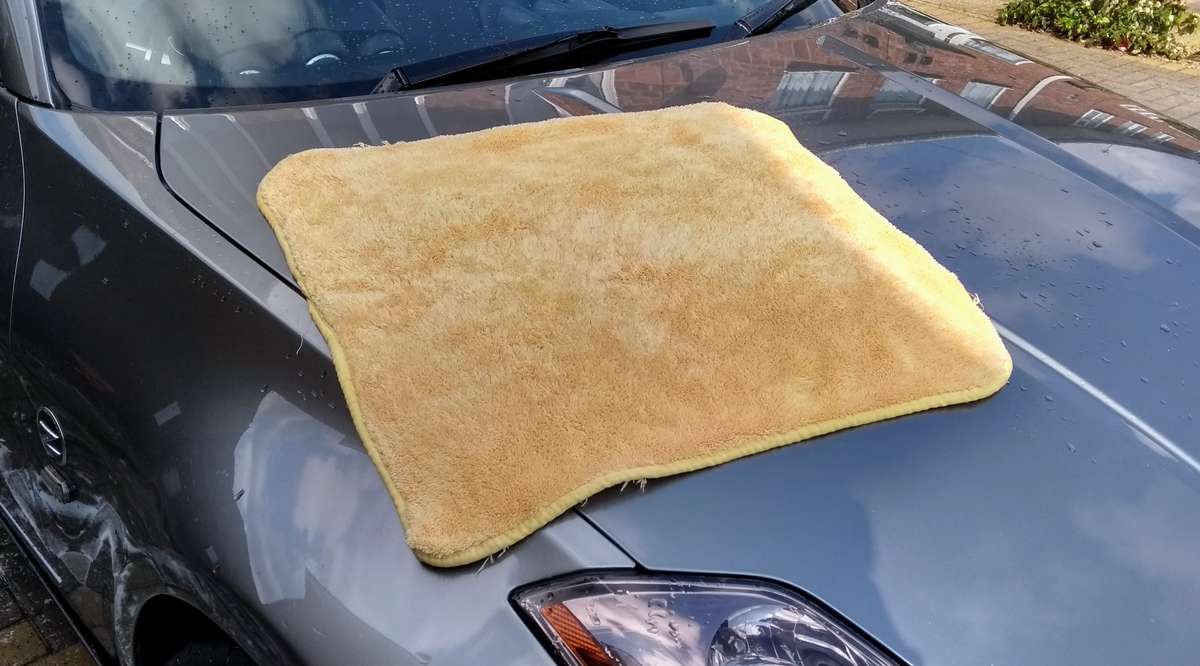

Drying towel bodywork and wheels
Autoglym Rubber Plus on tyres
All to keep the winter grime at bay!!

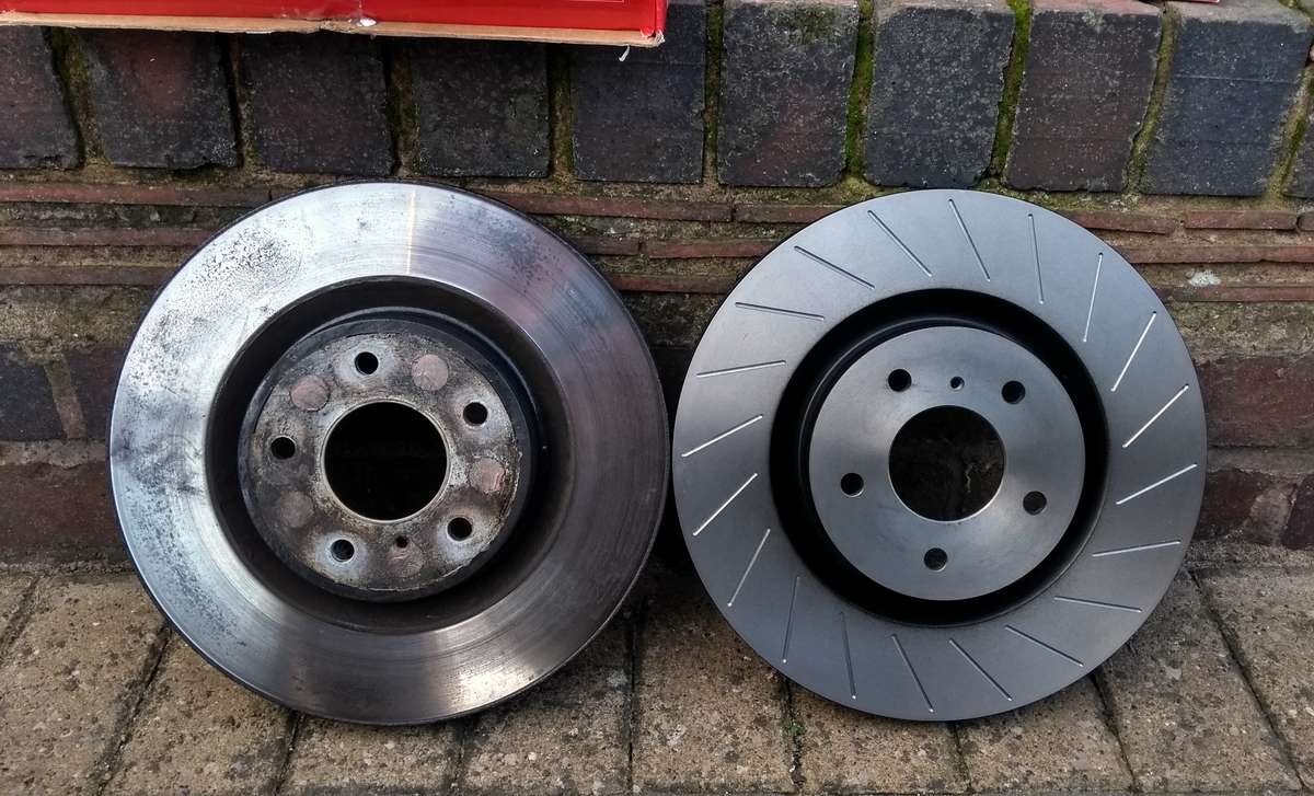

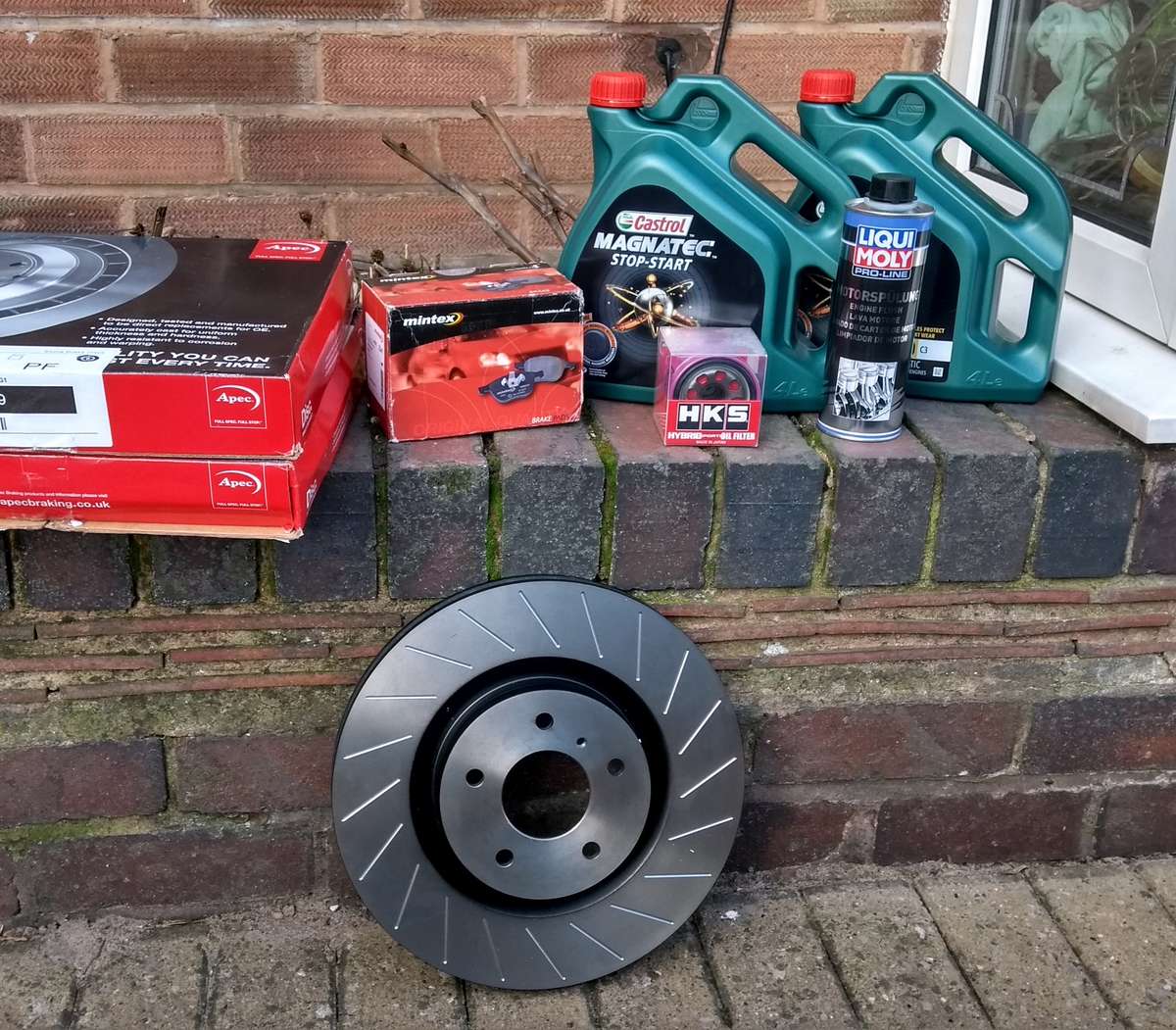

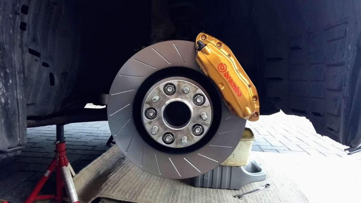

It's that time of year again. Routine oil and filter change, she also was in need of front discs and pads as Silverstone had permanently hurt the old set up.
Mileage 84272

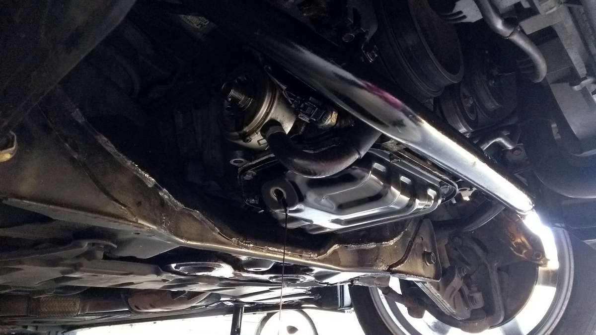

Thought it made sense to combine jobs, time to run up the engine from cold and draining the old oil allowed for partial replacement of the brakes. Not only did I again lower the O/S of the car to aid with oil drainage, but purged out the old oil by pouring in fresh oil with the sump plug removed. Yes this felt very odd, but worked as it help push the old stuff out as seen below.
Magnetic sump plug found practical nothing, which I guess is a good thing. First time round after 12 months found swarf, but makes sense that it wouldn't so much there after on a maintained engine.
Then a couple of weeks ago, the forums local legend @350Butcher hooked me up with replacing the compression arms. Went with the Moog option from Torqen. The N/S although didn't look terrible nor would cause concern during an MOT, over uneven surfaces made a right racket.
Now feeling, sounding and braking spot on again.

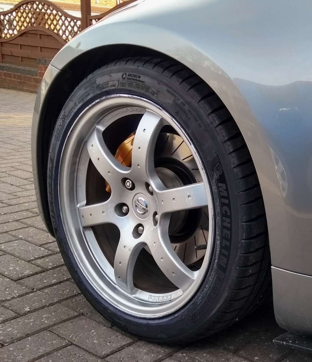

New boots time, Michelin PS3's coming off so made sense switching to the PS4's. New tyres even for 45 profile, look to be squared off much more than the 3's or even the mpss. Really liked the PS3's, could torment understeer at will in the cold at slow speeds but on track apart from the expected blistering, felt the front end was always where it needed to be. Driven sensibly on road, never gave me bother in all conditions and the replacements are said to be possibly the best road tyre in OE fitment.

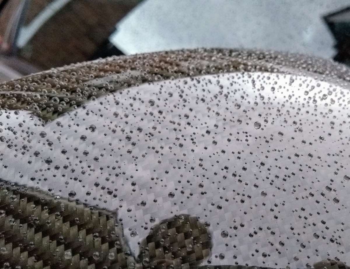

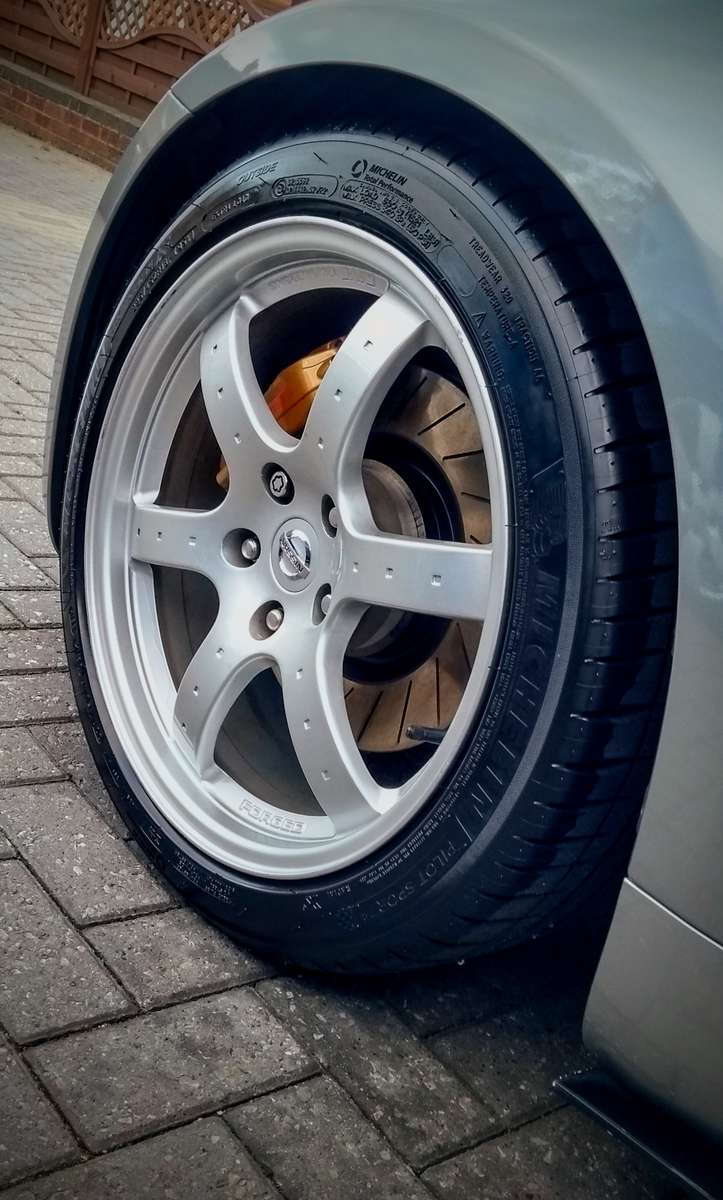

Thought I'd share for any bead lovers :) Double coat of Autoglym Ultra HD Wax doing it thing and should be good for 5-6 months of protection.

You can tell alot of effort has been put there mate, deep reflection too  :thumbs:

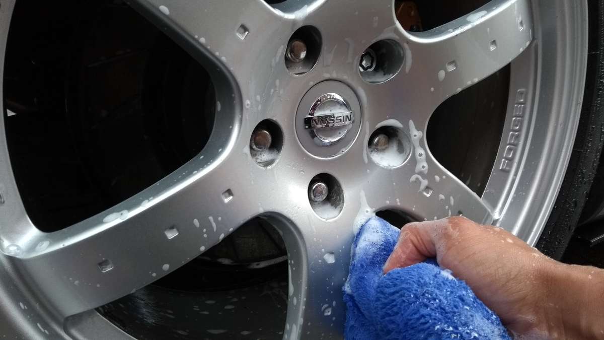

How did you use that autoglym alloy wheel seal?
I've got some but haven't used it yet, thought it be best to remove alloy, completely clean them then cover tyre and spray on.
Did you just spray on the face of the alloy and tyre?
Do you just spray and leave to dry?
What do you think of it?
  • Thanks 1
Cheers fella, even after all these years the gloss and wetness of the paint takes me by surprise.
I've cleaned and decontaminated the wheels using Carchem Revolt before storing for the winter, then on the car clean the faces and barrels as part of the routine wash *time allowing. Applied AG wheel seal using a microfiber cloth and buffed off any excess.
https://waxandshine.co.uk/shop?olsPage=products%2Frevolt-wheel-cleaner-500ml
First time I've used it so not much to go on as yet, but an aerosol means it's a quick grab of the shelf. It's gone no where near the tyres or brakes.
Edited by davey_83

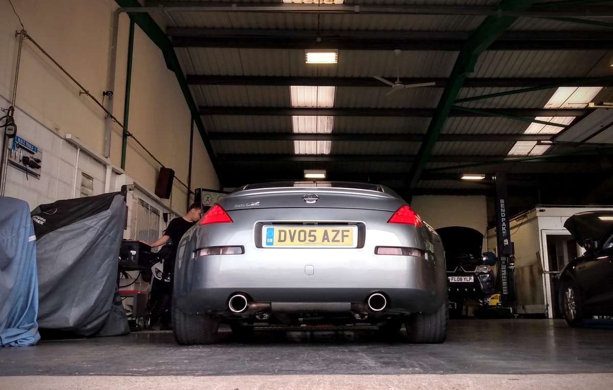

Car booked in for MOT this morning and worst still at a garage I've never had a car tested at before. Old place (of 13 years) earlier in the year chose not to renew their policy for testing - great!!
Fresh eyes over ol' girl and she passed without any advisories, I even asked the tester afterwards anything to keep an eye on for next year? Said 'nothing' and joked just tyres and brakes lol
After a very proud drive home, with the wife at work and kids at their favourite auntie - I set about treating the her :yahoo:

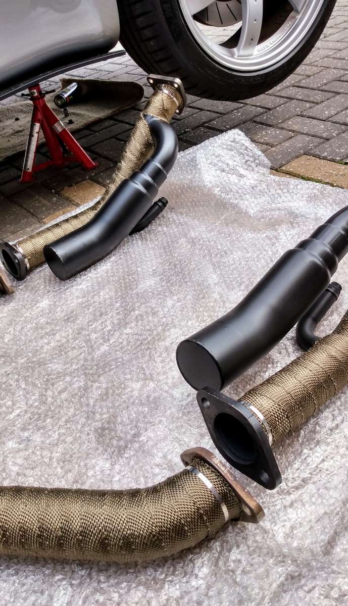

We know what this means......
Out with the old.....
and in with the MD
Used super low mileage O2 sensors fitted with spacers.
Ceramic coated and titanium heat wrapped Motordyne ART pipes, XYZ full merge collector with 200 cell Sports Cat. Thank you also to Tarmacsportz for the gasket and bolt kit :thumbs:
