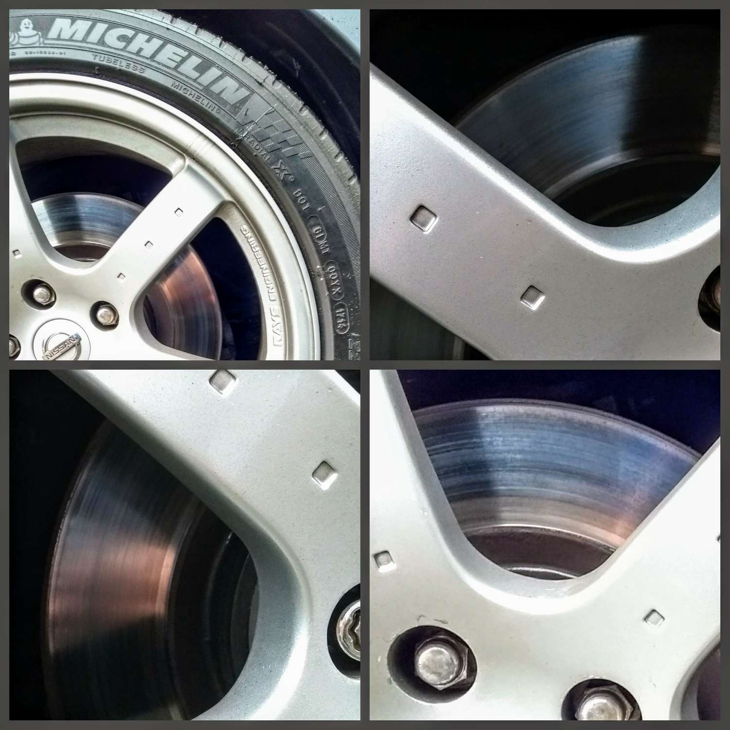

davey_83 Posted January 27, 2018 Author Share Posted January 27, 2018 (edited) For ages since taking my car out on track at Silverstone, I've had a fairly noticeable brake judder. I knew it wasn't warp discs or down to poor fitment, as i knew the moment it happen and seemed as a result of not warming the brakes up before punishment. Whilst the car is filthy and in need of a wash, on the way home from work this morning I went through a pad bedding in process. Damn it worked, no more judder and the discs are in much better condition to take another set of pads ready for Castle Combe. #bluemuch Edited January 27, 2018 by davey_83 Quote Link to comment Share on other sites More sharing options...
Rob350 Posted January 27, 2018 Share Posted January 27, 2018 2 hours ago, davey_83 said: For ages since taking my car out on track at Silverstone, I've had a fairly noticeable brake judder. I knew it wasn't warp discs or down to poor fitment, as i knew the moment it happen and seemed as a result of not warming the brakes up before punishment. Whilst the car is filthy and in need of a wash, on the way home from work this morning I went through a pad bedding in process. Damn it worked, no more judder and the discs are in much better condition to take another set of pads ready for Castle Combe What was your process?? Iv had brake judder for a while also, so would like to try what you did.. Although I think I did warp mine..I'd done about 5 laps around nurburgring GP track but was taking it a little easier on the 1st corner (going from about 120 to 20) on my last lap I thought I'd go for it and brake hard all the way.. I got to about 40 and then the juddering started and now happens when I slam on hard... but i did thjnk that the standard brembo discs were good quality and hard to warp?? Maybe there abit thin so warped easier.. Quote Link to comment Share on other sites More sharing options...
davey_83 Posted January 27, 2018 Author Share Posted January 27, 2018 (edited) The feeling I had was pedal pulsing, due to pad transfer on the face of the discs. This then leave 3 options; replace, skim or use controlled heat to sheer off. I needed to do it as the pads are getting low, I didn't want to throw in new pads and have them tackle an extra job. Process was 50mph to 30mph lightly X5, 70mph to 40mph medium firm x5, 80mph to 40mph hard x5. Steady drive home for 15mins, when coming to a stand still I was sure not to hold the foot brake. From what I gather a heat cycle is recommended prior to heavy use, as it leave a nice friction surface for the pads. Edited January 27, 2018 by davey_83 Quote Link to comment Share on other sites More sharing options...
350Butcher Posted January 28, 2018 Share Posted January 28, 2018 Are you using Ferodo 2500 pads? Quote Link to comment Share on other sites More sharing options...
davey_83 Posted January 28, 2018 Author Share Posted January 28, 2018 Standard Ferodo street pads front and rear. Quote Link to comment Share on other sites More sharing options...
350Butcher Posted January 28, 2018 Share Posted January 28, 2018 Jeez mate, if you're tracking the car get them pads out! The DS2500's are awful pads so standard street stuff is even worse! I guessed at Ferodo as the vibration you get from pad material transferring on to the disc is a Ferodo trait. They are the worst culprits for this. 10mins on track and they are finished!! Quote Link to comment Share on other sites More sharing options...
davey_83 Posted January 28, 2018 Author Share Posted January 28, 2018 Couldn't agree more fella, I don't track the car as in 'track days' more track sessions ie 20 or 30mins which is plenty at a time for me. Knowing I have oe spec pads made me very aware that 7/10 was plenty while on track. Sub £100, what would you recommend for fast road and a few sessions on track? Quote Link to comment Share on other sites More sharing options...
350Butcher Posted January 28, 2018 Share Posted January 28, 2018 Sorry, thought you planned to do full days on circuit. I've not tried them but if it was me I would try a set of the Performance Friction Z-rated fast road/track pads......only just over budget! https://www.ebay.co.uk/itm/PFC-1001-11-Z-Rated-Front-Brake-Pads-Mitsubishi-Evo-5-9-Impreza-WRX-STi-350Z/192337445611?hash=item2cc83482eb:g:YYQAAOSwH2VZ50F3 1 Quote Link to comment Share on other sites More sharing options...
davey_83 Posted January 28, 2018 Author Share Posted January 28, 2018 Sadly not, nice one for the link. It's a daily so dipping my toe in is my limit I soon realised it's not the car holding me back, I was holding the car back from going quicker. Quote Link to comment Share on other sites More sharing options...
