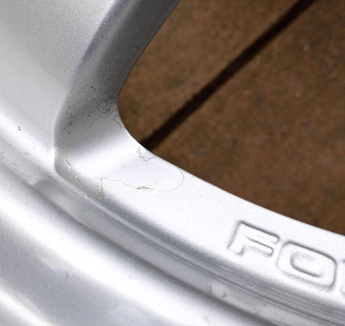

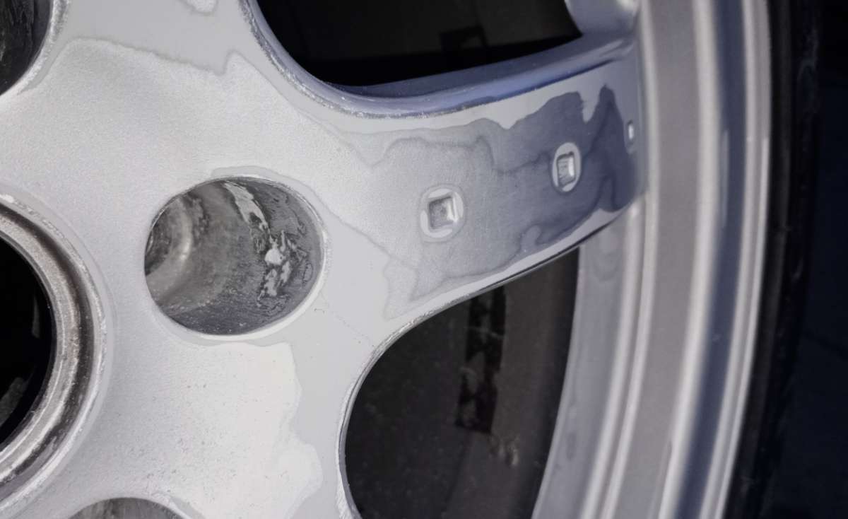

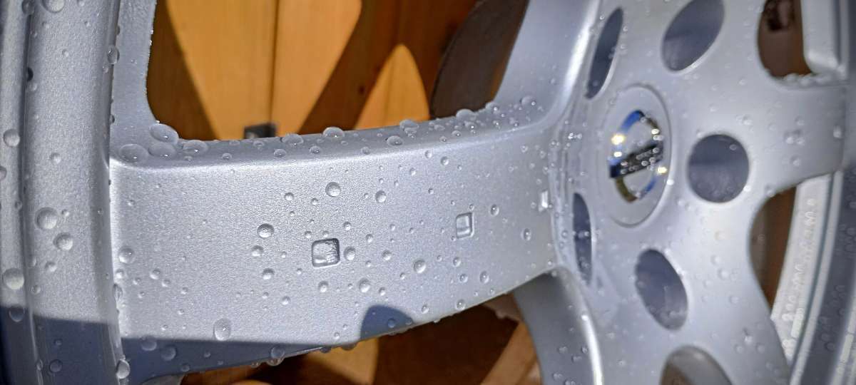

Few bits to catch up on, 18' RAYS wheel refurb, Spring clean including arches, suspension raised 15mm all round and annual service.
Previously painted before my ownership most likely to help with the sale, showing lacquer peel, corrosion coming through and a couple of paint runs. Nothing terrible but every time you'd wash the car however
240, 320 600 prep work - 2hrs each wheel
Masked off and tac ragged over
X3 coats of primer later
1st dust coat of silver
My makeshift spray booth
x3 coats of primer, base & 2k lacquer later with 24hrs between each stage
Searched a decent amount of time for the right silver as most silvers are metallic, which I didn't want and think looks crap on wheels if you want an OE look.
Products used x2 cans each, wheel barrels not done.

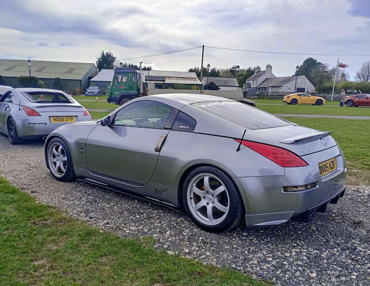

Anglesey with the club was a blast, personally my favourite drive out and conditions were great considering it was the end of March. Used the wipers for about 4 minutes on the way back across the boarder so can't grumble at that.

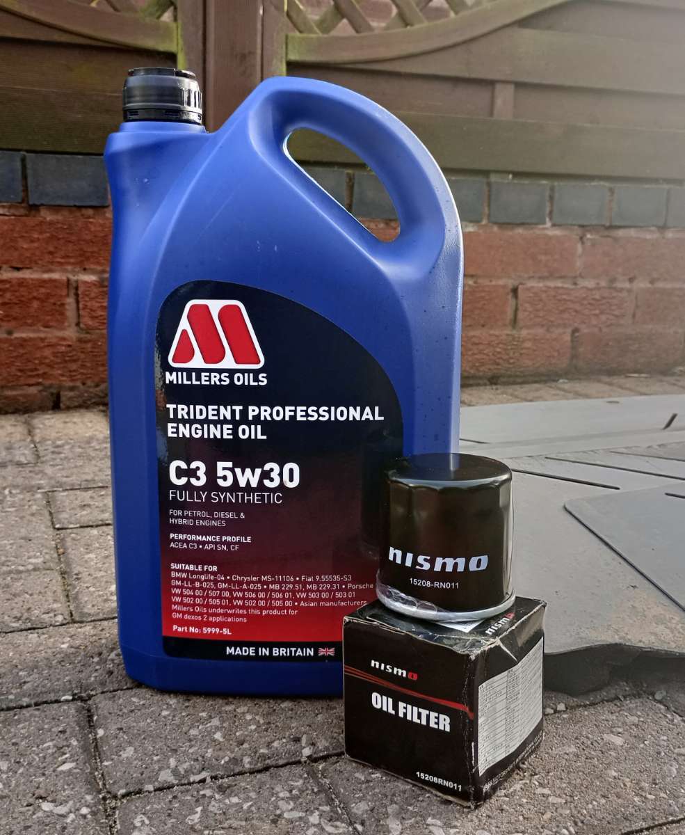

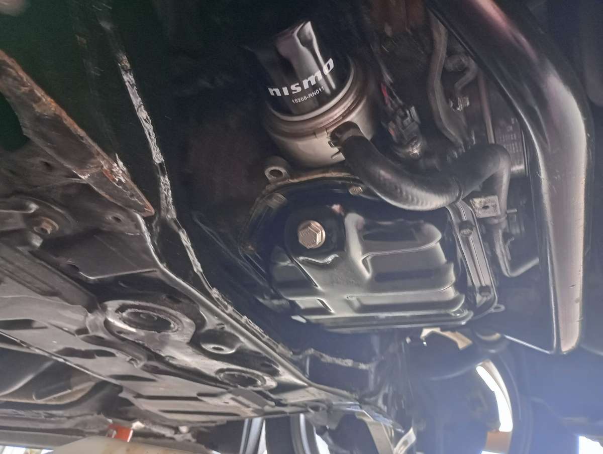

Annual oil and filter change. Ally underlay with service hatch, but still take it off to have a nose round and wipe down underneath
Edited by davey_83

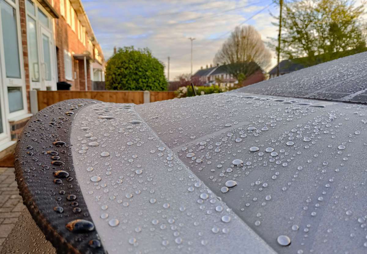

Having not long refurb'd my 18' RAYS and with them fitted for the Anglesey trip, they naturally got proper grimy. Following the successful install to my Varrstoëns, I had the bright idea to again PPF the lips. Never seen anyone do it before.
Measured, cut and installed - barely even tell it was there unless really looking for it. By far the best protection for the part of the wheels that gets most brake dust abuse.
PPF used Suntek Ultra

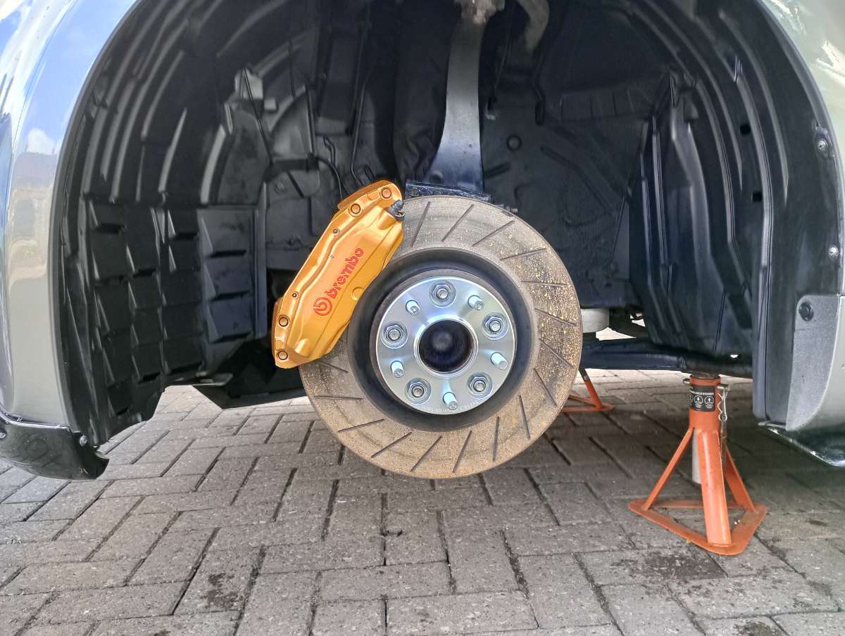

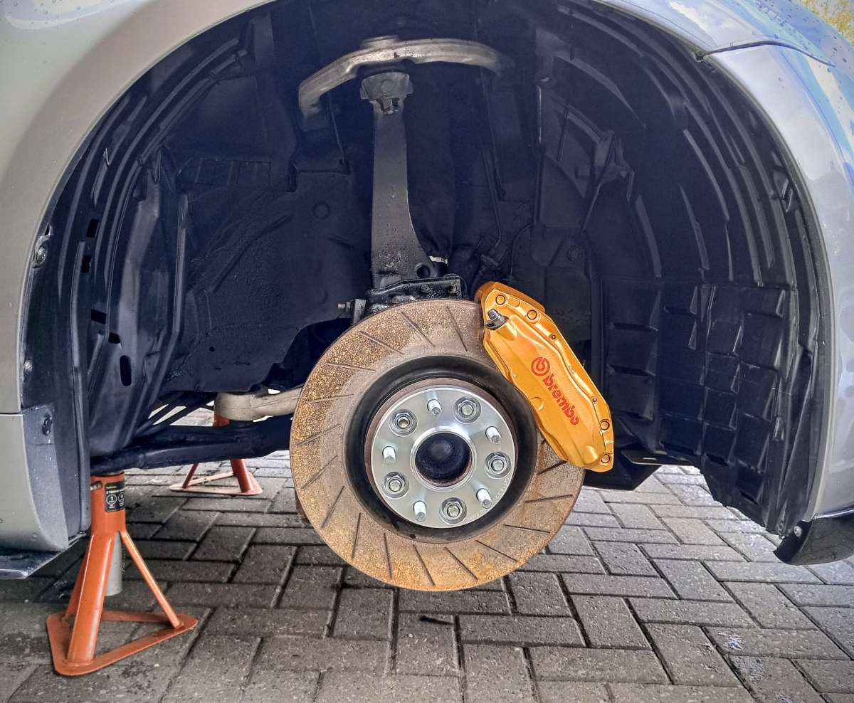

Been a couple years since the last brake fluid change, so thought I'd incorporate braided lines to replace the near 20yr old rubber hoses. New track pads all round were also fitted.
Had the Goodridge brake lines for years and years, never fitted as thought the job would be a complete ball ache hence getting it into the garage. All the OE brake flexi hoses came off  without bother, nothing seized - unjustified anxiety.
Underseal sanded off to reveal barely any corrosion.
Pedal feel is noticeably more positive now, on to the pads.
Old pads weren't worn out by any means however the entry level Mintex just aren't any good at high temps. The new items at least visually look alot more purposeful.
Clutch fluid change also carried out while she was in the air, as surplus fluid.
