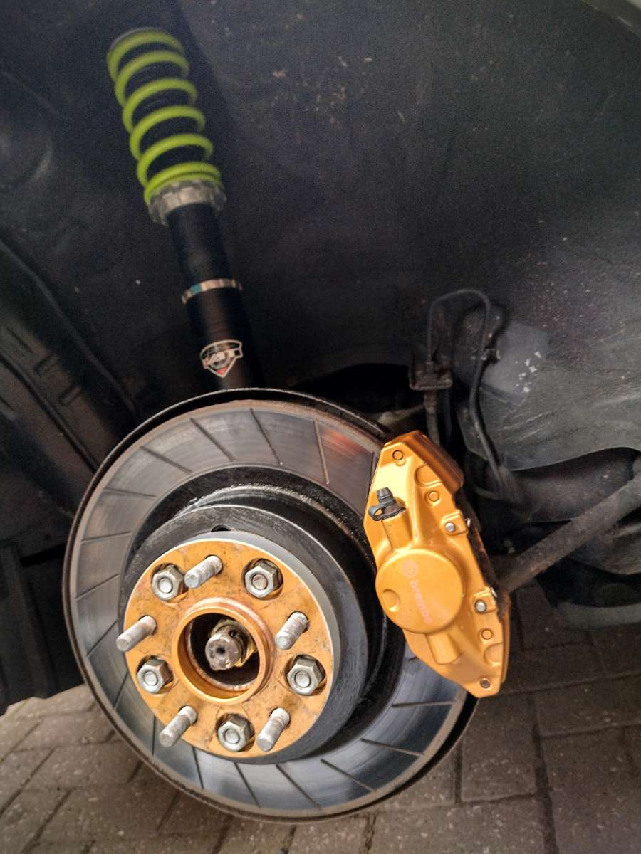

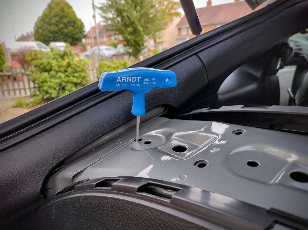

The coilovers I bought didn't come with rear adjuster extenders, came across a simple yet effective idea - £6 damper adjuster solution with no holes in the interior. Do your adjustment, pop the trim back on and you're good.
Drill in one hand, vacuum attachment in the other made it interesting.
Gone from 12/40 clicks, up to 22/40

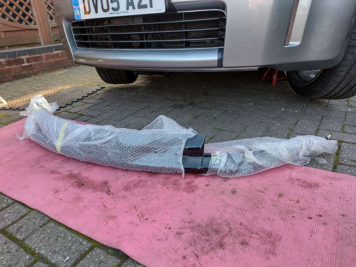

The other morning I messaged Chris over at @Tarmac@TarmacSportz to see if they had any stock for their Mines style front splitter, goes they had two on the shelf - so made arrangements to pop up to collect that day. Wanted one for a while and finally pulled the trigger.
Old splitter and carbon bumper insert off, quick clean up ready for the new item. Fitment was great however being a fussy bugger, i spent some time contouring the splitter where it bulked. Thought I'd rather do this as I didn't want to result to applying a silicon sealant, which can leave the splitter under unnecessary tension as your asking the material to pull/push into place.
Unibond double sided tape for the centre and the side line up with the factory bumper lower bolts in front of the wheels. I also ran a torx self taper at the ends near the wheel wells for good measure.
Absolutely chuffed with it and may look to PPF it as its in a high traffic area.

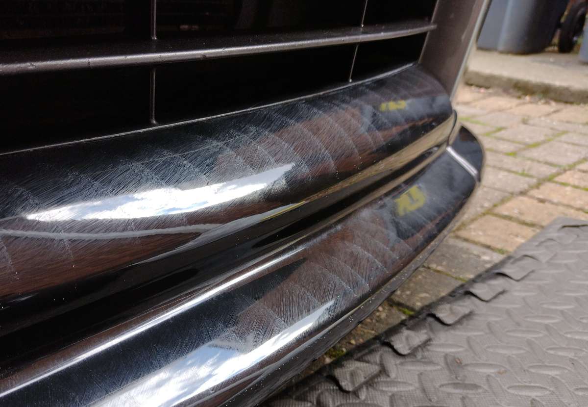

Attempted to the PPF the front splitter in sections and failed terribly, even made a template. Previously did my carbon bumper insert however this time she wasn't having none of it. Gave up on the idea and stuck a layer of sealant on to make myself feel better.
To be fair there are alot of intricate curves on that splitter.
It'd be great if there was a plastidip type spray that had a really glossy transparent finish to it.
Just mask up and spray on a protective clear top coat that could be relatively easily peeled off and replaced as it aged and chipped.
I'll give it another go, think I used too much Johnson's baby shampoo in the mix as it sort of neutralised the tac of the film sadly.

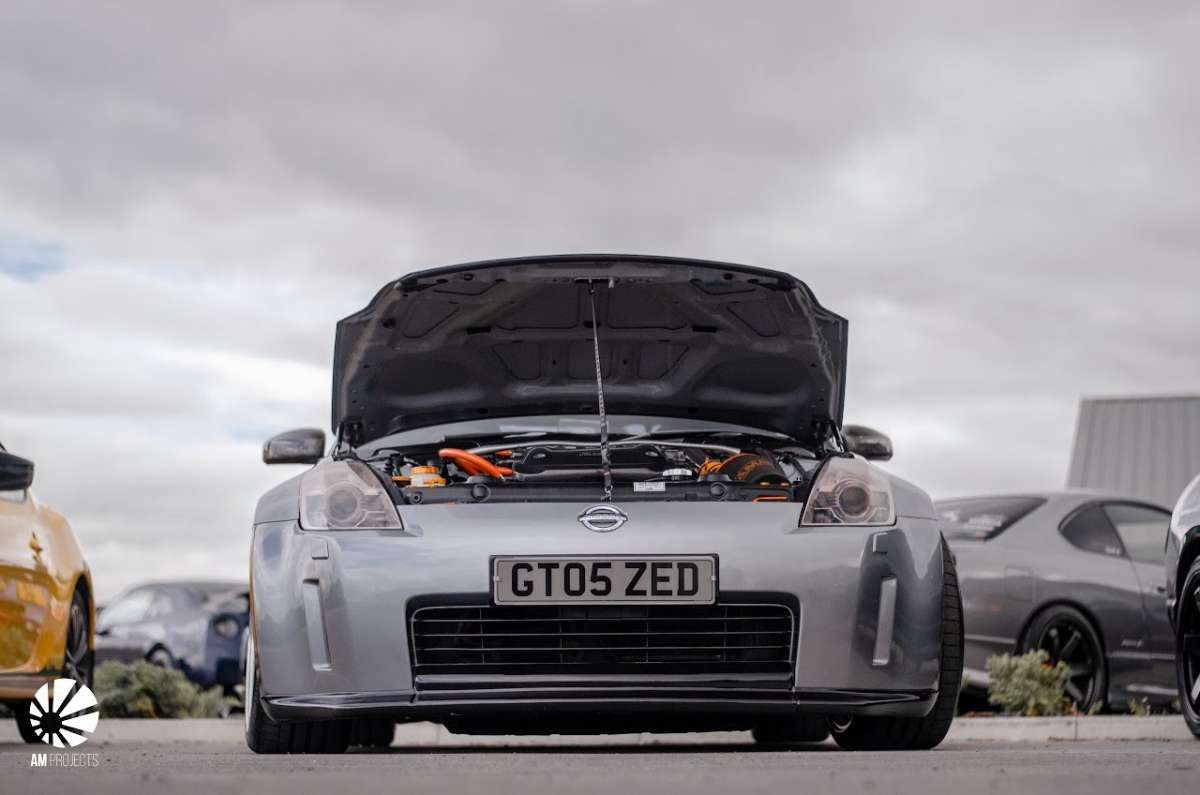

Came across a couple pics online from the weekend up North.
An actual show pic with the bonnet down for a change 🤭

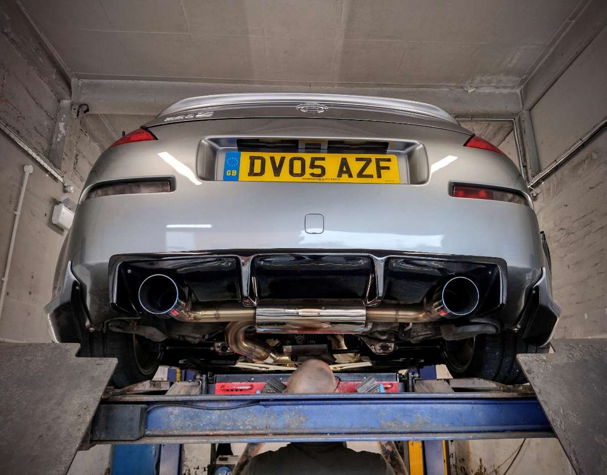

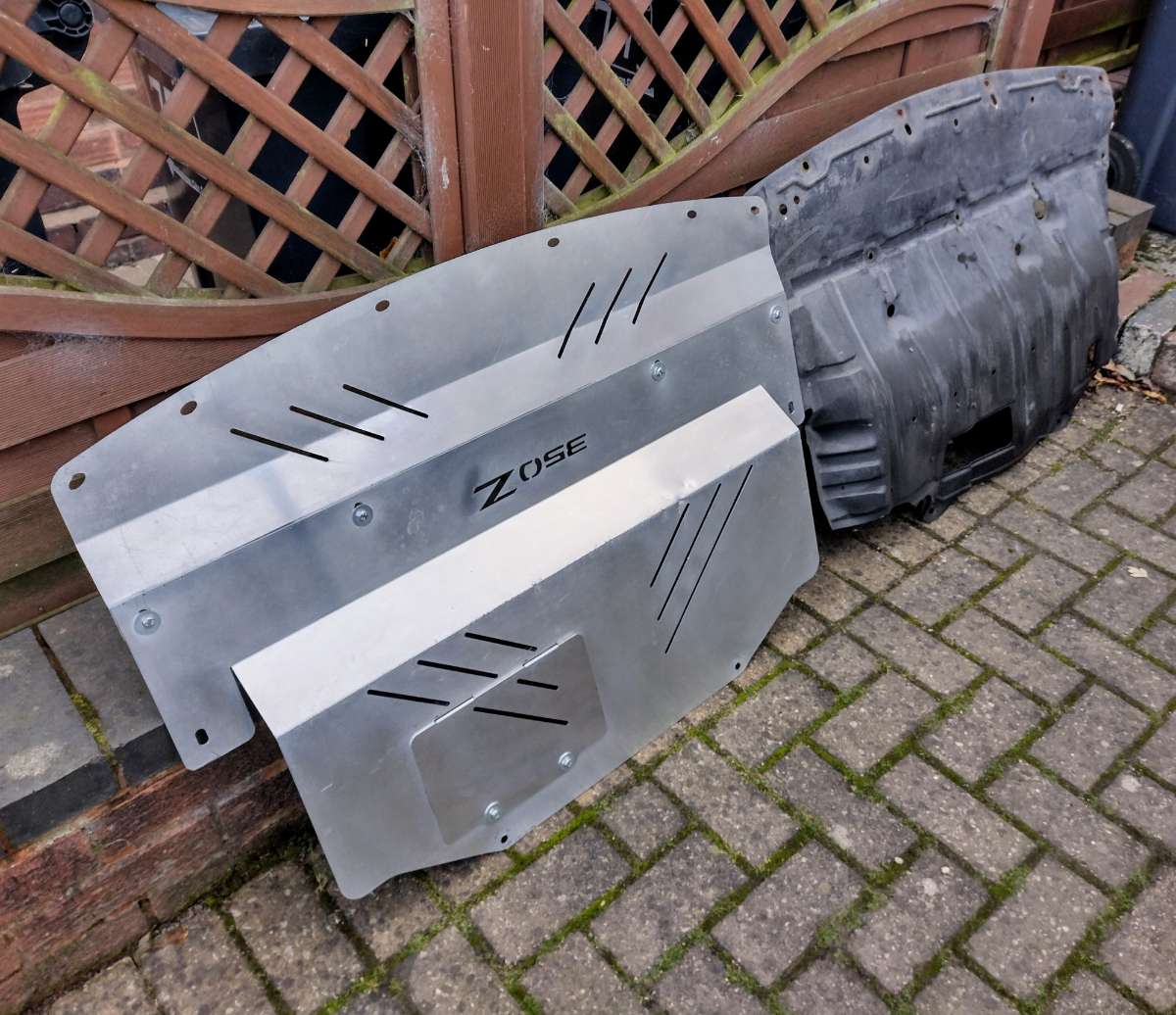

Last weekend I went along to the club's Rolling Road Day held at MSL Performance.  Prior check over needed for the vehicle and managed to sorted out an exhaust leak from the y pipe v band. Fitted a Tarmacsportz ally undertray whilst carrying out an oil change for good measure. Also gave me the chance to swap over to the winter wheels ready for the morning, along with raising the ride height 15mm.
Structurally alot more supportive than the 16yr old factory plastic item and future oil & filter changes will be a cinch.
Tyre pressures set to 34psi
Wheel spacers on and ride height adjusted.
In the shop 😄
Now time for a few pulls
Best run 251whp and 242wtq

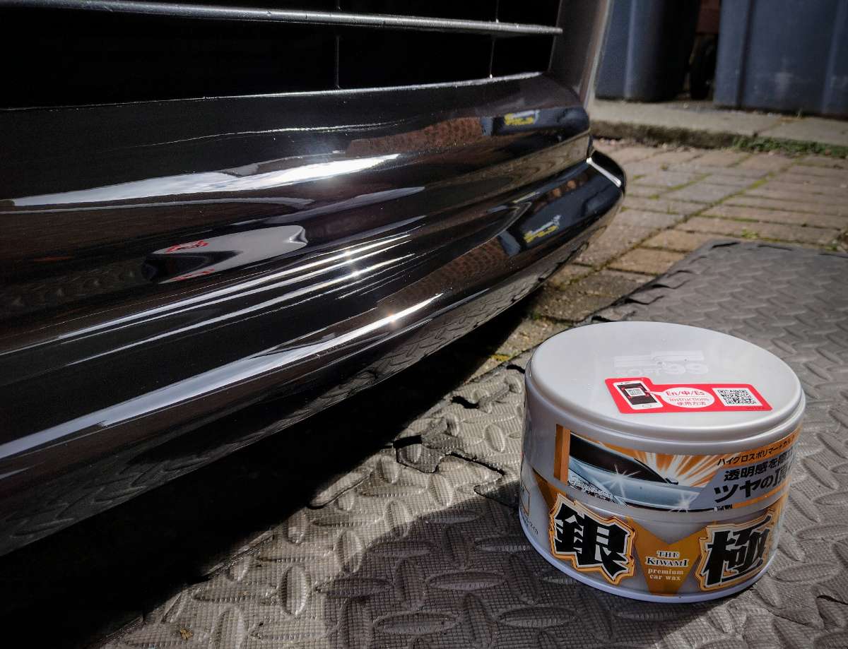

Better late than never, Winter clean and protection carried out.
Pre was
2 bucket wash
Towel dry
SP Pro Neutral Enhance
Soft99 Kiwami sealant
SP Pro NE used as a paint cleanse/prep for the LSP. Few days later and in typical fashion it rained.
After cleaning thought I'd bag the tailpipes to help stop water spotting, as I won't be driving her for a while.
  • Like 3
