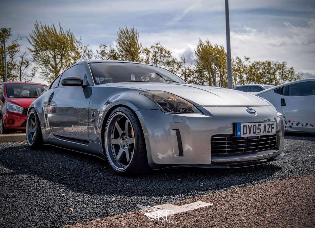

davey_83 Posted June 5, 2021 Author Share Posted June 5, 2021 Same car, different background 😀 1 Quote Link to comment Share on other sites More sharing options...
HEADPHONES Posted June 5, 2021 Share Posted June 5, 2021 26 minutes ago, davey_83 said: Same car, different background 😀 That's the money shot right there 1 Quote Link to comment Share on other sites More sharing options...

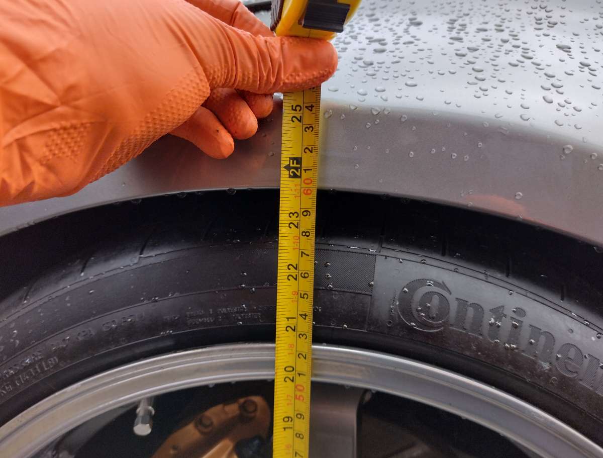

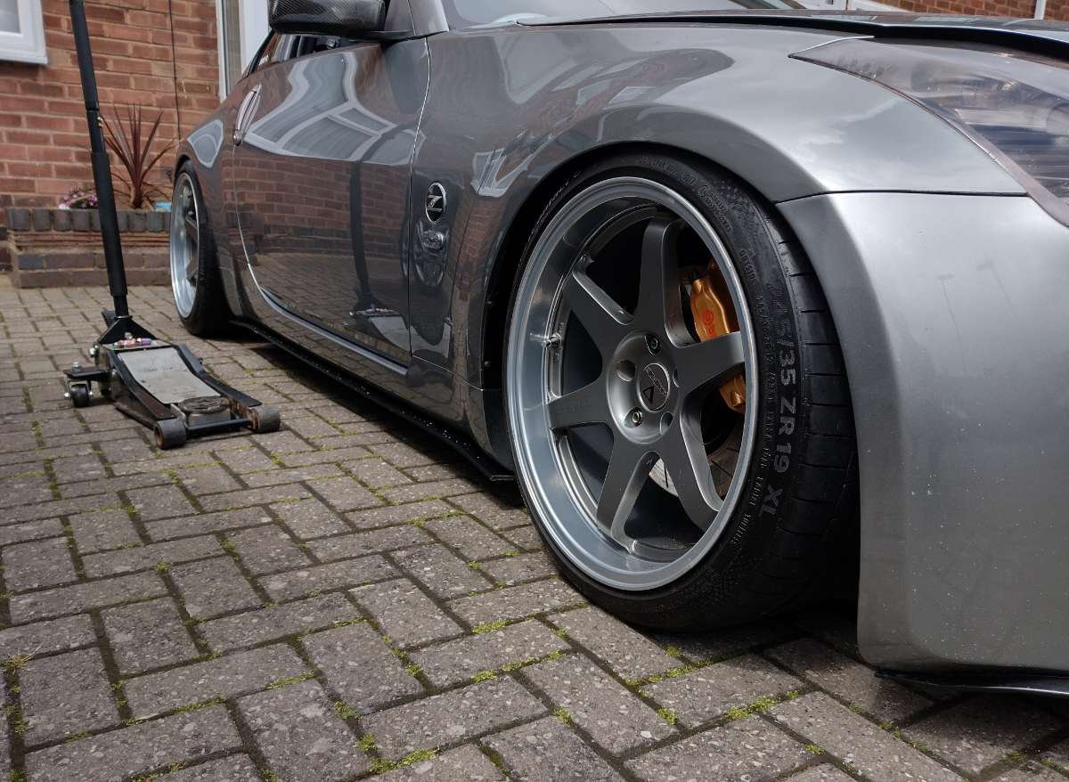

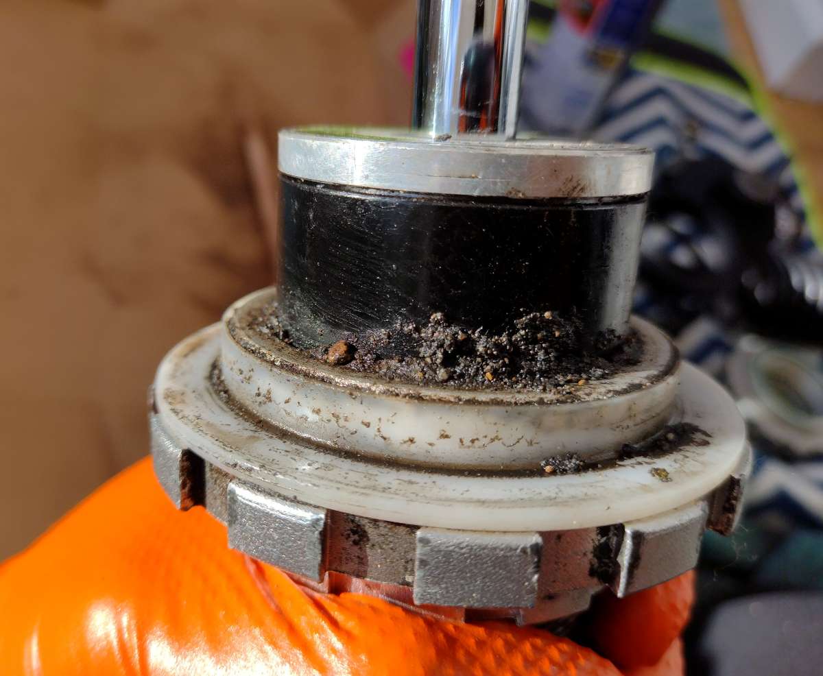

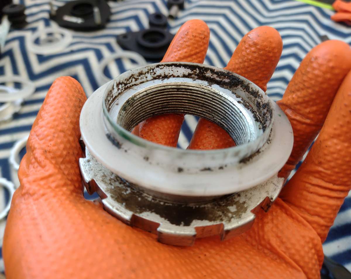

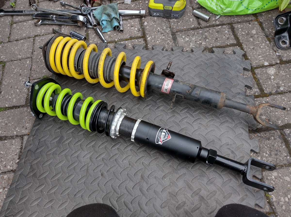

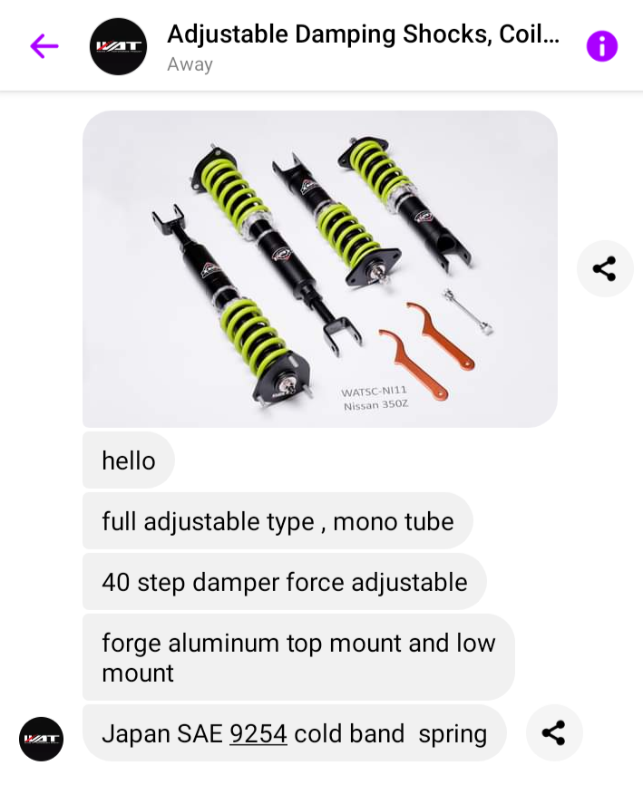

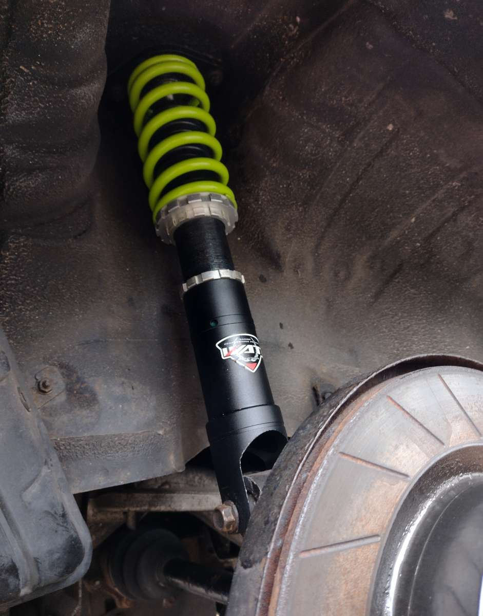

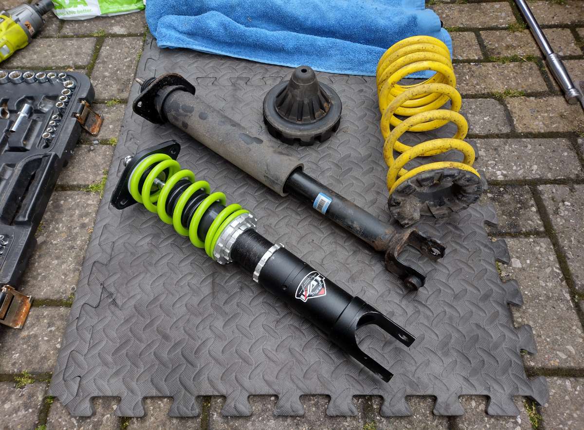

davey_83 Posted June 27, 2021 Author Share Posted June 27, 2021 (edited) Browsing as you do i came across a used set of coilovers on eBay, listed as Nissan 350z springs and shock absorbers. Thought I don't recognise this make however figured they'd be worth a look. Quick check of the ad out of interest looking to gauge condition and more importantly the make. Made out the wording WAT Racing, who you say. I thought the exact same thing, turns out WAT Racing Performance is a motorsport company in Taiwan who run a FIA rally team (four time consecutive class titles) who also design, build and test their own suspension. Competing in circuit/track along with rally/hill climb competitions. www.watsuspension.com/about-us.htm Thought for the right price these would be worth the gamble, nothing ventured and all that. Also made sense that a motorsport team might know how to make decent suspension. Was happy with the current ride height, however wanted to dial out the floaty feeling when pushing on as you can sense the weight I guess more with softer dampers along with reduced travel from the lowering springs. Bought the coilovers and in the meantime messaged WAT Racing via Facebook for details on what I had paid for. They kindly came back with the below. Being a used set they of course needed a good tidy prior to fitting. Took everything that I can apart to assess and clean. Having never had coilovers before with helper springs (previously had MeisterR and BC on my last car) I again contacted WAT Racing for information on preload. Was absolutely blown away with the reply *see below. Thought ok let's get to it. Looking much better The complete set awaiting assembly Built up and preloads set to manufacturers spec. Ride height of each corner checked from bottom of the alloy to arch. Rears first, figured I'd get the easy pair out the way. Considerably weight saving. Spin the car round and onto the fronts, again fair bit of weight lost due to forged top and lower mounts. Initially siting way to low......... Raised each corner and went for a drive round the block. Back on the drive and adjust ride height again. Currently sitting -40mm however later want to set the ride height to -25mm. Will no doubt settle after a decent drive out. Damping set to 8 clicks front and 12 rear out of 40. The next day went to Wheels On Wednesday car show in Spetchley, circa 70 mile round trip encountering motorways, duals, A and B roads, gravel track and even cattle grids. To my relief the ride is great, deals with poor road surfaces very well. Will feel better once it's raised a bit too I'd have thought. Compared to the 16yr old shock absorbers of course the ride is going to feel way better. The car deals with adverse cambers and undulations so much better now with greater body control. To explain poor road surfaces are no longer poor surfaces. Haven't of course lent on the car yet, but I am looking forward to seeing what's what. Edited June 30, 2021 by davey_83 4 Quote Link to comment Share on other sites More sharing options...
ballistic Posted June 27, 2021 Share Posted June 27, 2021 Awesome. Looks fantastic, looks like the gamble paid off. 1 Quote Link to comment Share on other sites More sharing options...
HEADPHONES Posted June 28, 2021 Share Posted June 28, 2021 Wow.....what a find! Add to that the very personal support from that you got and it all sounds a fantastic purchase. 2 Quote Link to comment Share on other sites More sharing options...
msitpro Posted June 28, 2021 Share Posted June 28, 2021 unexpected! Very nice What are the spring rates? 1 Quote Link to comment Share on other sites More sharing options...
davey_83 Posted June 28, 2021 Author Share Posted June 28, 2021 (edited) 15 hours ago, ballistic said: Awesome. Looks fantastic, looks like the gamble paid off. Cheers pal, yeah thankfully so. 13 hours ago, HEADPHONES said: Wow.....what a find! Add to that the very personal support from that you got and it all sounds a fantastic purchase. Yeah I felt a bit more confident when I was building the suspension back up, following the communication from WAT. It was clear they knew what they where talking about and was more than happy to take the time to explain the set up. 4 hours ago, msitpro said: unexpected! Very nice What are the spring rates? You're telling me, during lockdowns I've spent more on the car than all the years prior!!! Spring rates are 14kg/mm front and 6kg/mm rear. Edited June 28, 2021 by davey_83 Quote Link to comment Share on other sites More sharing options...

msitpro Posted June 29, 2021 Share Posted June 29, 2021 On 28/06/2021 at 13:01, davey_83 said: Cheers pal, yeah thankfully so. Yeah I felt a bit more confident when I was building the suspension back up, following the communication from WAT. It was clear they knew what they where talking about and was more than happy to take the time to explain the set up. You're telling me, during lockdowns I've spent more on the car than all the years prior!!! Spring rates are 14kg/mm front and 6kg/mm rear. Ahh snap on the front. What do you think? Currently running 8k on the back of my 'true' coils myself - purely for arch clearance reasons due to silly wide semi slicks and stock arches. Extremely stiff. I have 6k rear springs as well and really that's the limit IMO for any kind of comfort whatsoever. I think I'll go 10-12k front and 6k rear when these wheels/tyres come off and I go back to the TC-4s. Quote Link to comment Share on other sites More sharing options...
davey_83 Posted June 29, 2021 Author Share Posted June 29, 2021 (edited) I didn't choose the spring rates, didn't even know what they were till the package arrived and from reading past threads on here 14/6 is what I'd have chosen. No doubt with more time behind the wheel and when I raise the ride height a tad dial in some rake, il be able to lean on the car to see how it responds. Normal driving thus far feels really good. Also 14kg with the 2kg helper spring I guess would change the dynamics at the guess being sandwiched together? Edited June 30, 2021 by davey_83 Quote Link to comment Share on other sites More sharing options...

msitpro Posted June 30, 2021 Share Posted June 30, 2021 16 hours ago, davey_83 said: I didn't choose the spring rates, didn't even know what they were till the package arrived and from reading past threads on here 14/6 is what I'd have chosen. No doubt with more time behind the wheel and when I raise the ride height a tad dial in some rake, il be able to lean on the car to see how it responds. Normal driving thus far feels really good. Also 14kg with the 2kg helper spring I guess would change the dynamics at the guess being sandwiched together? I did wonder if that was the case haha Good thinking on the rake - see so many slam the rear and in my personal experience it messes up the balance of the car , turn in etc. The helper spring will be fully compressed at normal ride height. It softens the spring rate when you 'land' from a larger bump. Think it makes the effective spring rate around (spring1+spring2)/2 when 'landing'. So in your case 8k. You'd not want it uncompressed at all at normal ride height. That's like a progressive wound spring where it could change handling characteristics WHILE cornering - not predictable. 1 Quote Link to comment Share on other sites More sharing options...
msitpro Posted June 30, 2021 Share Posted June 30, 2021 Note also can improve grip via preventing a wheel leaving the ground. (Improved droop) Quote Link to comment Share on other sites More sharing options...
davey_83 Posted June 30, 2021 Author Share Posted June 30, 2021 18 minutes ago, msitpro said: I did wonder if that was the case haha Good thinking on the rake - see so many slam the rear and in my personal experience it messes up the balance of the car , turn in etc. The helper spring will be fully compressed at normal ride height. It softens the spring rate when you 'land' from a larger bump. Think it makes the effective spring rate around (spring1+spring2)/2 when 'landing'. So in your case 8k. You'd not want it uncompressed at all at normal ride height. That's like a progressive wound spring where it could change handling characteristics WHILE cornering - not predictable. 6 minutes ago, msitpro said: Note also can improve grip via preventing a wheel leaving the ground. (Improved droop) Yeah a level slammed car might look good but yeah defiantly compromised handling and possibly high speed stability due to a light feeling front end. Yeah the helper would be that quicker reacting force keeping the wheel on the ground maintaining grip/traction *in theory. 911 GT3 runs helper springs and no doubt the handling and body control is best in the game, so no bad thing. Quote Link to comment Share on other sites More sharing options...

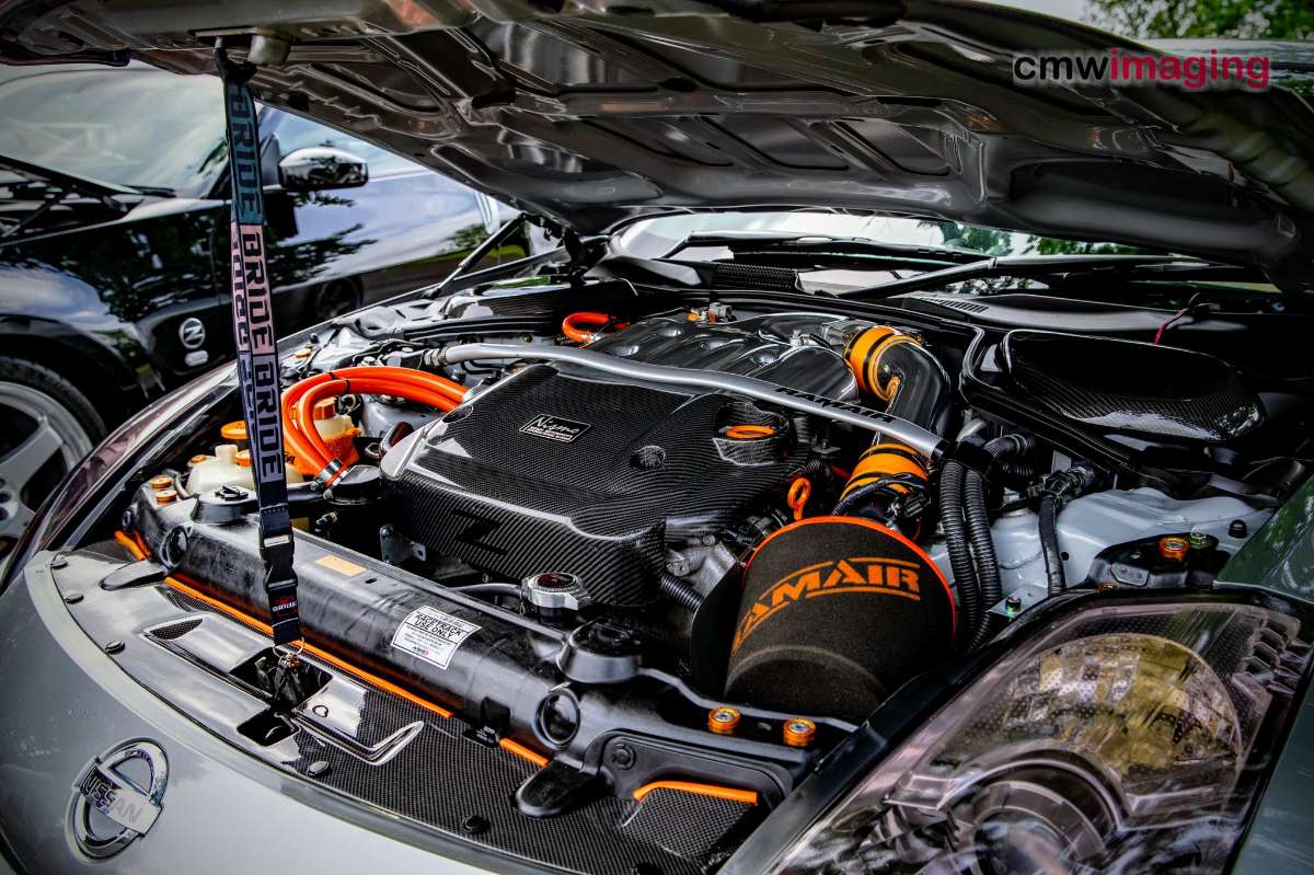

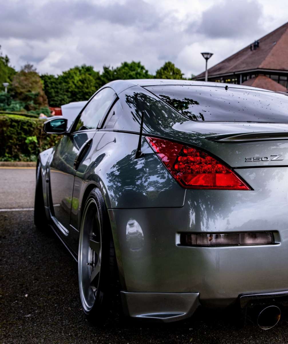

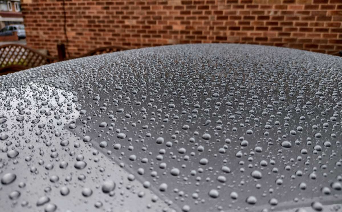

davey_83 Posted July 4, 2021 Author Share Posted July 4, 2021 Washed and sealed for today and it of course rained early door arghhhhh. The actual event was dry and even t shirt weather later on. Few pics of mine from today The gloss kids Quote Link to comment Share on other sites More sharing options...
