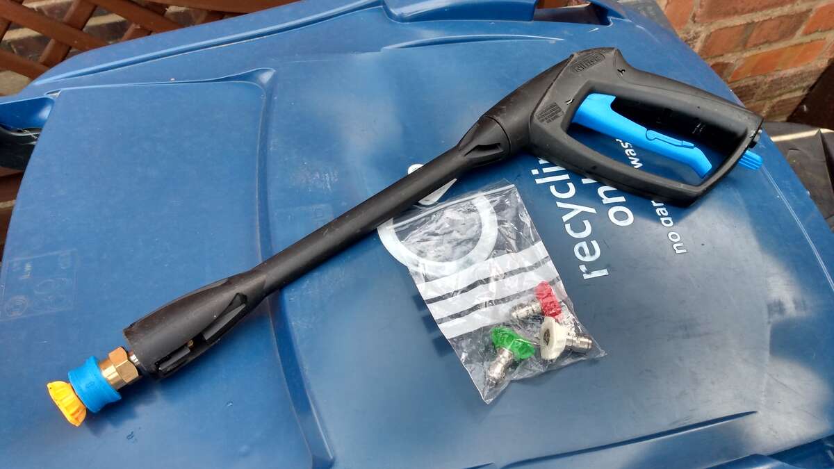

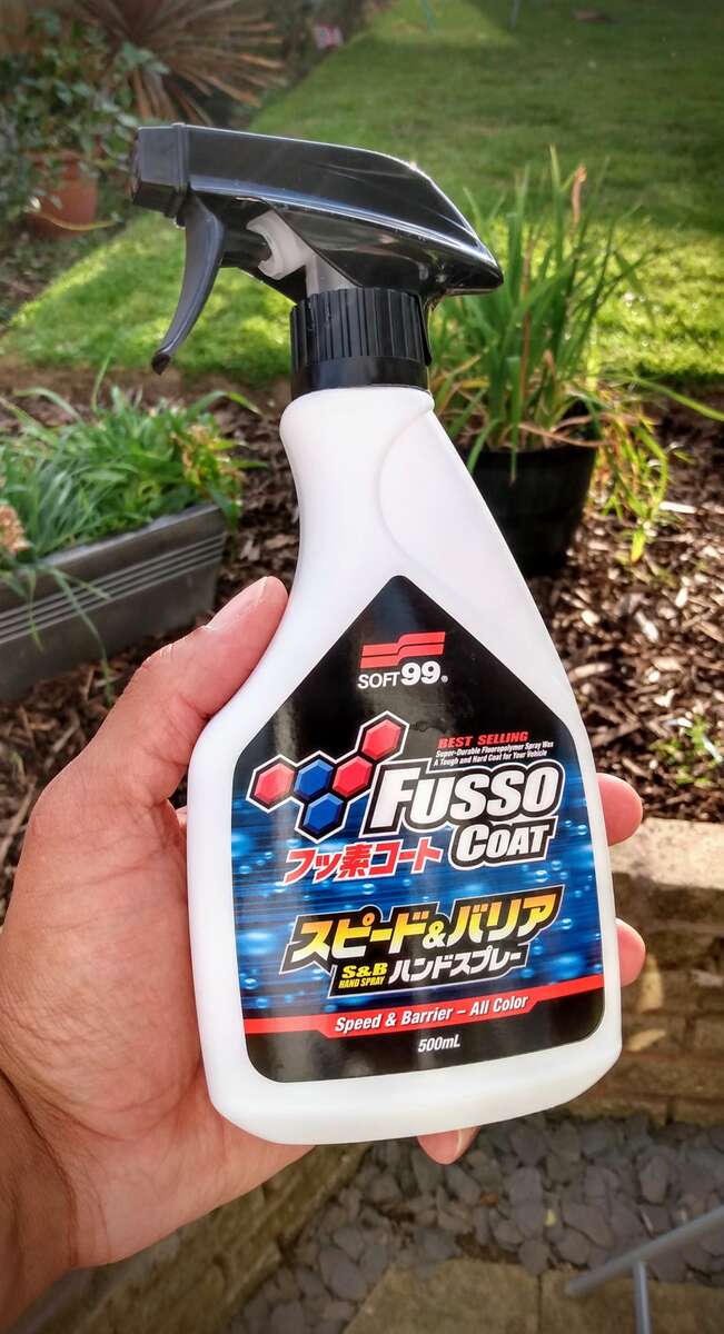

davey_83 Posted August 2, 2020 Author Share Posted August 2, 2020 (edited) Popping over to Caffeine and Machine tomorrow evening, so had a good excuse for a quick wash and wax. Also to try out my new stubby lance, lovely addition and way more control over the jet. https://www.ebay.co.uk/itm/292333253557 My new go to spray sealant Edited August 4, 2020 by davey_83 4 Quote Link to comment Share on other sites More sharing options...

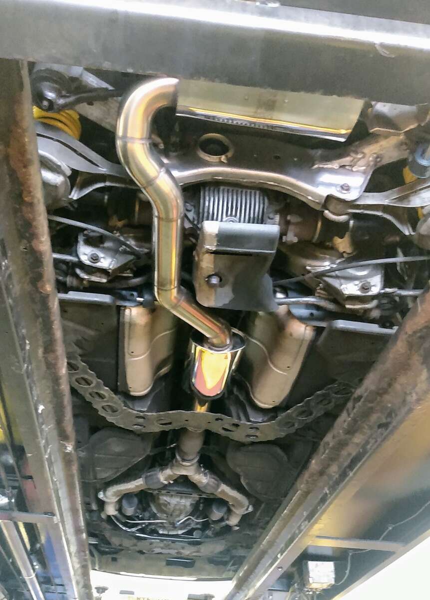

msitpro Posted August 6, 2020 Share Posted August 6, 2020 Not heard of this exhaust before - even googling now i can't find it? Seems a very sensible choice with the big oval centre box... I know this from personal experience of perforated eardrums 1 Quote Link to comment Share on other sites More sharing options...
davey_83 Posted August 6, 2020 Author Share Posted August 6, 2020 (edited) I very much doubt they've ever built an exhaust for a 350z other than mine, normally make stuff like this Sound clips don't do it justice at all, sounds amazing!! Edited August 6, 2020 by davey_83 Quote Link to comment Share on other sites More sharing options...
msitpro Posted August 6, 2020 Share Posted August 6, 2020 Ahh - didn't fully engage my focus on the 'custom' bit. Wise choice of design IMO as I said - very easy to make a Z un-liveable noise wise, as I discovered and have now drawn back from. 1 Quote Link to comment Share on other sites More sharing options...

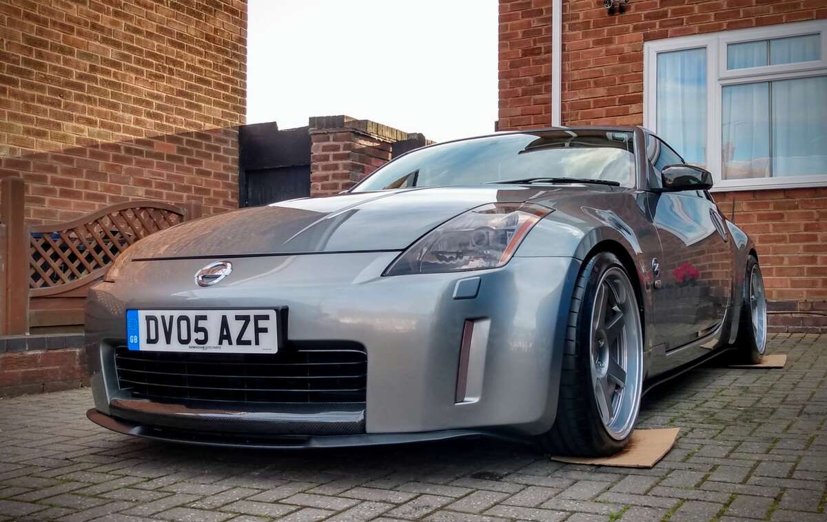

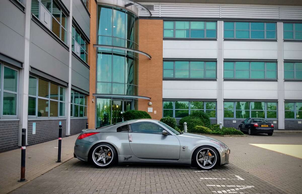

davey_83 Posted August 27, 2020 Author Share Posted August 27, 2020 Couple of pictures from the Wheels On Wednesday event, why do cars always look better parked on grass 1 Quote Link to comment Share on other sites More sharing options...
msitpro Posted August 27, 2020 Share Posted August 27, 2020 On 15/08/2020 at 15:54, davey_83 said: MOT day and she did me proud again. Ask the fella at the end, anything to keep an eye on over the next 12 months to which he said nothing, it's really clean and solid underneath. Exhaust, brakes, tyres, steering, suspension all look great. Emissions figures please! Did you witness the test being run? Did they keep it at 2500-3000 for the whole 30 seconds on the fast idle test? (it's easy to fake the result if you just prod the throttle in the last few seconds, with the pipe adding latency to the CO / HC sensor) Quote Link to comment Share on other sites More sharing options...
davey_83 Posted August 27, 2020 Author Share Posted August 27, 2020 How can I word this................... this part of the test I didn't see however emissions passed being very clean. Quote Link to comment Share on other sites More sharing options...
HEADPHONES Posted August 27, 2020 Share Posted August 27, 2020 1 hour ago, davey_83 said: Love this pic Sky is proper moody. Reflections of the horizon nicely proportioned in the door Even the angle of the shot accentuates the muscular rear arch 1 Quote Link to comment Share on other sites More sharing options...

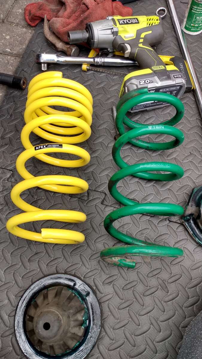

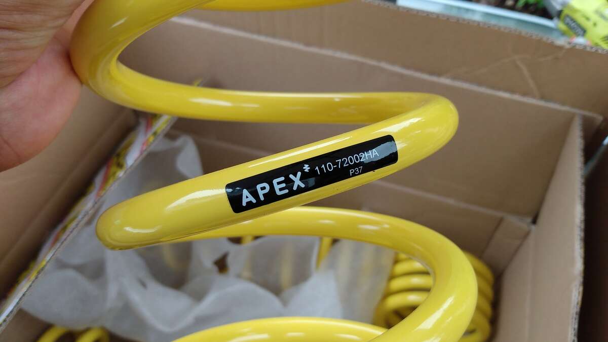

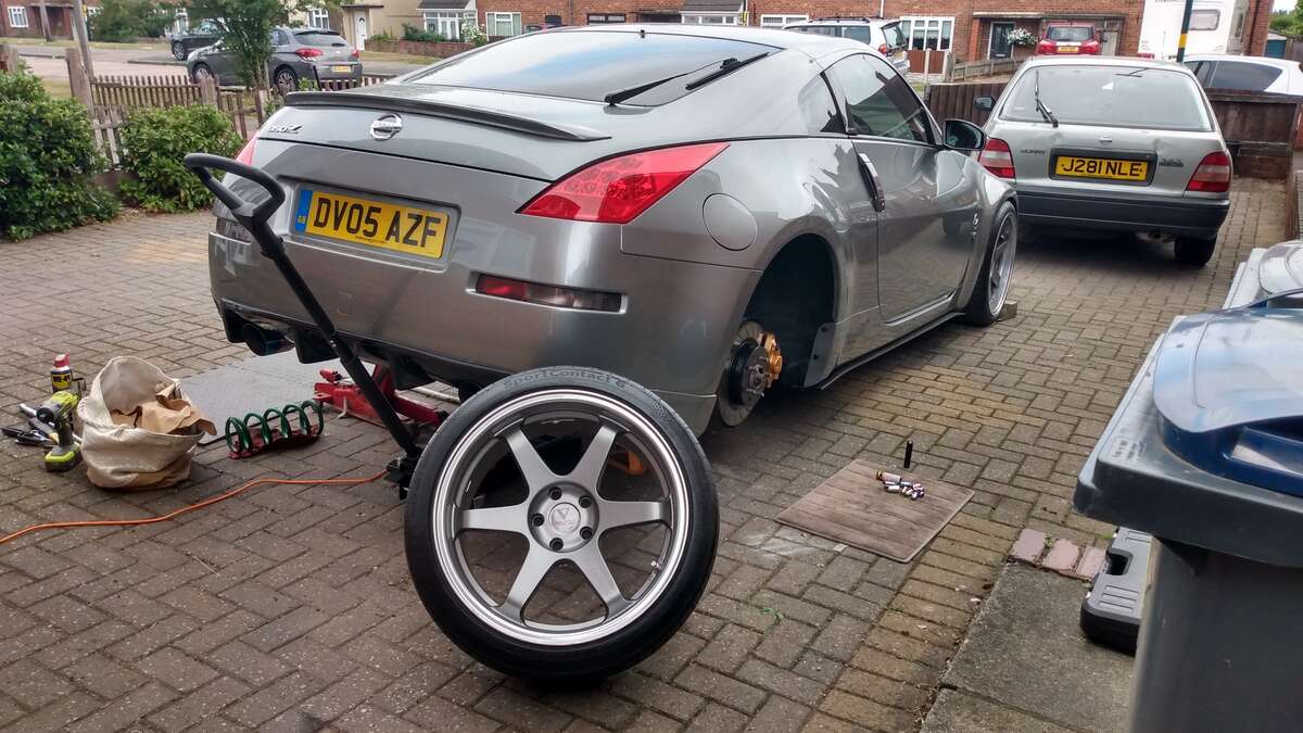

davey_83 Posted August 28, 2020 Author Share Posted August 28, 2020 (edited) For a while now had the idea to lower the suspension some more and now working from home, that thought seemed all the more appealing. Placed an order with Larkspeed for a set of Apex -30mm lowering springs (second company I went to as nowhere in the UK had stock) so these where built to order at the factory in Holland. Sits just about perfect now and the ride on the Apex progressive springs, is a tad more forgiving than the Tein fixed rate ones. Fitting was a breeze this time round using an impact gun. Rears done, on to the fronts and this gave the opportunity for a bit more treatment. How she sits now Edited August 28, 2020 by davey_83 3 Quote Link to comment Share on other sites More sharing options...
HEADPHONES Posted August 28, 2020 Share Posted August 28, 2020 Wheels filling the arches nicely. Can't get this outta my head now....... "Get low get low get low" 2 Quote Link to comment Share on other sites More sharing options...
Lewis Schwier Posted August 29, 2020 Share Posted August 29, 2020 Wow that looks like a perfect drop, will have to seriously consider myself. Look forward to seeing on Sunday Quote Link to comment Share on other sites More sharing options...
davey_83 Posted August 29, 2020 Author Share Posted August 29, 2020 Cheers pal, I think the Tein springs look great with the OE RAYS wheels however with aftermarket 19's -30mm gives it that mild stance look. 2 Quote Link to comment Share on other sites More sharing options...
