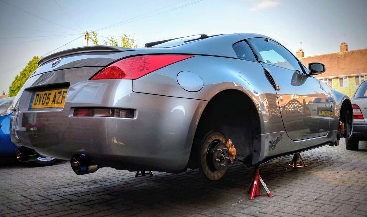

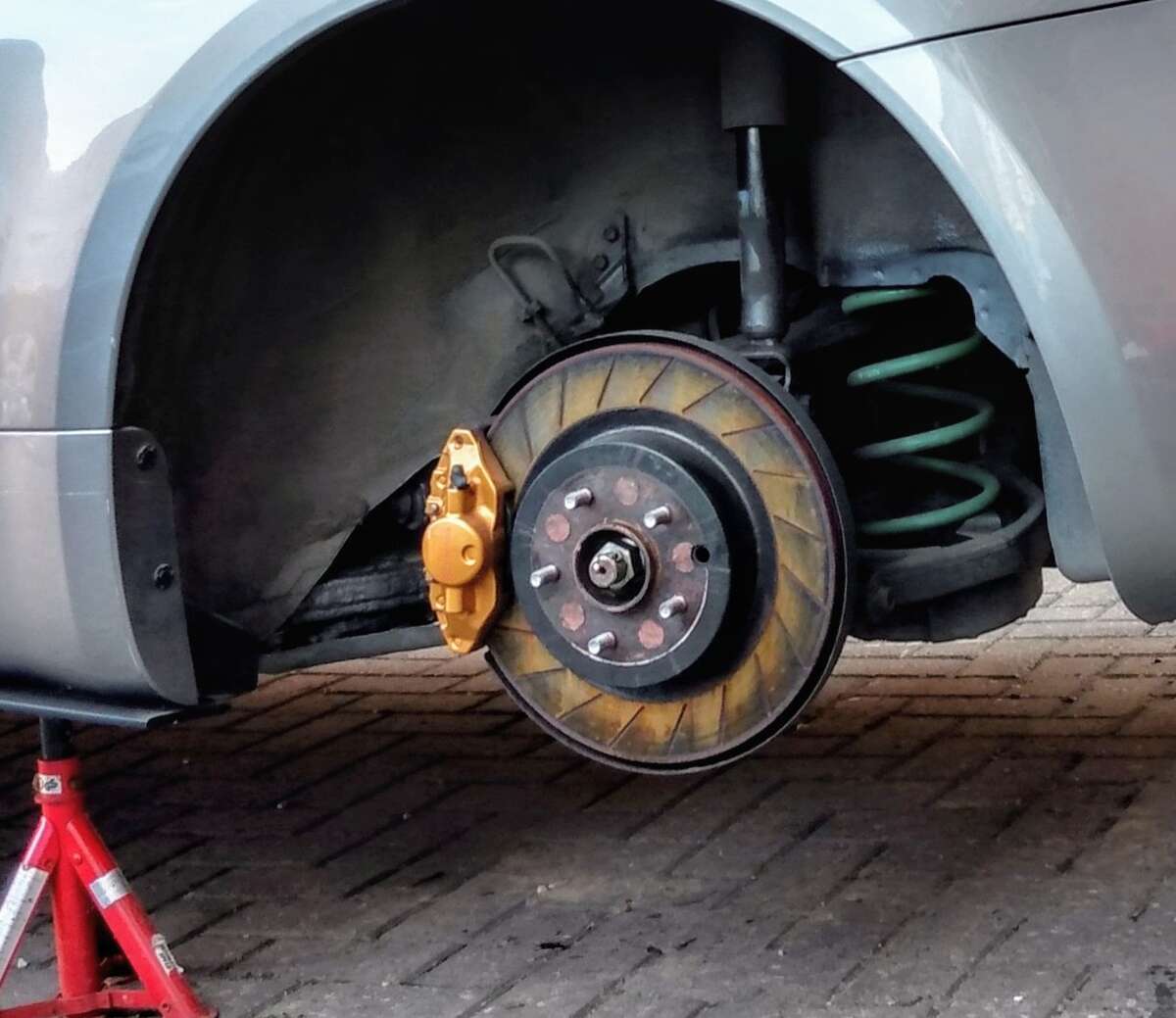

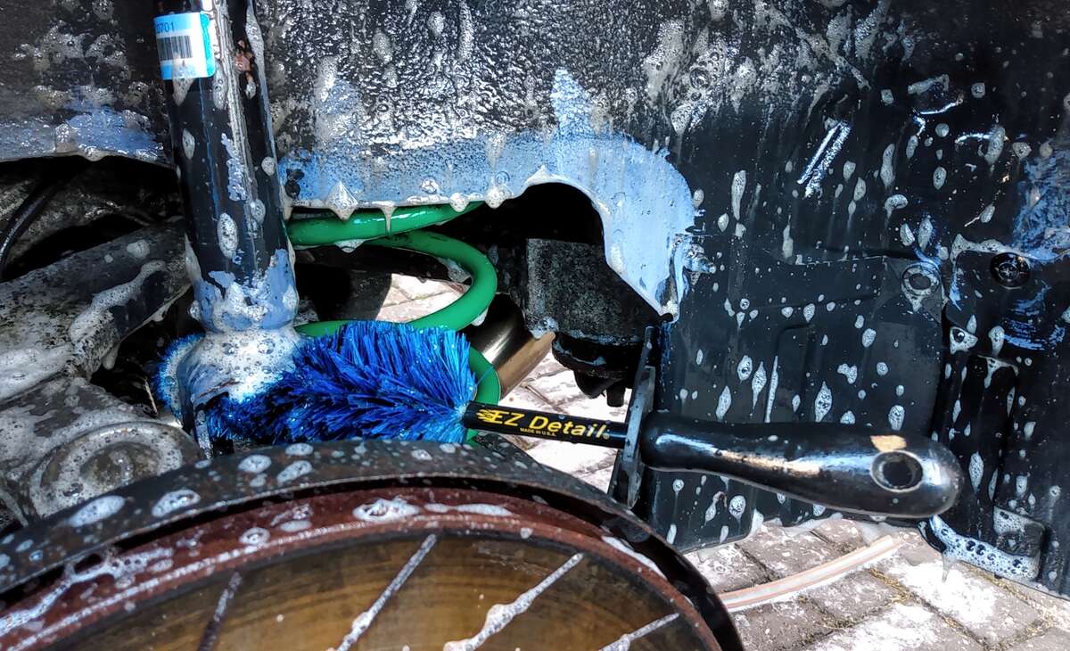

Swapped over to my summer wheels and set about cleaning out the arches, taking advantage of the overlaps labour.
- Bilt Hamber Autofoam 5:1 through foam cannon.
- Various scrubber brushed
- ACF50 for the suspension and steering components
- Autoglym Tyre dressing for wheel arch liners
Dirty now clean pictures
Behold the floating Zed
Deep clean required for another day
Not looking terrible for 18 months worth
Dried and protected

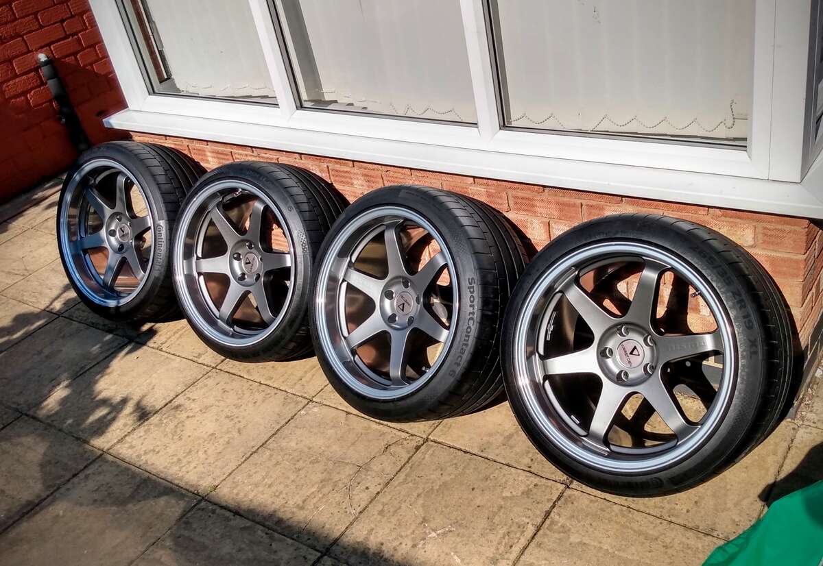

Wheels the day before curing in the sun after a coat of Gtechniq C4
First time ever swapping wheels using an impact gun, best driveway DIY tool ever
Car washed and dried as the bodywork has over spray from cleaning the wheel arches, tyres dressed in what can only be described as Jerry Curl Oil :lol:
Tyres pumped back up from 30/31 psi to 34psi and relax

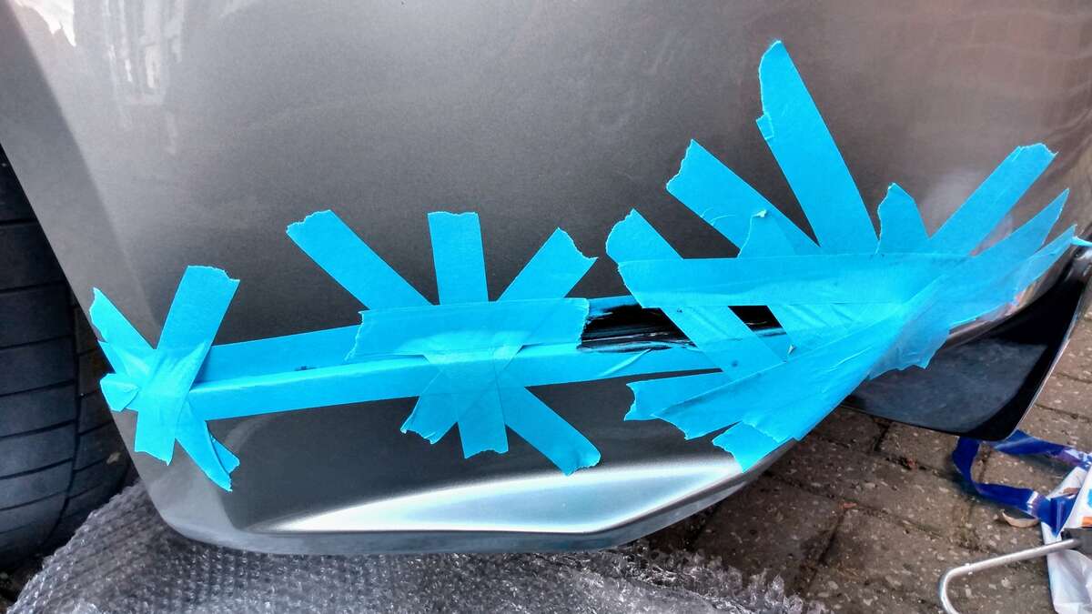

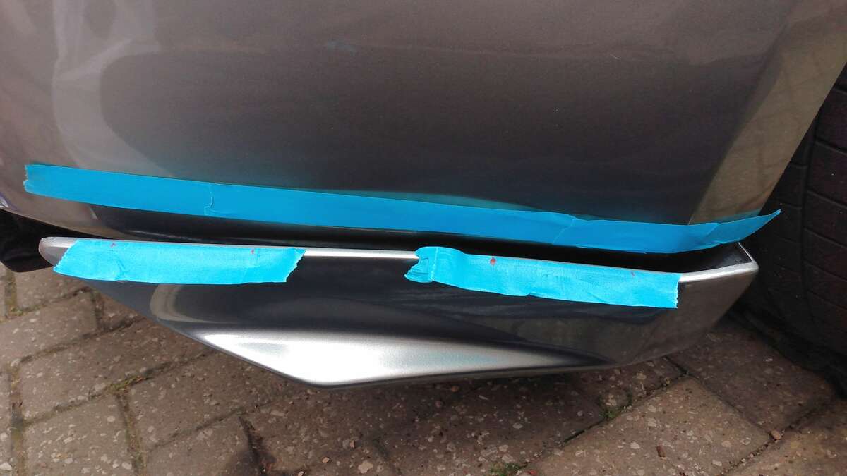

Since having the new burnt tip exhaust fitted, it's become even more apparent the rear was lacking presence. Having stainless roll tips before helped give shape to the rear, which was now lacking. Picked up the bits below and set about fitting these prior to the Midlands Z meet on Sunday.
Massive thank you to @CLASSIX for prepping and painting the rear spats, a perfect colour match and glossy finish. Soon after @ShortPaul was selling a DE bumper insert and who can say no to a bit of carbon.
First up, the easy part.
The diffuser took muck fettling to sit right against the bumper.
Spats also needed contouring, grinder stones and emery paper required once bulking areas marked out.
Never dealt with any type of bondo but slapped out the tiger seal. Heat gun also helped to relax the fibreglass.
Left to cure and the next day, ta damn
Considering I've not done any minor body fitting before, I was quite proud of myself for getting stuck in.

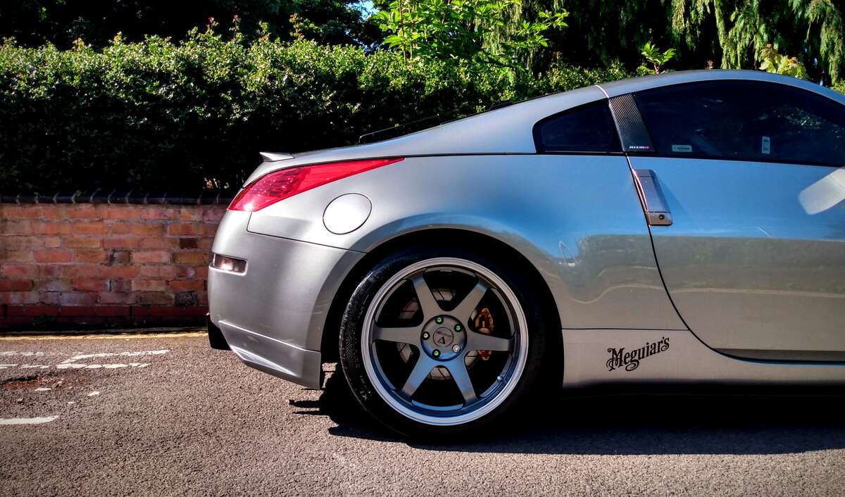

Took longer than 6 days but she's very nearing completion, more than happy with the looks now. Over a factory GT, its more towards a GTS feel. Inline with what manufacturers currently offer for their sport cars ie suspension, exhaust, wheels, diffuser, splitter, alcantra and carbon options.
Edit - bumped her down a notch, from Clubsport to GTS

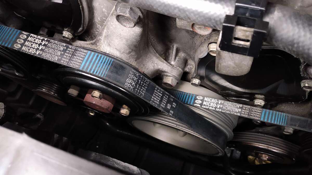

Fitted a lightweight crank pulley, tackled the job from up top. Definitely possible but unless you have skinny long fingers like me, set aside the time to take of the engine undertray to do it properly.
1kg vs 2.8kg
Turned over twice by hand to check for binding, alignment looks good
All tucked away hidden
Cheers pal, getting the spanners out on your own car is all part of the joy. In my excitement went out for a drive last night and the difference was felt straight away. Watching out for the placebo effect, I weren't expecting alot.
Rolling on/off the throttle feels more fluid if that makes sense. I guess that touch easier now asking the big VQ to go from declaration to acceleration. Revs out quicker and so pulls just that touch harder. When pulling away normally, now feels smoother on take-up *always personally struggled with this. Even part throttle feels keen to build rpm.
 I would say it's made more of a difference to acceleration than any individual engine/exhaust mod thus far.
