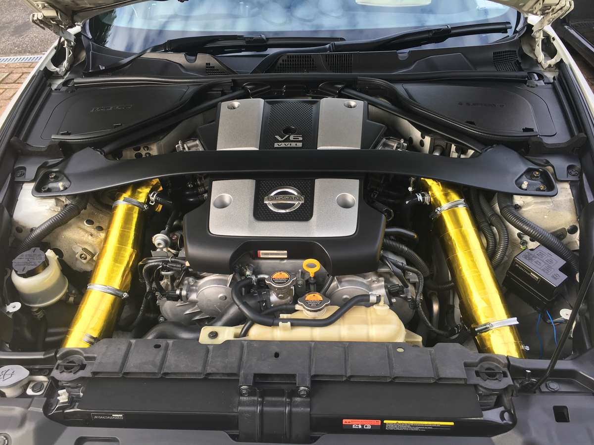

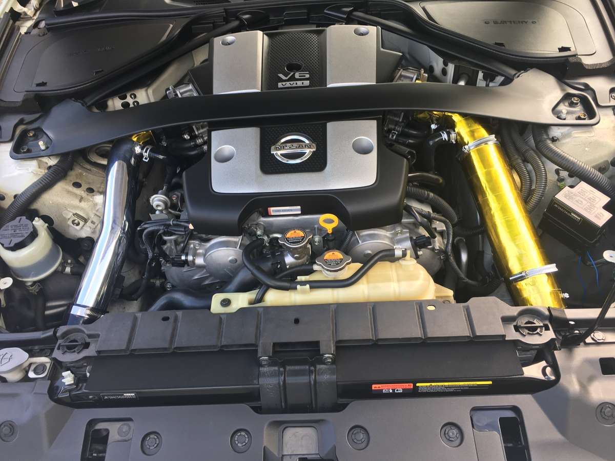

nub Posted February 21, 2018 Share Posted February 21, 2018 (edited) Bumping an old thread. I was sceptical but on my remap Mark proved to be correct about CAI vs stock Intakes. Simply touching the aluminium for a second, I can’t deny that it’s too hot to even place your hand on it. And no plastic or silicone will get that hot. My Z1 CAI kit did not seem to contribute to the gains from my other mods. However, im still confused as in the states, on their forums you hear a very different and contradicting theory. it’s seems pretty much indisputable that the stillen, Z1, AAM style CAIs etc are indeed considered to be the most effective Intakes. With gains of at least 10bhp over stock setup (dependent on existing mods) which sounds reasonable with larger “cold air” filters. I mean literally everyone chooses one of the CAI options, Z1 promotes it in their 400bhp kit. There’s no mention of heatsoak in the states or any conflicting opinions or alternatives. All of them including the manufacturers like stillen themselves, agree that these CAI performs as it claims. Certainly, I’ve never heard the idea that stock intake provides better gains, or that the CAIs are in fact detrimental with due to heatsoak. So something doesn’t add up, as the 350/370Z scene over there is surely much bigger than ours. They cannot all be entirely deluded and misled. Or the general consensus and concept of the CAI over there is basically a scandal of false claims lol. I mean there’s so many dynos over there, somebody would have realised by now if their stock intakes out performs the CAI. But like I said, as much as I’ve read I’ve not seen any threads or posts that challenge or question the possibility. Yet as I said, my pipes were hot as ****. And there’s no doubt that any gains from design, larger filters, bigger intake pipes, velocity stack is at least somewhat negated by heatsoak. They even go further and sell products that are upgrade add ons for your existing CAI. And they are also dyno proven claimed to add another 5-10bhp! Simply by repositioning the filter positions slightly and using even larger filters. Looking at Darren’s 323whp it seems consistent to confirm that in my case, the Z1 CAI was the weak factor robbing my precious NA bhp. Considering I expect my setup would otherwise provide similar gains. It should even be a bit less restrictive in comparison.I’ve got ART Decat Pipes as opposed to Cobra HFCs. As with most cars, I would expect a decat to give at least 5bhp over a pair HFCs. Not a huge difference but even with the most highest flowing 200 Cell HFCs...logically and visibly they must be more restrictive and give several bhp less than a decat. In terms of exhaust, I have Ark Grip CBE, which as far as I know and based on design would be similar in performance compared with a milktek. I don’t know if one is better but I know other larger bore CBEs like AAM/motordyne Shockwave would outperform both, by another 5-10bhp (as a guess!) I had fast intentions on before and that was less restrictive but too loud. So we are left with my Z1 CAI vs Darren’s stock intake with K&N filters. All mods considered this appears to be the biggest factor. I wonder if I would gain 5-10bhp by reverting to the same stock setup with drop in filters. 10bhp is petty and not enough to justify the cost I know lol. but since I’m due a service anyway I am sad enough to consider doing the switch and remap anyway. Also my car was remapped on the hottest day of last year, around 32C. If it had been Like 0 to -2 degrees like the current night temps I might have gained another 5bhp lol I still cannot explain all the contradictory claims and dyno charts it in the states. And TarmacSportz etc are happy to recommend and sell the products? backing up the claims too. Could it be possible that these CAIs do generally function as intended in normal outdoor road conditions. But might be more susceptible to heatsoak and less functional in an enclosed dyno room? I know all dynos have huge fans to compensate for air flow, and even with the bonnet open, but how many fans does it take to accurately replicate road conditions? I’ve no idea and it’s just a theory. I know all dynos are different and any margin of error between any dynos comparisons wouldnt prove anything. But I’d be interested to know if TDI north non hub dyno rollers also demonstrate that CAIs are useless? Ive been there twice with my hondas, they map Zs too. Silicone/plastic Long CAIs are undeniably the best options for the Type Rs and K20s. Hybrid racing and skunk2 for the FN2. There’s some distance between them but I always see tdi recommending Abbey with the ECUtek so im guessing there’s some partnership or something. They don’t map nearly as many Zs and don’t quite match the experience and knowledge of Abbey or Horsham. but CAIs are basic stuff and Paul West will definitely have some knowledge to give an opinion. On the functionality of our CAIs, based on some of their customers. If he also condemns CAIs then I might take mine out and burnt it Or sell it to an American heres my attempts at reducing heatsoak btw. It’s quality 3” silicone with thick walls which I managed to wrap around the majority of the aluminium. And then I covered that in layers of the best gold heat reflecting tape. 3 or 4 layers in some areas on it. I tested one side first to compare , and the surface temp was 60c on the aluminium but half that 30C on my heatsoak protected effort. Which doesn’t mean the aluminium underneath is the same temp but it definitely helps. just comparing the silicone couplers there was a significantly lower surface temp. But as you go further up towards the TBs there’s more metal to metal contact which reduces the difference. But at speed the airflow might now have an easier job of keeping the cold or cold, as it flows within the pipes that are now very well insulated and less exposed to heatsoak from the engine bay Edited February 21, 2018 by nub Random wrong pic Quote Link to comment Share on other sites More sharing options...
Tricky-Ricky Posted February 21, 2018 Share Posted February 21, 2018 I think your getting way too hung up over 5-10BHP which in reality you will likely never really notice, if wrapping your intake makes you feel better great! but heat soak cant really be avoided, just reduced. There will be a maximum and an average under bonnet temp that is pretty much unavoidable, during normal running, but temps will climb under both high load and low speed or stop, The air speed in your intake will be pretty cool due to the boundary layer effect and the position of you intake, which should have access to outside air, under normal running IE at speed, The boundary layer effect means that despite the intake pipe temps on the outside, the inside airflow will always be cooler due to the layer of virtually static air that acts like an inner insulation between the moving air and and pipe walls no matter what the material, so as long as the airflow speed within the pipe is high enough, the moving air will pick up very little heat. So as said before once you're in low moving traffic or stationary this is when the boundary layer effect is overcome and the airflow inside the pipes start to heat up due to the breakdown of the boundary layer, more noticeable on FI cars because of the hot air producing less boost due to hot air being less dense. Quote Link to comment Share on other sites More sharing options...
nub Posted February 21, 2018 Share Posted February 21, 2018 Oh I know debating 10bhp is silly. I’ve also heard that the air passes through so quickly that it doesn’t warm up. But if what you’ve said is true, it doesn’t explain why stock intake outperforms the CAIs on the dynos. I think 10bhp is quite significant from the intake alone considering it’s NA. And certainly if it saves buying a £400+ CAI that doesn’t do anything Quote Link to comment Share on other sites More sharing options...

Jetpilot Posted February 22, 2018 Share Posted February 22, 2018 (edited) 22 hours ago, nub said: And certainly if it saves buying a £400+ CAI that doesn’t do anything I seem to remember the consensus when you asked was pay little attention to the "claims" and stock intakes where best and dismiss dyno readings as they often differ, i wont say we told you so, but........... Perhaps just to throw a theory out there re American cars, i would imagine in popular places, California etc the ambient air temp is considerably higher than the UK, which presumably will lead to increased under bonnet temps compared to here, so maybe dropping a filter directly into the air flow does result in gains for the Americans as its considerably lower than under bonnet temps, just a thought. I seem to remember the 350z was able to display air intake temps with torque pro app, so guess the 370z will do the same, so if you really want to check which is best and whether your insulating has made a difference you can find out. Edited February 22, 2018 by Jetpilot Quote Link to comment Share on other sites More sharing options...
nub Posted February 23, 2018 Share Posted February 23, 2018 17 hours ago, Mark@Abbey m/s said: @nub did you see this thread re a MK2 Nismo on a UK dyno. after what was been spoken on the Facebook page re Nismo 370Z BHP Yep. I was only by the claimed figures lol but you are correct again. That really sux to buy a nismo then and make 320odd bhp WITH HFCs. although I’d like the shorter FD. If someone links me to this device/app that will show IAT then i’ll give it s test. They are very very well insulated with 3” silicone and layers of gold rap. but ofcourse it contacts metal in various places as you go further up. When more air is flowing it must lower heatsoak, but obviously not enough for the metal intake temp to be cooled significantly. My insulation might tip the balance so that the airflow through the engine is now sufficient to cool down the insulated pipes, or maintain a lower IAT. So in theory the air within the CAIs remainscooler to some degree and less heatsoaked. The silicone does still gets warm with airflow like cruising at 60mph, but not nearly as hot as the exposed aluminium piping which also takes ages too cool down. I could have put even more layers of tape or silicone but it is already so much thicker and wider than it was before. Also the is a small gap in most sections between the silicone and the gold wrapped pipe, help would also help. I’ve got a thermometer I’m gonna see what I can determine. I can check my temps in different conditions if you guys can tell me what the typical temp should be. As I have no mechanical skills and won’t remove it. Maybe Mark can remember the typical temps with CAI vs the stock plus drop ins? Quote Link to comment Share on other sites More sharing options...
