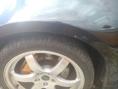

Mjforan89 Posted July 13, 2016 Share Posted July 13, 2016 Hi I looking to buy my first 350z. The car is advertised at £5,500 with 71,000 miles on the clock. However, on the advert the guy has said that there is slight 'blistering' on the arches. I got the guy to send me pics and it doesn't look too bad. But is it a good idea to even consider buying this car as I've read that rust is a big problem with the 350z's? I'd be appreciate any help and advice. Quote Link to comment Share on other sites More sharing options...
Andy_Muxlow Posted July 13, 2016 Share Posted July 13, 2016 Well tbh there is not a lot you can do about rust it happens on most cars really so if it is not too bad you could have it sorted really it just depends on how much rust there is... Sent from my iPhone using hammer and chisel! Quote Link to comment Share on other sites More sharing options...
GMballistic Posted July 13, 2016 Share Posted July 13, 2016 Welcome aboard firstly. My own experience with my old 350Z & blistering on the rear arches would say to walk away imo. The reason I say that is I paid for some minor blistering to be repaired on my old Zed at a body shop. Literally a week after I get the car back from them the blistering under the paint is back. This time I get them to take pictures as they do the work to my Zed. They cut out portions of the rear arch where the rust was & then welded in new steel. This was then prepped, primed & painted properly ~ all documented with photographic evidence. Unfortunately despite this, around a year or so later small blisters started to appear in the same area again. Really disappointed and money down the drain. They'd done other paint/body work on my car which was fine but they just couldn't get the rear arches fixed properly. Realistically I would have probably needed new rear quarters to get rid of the rust altogether or maybe another body shop would have done the job better/right in the first place but as you don't own that 350 why not try to find one without that issue already occurring as you could be letting yourself in for a right ball ache of a job to get fixed right. 1 Quote Link to comment Share on other sites More sharing options...

R35LEE Posted July 13, 2016 Share Posted July 13, 2016 To do the job properly the quarter panels would be replaced but you don't really want to get into the cost of doing that. Sent from my D6603 using Tapatalk Quote Link to comment Share on other sites More sharing options...

KyleR Posted July 13, 2016 Share Posted July 13, 2016 That picture is of the front arch, so if it's only the front they are easily replaced and not nearly as expensive as the rears. Offer him £4,500 take it or leave it. Quote Link to comment Share on other sites More sharing options...
Dicky Posted July 14, 2016 Share Posted July 14, 2016 I had a small amount on both my rear wheel arches, it's a common problem due to the inner and outer wheel arches being spot welded every 4" or so where they come together, leaving a slight gap where water can get in. I had the rust cut out and lots of wax oil squirted inside the arches, then new metal welded back in. It cost me £800 for both arches. 1 Quote Link to comment Share on other sites More sharing options...
