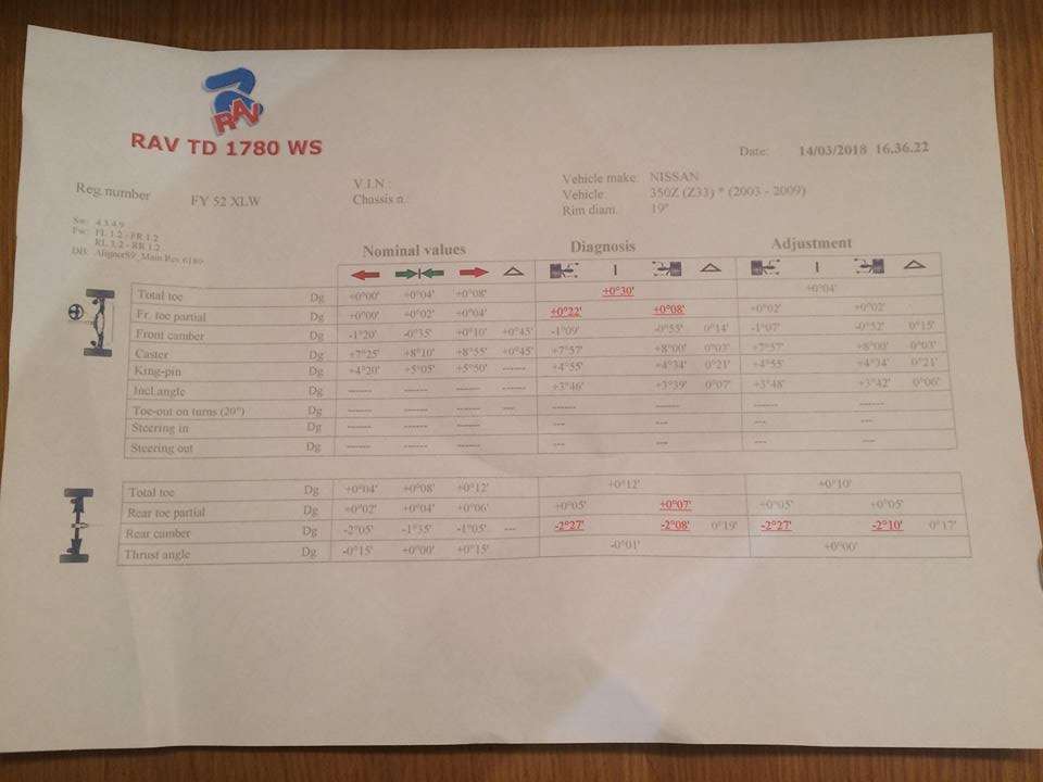

valy Posted March 15, 2018 Author Share Posted March 15, 2018 (edited) part day at H-Dev today: suspension check plus front & rear drop links replaced p1 service done and new nissan oil pressure sensor fitted wheels alignment done air con belt readjusted as it was squeaking a bit sometimes as usual when driving somewhere my phone battery dies after the first snap anyway good to chat to the boys a bit,see and hear the twin turbo track 350z that they built and the other SC Z projects Edited March 15, 2018 by valy Quote Link to comment Share on other sites More sharing options...
