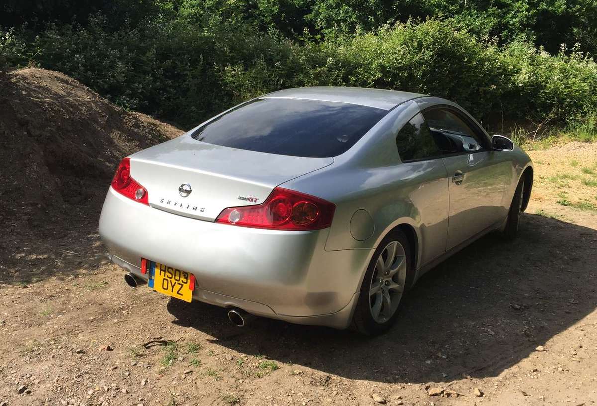

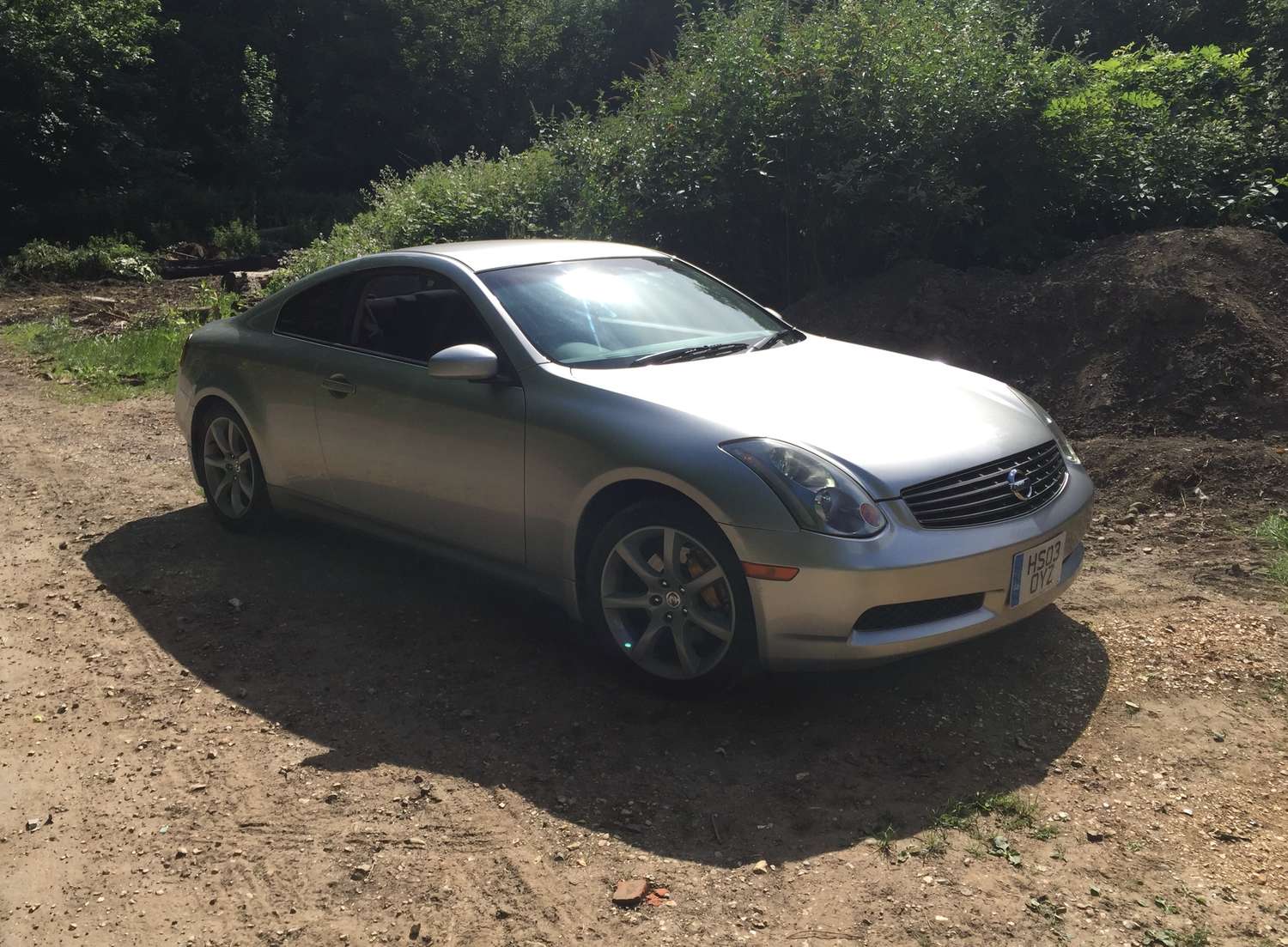

Tom_K Posted November 25, 2017 Author Share Posted November 25, 2017 (edited) Not sure how many pictures you can upload to this site directly but here are 2 to remind you: Edited November 26, 2017 by Tom_K Quote Link to comment Share on other sites More sharing options...
