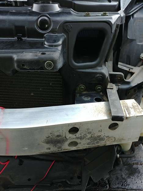

cob1980 Posted April 4, 2018 Author Share Posted April 4, 2018 On 02/04/2018 at 17:32, HEADPHONES said: Those headlights look badass and finish off the edgy look a treat Thanks buddy Another update... Whilst the front bumper was off to fit the headlights I fitted this EVO-R Type I air duct, I managed to get this from a fellow member GrahameJ for £93. Small bit of trim-age required... Hi-flow cats on order now, which will complete the mods before remap.... EVO-R air duct Velocity stack mod Cosworth panel filter Motordyne plenum spacer Lower plenum thermal gasket ARK R-Spec High Flow cats (to be fitted) Unknown Y-pipe Nismo exhaust That's all... Iain. 1 Quote Link to comment Share on other sites More sharing options...

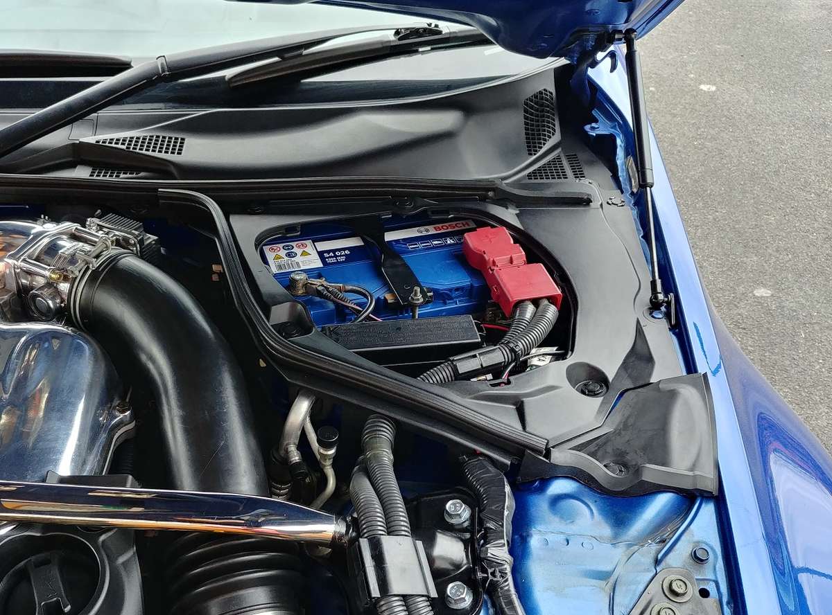

cob1980 Posted April 1, 2020 Author Share Posted April 1, 2020 2019 the battery gave up. I took on the challenge of finding the biggest capacity battery that would fit without any modification. I found the Bosch S4 026, and even better it had a blue top! 70Ah with 630A cranking power. Quote Link to comment Share on other sites More sharing options...

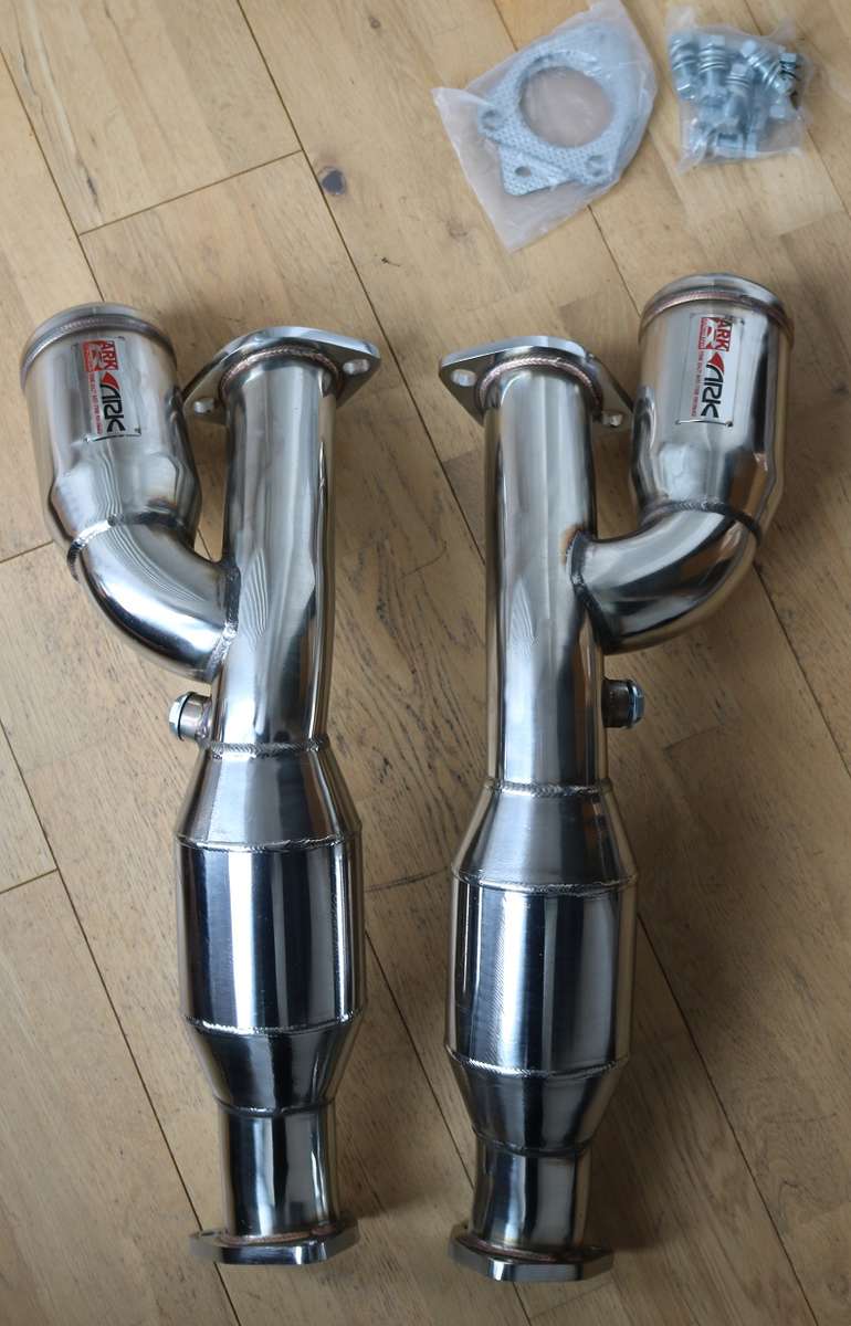

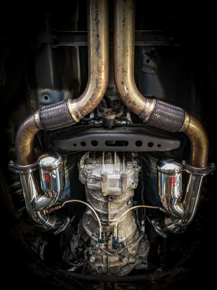

cob1980 Posted April 1, 2020 Author Share Posted April 1, 2020 (edited) Next up for summer 2019 were my ARK Performance Spec-R High Flow Cats. These beautifully made HFC's have been sat in a box for quite some time before I got around to having them fitted. I do have some before and after videos, but I guess I have to host these on YouTube or something? I compared the previous Mot emissions with standard cats to this years Mot with HFS's. Here are the results: Standard cats: CO 0.019 (max 0.200) HC 0 (Max 200) Lambda 1.002 (1.000 is optimum) HFC's CO 0.050 (max 0.200) HC 14 (max 200) Lambda 0.999 (1.000 is optimum) All very low which is testament to the quality of them. However, I'm not convinced I'll be keeping the HFC's. I'm not 100% on the combination of the Nismo + HFC's. I prefer something a little more subtle. So these could be up for sale! Edited April 1, 2020 by cob1980 Quote Link to comment Share on other sites More sharing options...
