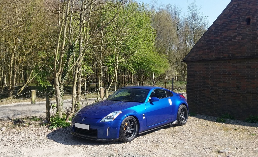

Si8pny Posted April 5, 2017 Share Posted April 5, 2017 That front splitter looks really nice. Did you have to trim any of it to fit? Quote Link to comment Share on other sites More sharing options...
Olly350z Posted April 5, 2017 Share Posted April 5, 2017 Please fit those facelift front lights haha. Or sell them to me! Quote Link to comment Share on other sites More sharing options...
cob1980 Posted April 5, 2017 Author Share Posted April 5, 2017 That front splitter looks really nice. Did you have to trim any of it to fit? Cheers yes very pleased with it especially considering how much some carbon fibre lips are. Very minimal adjustment, just used the dremel on one of the corners on the right hand side as it was a bit too tight. One screw either side and then Sikaflex to bond it on. Please fit those facelift front lights haha. Or sell them to me! Ha! I've had them for a year now, I've cleaned up the lenses as the one especially was very scratched. But I want them blacked out and iron man mod first. Just not got around to sorting it. Looking forward to that mod though! Quote Link to comment Share on other sites More sharing options...

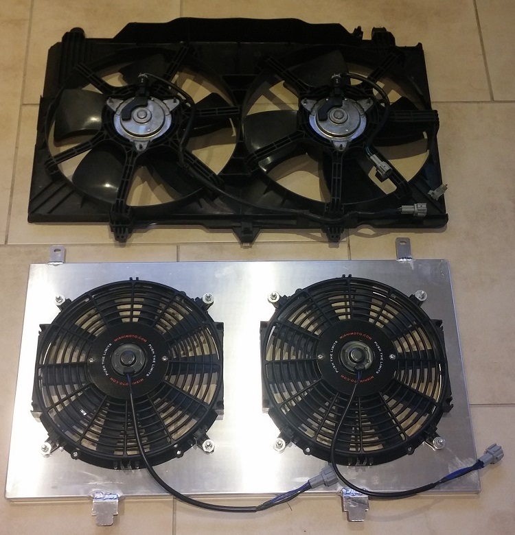

cob1980 Posted April 8, 2017 Author Share Posted April 8, 2017 (edited) On Saturday was the first day I took the Z out since the end of Nov last year, I realised the radiator fans had packed up. I tried to refurbish the old motors; this worked to a certain extent but I don't think the passenger side fan was 100%. Mitz at Cougar Store sorted me out with a pair of Mishimoto fans for £180 which I got fitted this week. I was warned on here and by Mitz and on here about how noisy they are. On one hand it's reassuring that you can hear them working but on the other hand they do get a bit of getting used to. Anyway, all fixed cleaned and ready for it's service and Mot. Good news - service done and Mot with no advisories And the sun was shining so out for a drive... Iain. Edited July 3, 2017 by cob1980 Images 1 Quote Link to comment Share on other sites More sharing options...
Olly350z Posted April 8, 2017 Share Posted April 8, 2017 Looking awesome buddy! The azure blue is so nice. Just how noisy are the fans then? Quote Link to comment Share on other sites More sharing options...
cob1980 Posted April 8, 2017 Author Share Posted April 8, 2017 Looking awesome buddy! The azure blue is so nice. Just how noisy are the fans then? Cheers yeah love the Azure blue. Because the fans are single speed it's the same as when you are stuck in traffic for ages but even just having the aircon on does this. If I can find replacement motors at a reasonable price I'l probably change it back, but for now it's not top of my list as it works. Need to work on these headlights next... Quote Link to comment Share on other sites More sharing options...
reeceybeaney Posted April 8, 2017 Share Posted April 8, 2017 The mishimoto fans are noisy, very noticeable if stuck in traffic Hate seeing azure blue zeds like this, makes me wish I got one Lovely zed! Quote Link to comment Share on other sites More sharing options...

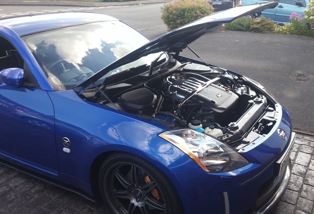

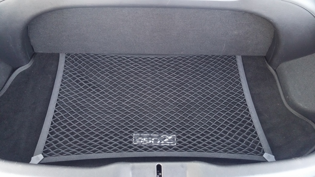

cob1980 Posted July 8, 2017 Author Share Posted July 8, 2017 Not updated for a while. Here's the latest... Upgraded to facelift rear lights £165 from eBay, sold the old ones for £70. Fitted bonnet lifters (thanks LukeA) £45: Fitting under-bonnet (thanks rickdon for supplying) £105: Fitted a cargo net (thanks 350jimbobz for the tip), from eBay £13.59: And finally, gave it a damn good clean ready for the 10th anniversary meet next week And finally... facelift headlight mods are well underway now, see... - Iain. Quote Link to comment Share on other sites More sharing options...

P15UL T Posted July 8, 2017 Share Posted July 8, 2017 What did you use to stick the under bonnet mirror plates in place ? I've got the HR bonnet kit but it didn't come with any adhesive. If you could let me know thanks paul Quote Link to comment Share on other sites More sharing options...
cob1980 Posted July 8, 2017 Author Share Posted July 8, 2017 2 hours ago, coldel said: Great price on the rear lights Yeep, was on the lookout for ages. 18 minutes ago, P15UL T said: What did you use to stick the under bonnet mirror plates in place ? I've got the HR bonnet kit but it didn't come with any adhesive. If you could let me know thanks paul Hi Paul I used this stuff: http://www.screwfix.com/p/geocel-trade-mate-mirror-fix-white-310ml/95057?_requestid=374876 Good for metal panels and heat resistant, i fitted a couple as a test, left for 24hrs and took the Z out for a drive to warm up. Couldnt shift them so looks to have done the trick. I cleaned and degreased before fitting, and used folded post-it notes to hold them in place Just hope i never want to remove them now... Iain. 1 Quote Link to comment Share on other sites More sharing options...
