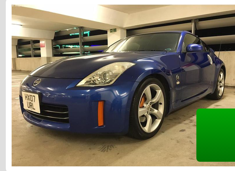

RavenDW Posted May 16, 2016 Share Posted May 16, 2016 (edited) Or was there some crossover? To clarify, my Zed was registered in April 2007 (according to the DVLA). Whenever I do insurance quotes etc. it comes back listing it as a 313 rather than one of the lower bhp models. It has the GT pack; Bose system, cruise control, heated seats etc. However, the by the lack of bonnet bulge and looking in the engine bay it isn't a HR, right? Not to mention it only has one intake. ( (Please excuse the dirty engine bay. The last few weekends have been busy; I've only just about been able to wash the outside.) So does anybody have a clue as to where I stand? Because at the moment it seems like I was assuming the insurance companies etc. (including the tax man) were correct and they have been charging me for a 313 HR and not a rev-up DE (which this looks like this is). The rev counter has the redline in 7k, rather than 6.5k or 7.5k like the other models. Admittedly it means I won't have to worry about the gasket issue that I've been following, but I'm confused. Edited May 16, 2016 by RavenDW Quote Link to comment Share on other sites More sharing options...
Lexx Posted May 16, 2016 Share Posted May 16, 2016 There was a large batch of late registered Rev-up cars sold in 07. So there is some over lap. Quote Link to comment Share on other sites More sharing options...
GMballistic Posted May 16, 2016 Share Posted May 16, 2016 That's a DE RevUp 350 there judging by the engine picture & where you say the redline is. Quote Link to comment Share on other sites More sharing options...
ATTAK Z Posted May 16, 2016 Share Posted May 16, 2016 A few 07 cars are DEs ... indeed some DE engined cars got stuck in Ireland and weren't registered till even later so yours is deffo a rev-up DE engine Quote Link to comment Share on other sites More sharing options...
ATTAK Z Posted May 16, 2016 Share Posted May 16, 2016 Another give away is the colour; no HR cars came in Azure Quote Link to comment Share on other sites More sharing options...
RavenDW Posted May 16, 2016 Author Share Posted May 16, 2016 Okay guys thanks for the info. I was pretty sure I was right. Not sure how to feel about not have a HR but hey. Now I just need to make sure that companies don't assume I have a 313 in the future. Quote Link to comment Share on other sites More sharing options...
