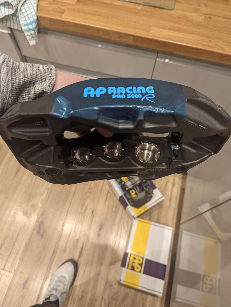

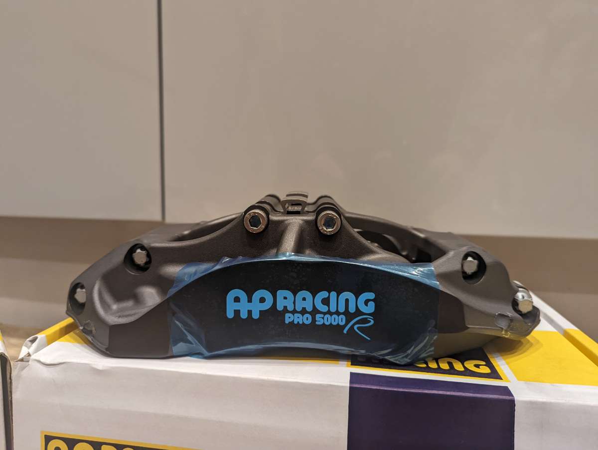

nissanman312 Posted January 29, 2022 Author Share Posted January 29, 2022 (edited) It's been a while but I've got a new mod ☺️ I did a track day a few months ago and the stock brakes although ok didn't really allow me to keep lapping so I've gone for a mega upgrade and one which I may make available to anyone else interested. It consists of the ap 5000r 6 pot caliper brackets and bells to suit either 350 or 370 and a set of used btcc j hook discs and pads all for less than a set of Chinese brakes . If anyone I'd interested keep following and I'll have more fitted pictures soon and prices tbc but for now here's a little sneak peak Edited January 29, 2022 by nissanman312 4 Quote Link to comment Share on other sites More sharing options...

nissanman312 Posted March 30, 2022 Author Share Posted March 30, 2022 (edited) Brackets and bells arrived along with some PFC Z rated pads for the road so it's time to get them fitted up Fitted pictures to follow Edited March 31, 2022 by nissanman312 4 Quote Link to comment Share on other sites More sharing options...
davey_83 Posted April 1, 2022 Share Posted April 1, 2022 These look MEGA!!! Looking forward to the install update. Popping your track cheery also, fair play. Pushing ones car on track is sooooo different to on road, can actually lean on the chassis and see what's underneath you. @Charlie Boy you need to follow this 👍 1 Quote Link to comment Share on other sites More sharing options...
nissanman312 Posted April 2, 2022 Author Share Posted April 2, 2022 (edited) All fitted up big thanks to @350Butcher for his expertise once again He got to test them out first ofcourse. We weighed pads calipers and discs to find just shy of 6kg weight saving per side over stock set up . and with the anti rattle springs fitted along with pad retention clips they have perfect road manners for a Motorsport set up With the added stopping power and ability to perform over and over without getting to hot I'd say that's a win win situation of anyone fancys a set let me know I'm going to put a few kits together. 😁 Edited April 3, 2022 by nissanman312 4 Quote Link to comment Share on other sites More sharing options...
