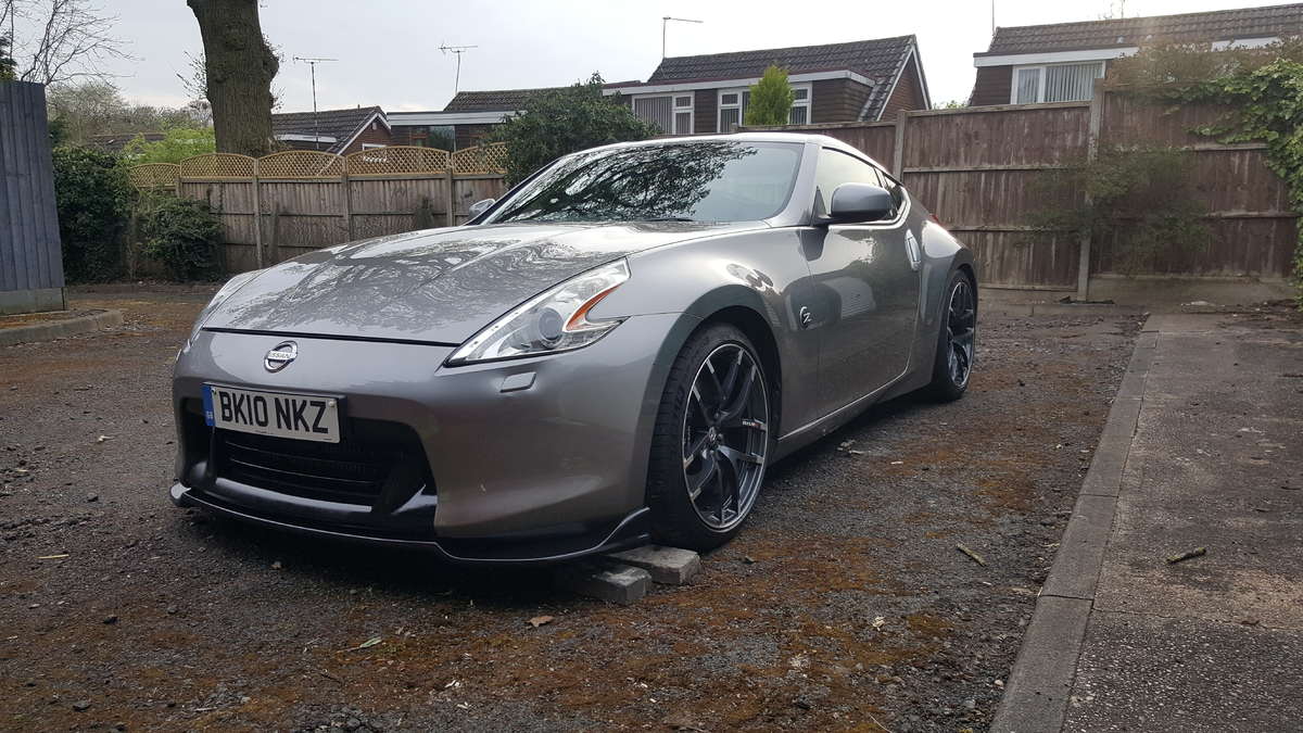

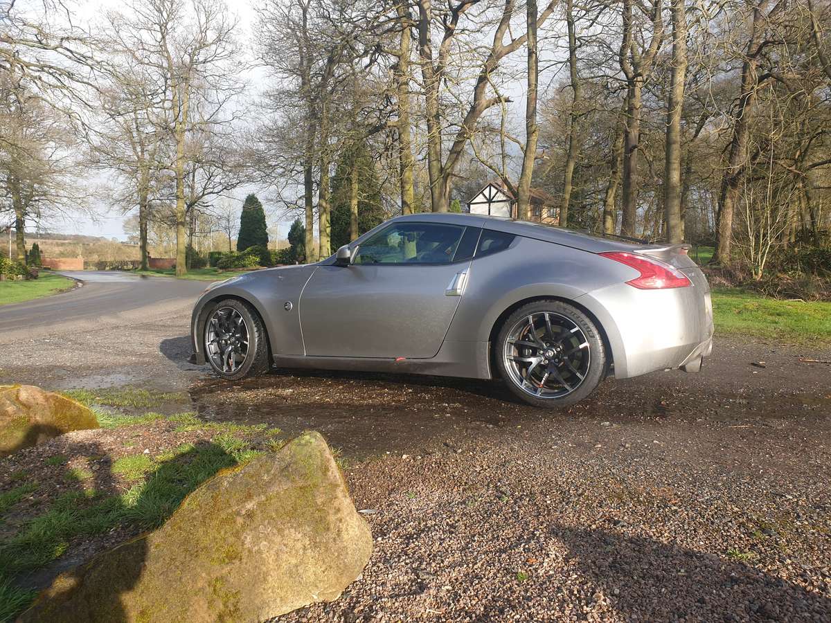

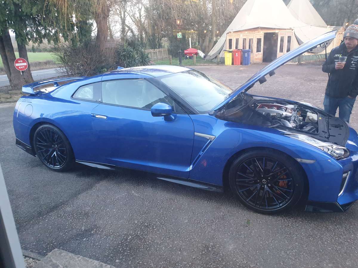

nissanman312 Posted February 29, 2020 Author Share Posted February 29, 2020 Got the nismo wheels on today I'm so pleased with how they look Also had a little ride upto caffine machine with my pal in his m3 and got a sit in this beautiful 50th anniversary gtr 2 Quote Link to comment Share on other sites More sharing options...
andy james Posted March 1, 2020 Share Posted March 1, 2020 Wheels look spot on buddy Quote Link to comment Share on other sites More sharing options...
nissanman312 Posted March 1, 2020 Author Share Posted March 1, 2020 2 hours ago, andy james said: Wheels look spot on buddy Thanks andy I wasn't sure but I'm realy pleased with them Quote Link to comment Share on other sites More sharing options...
davey_83 Posted March 1, 2020 Share Posted March 1, 2020 As in WhatsApp, they've made the car!! Looks amazing chap. 1 Quote Link to comment Share on other sites More sharing options...
SHEZZA Posted March 1, 2020 Share Posted March 1, 2020 Wheels look great mate, really suit the colour of the car. 1 Quote Link to comment Share on other sites More sharing options...
N13GEY Posted March 1, 2020 Share Posted March 1, 2020 Nice wheels buddy! 1 Quote Link to comment Share on other sites More sharing options...

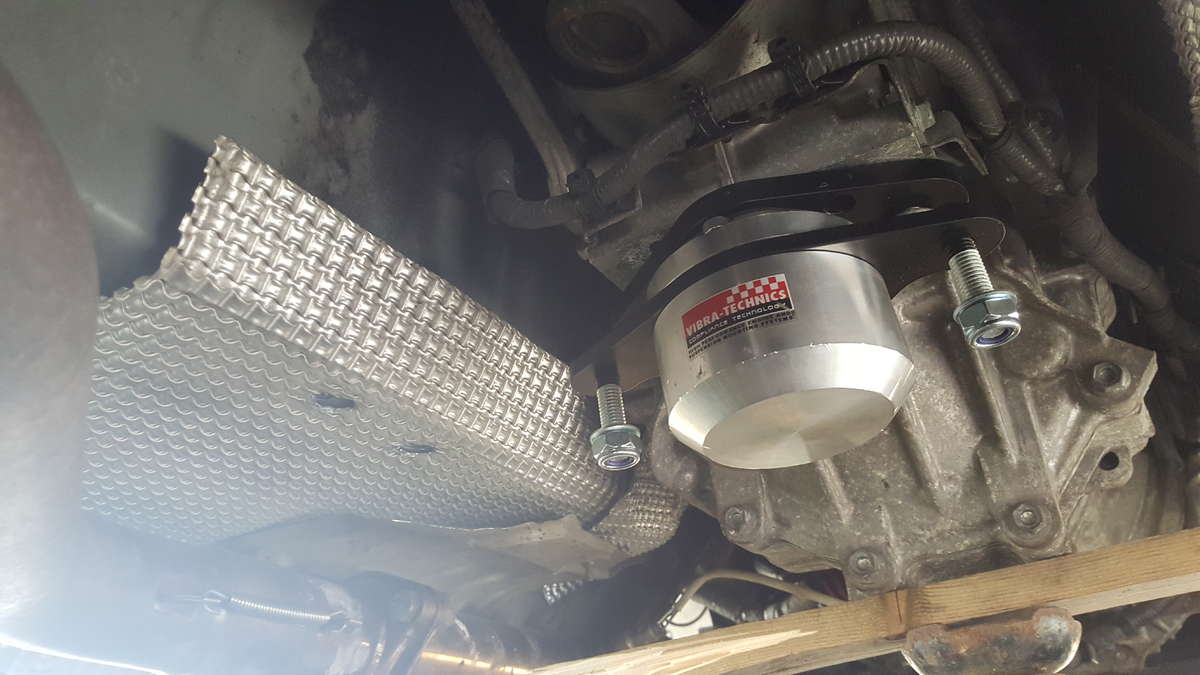

nissanman312 Posted April 6, 2020 Author Share Posted April 6, 2020 Hi guys Hopefully you are all staying in and keeping out of harms way To kill the time I've been getting through a few jobs car included I Fitted the gearbox mount yesterday and wow what a difference that's made Shaper throttle response Sweet crisp clear changes even at full chat and an it gives the drive a general felling of confidence rather than felling like the box is flexing around under you at load 100% recommend this mount Here's some pictures of the new and old one 2 Quote Link to comment Share on other sites More sharing options...

nissanman312 Posted April 6, 2020 Author Share Posted April 6, 2020 (edited) 3 hours ago, SuperStu said: how's the NVH v OEM? Right I've been asked this a bit on my Facebook post and I'm finding it a little hard to answer in words so I'll do my best When I inatialy drive the car up the road straight away even coming down my road which is a steep hill I could tell things were different I could tell straight away the box wasn't rocking about when going on and off the clutch . Then I did a pull up to about 5rpm at which I noticed what I'll call a difrent sensation through the butt cheeks! Not a horrible noise or vibration just a difrent sensation almost like a more connected to the car sensation After 5k to recline just a nice clean gearchange and more instant feeling between pressing the pedal to something happening ...like I wasn't waiting for that split second for things to load up dose that make any sense? Within 5 mile the sensation became almost the new norm and I believe i wont even think about it going forward. I've herd of stories of mounts vibrating and resonating through the car This dosnt do that @350Butcher recommended this to me and said it wouldn't and he's right Take his advise guys he knows his stuff. I hope that kind of makes some sense mate ? ( disclaimer I have a very noisy supercharger and blow off valve so this may hide a noise if you were stock however there's certainly no excess horrible vibrations) Edited April 6, 2020 by nissanman312 Quote Link to comment Share on other sites More sharing options...
andy james Posted April 6, 2020 Share Posted April 6, 2020 I have one of these on my 350. It's the best compromise mount. OEM like jelly, the Hardrace which I had before she became a garage Queen is awesome with rifle bolt changes but It comes with Land Rover noise levels. 1 Quote Link to comment Share on other sites More sharing options...

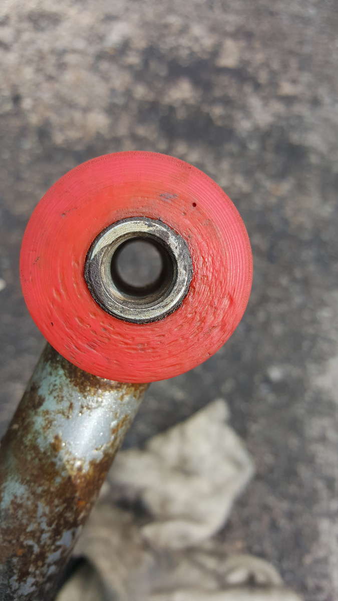

nissanman312 Posted April 8, 2020 Author Share Posted April 8, 2020 (edited) Another busy day on the car yesterday I 're bushed the kinetix camber kit on the car as I felt I was possibly getting some toe change over bumps as the rear felt like it was having a bit of a wiggle over certain surfaces I don't know if it's a characteristic of the quafie diff But I thought I'd give the bushes a refresh anyway They were not destroyed but they had seen better days The car feel a bit tighter now so the smashed knuckles were worth it I'll have them off again and give them a rub down and a paint up but I didn't have time on this visit But the all looked in good order in terms on strength no cracked welds or anything Which was a concern as they are not the best arms but id need to 're mortgage for spl so hey ho Edited April 8, 2020 by nissanman312 1 Quote Link to comment Share on other sites More sharing options...
msitpro Posted April 8, 2020 Share Posted April 8, 2020 Sickens me how all these expensive suspension parts will corrode like that due to our salty roads Although touch wood my Voodoo 13 traction, toe and camber arms seem to be holding up very well apart from the heim joints which are covered in surface rust. Quote Link to comment Share on other sites More sharing options...
nissanman312 Posted April 9, 2020 Author Share Posted April 9, 2020 18 hours ago, msitpro said: Sickens me how all these expensive suspension parts will corrode like that due to our salty roads Although touch wood my Voodoo 13 traction, toe and camber arms seem to be holding up very well apart from the heim joints which are covered in surface rust. I know yeah These are 3 years old Not that expensive but puts you off putting nice expensive rose joints everywhere they would be wrecked in no time Quote Link to comment Share on other sites More sharing options...

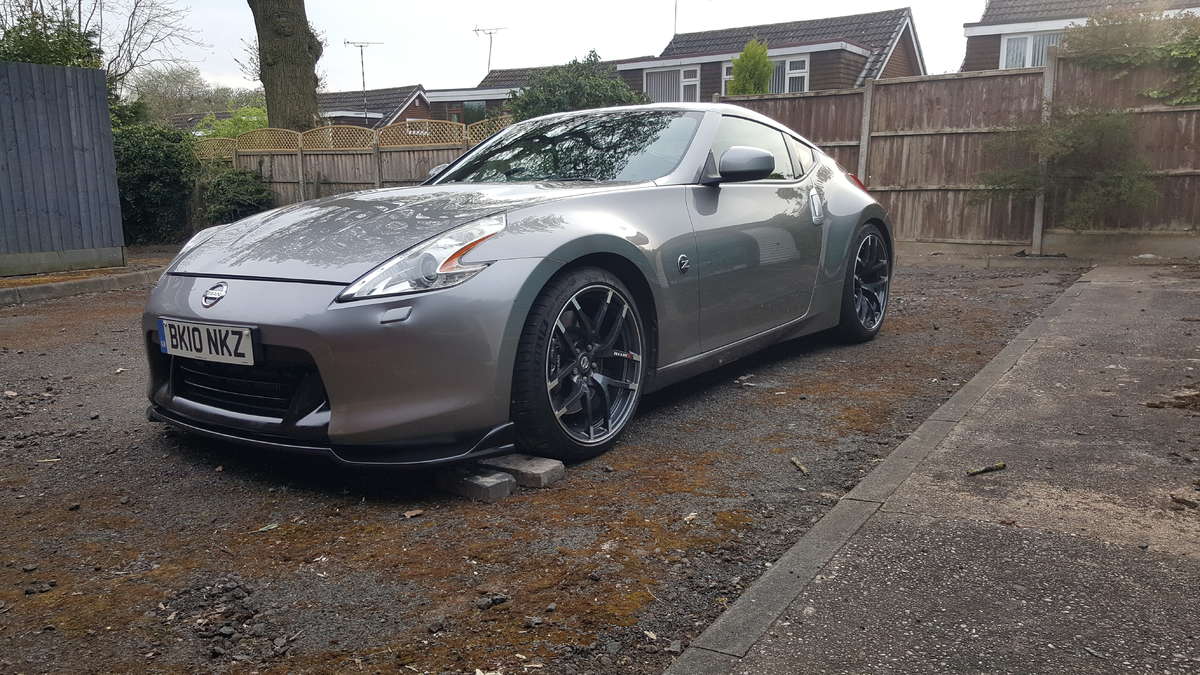

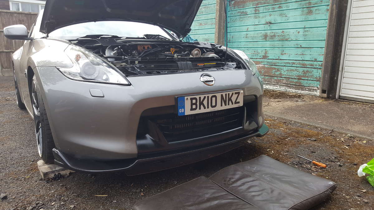

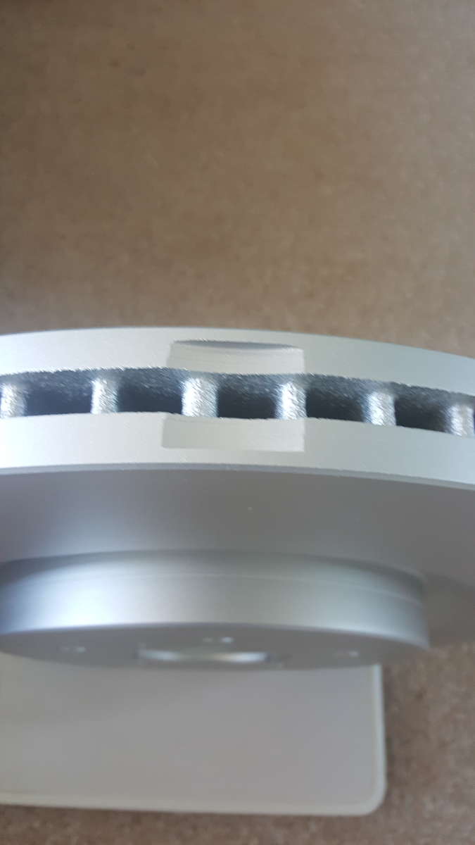

nissanman312 Posted April 21, 2020 Author Share Posted April 21, 2020 A few more running repairs/tidy up done last week in the sun The front lip and bumper got a real beating in Europe last September as you can imagine after 3000 spirited miles So it was time for a tidy up Also the new pagid one discs turned up My god these things are heavy A nice 2 piece set up is in order during better times I think These with the pfc z rated pads will have to do for now 6 Quote Link to comment Share on other sites More sharing options...

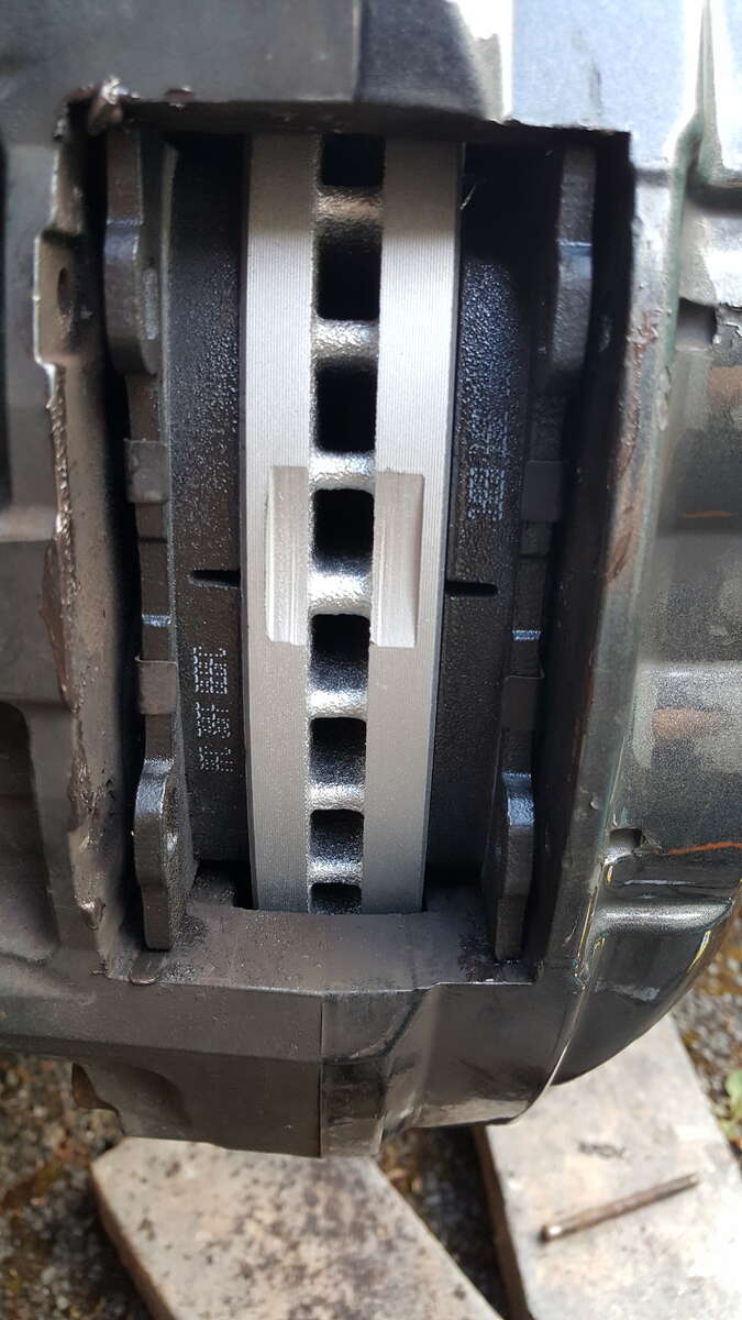

nissanman312 Posted May 11, 2020 Author Share Posted May 11, 2020 (edited) New discs and pads on the front Pagid oem replacement discs and PFC z rated pads Realy pull up well now I wasn't to keen on the hawk pads and my discs had seen better days. Edited May 11, 2020 by nissanman312 1 Quote Link to comment Share on other sites More sharing options...
davey_83 Posted May 12, 2020 Share Posted May 12, 2020 Nice stoppers!! Quote Link to comment Share on other sites More sharing options...
