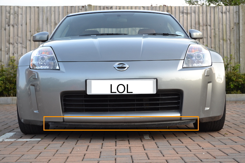

shad0wca7 Posted May 14, 2016 Share Posted May 14, 2016 As the title says, I noticed that mine isn't there any more - left on a kerb somewhere I guess! 2 Quote Link to comment Share on other sites More sharing options...

ATTAK Z Posted May 14, 2016 Share Posted May 14, 2016 A lot of cars came out of the dealerships with this part missing ... there must be a big pile of them somewhere 1 Quote Link to comment Share on other sites More sharing options...
Lexx Posted May 14, 2016 Share Posted May 14, 2016 You'll find many Zeds missing this. When the cars arrived in the UK the part was in the boot and dealers were supposed to fit it. Many didn't bother. 1 Quote Link to comment Share on other sites More sharing options...
veilside z Posted May 14, 2016 Share Posted May 14, 2016 When you replace it put some Tiger Seal Black mastic in the groove before you push it on, then leave it for a couple of hours to harden before driving. 1 Quote Link to comment Share on other sites More sharing options...
