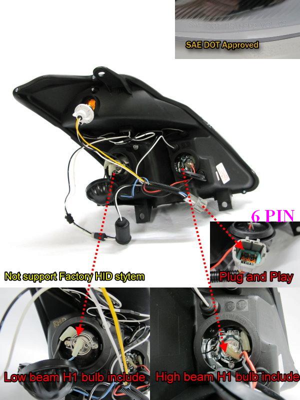

gort Posted April 24, 2016 Share Posted April 24, 2016 Hi Guys. As anybody bought these, great price! would just buy the H1 basic, I can always buy a HID conversion kit at a later time if needed http://www.ebay.co.u...sd=360420426401 the lights I have now are all crazed and full of condensation :-( from the pic of the socket, it looks like plug & play, can anybody confirm? Quote Link to comment Share on other sites More sharing options...
ZedManTID Posted April 24, 2016 Share Posted April 24, 2016 Yeah I've got these from that seller. Plug and play if you have a JDM import. If you have a UK car you'll have an 8 pin plug and not 6 pin so will have to swap the plug over Quote Link to comment Share on other sites More sharing options...

gort Posted April 24, 2016 Author Share Posted April 24, 2016 I have a UK car, so where would I get a 6 pin plug from? Quote Link to comment Share on other sites More sharing options...
ZMANALEX Posted April 24, 2016 Share Posted April 24, 2016 I have a UK car, so where would I get a 6 pin plug from? If you fit 6 pin you will lose your auto headlight levelling. Cheap eBay tat, best to avoid unless you want continual grief. Just saying. 1 Quote Link to comment Share on other sites More sharing options...
gort Posted April 24, 2016 Author Share Posted April 24, 2016 how big a job is it to fit these, don't suppose you good fit mine? Quote Link to comment Share on other sites More sharing options...
ZedManTID Posted April 24, 2016 Share Posted April 24, 2016 (edited) You'll have to cut and use the plug from your old lights. I think two of the wires on your UK car are for the headlamp levelling, if I remember correctly, so you'll lose use of them. Edited April 24, 2016 by ZedManTID Quote Link to comment Share on other sites More sharing options...
