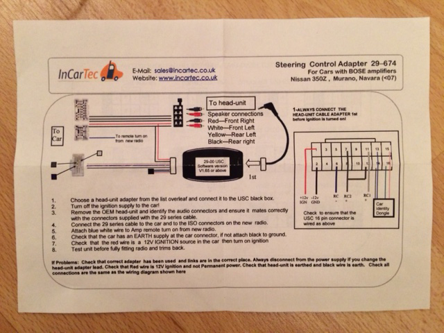

temporarily - I'm now just thinking for speeds sake to just use the regular harness without steering wheel controls - which has two adapters which seems to be plug and play - unless its' a defo no no - I don't want to damage circuits etc.
(attached picture)
