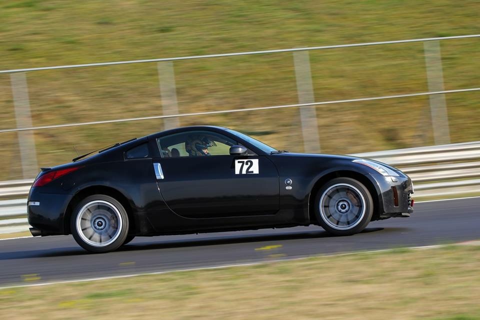

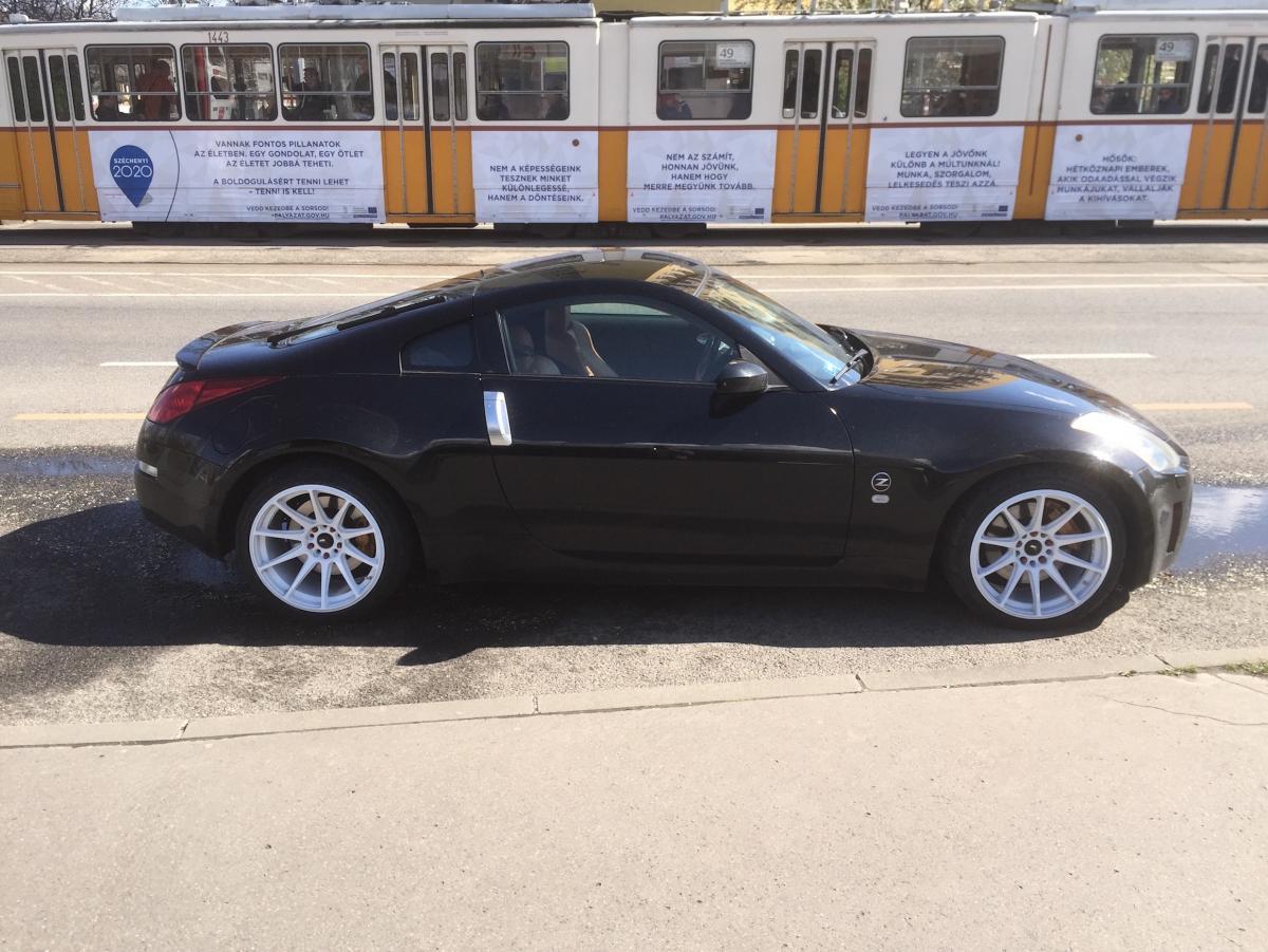

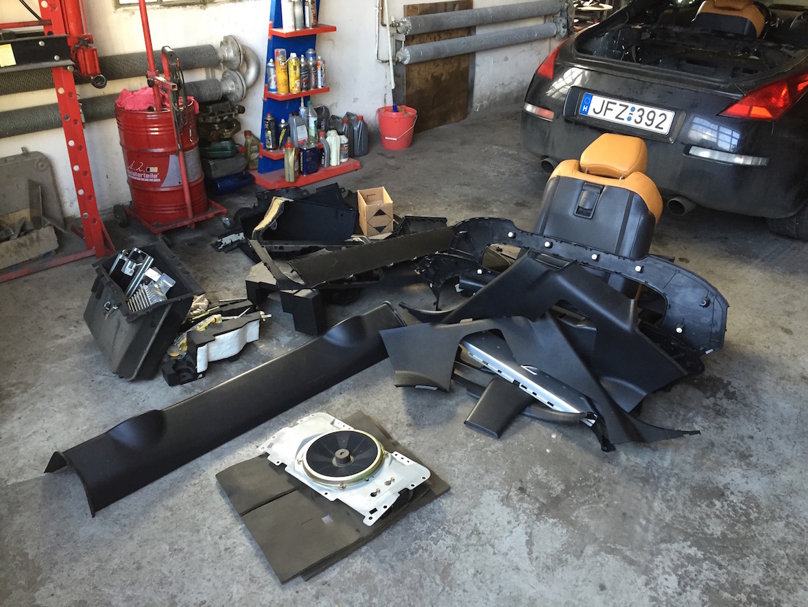

Fuli Posted February 29, 2016 Share Posted February 29, 2016 Hi Guys! I'm new here, so a few words about myself: I'm 30 and living in Budapest, Hungary. I had ( and also have ) some sportscars in the past 12 years, subarus, audis and the like. 2 years ago I've bought a '04 Nissan 350z ( 280hp european version with 6speed manual and brembos ). Last year I started racing in the national time attack series with it, as a full stock car. I nearly won my category, ( i was 2nd because i had to skip 2 rounds ) For this season we decided to participate in the pro category and make the car a bit lighter and do some upgrade on the suspension too. The plan was to reduce it's weight min. 100kg and gave fully adjustable cambers and coilovers for them. So the current setup: '04 Nissan 350z ( VQ35DE - full stock engine ) - Driftworks Handling Pack ( HSD monopro coilovers , adjustable arms around, ) - Sparco Pro2000 seats, RRS stearing wheel, - -113 kgs out ( + 2x 11,5kg seats with brackets so the balance is -90kg from its stock weight ) - EBC black grooved sport discs with Ferodo DS3000 racing pads - Japan Racing JR11 wheels ( 9,5x 18 front and 10,5x 18 rear ) - slick tyres on the way. I hope you will give some advice and good ideas for my build, so that's why I'm join this community. Try to attach some pictures: 3 Quote Link to comment Share on other sites More sharing options...

Jetpilot Posted February 29, 2016 Share Posted February 29, 2016 Be intetested in the weight loss, I.e how did you loose 90kg I would probably loose the relatively heavy jr alloys for something light, that will make a world of difference, possibly some 2 piece discs with ally bells, unsprung weight is the best place to loose bulk. 1 Quote Link to comment Share on other sites More sharing options...

GT4 Zed Posted March 1, 2016 Share Posted March 1, 2016 Welcome. A few of us here have fully stripped the zed and still finding ways to get the car lighter. I'm currently at 1380kg but going for a full cage so will gain some more. Ultimately how much weight you can loose depends on your class rules. But in general: - lightweight wheels. Rays are among the lightest/strongest unless you can afford more exotic stuff. - full interior strip including sound deadening and unnecessary items behind dashboard. - replace door, window and bonnet with carbonfibre parts. Dry carbon is better than wet. - replace all glass except windscreen with lexan or plexiglass. - remove or hole-punch and chassis double skin that is not structural to offset cage weight - hole punch the front and rear crash bars - lightweight flywheel, clutch, pulleys and AC delete - Full underbody strip if possible. The tar weighs a lot. - lightweight battery - light weight 2 piece brake disc with aluminum hats - 304 steel/titanium exhaust from header to tail tip with added benefit of performance. - since you are using true rear coilovers swap the rear spring bucket arm for a lighter adjustable toe arm And any major thing I've missed someone will surely point out. While weight loss is important you can improve handling by swapping all the bushes to urethane or solid bushes. Good luck and keep sharing. 1 Quote Link to comment Share on other sites More sharing options...
