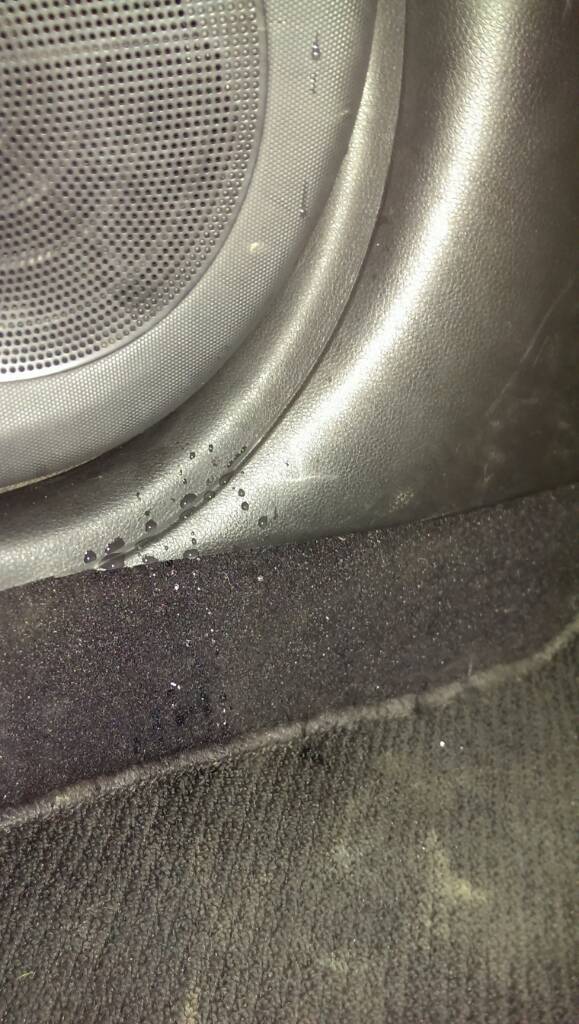

leeroy73 Posted January 23, 2016 Author Share Posted January 23, 2016 Ok checked the rear lights defo not coming on in from there .. it a coming from the passenger footwell trim area see pic. And it's filling the front foot well Sent from my HTC One using Tapatalk Quote Link to comment Share on other sites More sharing options...
Mopedmark Posted January 23, 2016 Share Posted January 23, 2016 Remove that plastic panel and you will see more it may be coming from somewhere you wouldn't expect Quote Link to comment Share on other sites More sharing options...

Randy_Baton Posted January 25, 2016 Share Posted January 25, 2016 that picture makes it look like its dripping from somewhere higher. If its happening regularly you could tape up some pieces of paper in line with the water spots and try and trace where its dripping from. Quote Link to comment Share on other sites More sharing options...
eatonm90 Posted January 25, 2016 Share Posted January 25, 2016 Had a similar leak on mine, after a few tests mine seems to be coming in from the top corner where the plastic side trim meets the top of the screen, may be your problem. The water then comes down the inside of the window seal rubber and exits here. which follows the door rubber down collects and into the footwell, one night off rain will soak 2 micro fibre drying towels. Think I have sorted mine with a small amount of black dum dum putty in the sceen to trim corner as a temp fix unitl I get time to remove the trim panel and fix it. Quote Link to comment Share on other sites More sharing options...
