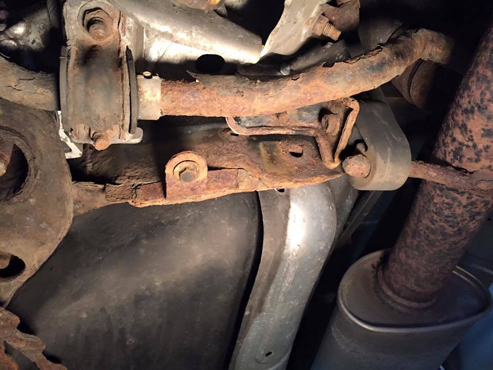

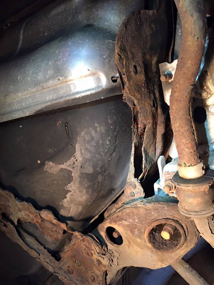

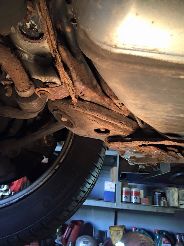

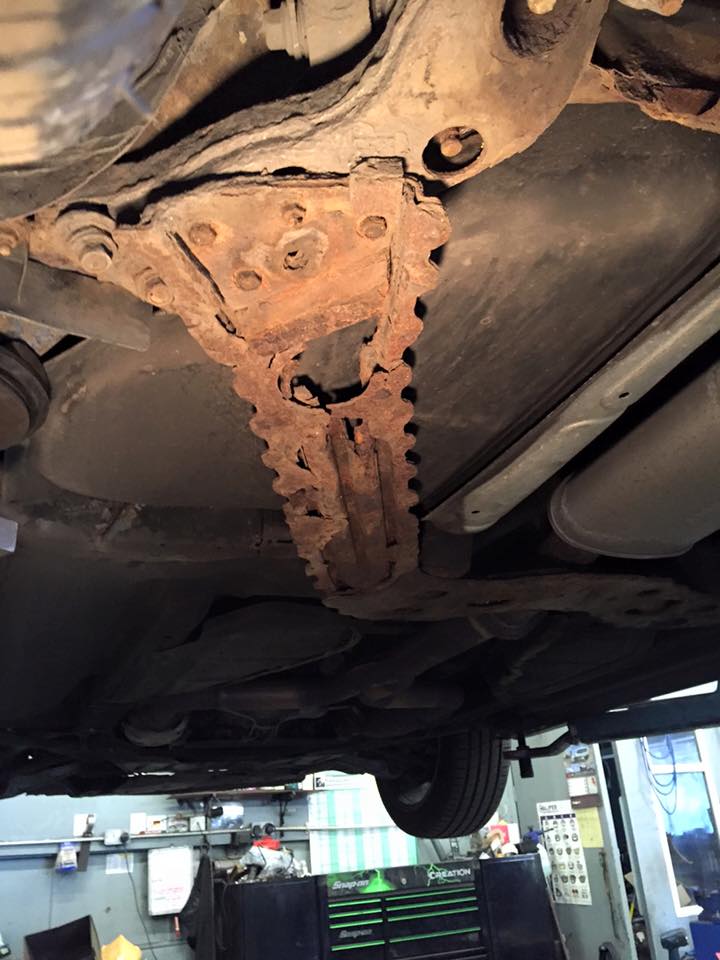

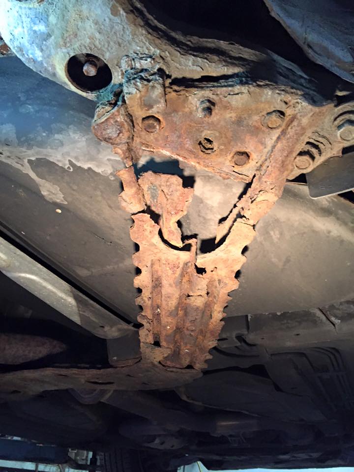

willow990 Posted September 20, 2015 Share Posted September 20, 2015 bought my 350 just under a month ago and finally had chance to get it on the ramp and look underneath. straight away noticed sort of 'u' shaped brace that was completely corroded (pictured). after looking a bit further, just behind the fuel tank (i think) there was another plate of some sort which is on its way out. I've tried to get some pictures the best i can, but if someone could give me any advice on if these need replacing? is it structural? and what they are called? so i can look into it replacing them. any advice would be appreciated so i can get it sorted before winter sets in Quote Link to comment Share on other sites More sharing options...
garygranite Posted September 20, 2015 Share Posted September 20, 2015 bought mine a week ago and noticed same , think only surface rust sure could be rubbed down and painted. may take mine off and get sandblasted!! Quote Link to comment Share on other sites More sharing options...
SHEZZA Posted September 20, 2015 Share Posted September 20, 2015 (edited) The one part in the last three pics is the W brace and looking at your pics that will definitely need replacing id say as it looks totally shot at the one end. Edited September 20, 2015 by SHEZZA Quote Link to comment Share on other sites More sharing options...
GMballistic Posted September 20, 2015 Share Posted September 20, 2015 That is definitely the worst condition W-brace I've seen on a 350 Willow. Usually the cheap option that most people can do is remove it, clean the rust off and "Hammerite" paint over it but yours definitely needs binning asap before it falls off in the road, ...could be especially bad if it comes off and hits another car. You could try zmanalex on here for a pre-owned W-brace which is the cheapest option. Link: http://www.350z-uk.com/user/9648-zmanalex/ Your next option and imo the best option is to get an aftermarket W-brace as it will be cheaper than getting a Nissan OEM replacement. This is the one I usually recommend to people on here and everyone I know has been more than happy with it. Link: http://www.ebay.co.uk/itm/Ultra-Racing-Rear-Lower-Brace-Nissan-350Z-3-5-2003-RL4-1259-/271339756751?hash=item3f2d1c1ccf If you don't like or want it though then I believe the Cougar Store or Clark Motorsport on here can both get you the OEM W-brace. Other traders may be able to as well but they are just the two I know who definitely should be able to although if memory serves it's around the £200 mark for the OEM one. Good luck. 2 Quote Link to comment Share on other sites More sharing options...

R88RPE Posted September 20, 2015 Share Posted September 20, 2015 That W brace is toast! Good job you checked it Quote Link to comment Share on other sites More sharing options...
