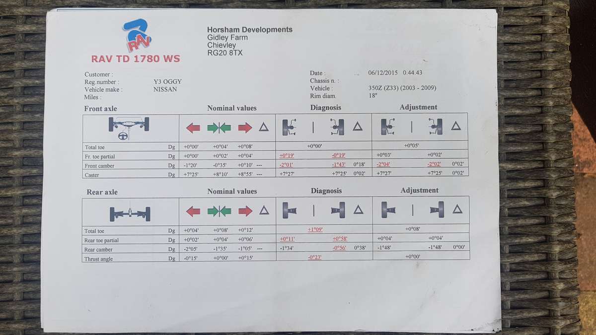

Ogman Posted June 4, 2018 Author Share Posted June 4, 2018 (edited) Well, it's been a while. Hello all the original crew and any other new members around now Been a tough couple of years which is why I haven't been active on here for some time! But now I'm back and just wanted to bring the thread up to date. Over two years back, when my better half was 7 months pregnant with our second child, our first child was diagnosed with Type 1 diabetes at the age of 4. Many of you will know Samuel from Ace Cafe, Japfest etc - especially Adrian and also Amy, who he adores! It took us as a complete surprise and we just took everything in our stride, and now it's just became a way of life for us now, not stopped us or him doing anything! -------------------------------------------------------------------------------------------------------------------------------------------------------------------------------------------------------------------------------- December 2015 The work that was carried out by Jez @ Horsham was top-notch, felt like a giant go-kart on steroids - seriously, the smile on my face the whole way home was something else. After purchasing the Uprev license, the car was mapped following the previous mods now carried out. Felt like a new car to drive, the noise, the throttle response, the power delivery, just....amazing. The following items were fitted: - SPL PRO V3 front upper camber arms - SPL rear camber links - SPL front end links - SPL rear end links - SPL rear traction arms - SPL eccentric lock out kit - Eibach front & rear ARB kit The alignment was tweaked and done to perfection (in my opinion). Can't remember the lads name who was working on the alignment but he was loving the SPL components! Loved working with them he had said too. I have a few images below of the results of the dyno and the geometry alignment: Plenum Spacer, Motordyne ART Test pipes, Invidia Gemini Cat-Back (Resonated), ran on V-Power. Edited June 4, 2018 by Ogman Quote Link to comment Share on other sites More sharing options...
