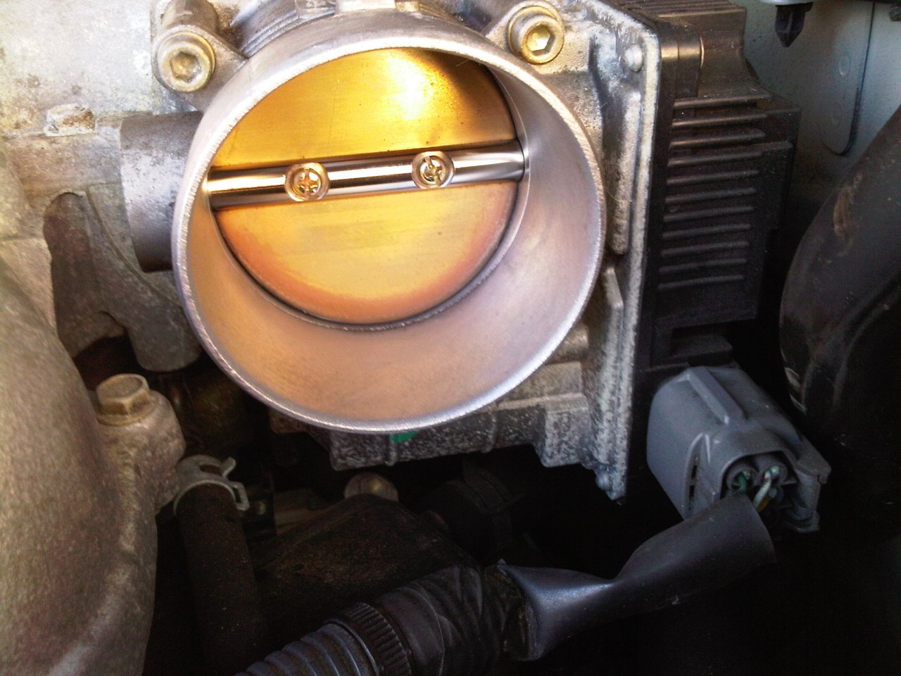

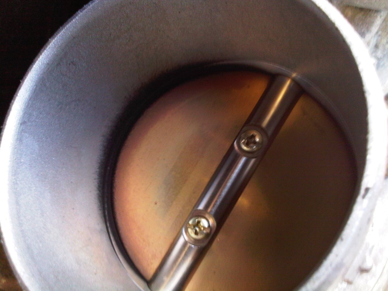

narcotix Posted February 20, 2010 Share Posted February 20, 2010 I've just had a go at cleaning out my throttle body ... I was planning on removing it so that I could give it a really good clean but my allen keys weren't very good .. I was still able to give it a thorough clean while still attached though so I'm pleased with the result ... I haven't been out for a drive yet but will let you know if there is any noticable difference compared to before ... Anyway here are the before and after pics ... Before: The TB was very dirty and there was lots of black deposits ... After: Looking much healthier now. I held the butterfly valve open and sprayed some cleaner through ... then used a cloth to wipe away all the black stuff ... Thanks andlid for an excellent guide .. it really made it easy! Quote Link to comment Share on other sites More sharing options...

andlid Posted February 20, 2010 Share Posted February 20, 2010 that looked dirty! Let me know how you get on with the drive, be carefull not braking that butterfly, it shouldn't need to be forced (only opens one way) Glad to be of help Quote Link to comment Share on other sites More sharing options...
narcotix Posted February 20, 2010 Share Posted February 20, 2010 I'll find out tomorrow as I don't really have any plans to go out today ... clarkie34, It didn't need any force to open the butterfly valve ... It just requires a bit of pressure to open it .. I think next time I'm going to remove it completely and give it an even better clean ... but for now that's done the trick! I should have taken some pics of the cloth after I'd finished cleaning ... It was almost completely black by the end .. Quote Link to comment Share on other sites More sharing options...
clarkie34 Posted February 20, 2010 Share Posted February 20, 2010 I have just done this and it made no difference.Plenty of crap came out the throttle but it's still behaving the same. Back to Nissan me thinks. Quote Link to comment Share on other sites More sharing options...
lrh Posted February 20, 2010 Share Posted February 20, 2010 Just done this myself this afternoon. Have cleaned the throttle on all my cars in the past but this was the worst. Took multiple sprays and three whole paper towels to remove the layer of black sludge. Only went out for a quick test after but hot idle seems to have gone from about 675 to 800 rpm, so it's definitely breathing easier on a light throttle. Butterfly feels lighter sprung than one worked by cable but remember you're turning the motor when you move it. Just be slow and smooth opening/closing it and you can't wrong. Quote Link to comment Share on other sites More sharing options...
